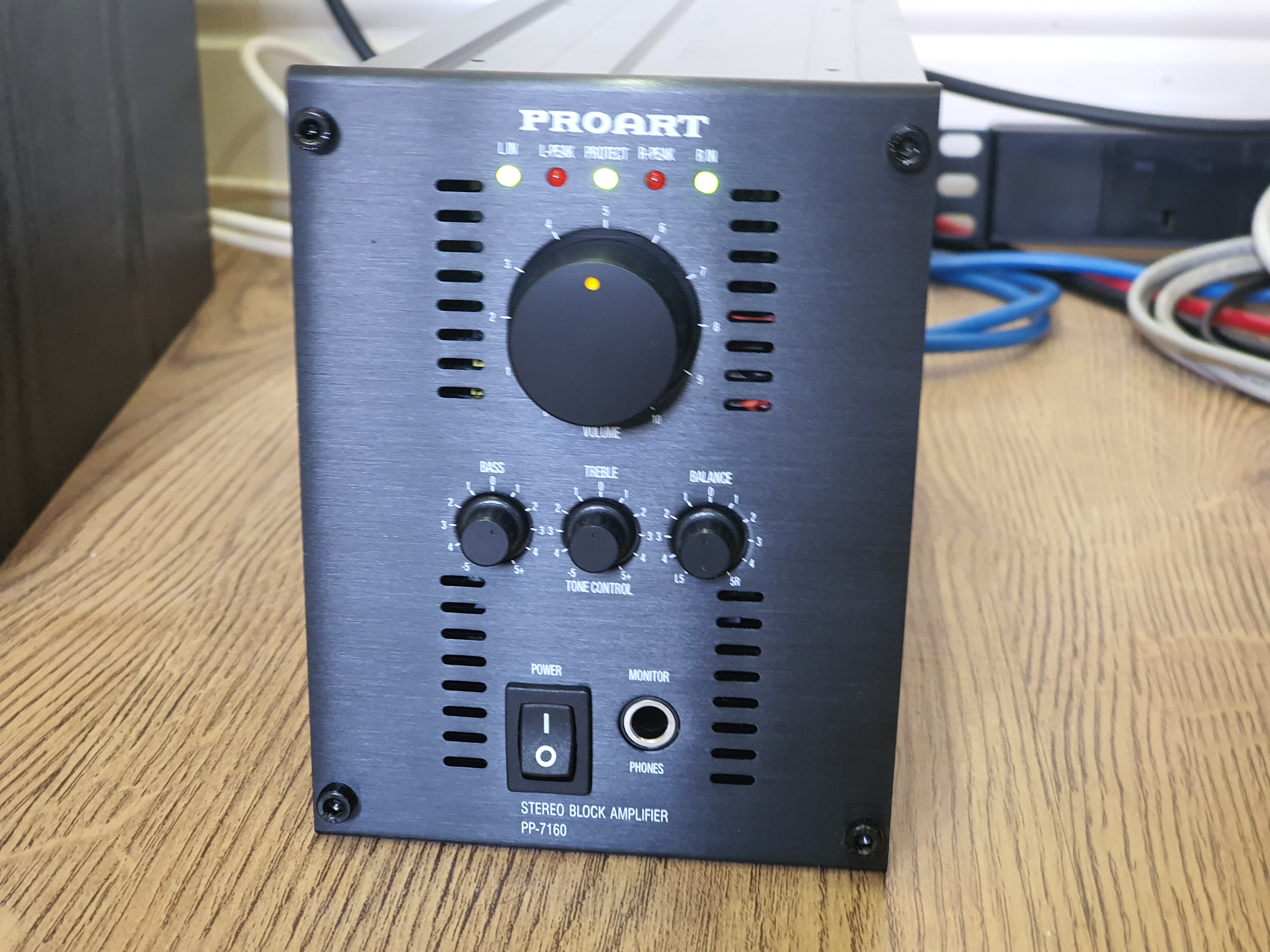

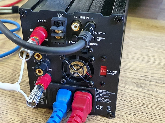

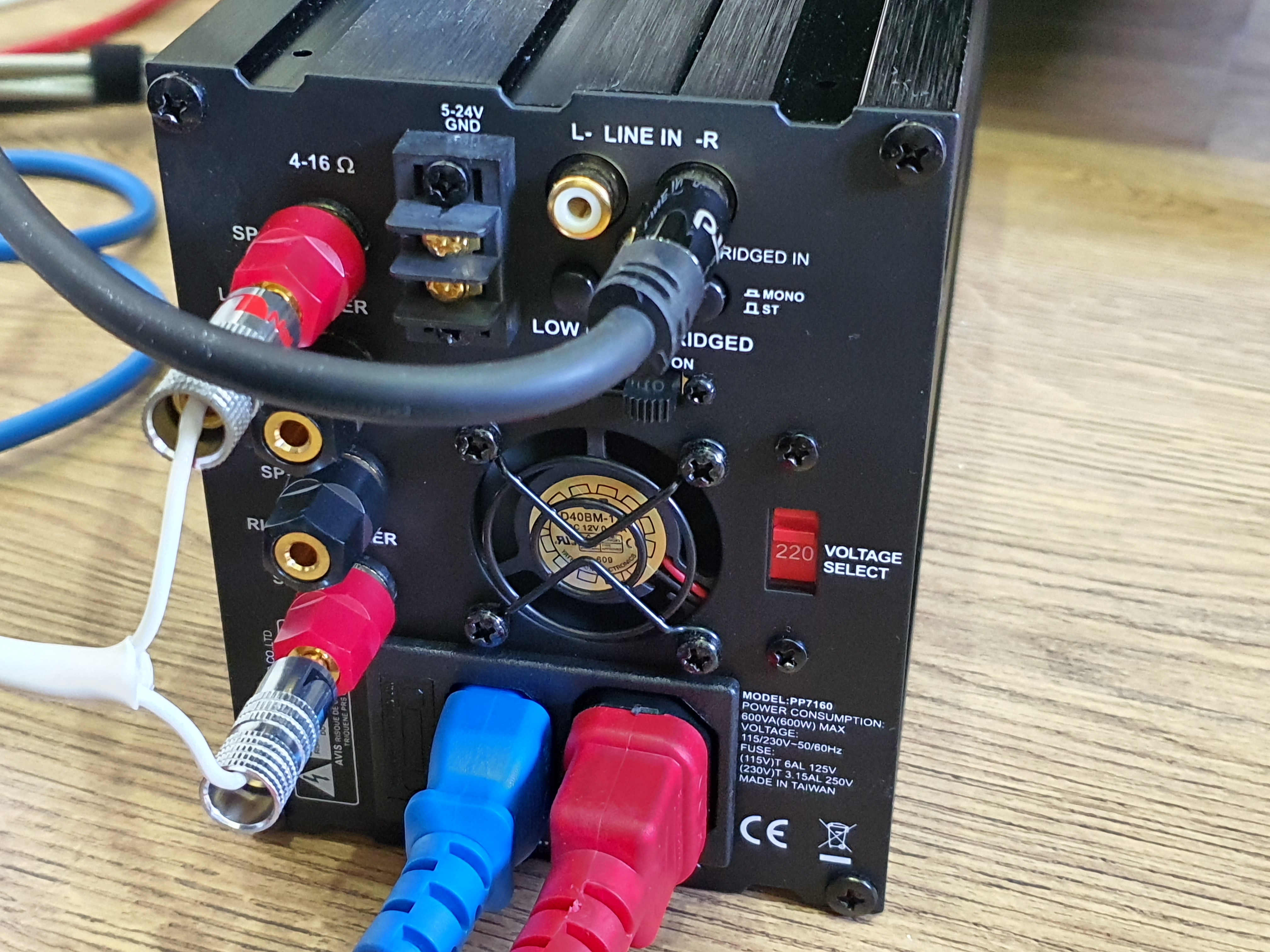

Look carefully at the inputs on your monoblocks. Line in L and R marked above them. However look below the sockets and the red R socket is also marked as ‘Bridged in’.
So a single RCA lead from the left output of your converter to the R socket of the monoblock you are using for the left channel.
Then a single RCA lead from the right output of your converter to the R socket of the monoblock you are using for the right channel.
Thanks Paul, so I only need one line level converter as there are 4 input wires (or two pairs) that would take up say, Speaker A outputs. Then as you say, split the RCA outputs to each amp, then output from there to one speaker per mono-block! :nerd_face: I presume the tape out sockets will give line level to the mono-blocks, irrespective of source on the main amp, so all will be golden :grimacing:

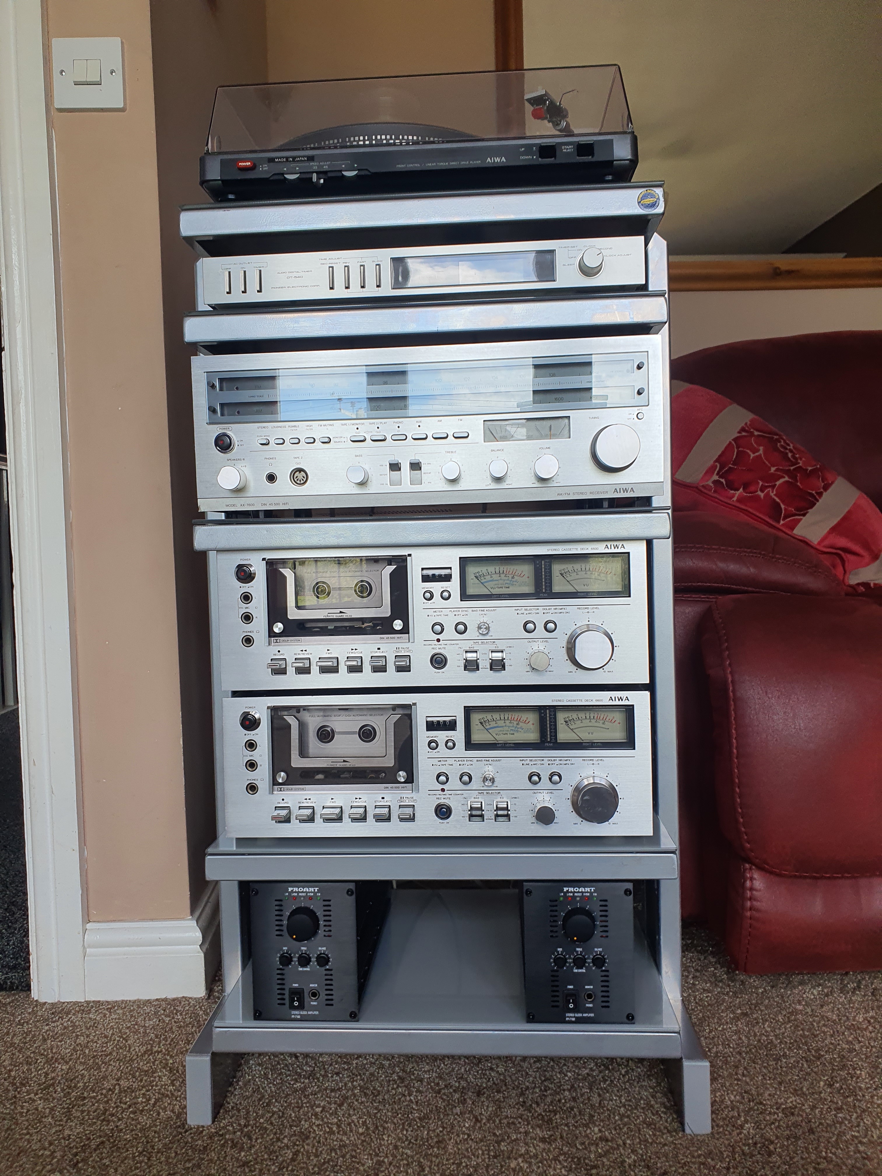

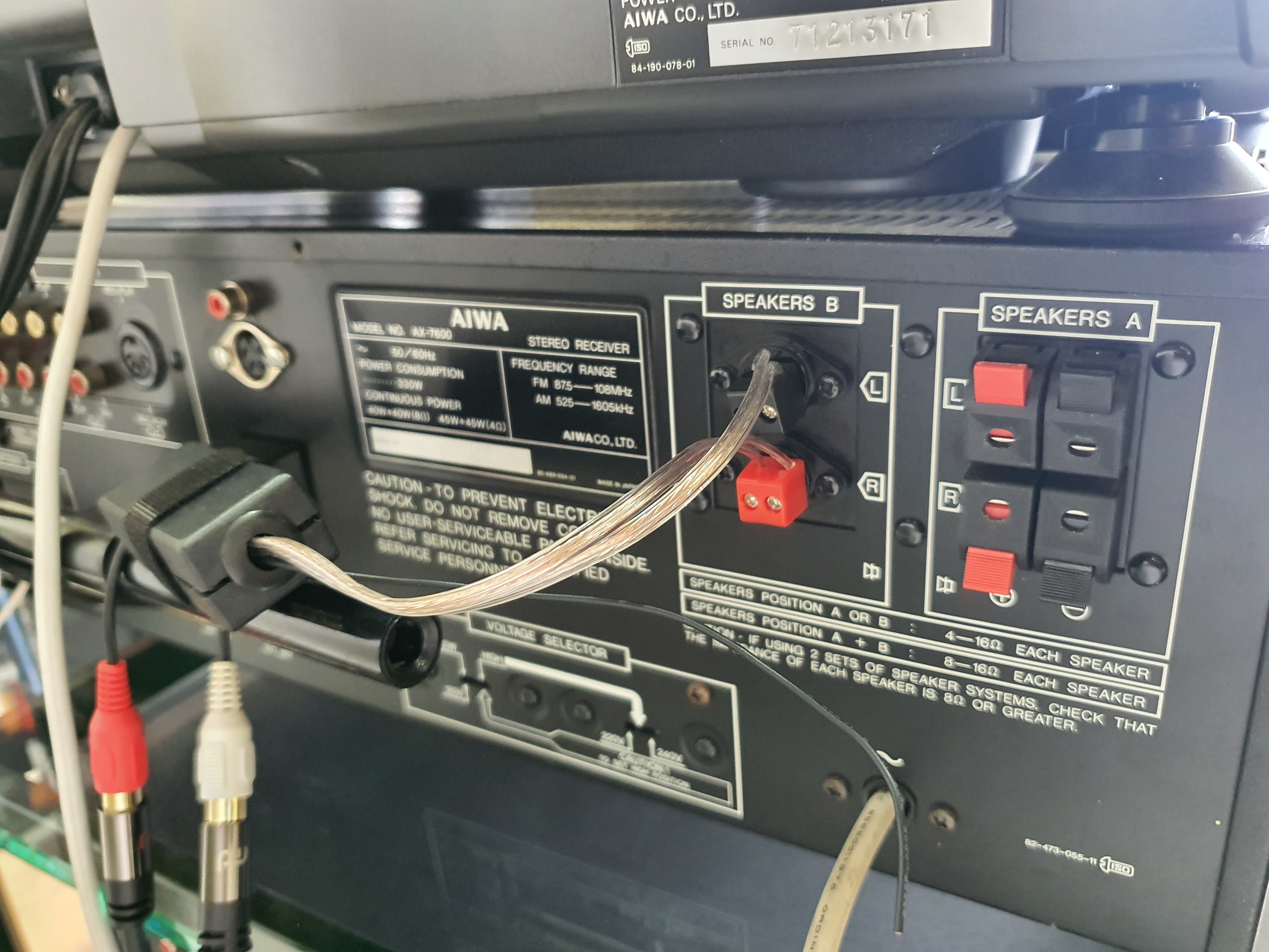

Well, I’ve only gone and done it!!! :smiley::smiley:
From help, advice and guidance on here, ( not too bad for a car forum), I’ve disconnected the entire set up as it was in the spare bedroom and reassembled some of the components to look like this.
Only got the tuner/ amp connected fully to the mono-blocks just to test.
Reinstated the fabulous LEAK 600’S for this occasion too! :+1:
The mono-blocks connected as previously discussed, reassured by advice gratefully received :slightly_smiling_face:
Rear view of main amp with speaker outs to line level converter.
All working very nicely, just need some sort of low stands for these amps now.
Its weird being able to individually set each speaker to give the sound you want?
Talking of sound, hearing great clarity from the tuner, better than ever! :nerd_face:

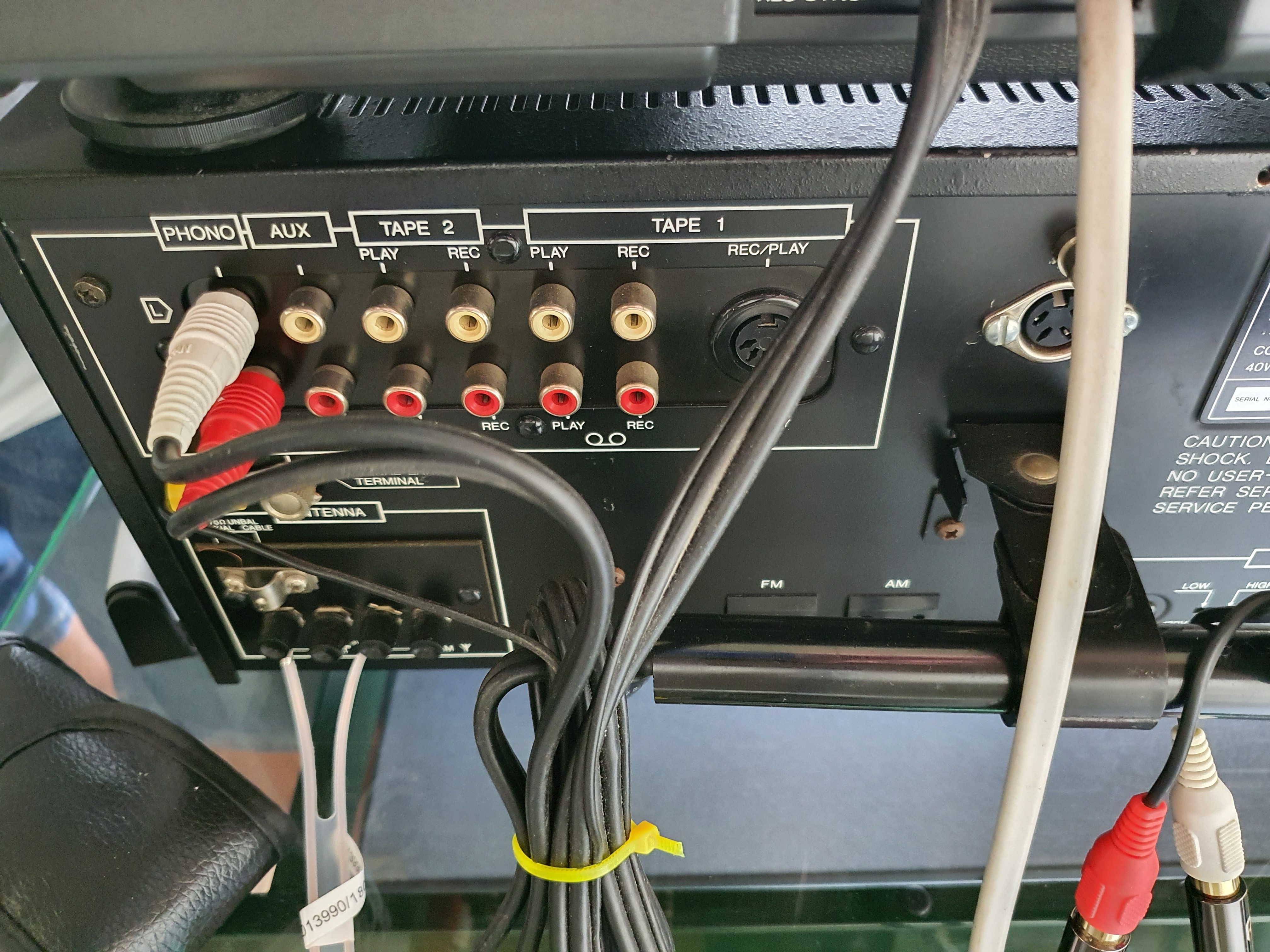

I want to connect the AKAI R to R deck so need to have a think about tape in outs for direct mono-block connections, the AIWA cassette deck to connect in too! :laughing:
Just realised, both the AIWA AX-7600 and the AKAI 4000DS have 5 pin DIN plugs, so can connect them directly to each other for play/record :hugs: on rear are further inputs/outputs so should be able to connect the mono-blocks directly AND the AIWA 6600 cassette decks :nerd_face:
I’ll save all that for another day though.
Just connect your reel to reel, cassette and everything else to the receiver as you would normally do. Forget about the monoblocks. The line level converter, monoblocks and speakers have just replaced whatever speakers you had on the system before. Do all the source selection on the receiver as before. Whatever comes out of the speaker outputs will be fed through the monoblocks.
One other thing, to minimise noise you should have the volume reasonably high on the receiver and low on the monoblocks. Maybe start at 6 out of 10 on the receiver and 1 out of 10 on the monoblocks. If that’s not loud enough then wind up the monoblocks to what you consider to be maximum required. Then just use the receiver volume for whatever you need at the time.

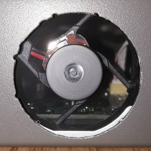

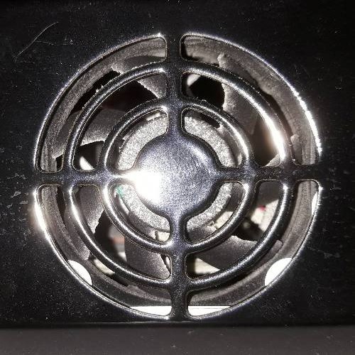

The cameras were lovely (their manual had such a Map), but fiddling about with the confusing and muddled menus on the DVR has taken a few too many days, and today I got fed up with its fan noise (it is not a noisy fan, but a noisy case).

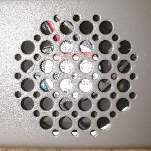

So this afternoon it was surgery on the brand new DVR to machine out the grille (a forest of tiny howling holes punched into the case), and turn the fan around so the draft hits the big heat-sink inside. Now it’s as quiet as the old DVR which had the same Sunon fan! I have a filtered grille on its way which will make it a lot quieter still.
Grief and frustration and wasted time, but the sharp and noise-free pictures (even at night) make it all worth while. And it can be easily accessed using browser (FF works nicely) from PC and phone - if they have enough bandwidth.
Old quiet DVR fan aperture
20200804_094852_b
New DVR with noisy forest of holes
20200804_094811_f

It will have this filter to keep dust and fingers out. I’ll put the fixing holes in when the filter arrives, no margin for error on something so small.

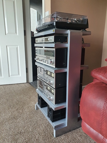

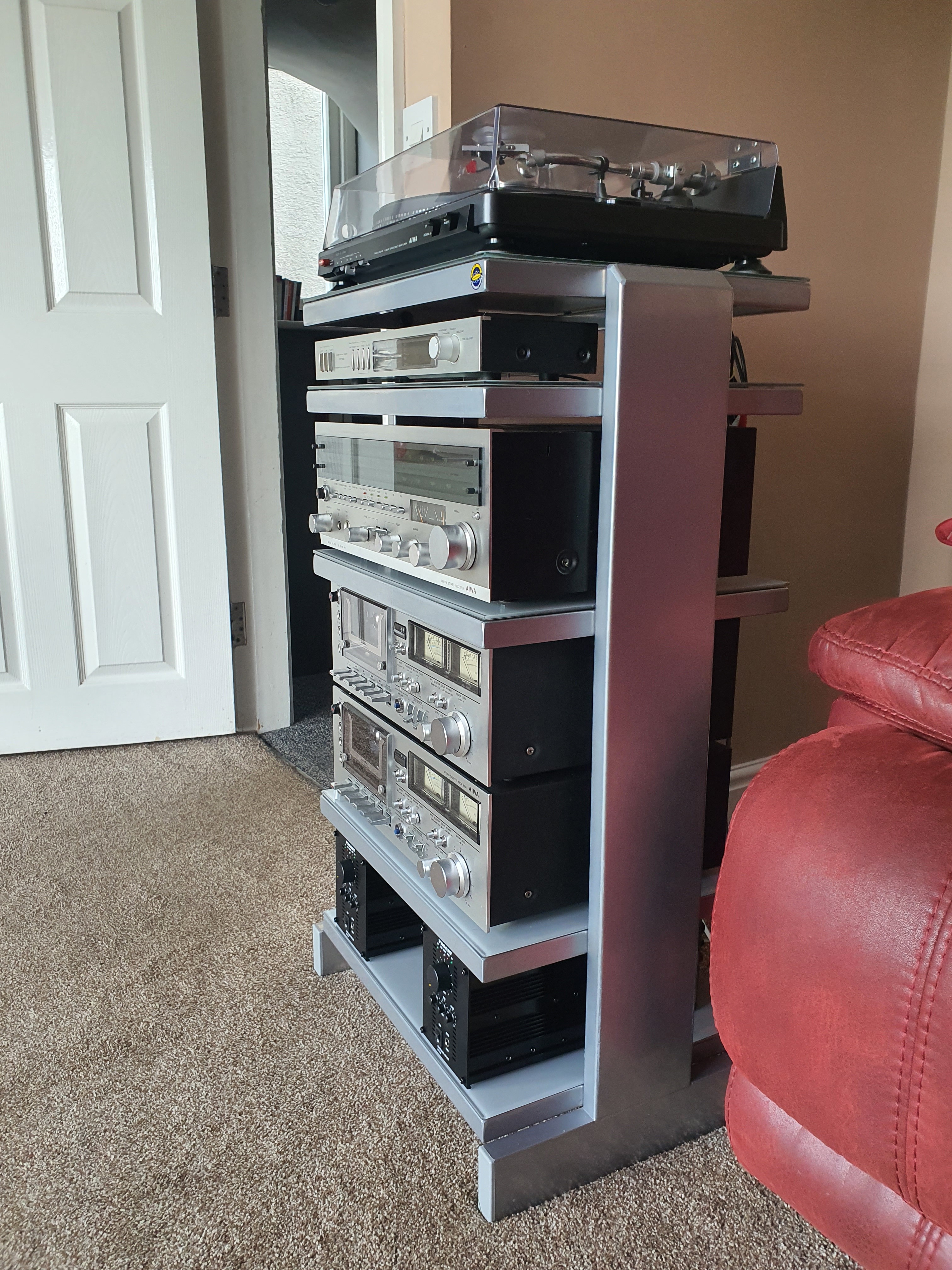

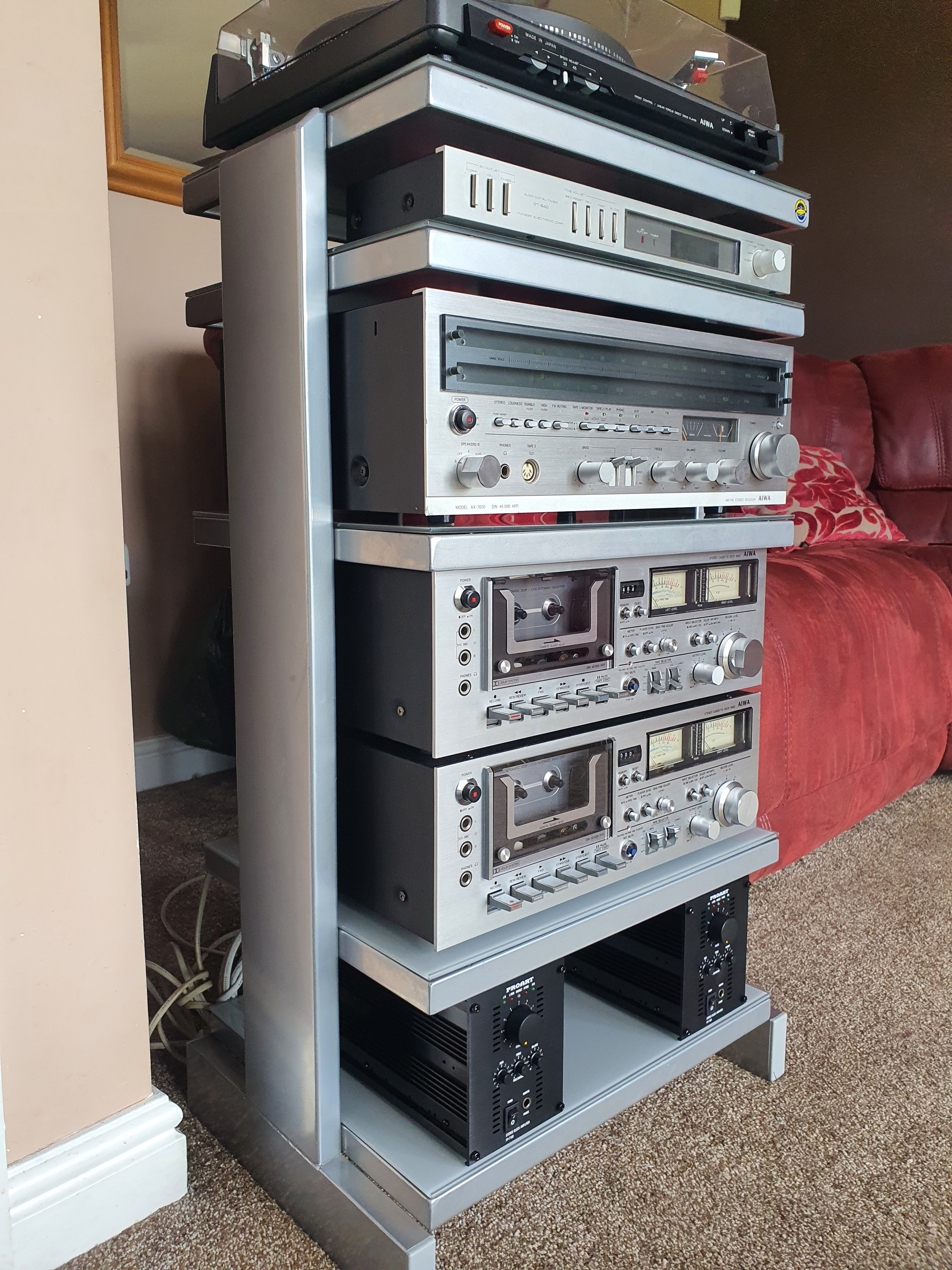

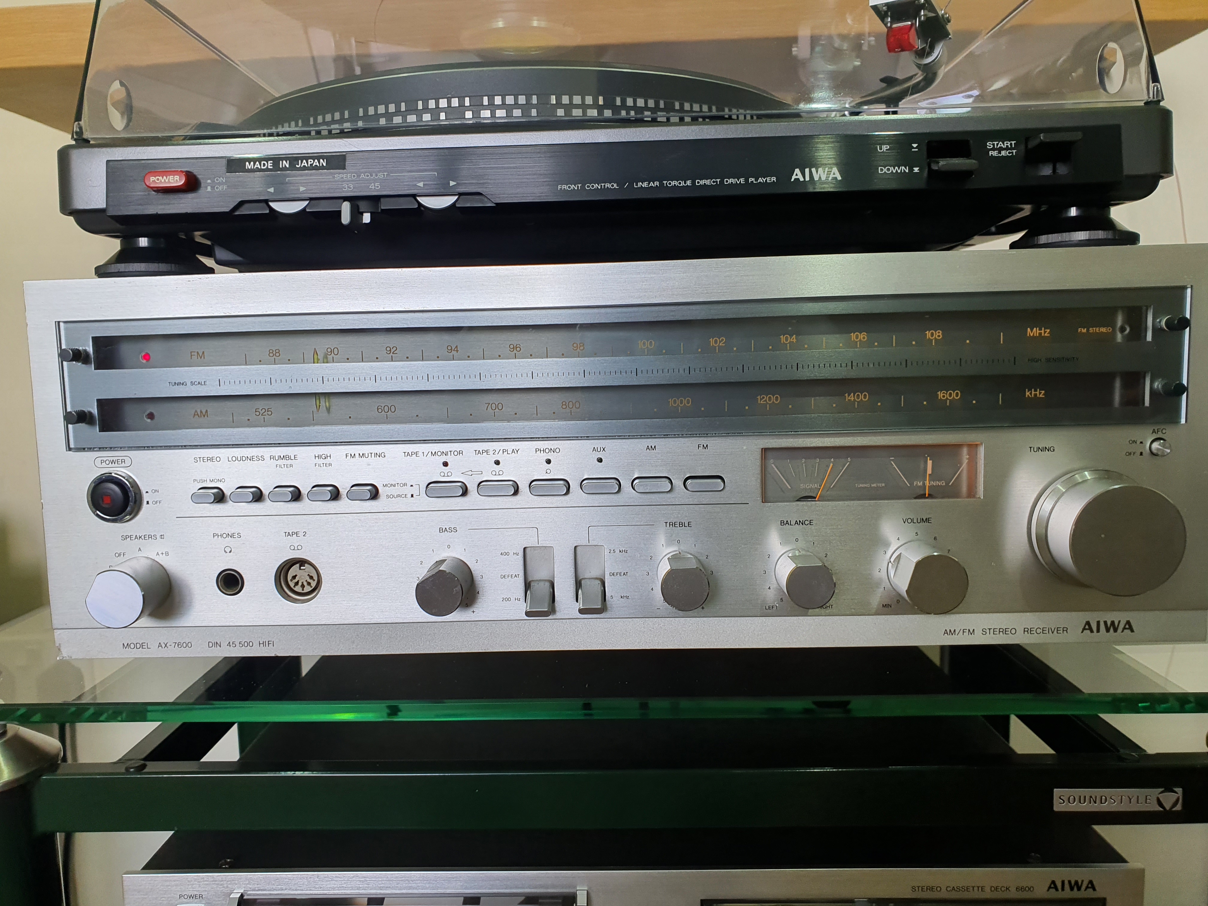

Well, its been over 2 weeks since any posts on here! Also, I feel like I’ve been slacking a bit! :rofl: So, nipped over to Oldham this morning and picked up a hifi rack. Been after another one for a while to put some gear back into the lounge but everything half decent is so expensive new. In these circumstances, FB Marketplace can throw up all sorts of stuff :+1:

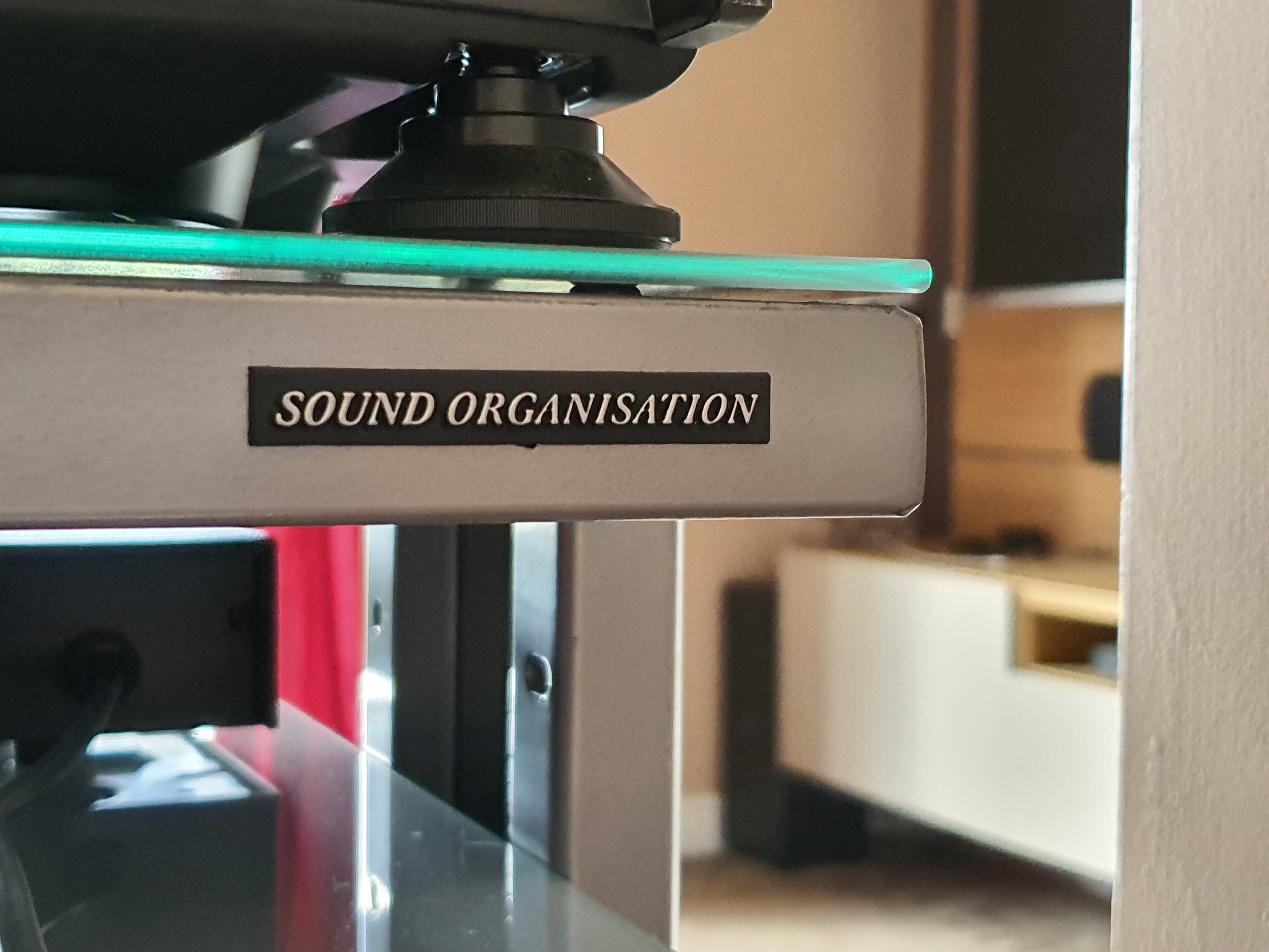

This mornings prize is a Sounds Organisation metal with glass shelves stand.
Old skool, very heavy and extremely solid! 5 adjustable levels, hold in place with Allan bolts and steel backing plates in steel side frames. Shelf frames are steel square section with glass shelves.
Not actually connected anything up yet, just brought stuff down from the upstairs office to the lounge, adjusting the shelves as each piece went in!
I’ve actually put equipment in, facing the wrong way? :thinking:
The stand is ready for floor spikes (my go to choice for damaging floor coverings) which I’ve ordered along with cups for them to stand in. So will shuffle stuff around when moving the stand into its final position.
I’m also compromising with MrsB who has acknowledged the need (my need) for HIFI gear to be reinstated in the lounge :joy:
The compromise is the speakers! I have the Polk T50’s, Tannoy Eclipse and the LEAK 600’s to choose from, or so I thought!
So, the Mourdant Short M10’s will have to do but I have a cunning plan! :sunglasses: I’m going to stealthily introduce the AIWA subwoofer into the mix somewhere, to provide support bass wise for the M10’s :smile: The mono-blocks are in there too so :crossed_fingers:t2: all will be good! Will report back once I’ve jumped all the hurdles!
