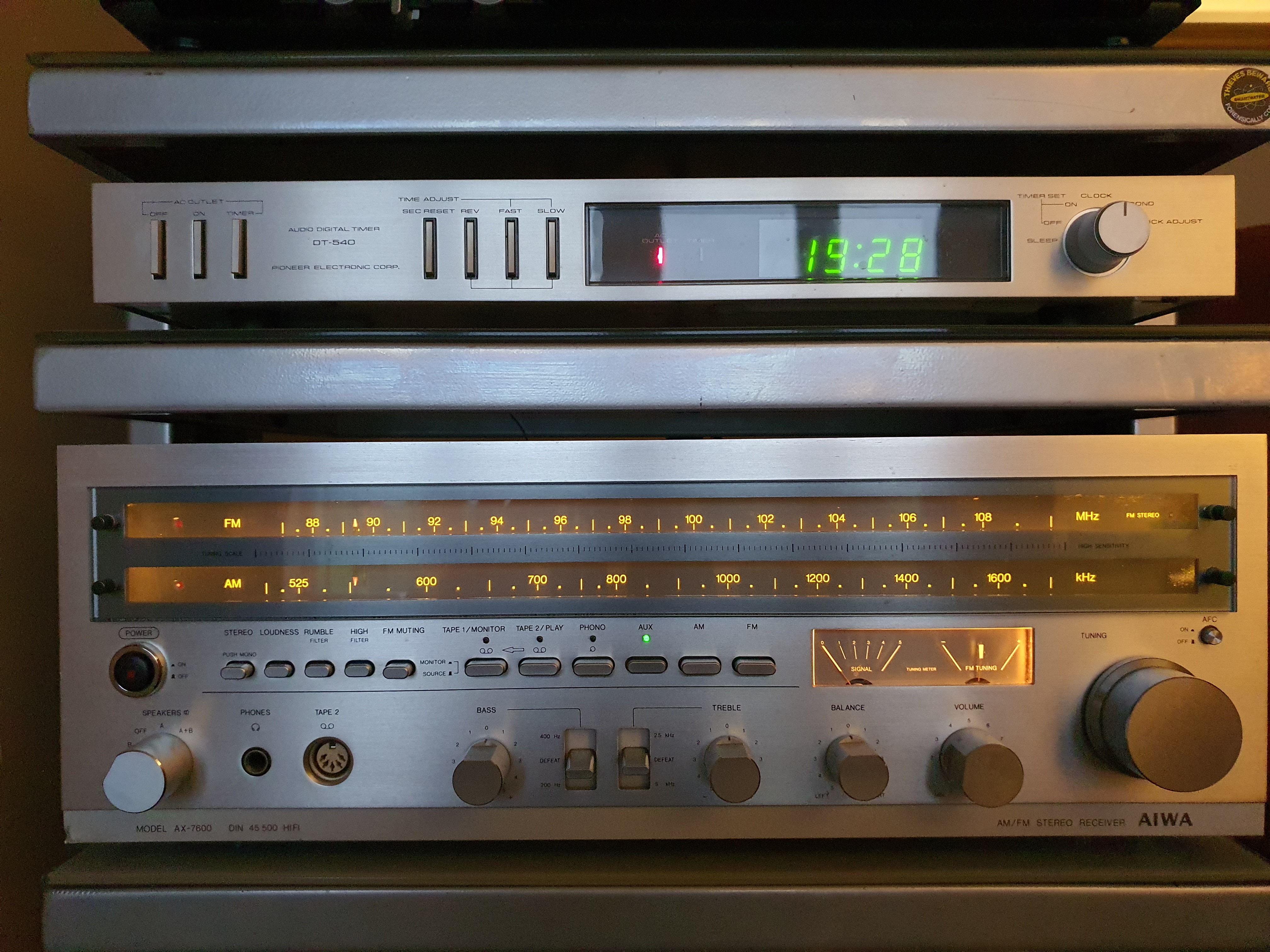

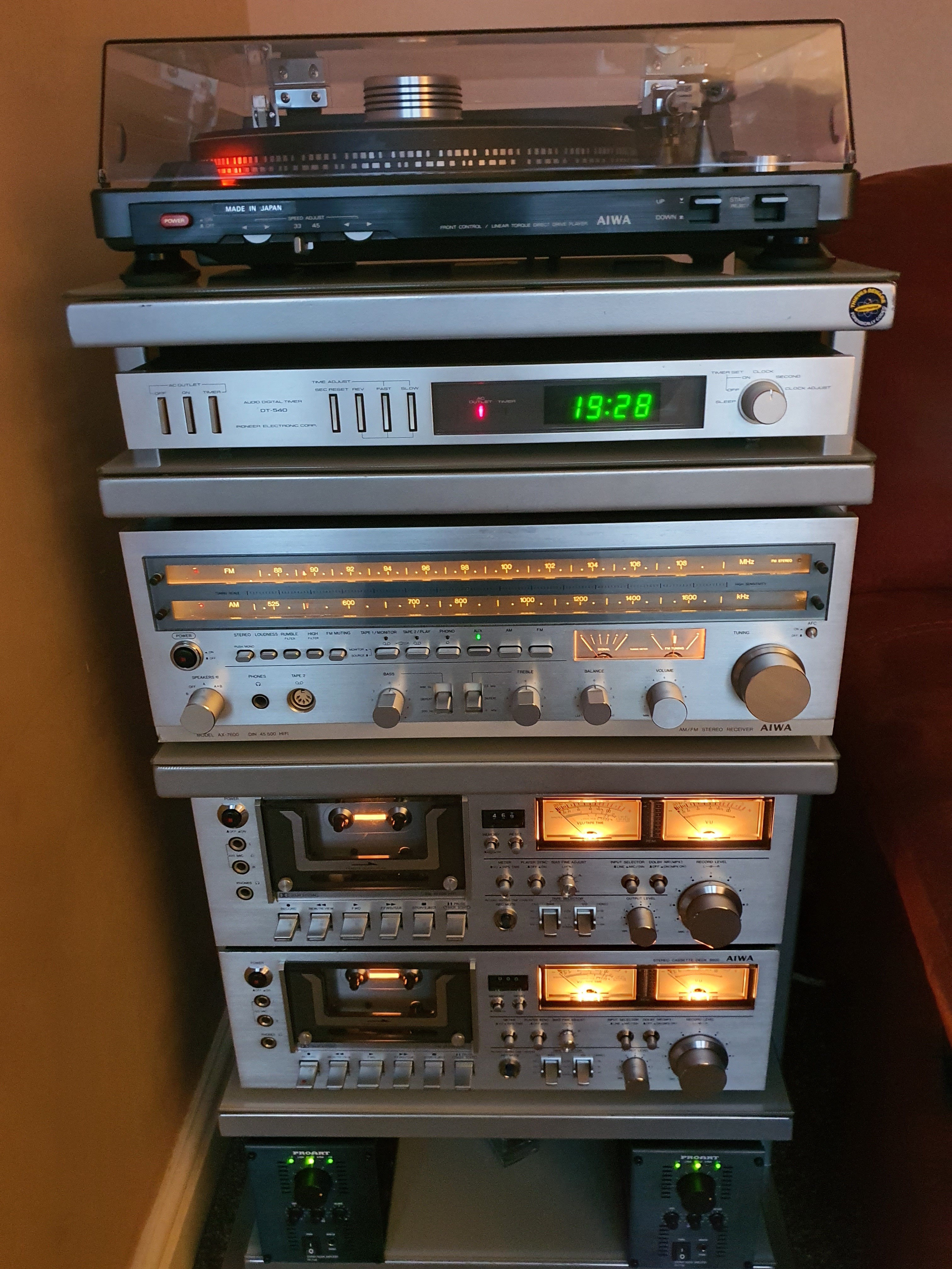

Just received another bluetooth receiver for the amp in the lounge. Its identical to the other one I purchased almost 2 years ago. That one went into the garden bar for outdoor music. As it has performed faultlessly in those two years, I decided to buy another! Mpow is the brand off Amazon at £14.99 delivered complete with 3.5mm jack/jack, 3.5mm jack/twin RCA phono and a USB charging cable too! Very easy to pair and connect to my vintage AIWA amp/tuner via rear RCA sockets.
Anyway, snapped a few pics of the system in the twilight :smiley:
Lovely display to look at :+1: the silver fronted separates I really do like! They don’t sound too bad either :smile:
Looks a great set up Barrie👍
Thanks Andrew, I sort of keep drifting in and out of the hi fi stuff while doing other stuff. Nice to have it sat there, ready for when I want to listen to things. :+1:None of it has cost a lot, which is a nice bonus :grinning:

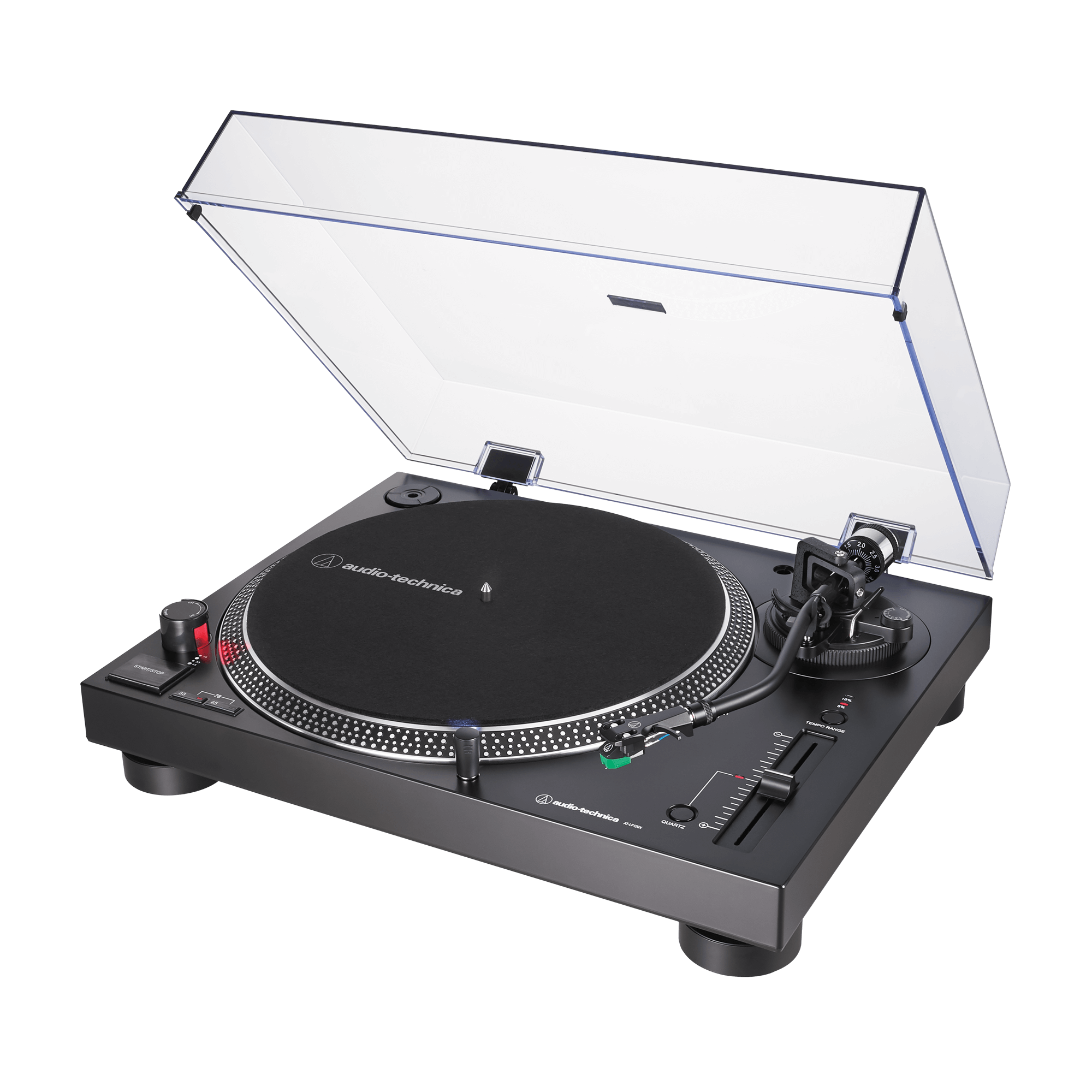

Hi everyone! I’ve been considering a new turntable to fit in with my collection. Contrary to the ethos of this whole topic, I’ve purchased one of these!
Certainly don’t need (or want) the USB feature but can’t get a new one without it :thinking:
Bought off Amazon for £208 delivered! Bit of a bargain hopefully. Not in stock at time of purchase but also out of stock on Audio-Technica website too! I’m not in a hurry really, had one in my basket on Amazon at £240, got a msg today to say it was reduced to £215, so had a look. Got to checkout and a further £7 discount applied! What’s not to like, I thought :+1:

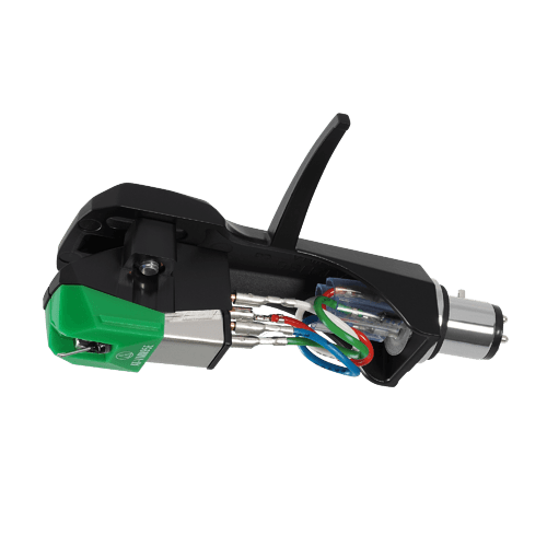

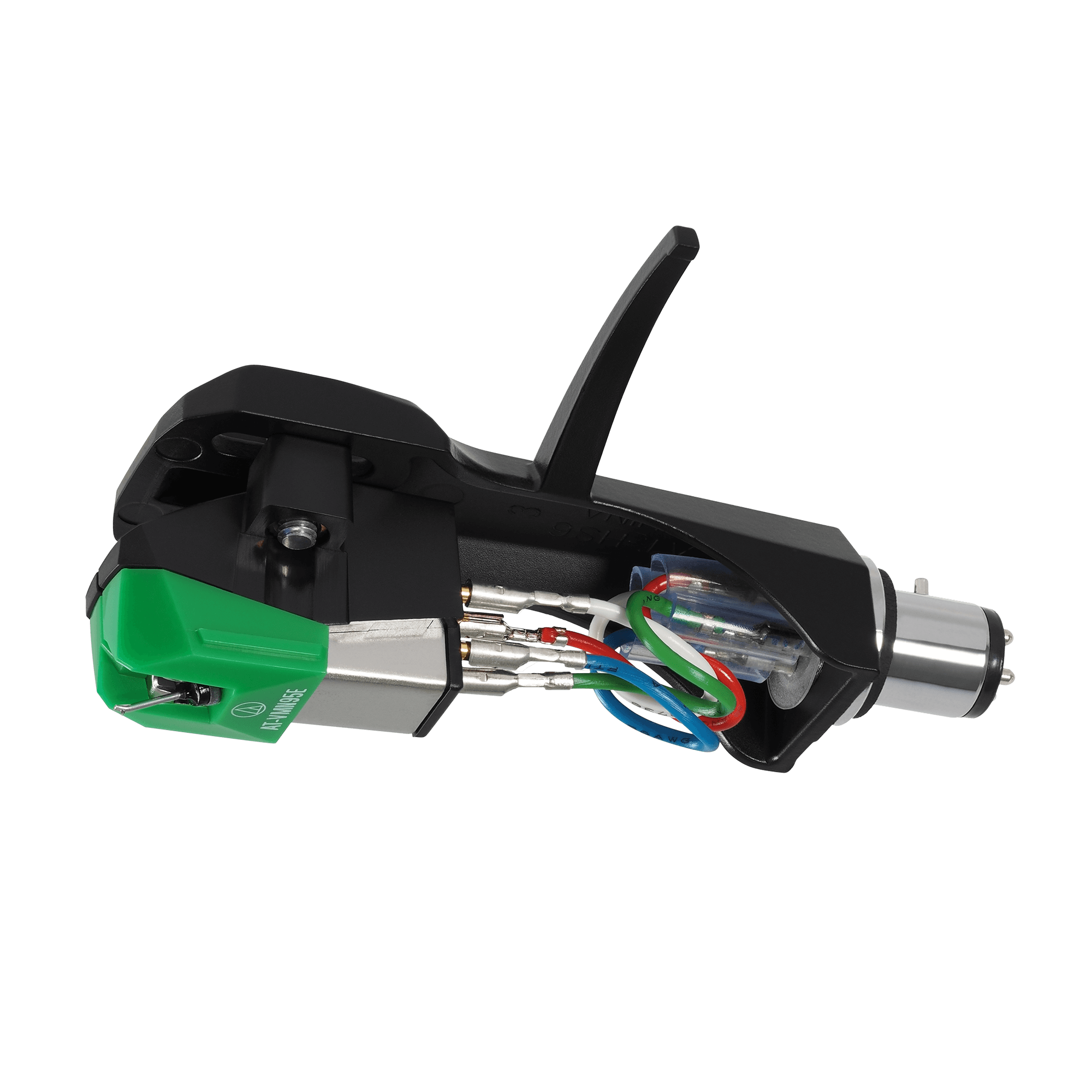

It ships with this head shell
and cartridge which is £70 on its own so a new direct drive TT for £140 is great.
Never owned a brand new TT before! Didn’t want to spend more than I had to and this is just the ticket for me! :+1:

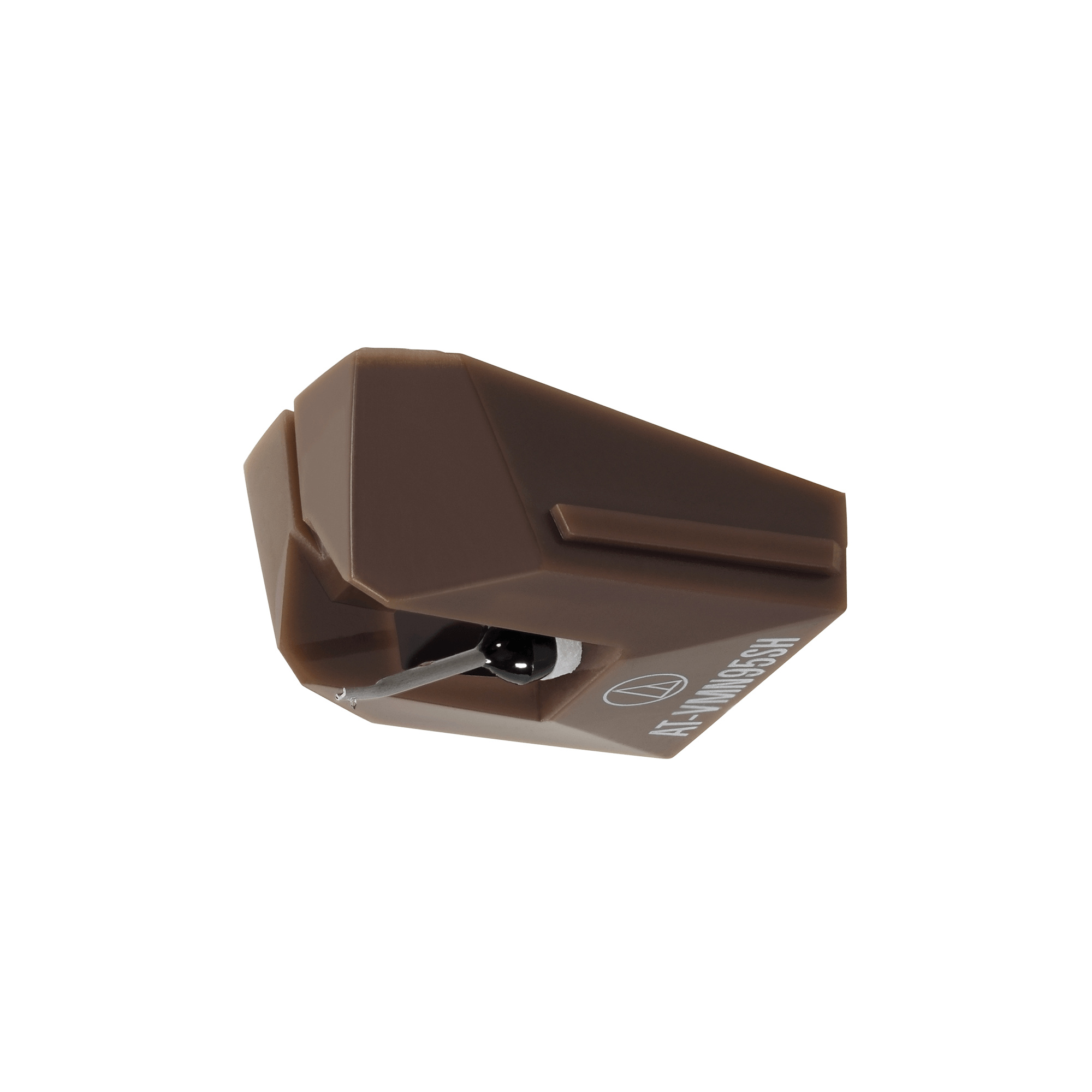

Various replacement styli available from a conical £19 jobby, to this Shibata stylus at £160
So plenty of options to upgrade ( if I ever get that far) the stylus itself. I like the idea of fully manual, direct drive and pitch control with quartz lock. Alloy platter and other features. Might pair it with the equally modern Sony STR-190 amp and the Polk T50 floorstanders. The ONKYO/LEAK/AIWA stuff can have a rest then! :smile:

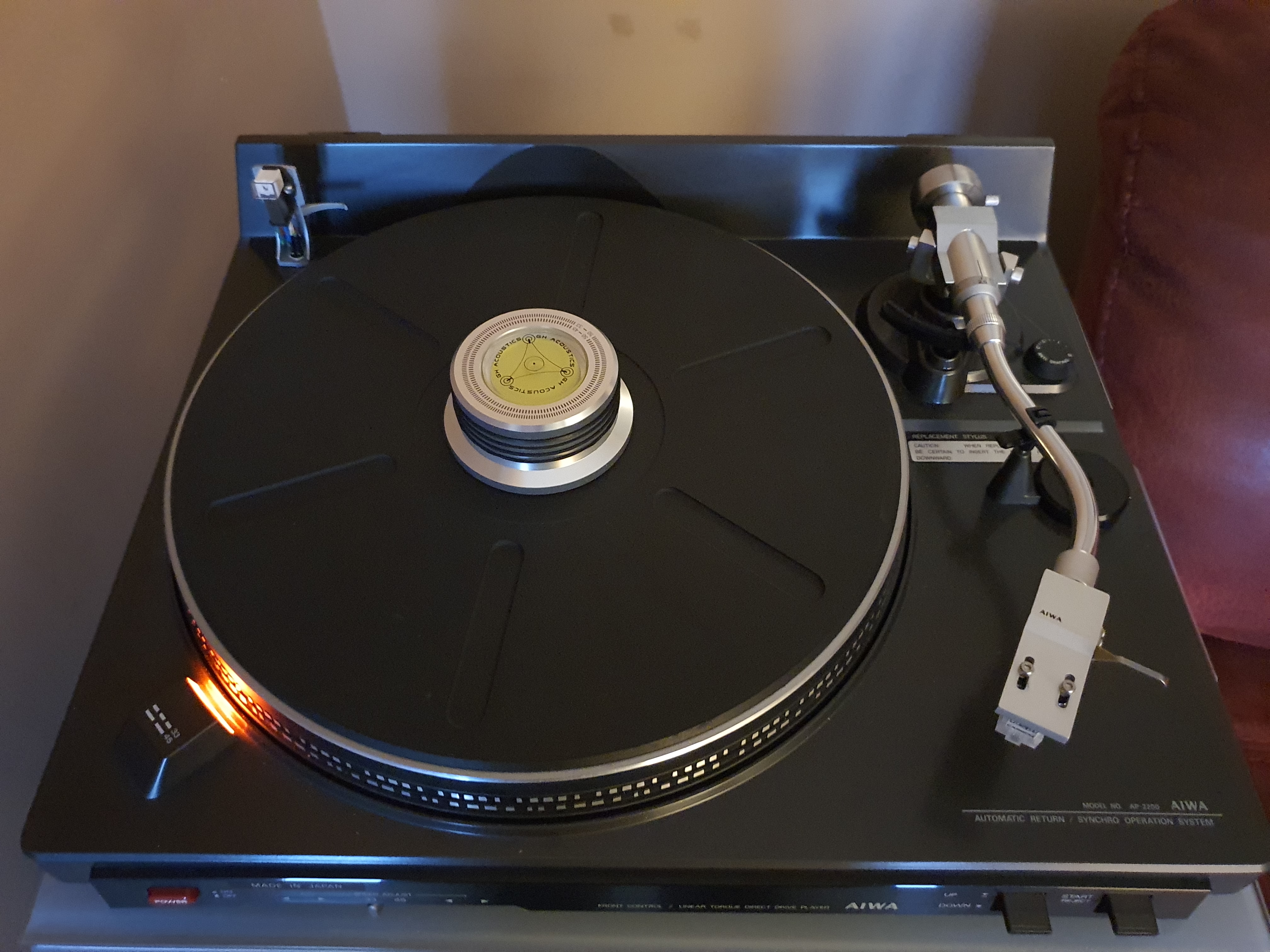

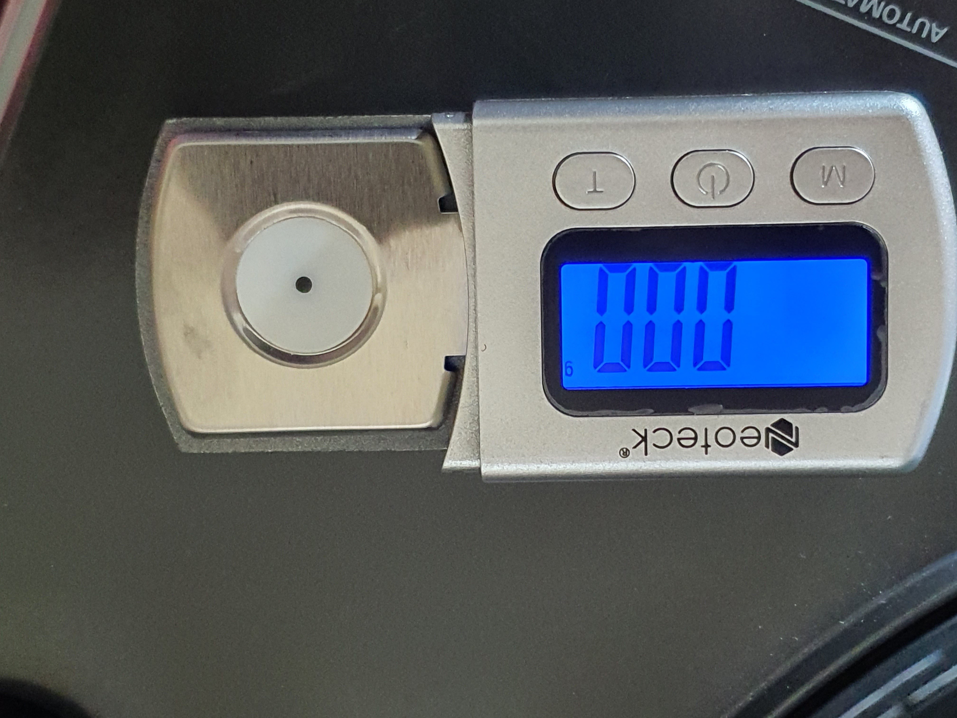

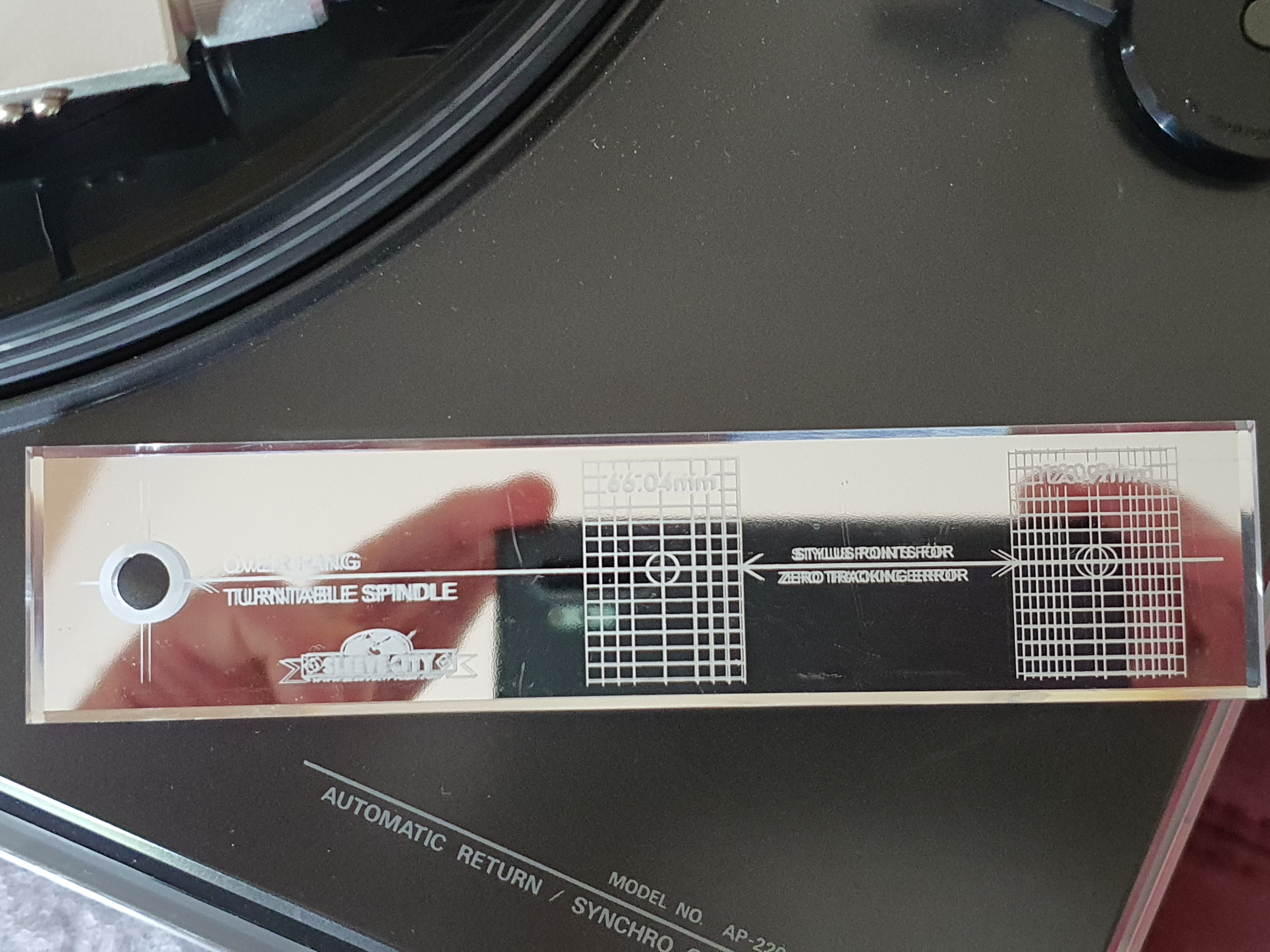

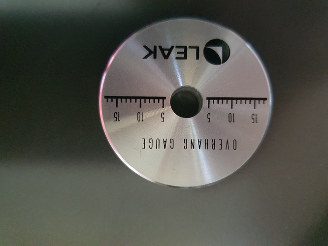

Just had a quick look on Amazon to check on progress of TT. Yesterday, I purchased for £208, this morning was £222, later on it is £230 and still pre order as none in stock! Glad I jumped in when I did! I think the AIWA AP-2200 TT was feeling a bit left out so gave it a bit of a ‘tune’ :grinning: using this,
this,
and this,
I checked and reset the tone arm balance, cartridge alignment and overhang and also tracking force and anti skate. Its quite an enjoyable task TBH :nerd_face:
I do have one issue to resolve though, the tone arm gets to a point (typically around the last track) where it wont go any further and starts to skip/jump. On certain albums, with less tracks, it won’t get to the auto return point either. Not too much a problem though, just treat it as a fully manual set up :nerd_face: would be nice to get it right though. I will disconnect it from the system and investigate at some point :+1:It’s what prompted me to check the settings as I thought maybe the tracking force and anti skate were off?

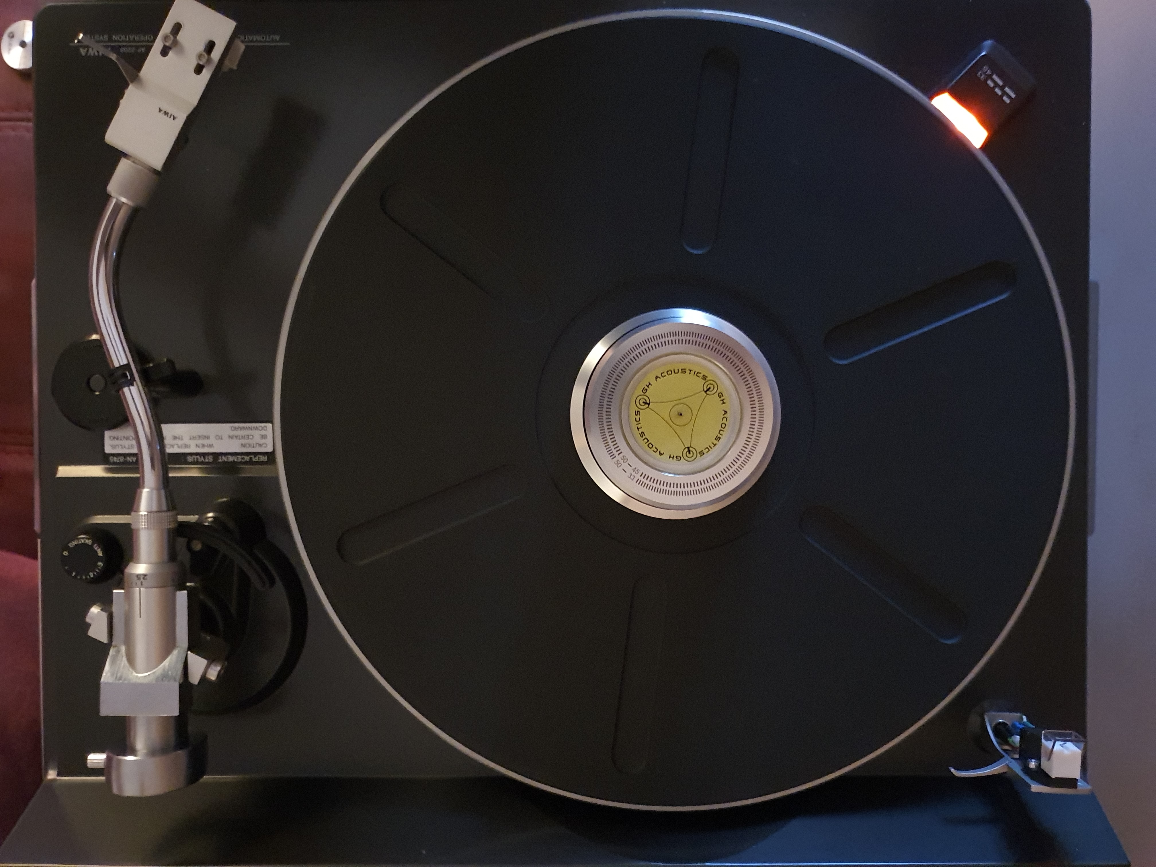

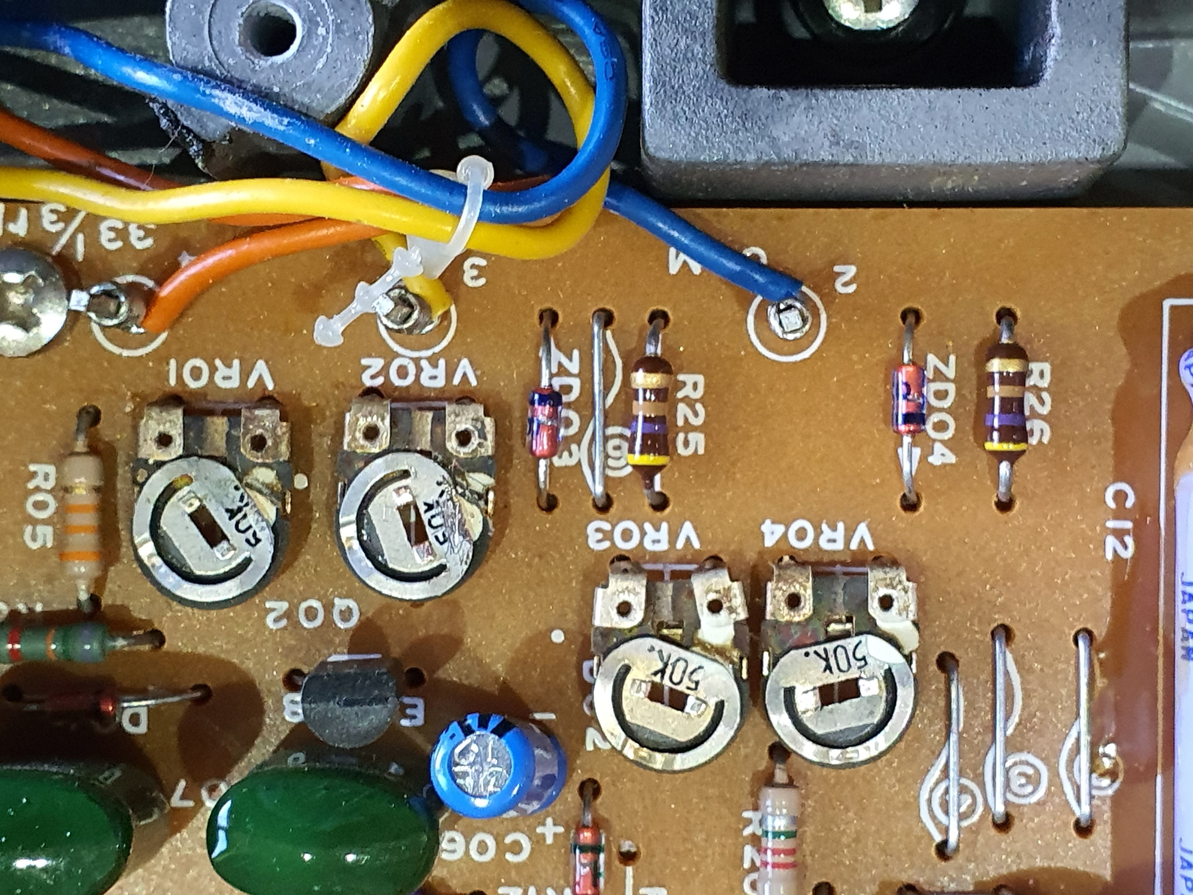

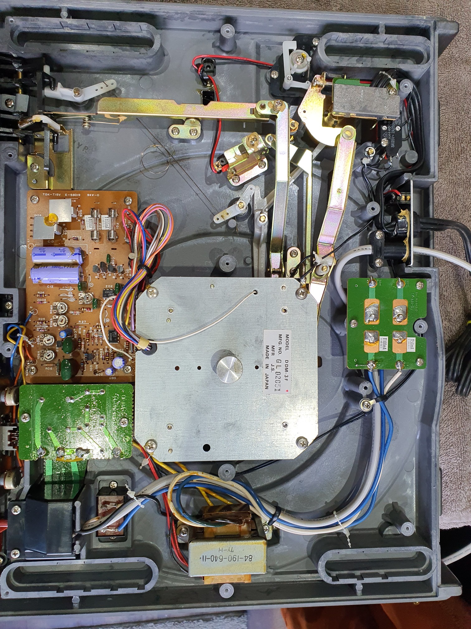

Right, pulled the deck out of the system and took it downstairs for a better look!

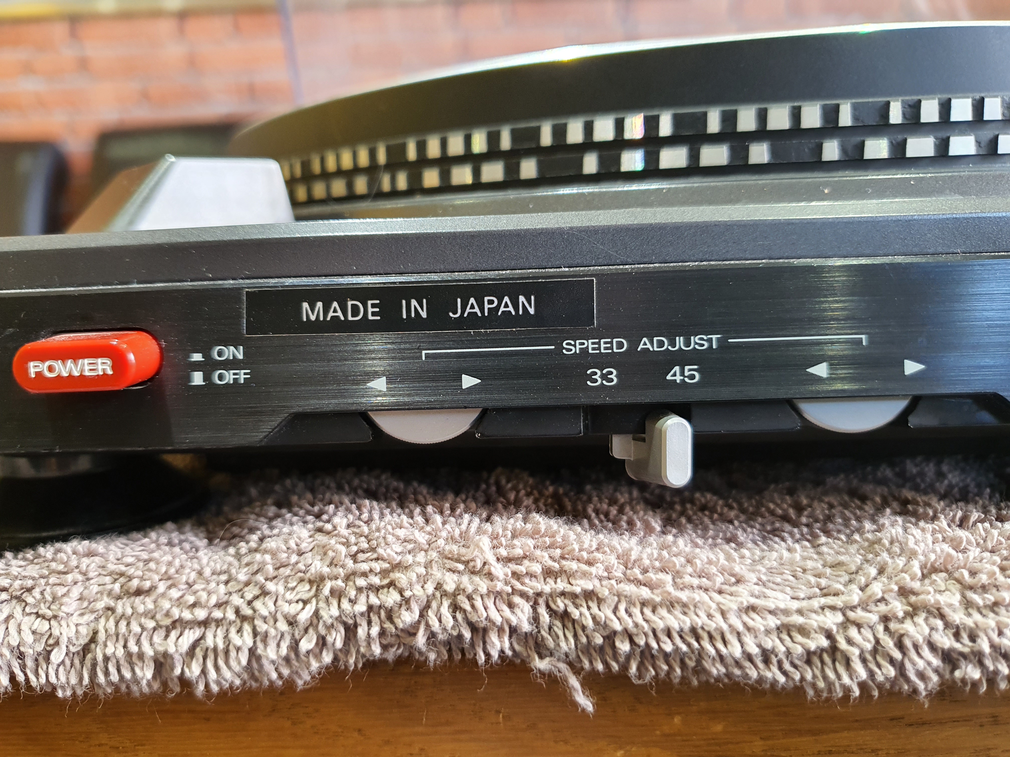

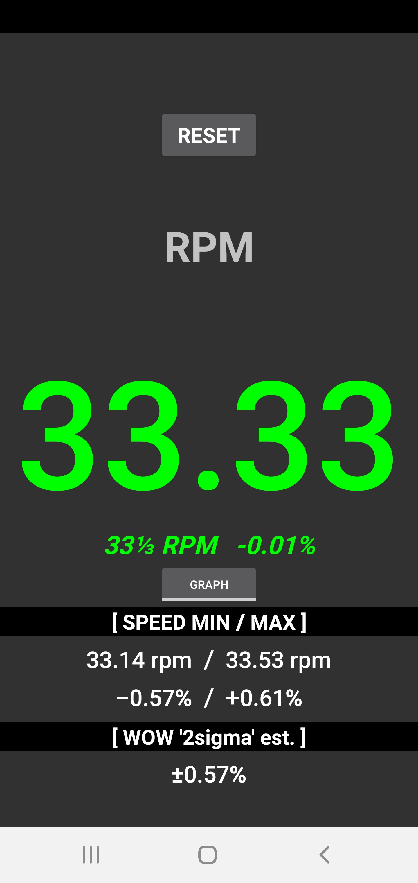

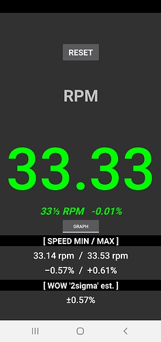

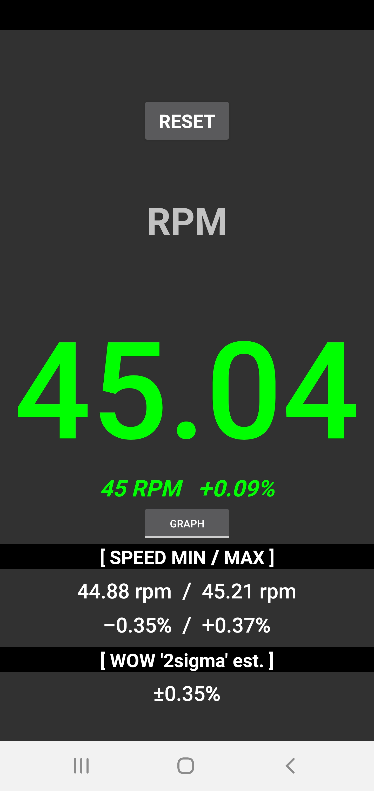

I started looking at speed adjustments as, although it runs correctly, all the adjustment is taken up at one end of the thumb wheels for each speed? I reckon that the thumb wheels should be more central with fine adjustments at each side of mid position.
So, I discovered two pots marked VR01 and VRO2 which actually control the speed.
By very carefully adjusting each in turn, with the thumb wheels set at mid position, i now have almost perfect speed at each setting!
I think its near enough! :smiley:
Going to have a look at the tone arm adjustments next to see if I can cure that issue!
How do you adjust those VR speed thingies Barrie?
Hi Roger, in the middle of each one is a tiny slot for a screwdriver? They are ‘fixed’ at the factory to correct speed then a blob of paint on each to keep it locked. By scratching the paint blob off, it frees the pot for adjustment. By careful steps, I got the speeds near perfect! Thumbwheels are now more or less equidistant from each end etc :+1:
Thanks Barrie, I did wonder about the slots but didn’t want to jump to conclusions! :+1:
