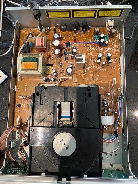

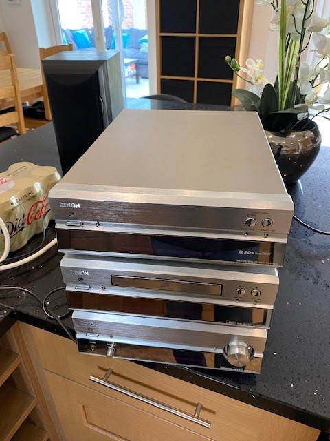

Having rad many of these posts for some time, I finally decided (well my wife decided) that the CD player in the lounge needed fixing as it was not working. So I took it apart and realised that when accepting the CD into the drive, it was not loading properly. So I took it apart a bit more and greased the loading mechanism and low and behold Success!! Gave it a clean, put it back together and we can now listen to CD’s in the lounge again…
I like those DENON midi systems with the mirror fronts, nice system :+1:
Thanks, I must have bought it all in about 1998 or so - from memory it was about £900 with the Mission speakers…however not used it (apart from playing Xmas CD’s) for a long time, since we got an Amazon Alexa system…
We have about 400 CD’s, but with music streaming and Amazon, you do not really need them. However we have the music stuff in the kitchen and this system is in the lounge, so we might give it a go again…
