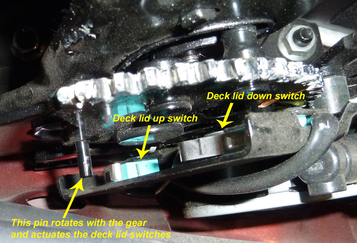

There are a number of micro switches involved in checking the roofs movement, it’s possible one of these has got dust on it and is sticking. Open the deck and switch the ignition off before the main roof moves and leave it off. when standing along side the drivers side of the car look below the main roof and look for a couple of green/blue micro switches… if you have some brake or carb aerosol cleaner, try a quick blast to clean them. There is another micro switch up behind the release handle cover which is telling the roof control module if the handle is open or closed. I’ve read that this can become misaligned. I’m sure there are two more but can’t remember where and I’m miles from my car so can’t check!

If none of that has any effect, I would then take a good look at the microswitches - they are located on the side and detect the motion of the deck as well as the raising and lowering of the roof, as well as in the latch. Also ensure the latch is closing fully and the release button is clicking back out when closed.

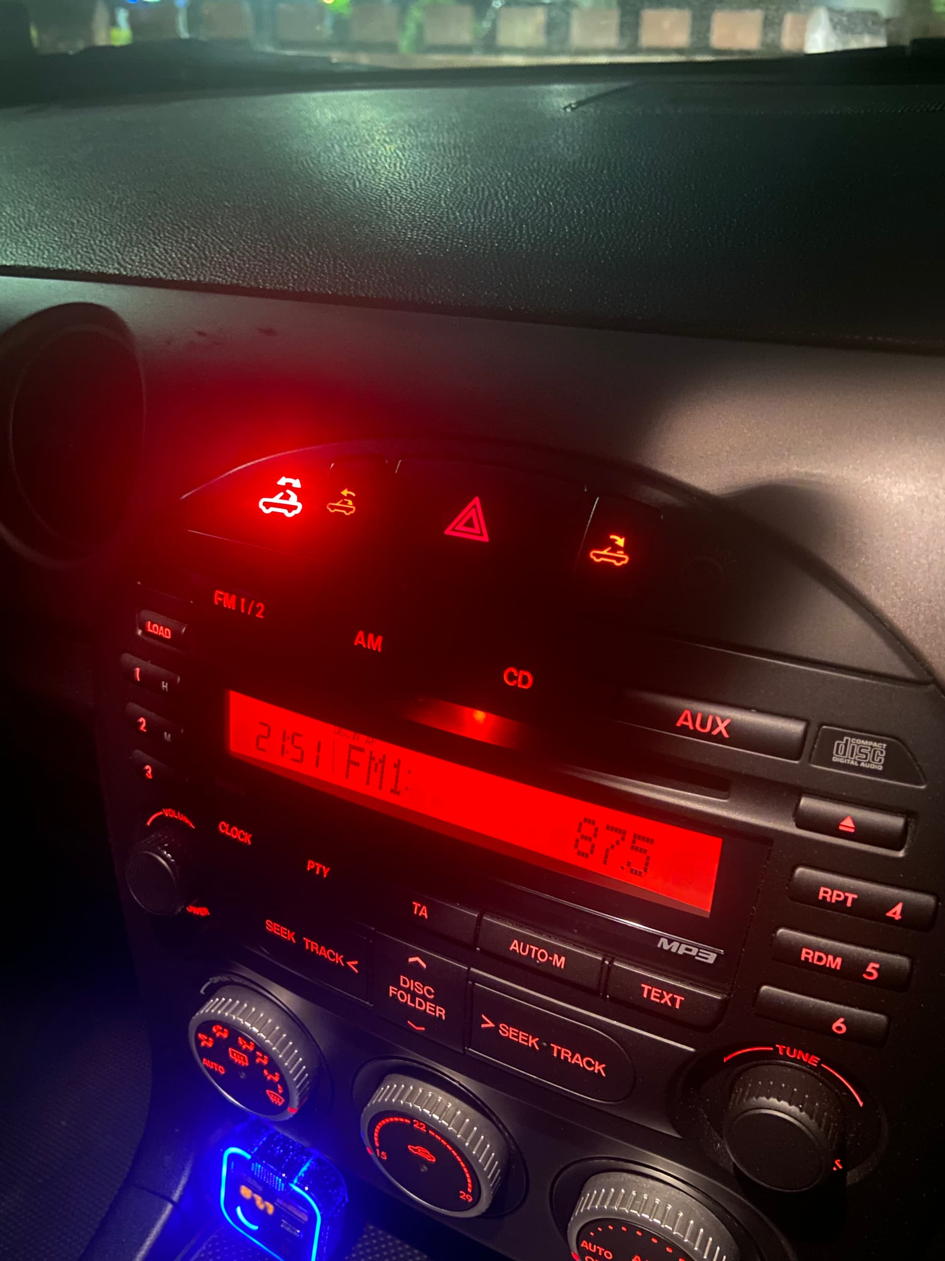

I tried what you suggested unfortunately it has not worked. I was hopful because about 5 to 6 seconds into holding the window buttons down. There was a click it also clicked 5 to 6 seconds into holding the both window buttons up. But unfortunately, I still have the same problem. At no point do I get a long bleep to confirm that the roof operation is complete.
I also made sure that the boot was closed 100% and it was however I have noticed that the button to release the boot that is next to the bonnet release is not working. I wonder if this could be anything to do with it.
I have attached a picture of the roof switches.

You should definitely check the microswitches. With the deck open but before the roof starts to move, they are pretty easy to identify. From memory there is a switch which confirms the deck is fully open, a switch which then detects the movement of the roof as it lowers into the space or rises out of the space, then the first switch confirms the deck has closed. Assuming your roof is still going up and down, my guess would be the deck switch is not properly detecting that the deck has closed and the cycle is complete.
I’m kind of guessing a bit, on my model I’m pretty sure you need to finish whichever sequence is underway before you can activate the opposite direction. I can’t start a close cycle until the open cycle has fully completed (I think).
Another long shot as well, but if you can’t easily spot any glaring issues with the microswitches, maybe try giving the deck a gentle nudge from behind pushing towards the front. Perhaps it’s just not travelling a couple of mm far enough and that’s enough for the system to throw a hissy fit :man_shrugging:

I can’t remember hundred percent if when pressing the button to open the catch to release the roof a red light came on button. I might be wrong on that one, but there is no light when the button is pressed to release the catch.

When I release the latch one of the icons lights solid red on the dashboard to indicate that the latch is open (off the top of my head I think it’s the roof closing icon). During an open or close operation, the relevant icon flashes until the cycle has finished and the long beep has sounded. When closing, after the beep the closing icon stops flashing and remains solid red until the latch is closed.
I’m pretty convinced that your issue lies with the microswitch that detects the deck is closed. The fact you are not getting the long confirmation beep confirms that the system hasn’t completed the cycle (or doesn’t realise it has), so the warning beeps are to tell you it thinks the roof cycle hasn’t finished.
