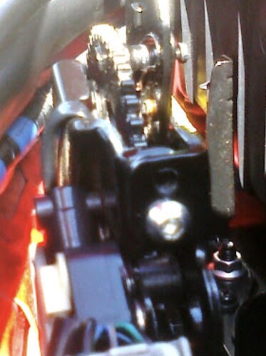

Borrowed the photo from across the pond. Hope no one minds👍
Tighten these dome headed bolts and see if that stops the noise.
Is the deck sitting down squarely?
ok I only see one from that picture and it looks like an Allen wrench?
It is. One both side, needs the deck up and back.
The driver side one was not tight. I’ve tightened it and the rattling as gone. I have done another video so you can see and also the alignment of the deck seems fine.
