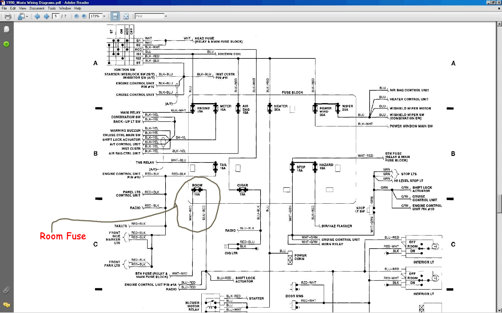

The room fuse is the permanent 12v supply (i.e. does not need the key in the ignition) that the interior lights uses.
Also on this circuit is the permanent 12v supply to the stereo to keep the clock and your radio presets stored.
If this is blowing, I’d start with the stereo to make sure this is not earthing somewhere.

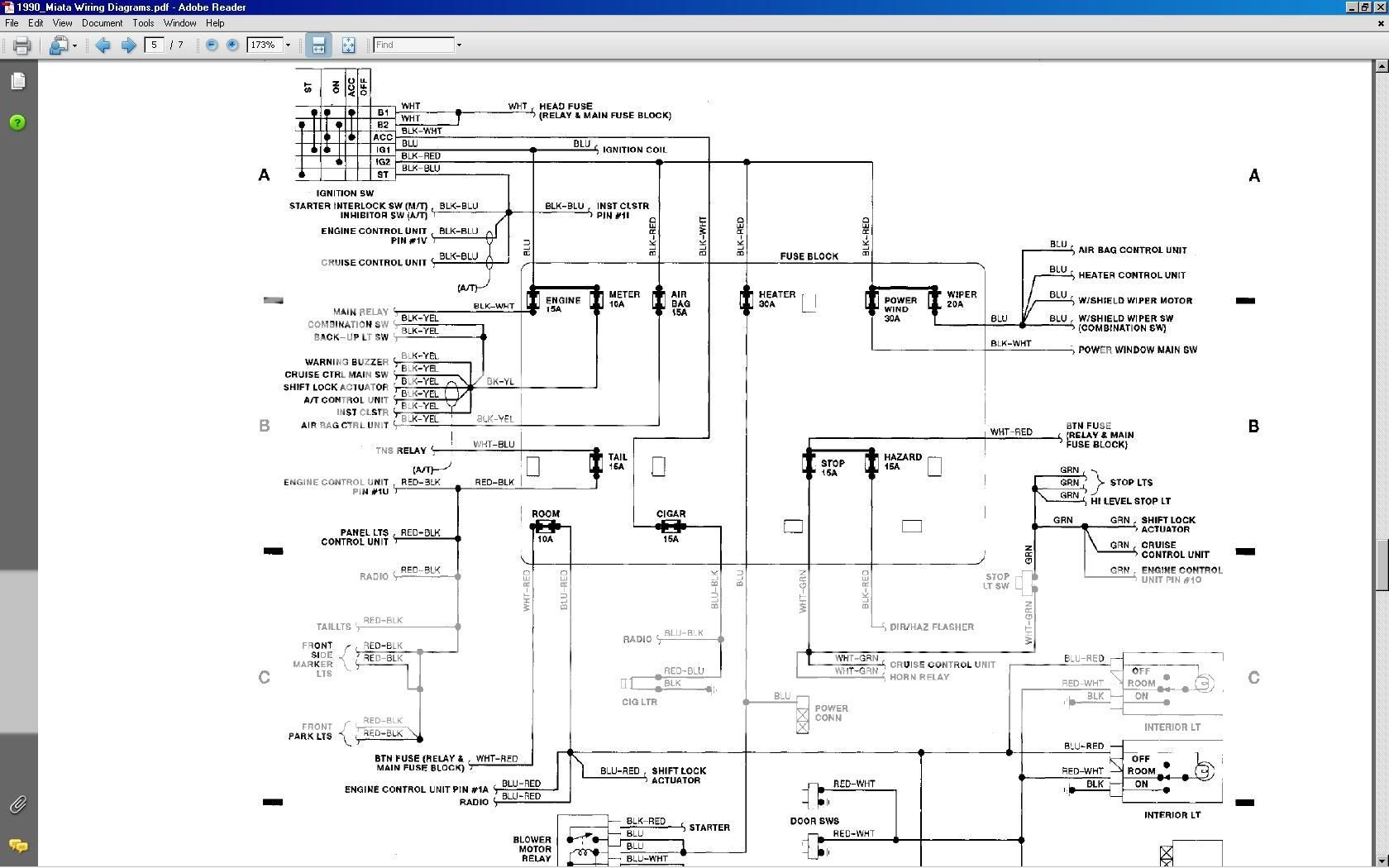

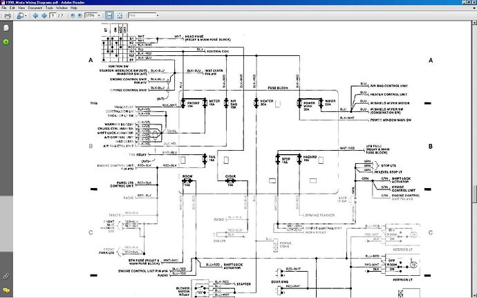

The circuit diagram shows a feed to the ecu from the room switch, but I have no idea what it does [bottom left hand corner]

That section of the circuit diagram does not show the “Room Fuse” so it is not possible to interpret what influence the fuse may have on that circuit.

 I think by far the easiest way to do this is going to be to pull the room fuse and see if mine starts.<o:p></o:p>

That “tosh” came from Mazda’s circuit diagram, it seemed fair to say cut power to the ECU and the car won’t start.
