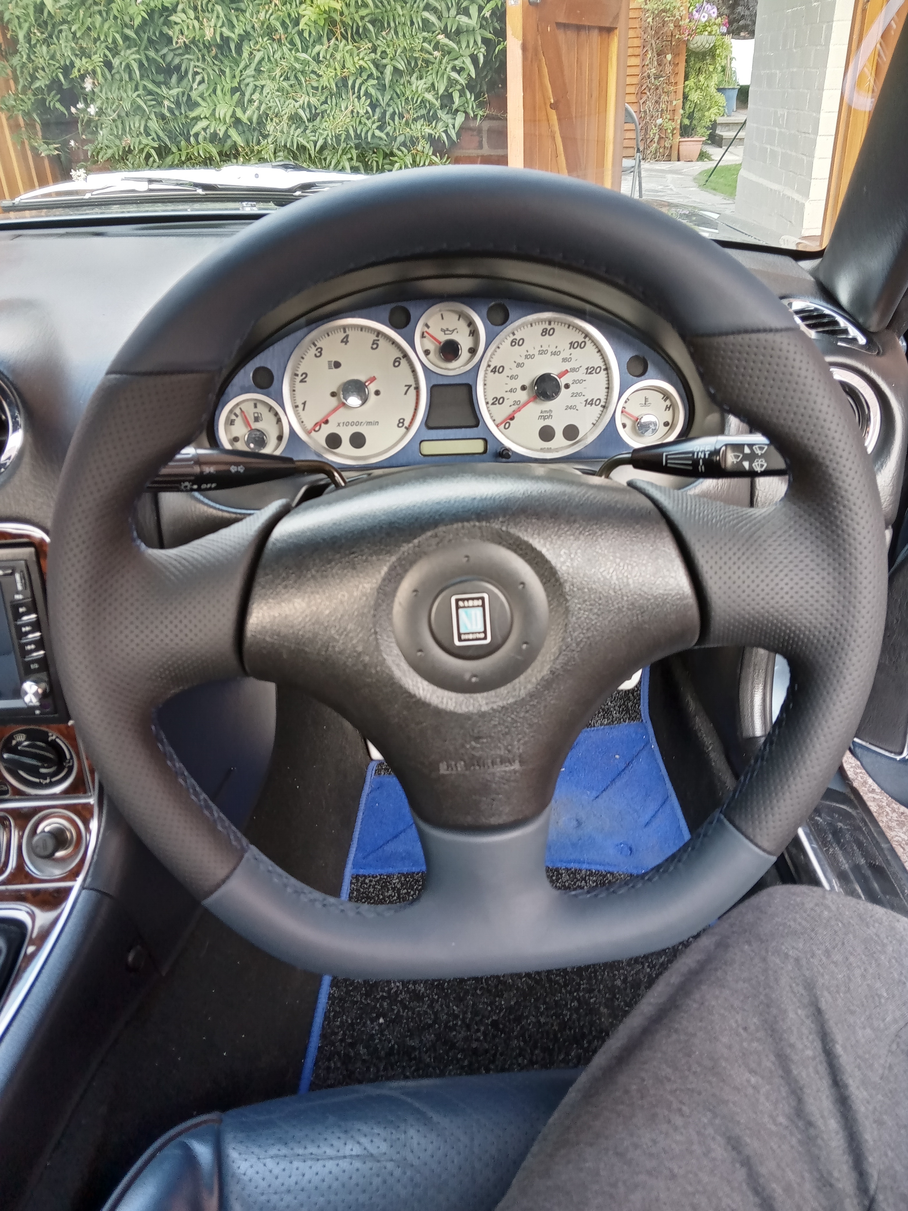

Coincidentally I got mine back from Royal today & very pleased with it I am too. He seems to be able to make pretty much what you want really. I asked for flat bottom modification, perforated black leather with thumb grips on sides, smooth blue leather top & bottom with blue stitching & 2mm thicker overall. It took 3 weeks all in which was a week longer than normal as he had to order the blue in.
I just have to figure out how to de-shine the old center hub now though as it looks a bit out of place. Any tips on this welcome.
Sorry I can’t offer any help with MK3 as mine is a 2.5.
Here’s mine …:white_check_mark::white_check_mark::white_check_mark:

Slightly thicker, printed leather top and bottom, perforated leather sides, black stitching.
I’ve got red stitching with perforated side pieces and thumb grips, smooth top and bottom of the wheel.
Can I ask if anyone knows, I would quite like a flat bottomed steering wheel, will they do a flat for round exchange?
You send in your standard wheel and they turn it into a flat bottom one.
Barrie (Bettabuilda) will give you the info, he’s had his done this way.:+1:
Yes, they will do whatever you need. Very clever actually, the overall diameter remains the same? It gets shaved at the lower end and built up to create the appearance :+1: That’s two I’ve had done with flat bottoms and each time, their wheels used and then swapped. Cannot fault them although Jack can be a bit tardy with responses but worth the wait definitely :nerd_face:
Here’s ours. No flat bottom, just 2mm thicker with thumb grips. Red leather was supplied by interior trimmers so it matched.
