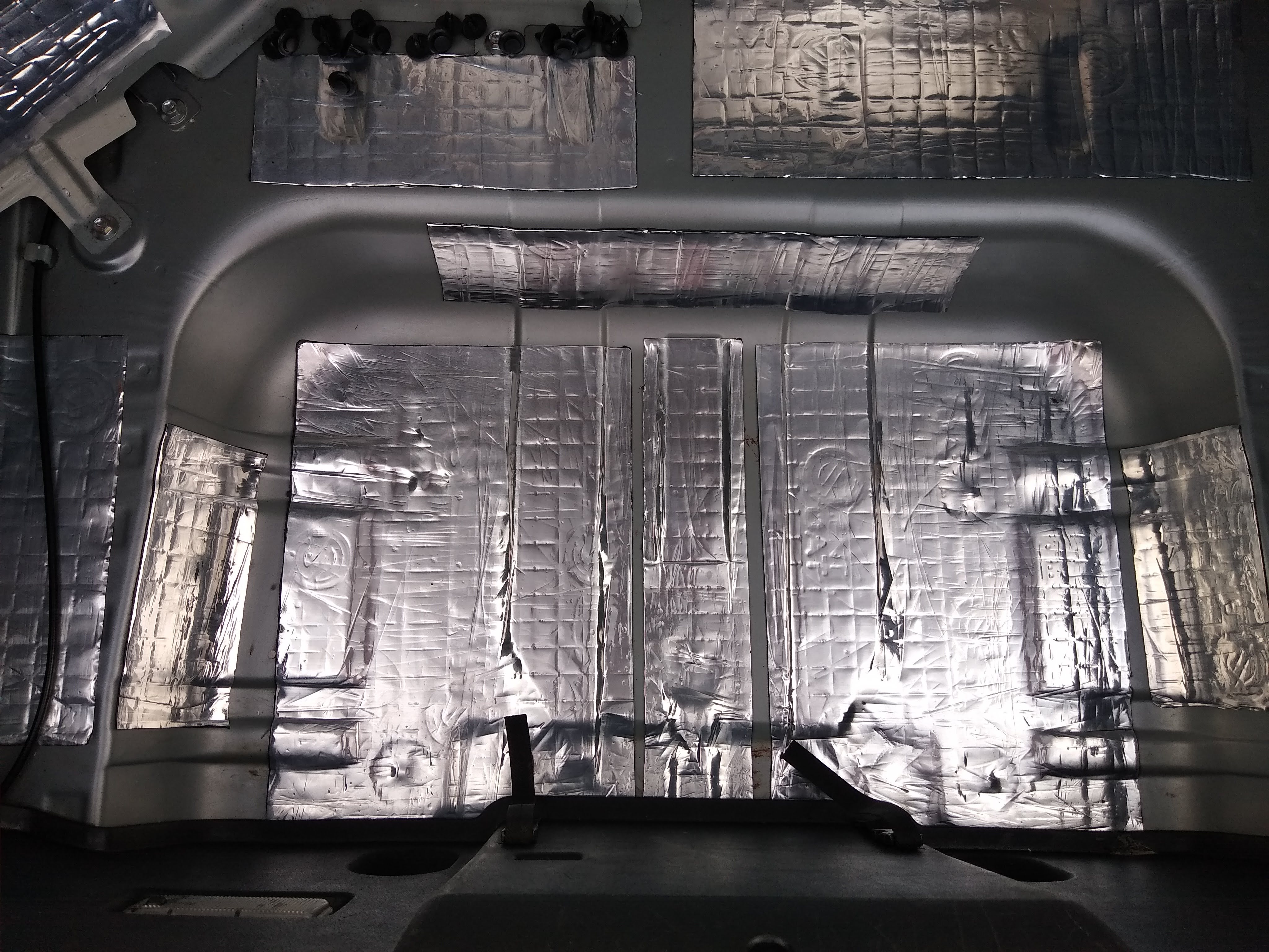

So I put a Japspeed rear box on the back of my 5, and it is a bit on the boomy side, so I got some silent coat (£25 for a pack of 8 sheets and a roller), and the results are fantastic, what a difference it makes, I can now hear the exhaust and the engine, the resonance has been dulled down loads and I am pretty happy with the results. I also stuffed some old towels into the cavities either side for good measure. Before I did that I blocked off the sound tube too. This car is coming along nicely!
Here are some pics…

The boot floor is amazingly resonant as standard.
Yep have done mine too. :+1:
+1 for Silent Coat in NC boot a couple of years ago, just on the tingy bits - still saving grams
I later added some more to the well.
I remember now, this panel made the biggest difference.

Did my boot a couple of years ago, and as the interior was out did that too. Made all the difference. Now a nice sound from exhaust, but even better when the stereo is on only music.
