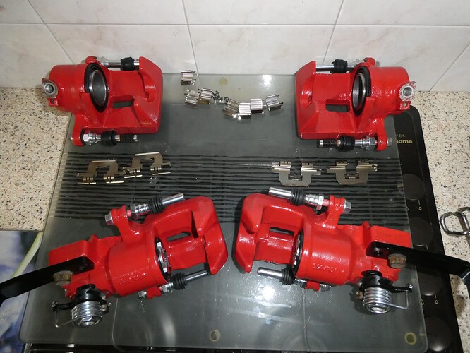

Not long after I got mine - I had the same - one rear and one front was getting very hot.
I ended up doing a full rebuild of all 4 calipers - they are excellent now.
