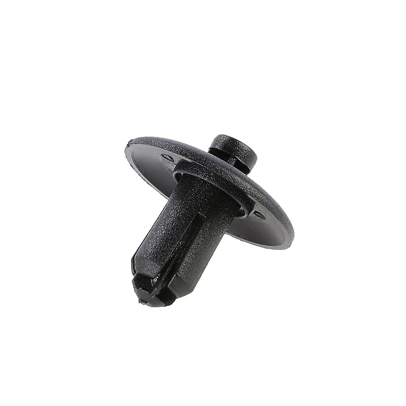

I deleted the plinth on my ND but found that the top of the grill has plastic thinner than a pop bottle so used body panel clips as rawlplugs and some long metal screws into them.

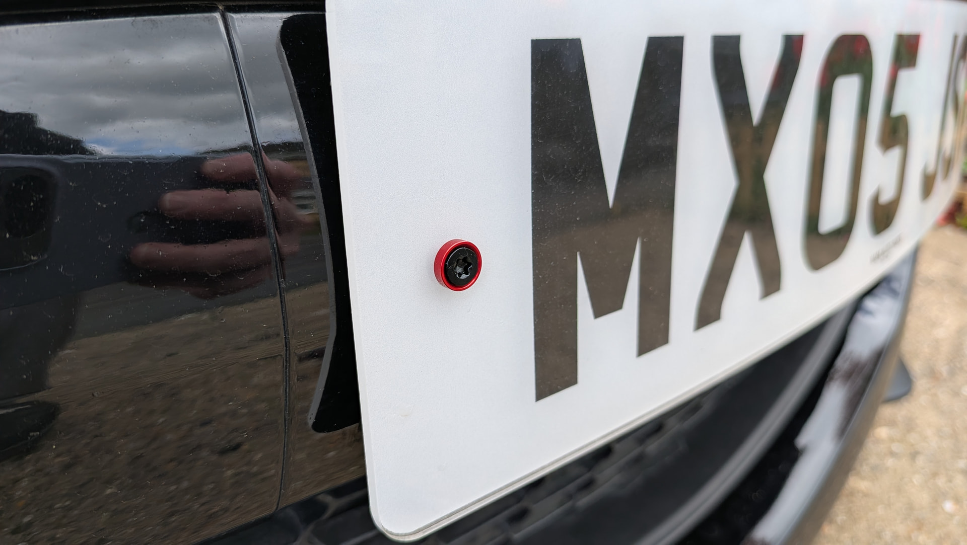

Swapped out the nasty screws/black caps with black torx screws and red dished washers to match the car scheme better :smiley:
