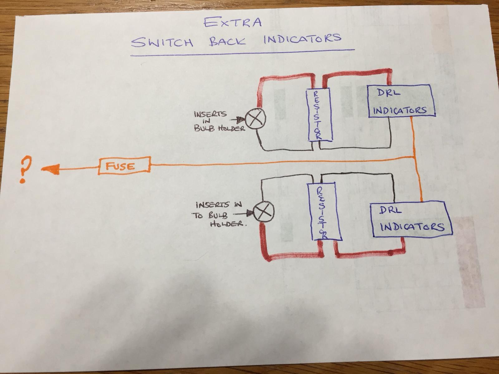

I think this might help…….
ERIC my mk3.5 metropolitan grey sport tech……the story so far !!
check this out …

Took me a while to get to the DLR lights bit on his car, he has been busy on it?!!
Interesting you tube video
