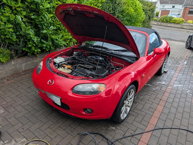

Now here we are trying to “properly” diagnose the issue. Here are the steps we have taken.
1: compression test and top of piston visual inspection . Cylinders 1,3 and 4. 178psi was the lowest and 198psi was the highest.
Cylinder number 2 would spike to 140psi but quickly lose compression.
Using an endoscope. We looked down the plug hole. Piston 2 is solid. No cracks, nothing that tells us a valve has hit the piston. Everything looks clean. Happy times? So far…
2: we removed the rocker cover to check the valve lifters. On cylinder 2, the exhaust valve lifter closest to cylinder 1 was significantly softer than the rest of the lifters. This is with the engine turned over so the valve is closed. My dad knows his stuff about cars but, he has never worked on a car with hydraulic lifters so he/we don’t know if this is normal? The way I see it, if one is different to the rest of the 23 valves then something is wrong. Could this be the knocking/loud rattle issue? When you use a screwdriver and listen when the engine is running, you can clearly hear something up on the exhaust of cylinder 2.
3: On Tuesday we will be borrowing our family members valve checker. This tool apparently puts pressure into the engine and you should be able to hear if the valves are leaking. This is something to do before removing the head so we know what to expect.
We currently have the rocker cover off, airbox, fuel rail, injectors and throttle body off. Exhaust manifold is still on, we want to soak the bolts first a few times before attempting this. We are almost ready to take the head off after we get this tool. So now I just want to ask around to see if anyone can give any suggestions on what it could be, what we could check and maybe any advice on removing the head? My dad is confident. But he’s used to older cars. Pre 80s. Anything engine related on a “modern” car is usually “screw this I’m getting someone else to do it”
