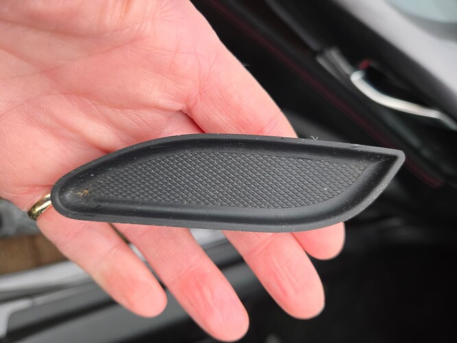

On a completely different subject, does anyone know where I can source the Interior door inlay for driver side, opposite shape to picture attached. I accidently hoovered it up at an IMO place yesterday. I didnt realise it was not fixed (Blonde moment :rofl:)

Those rubber inserts seem a tad expensive.
A pair on eBay, but might be worth asking the Mazda dealer for a price.
