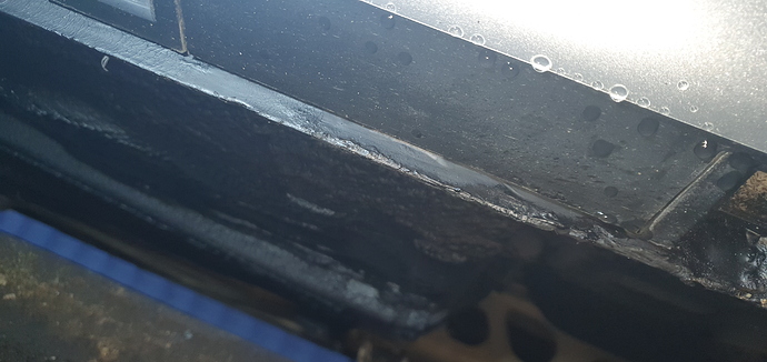

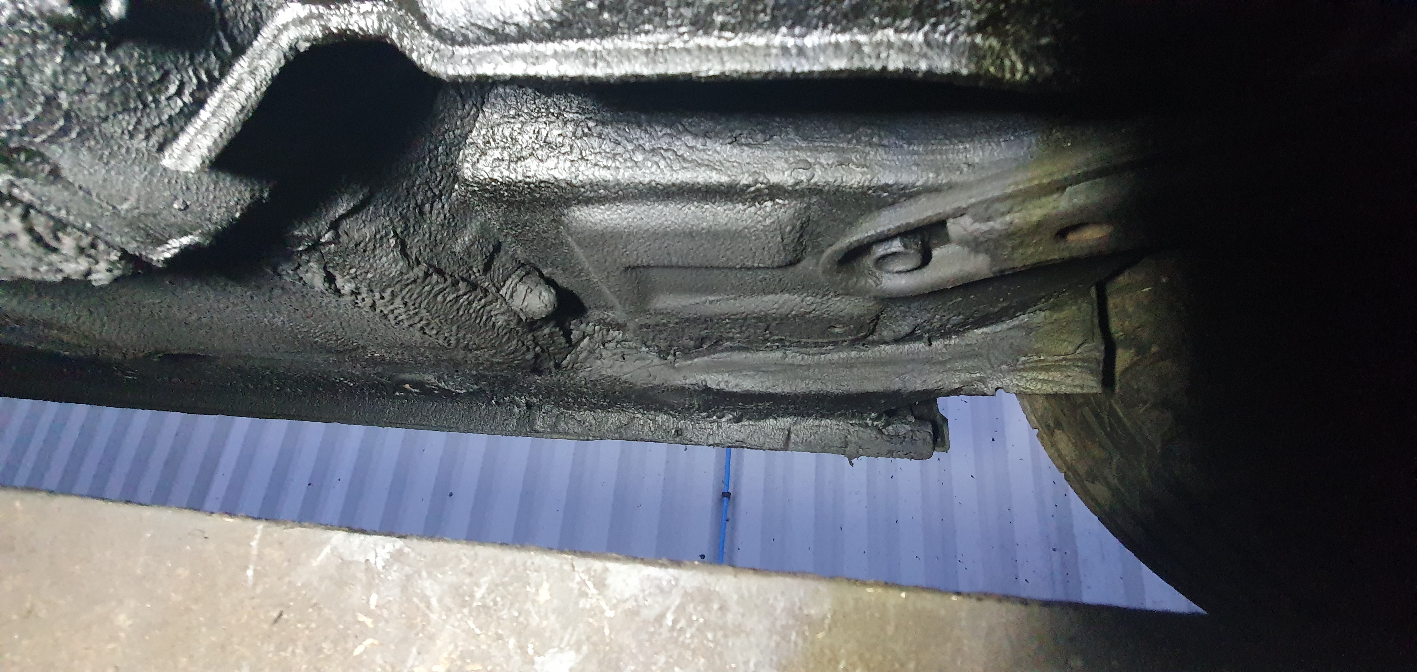

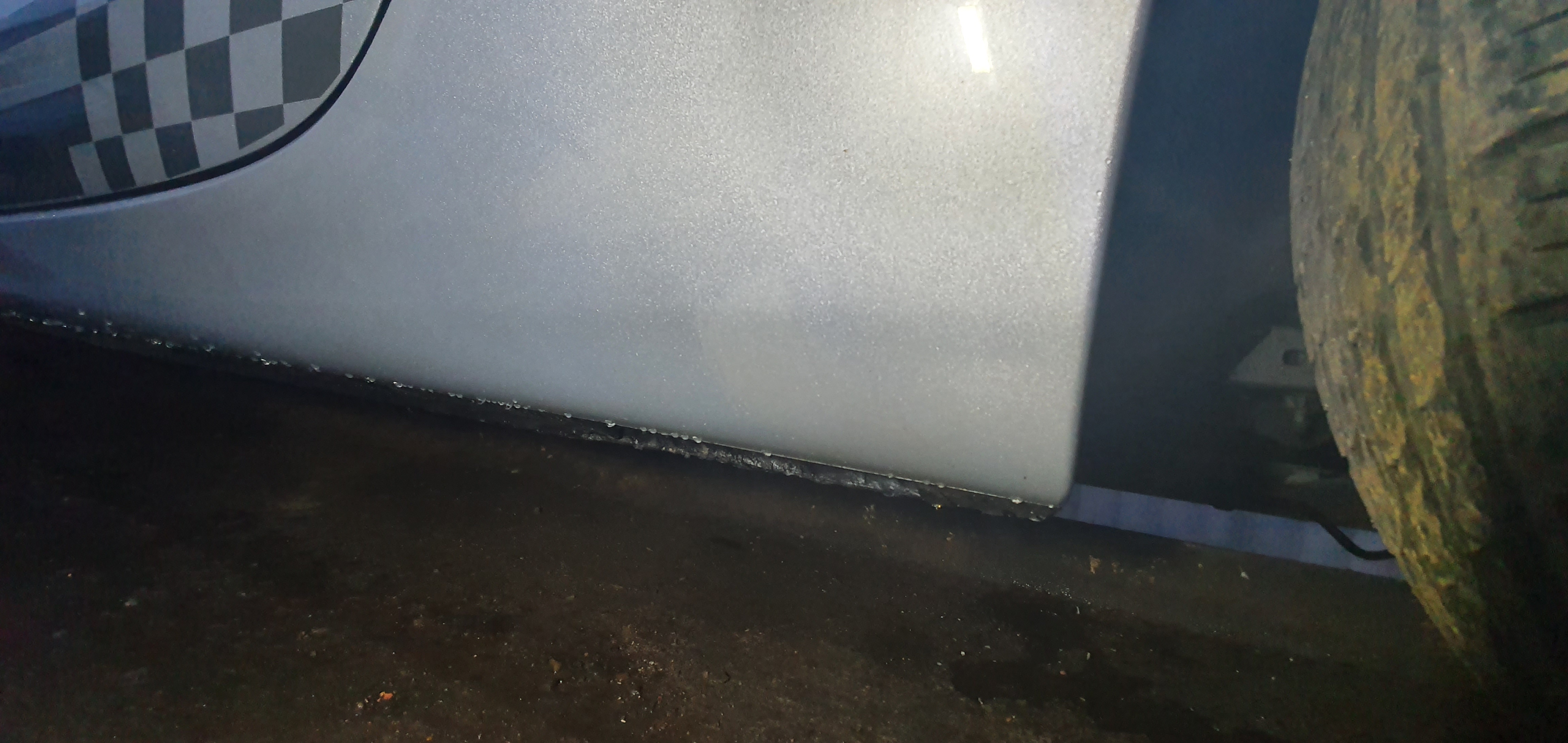

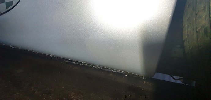

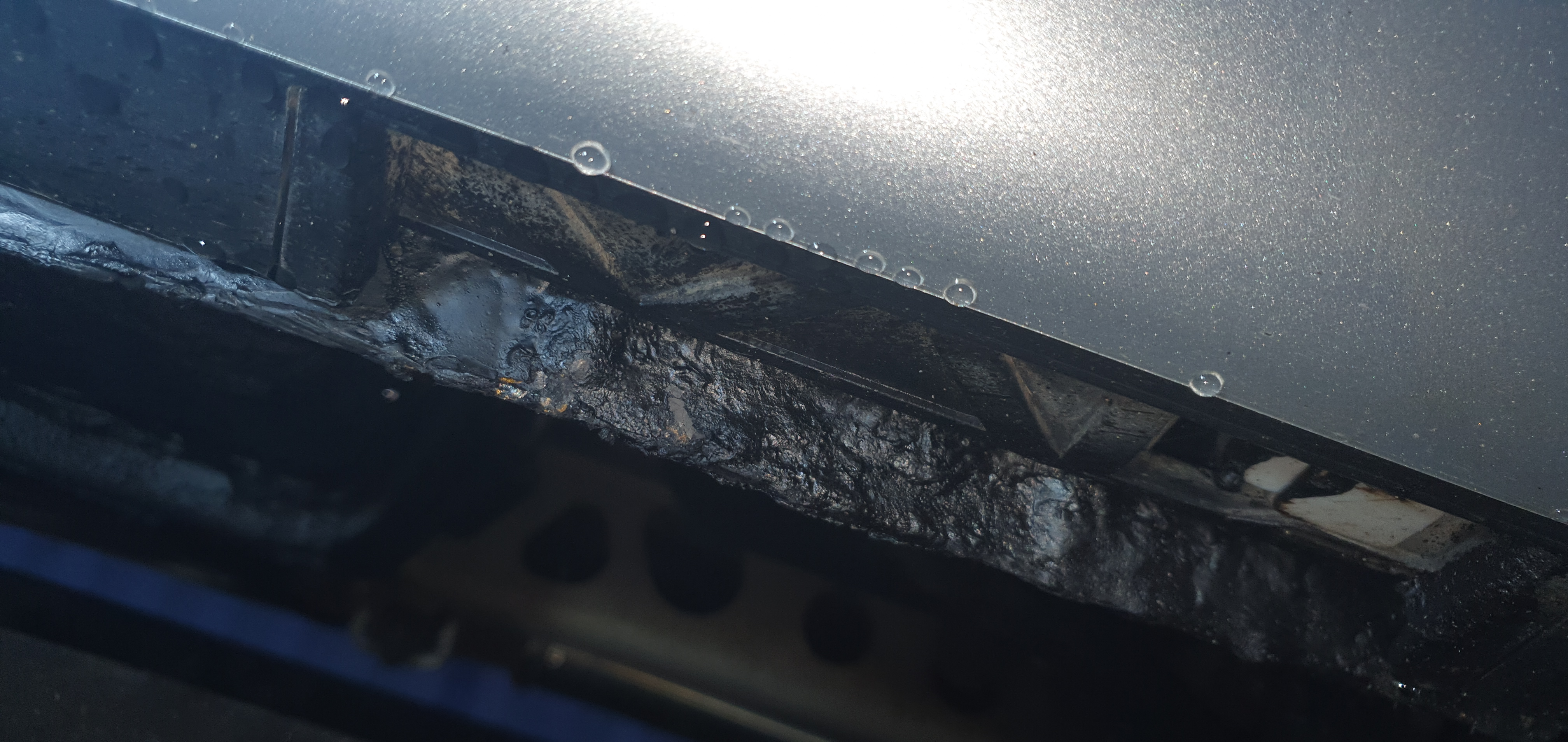

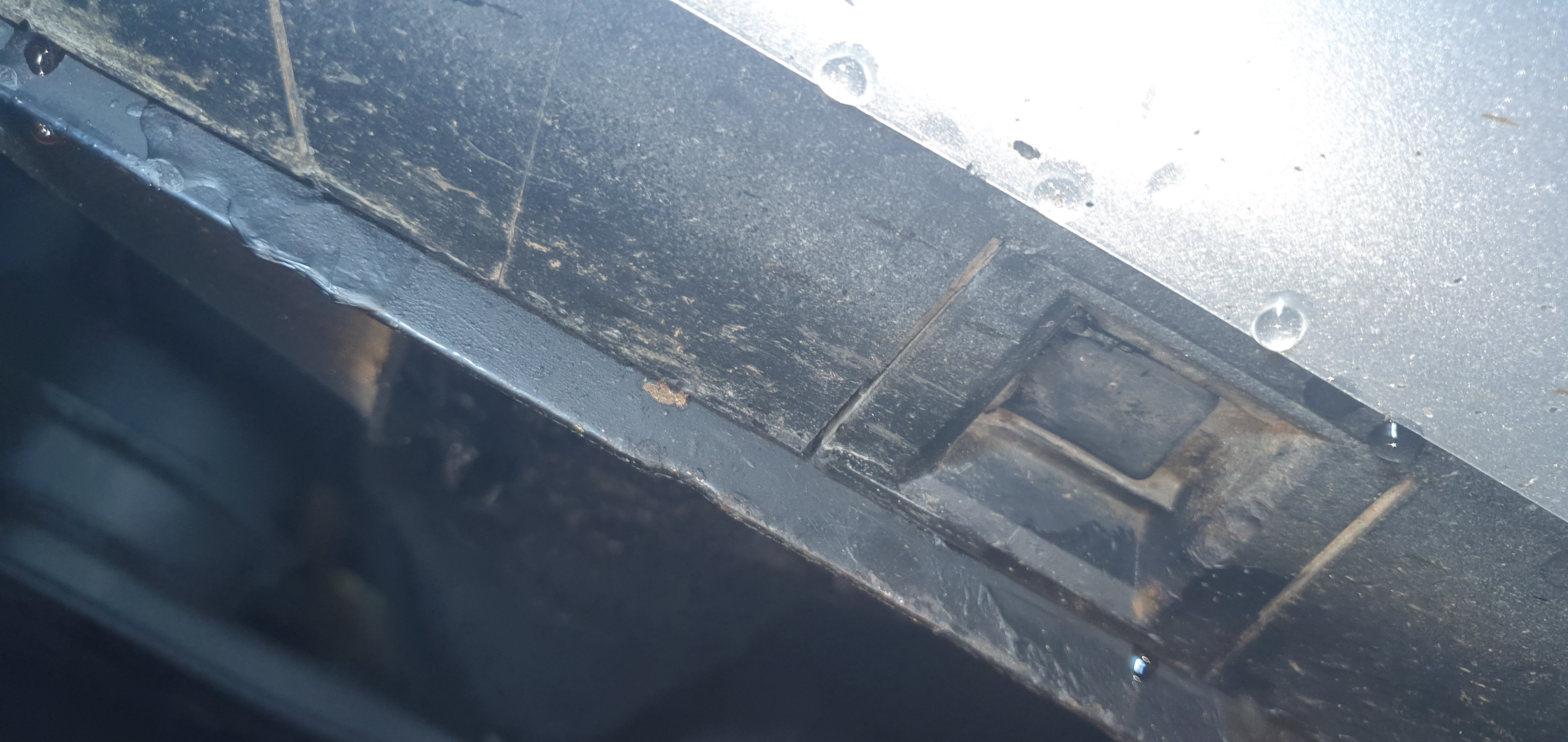

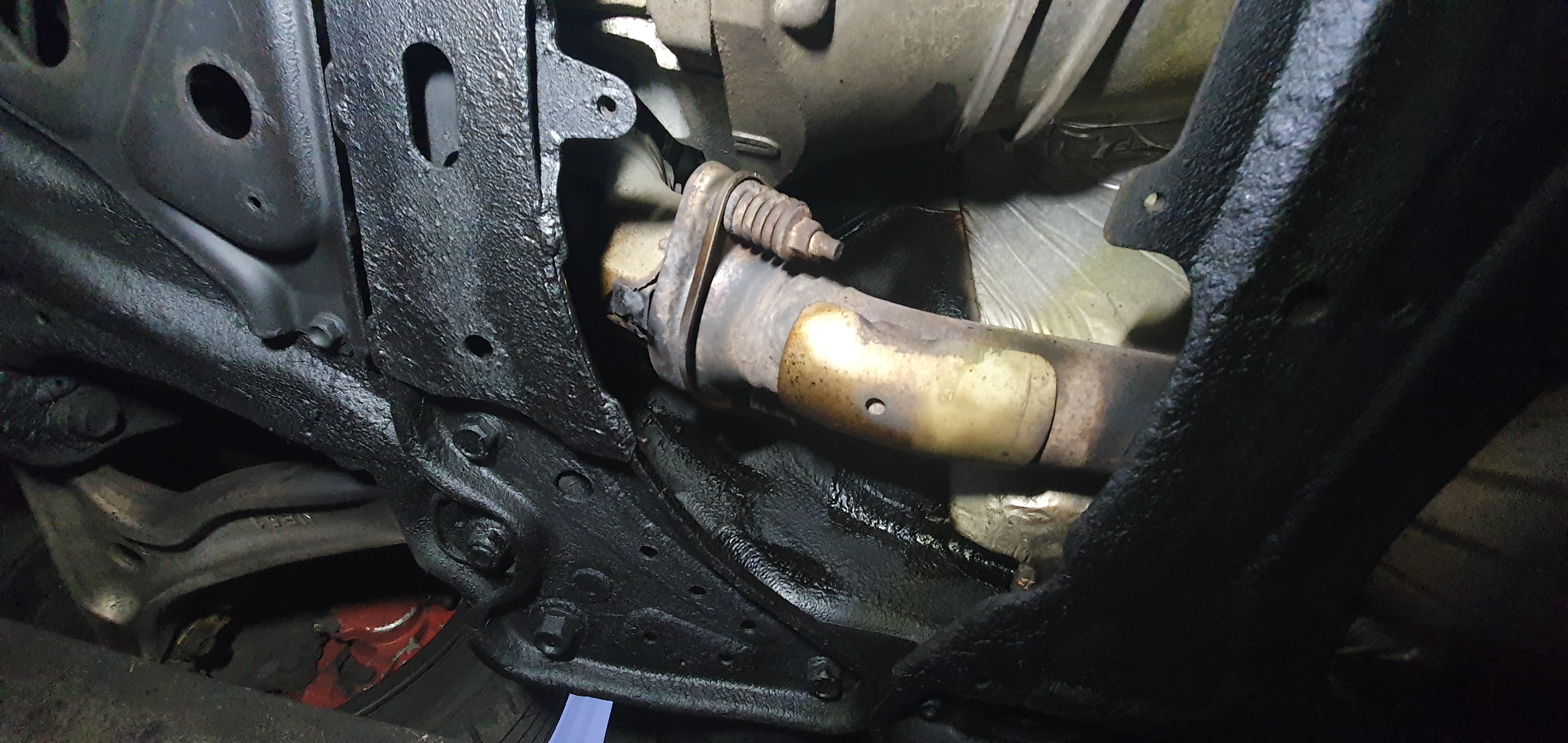

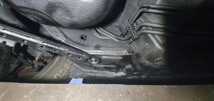

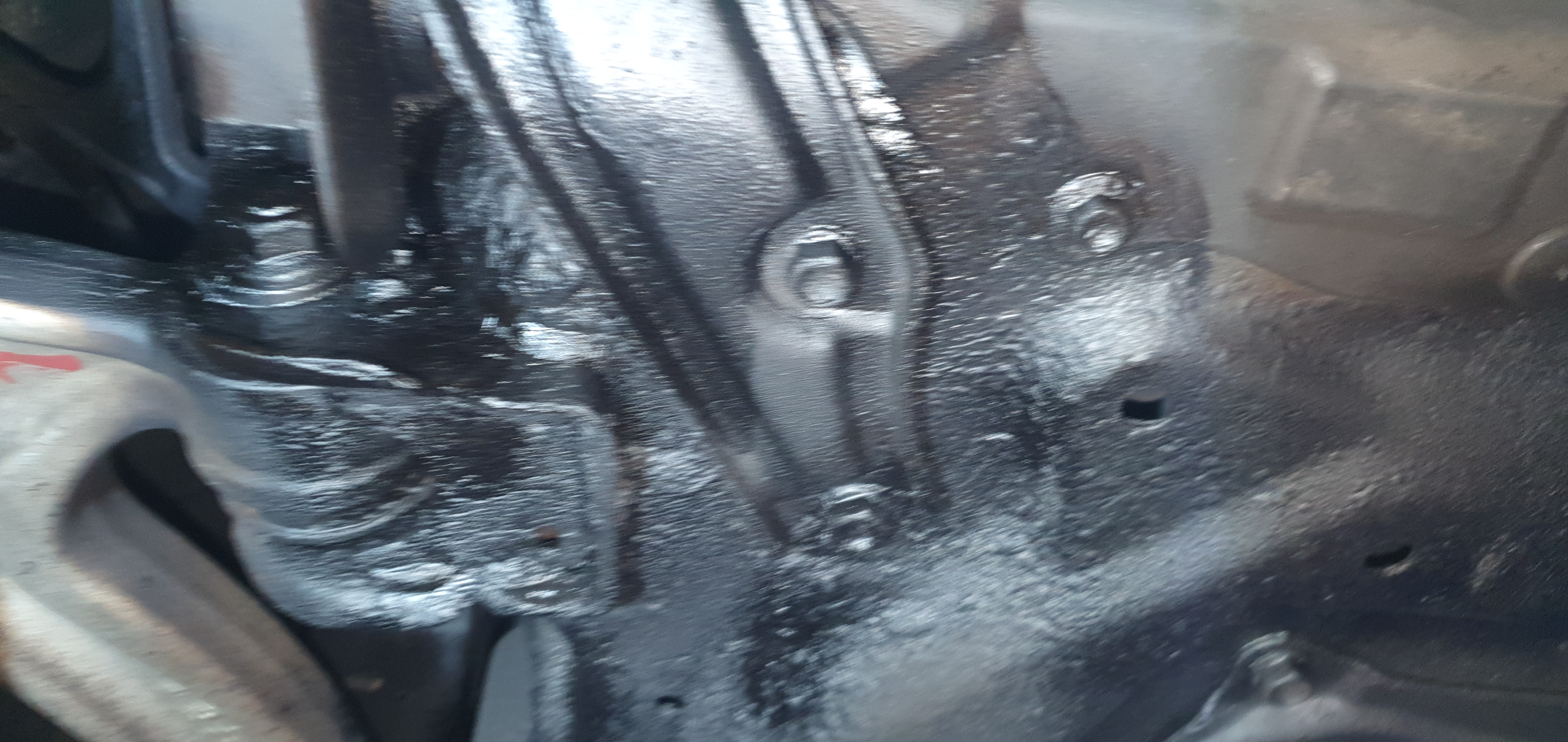

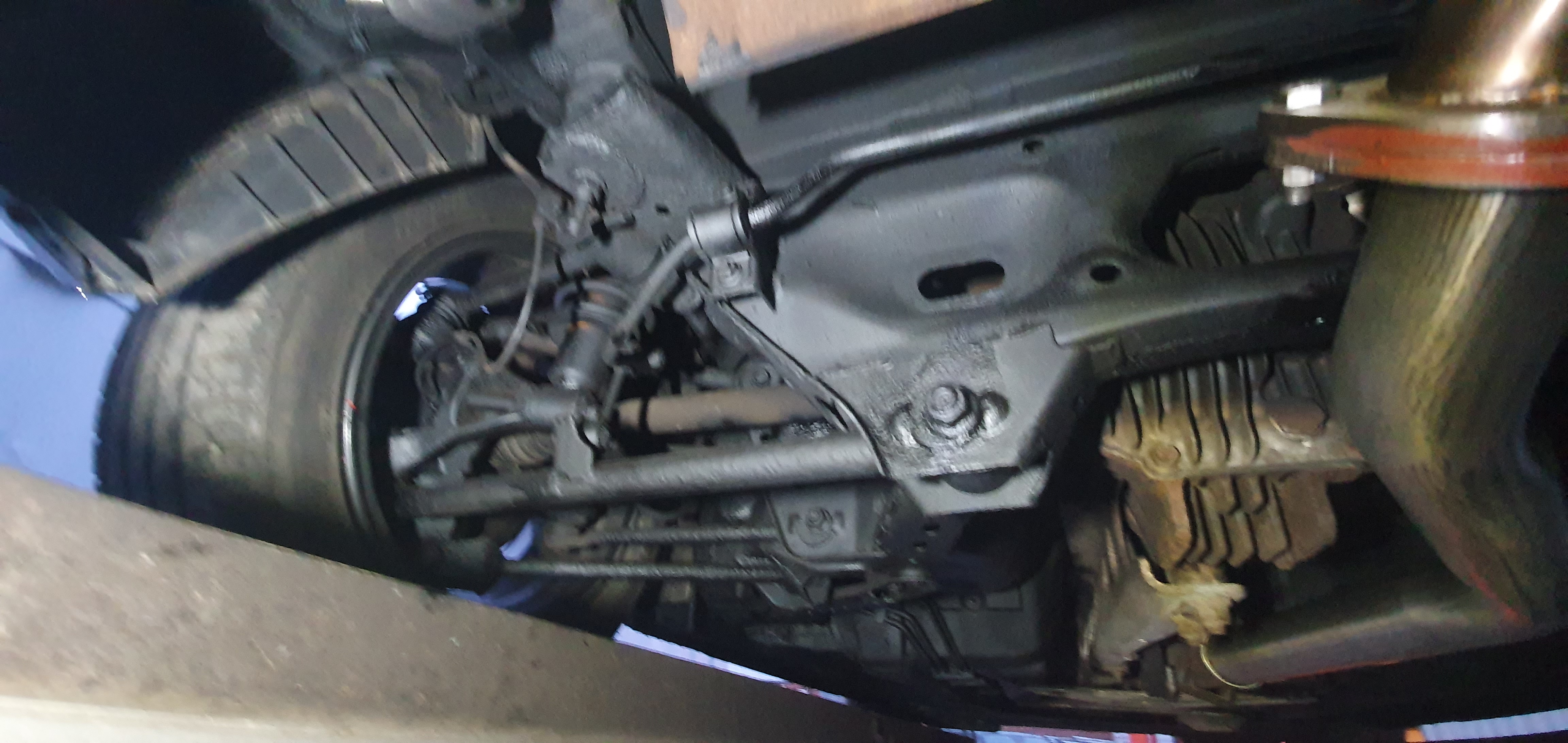

Well here is the end result of over a week’s work and £750 ex. VAT.

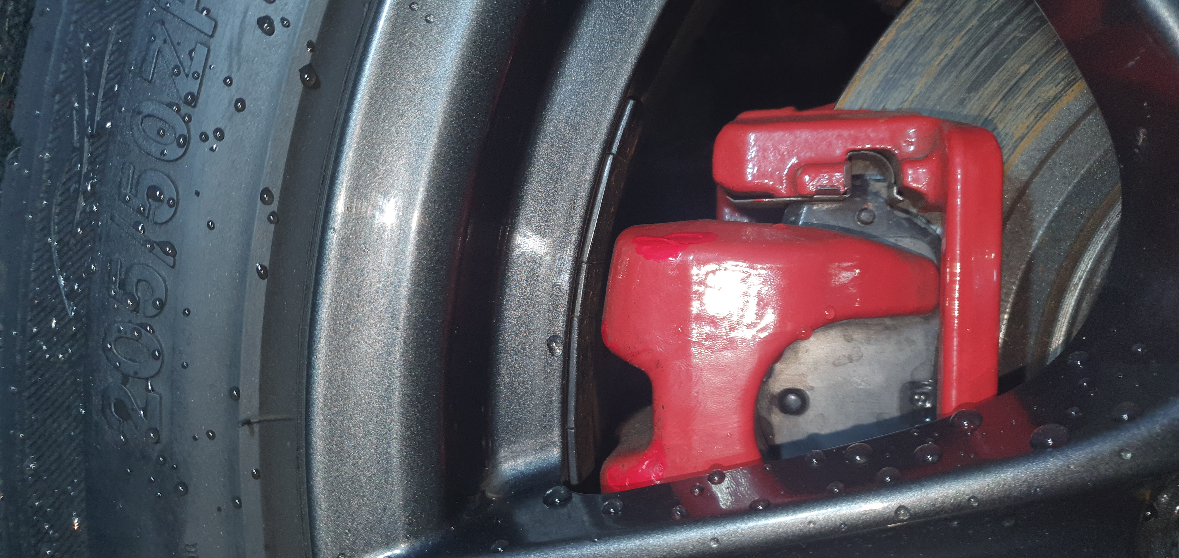

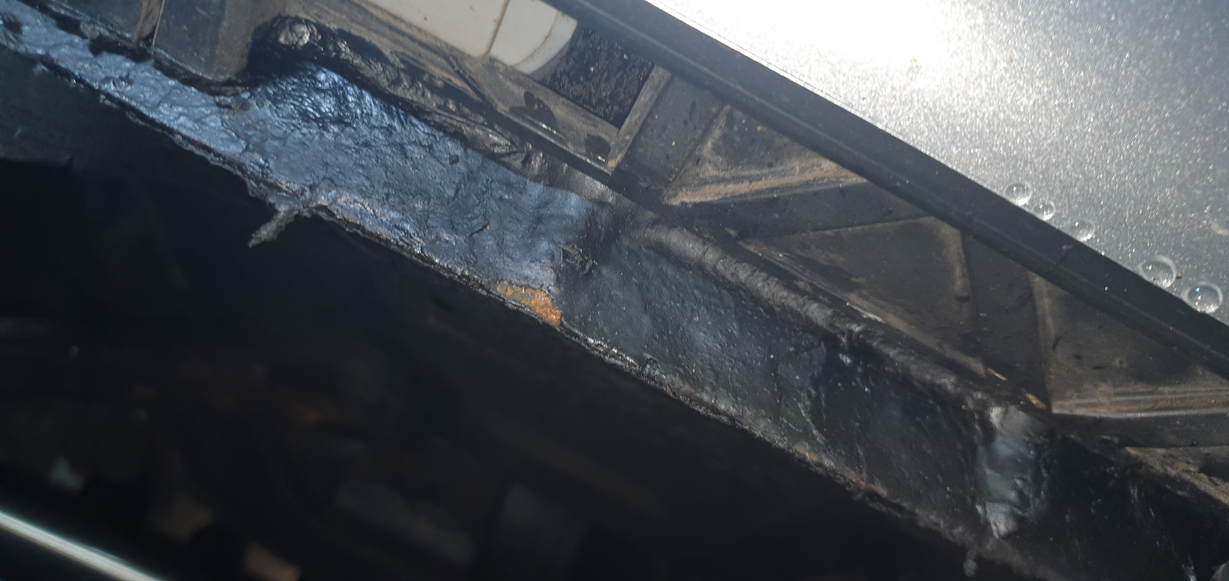

There’s still a lot of the waxoyl down the side skirts, the sills look like dog s***, and I’m eagerly looking forward to repainting my brake calipers that they oh so thoughtfully retouched in red paint that’s not even the same shade of red.
However the interior is clean, silver lining and all that :roll_eyes:
It was also blindingly obvious that someone has been driving my car while in their possession… When I collected it the car was up on the ramp as I requested so I could inspect it underneath. I would expect the engine to be luke-warm at best if it had been moved around the yard, however the gearbox was also quite warm/hot… I know for a fact that the back of the transmission at the furthest point away from the engine would not be warm unless the car had been driven, not at this time of year anyway.
Further to that when I went earlier on and I raised the issues above they said that the waxoyl on the bodywork will come off with traffic film remover and I asked for some of this so I can finish cleaning it up myself over the weekend… While I was waiting in the workshop for them find me some, the atmosphere with the workshop guys was particularly frosty where it usually isn’t, at all, and my overall impression of the workshop guys is that they actually do not give a s*** in any respect whatsoever and despite having had the car over a week have still failed to deliver what I expected as outlined in my message sent to them on Tuesday. Further to this they were pratting about in the workshop, one of them (the guy that worked on my car) was having a rant about his missus… Unprofessional is an understatement.
This isn’t so much about the poor workmanship anymore, it’s more about the fact that the owner(s) clearly haven’t held the moron in the workshop to account and looked over it themselves.
I haven’t bothered to argue with them about the price or anything, I’d rather take this as a lesson and go elsewhere in future - so yes, I said this would make or break my relationship with them… Here we are, I wish them all the best but I won’t be going back. Based on the quality of this work, they should wear a mask and a striped jumper.
So with that, can you all help me to find another good garage within 50 miles of West Yorkshire (WF post code) that actually do care and treat paying customers cars as they do their own, based on your own experiences?
I wish I’d have listened to the past experiences noted on here really, this is the first time they’ve let me down, and they’ve done that in spectacular fashion.
To the person that referred to this as a ‘witch hunt’… Take your car there and pay them your money… Report back and let me know if you feel the same afterwards :man_facepalming:
C’est la vie :fu:
Also forgot to add… My previously shiny yellow Bilstein’s are now black too. I’d have thought they’d mask them or something.

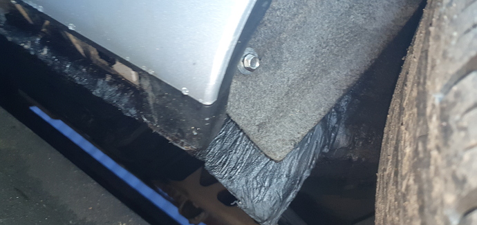

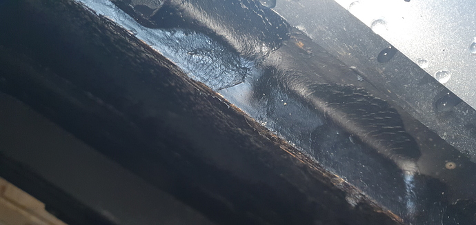

Can’t quite see but looks like they haven’t even done the sills properly.
I appreciate you just wanted the problem to go away, but personally I would have told them exactly what I thought, read recent reviews on your work and demanded a discount then paid and drove off into the sunset :sunrise:. But that’s just me.
I think any one who reads this post will form their own opinion and look elsewhere for the future. :slightly_smiling_face::+1:
Chris, That is still not good. When I spoke to JR Classics about treating the areas that MX5 City missed on my car they said that this was a familiar story and have had a number of cars through like this. I will have a better idea as to how much they charge for touching up and treating the missed areas in January. They also carryout welding and body repairs.
Certainly looks like the sill covers need to come back off and the bottom sill seam needs cleaning, derusting and treating. As I have said before i would also look behind the wheel arch liners, particularly up towards the door pillar and around the side indicator repeaters.

Chris, I forgot to mention that. Mine look like wasps !
To my eyes, it appears rust has been deliberately sealed in with “Black Nasty” of some sort.
In short, it’ll all erupt in no time…say 6 months to a year. Looks to me the sills need stripped, bare-metalled, repaired if required, and properly re-treated with converters. I’d be tempted to go inside the sill sections too tbh.
The diff has over spray as well, but the shocks cap it all for me. Utter disgrace.
Otherwise, Chris might as well have set fire to that 4 figure sum in his back garden.
It’s all so bad, it’s bizarre. A demented chimp on crack would have done better.

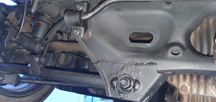

Yes I’m sure that’s not the product, never mind the procedure anyone wants blathering all over the underside of any vehicle,
Just looks like they’ve gone rouge with a old school shutz gun.
As for hiding all the alignment bolts and running gear under the stuff?
I’d be fuming as I’m sure anybody how has a clue would.

If you cannot get MX5 City to sort out the sills I would be tempted to redo them myself, as access should be reasonable and the job relatively easy to do. Having done them you will have more cause to be confident in the protection of your car.
