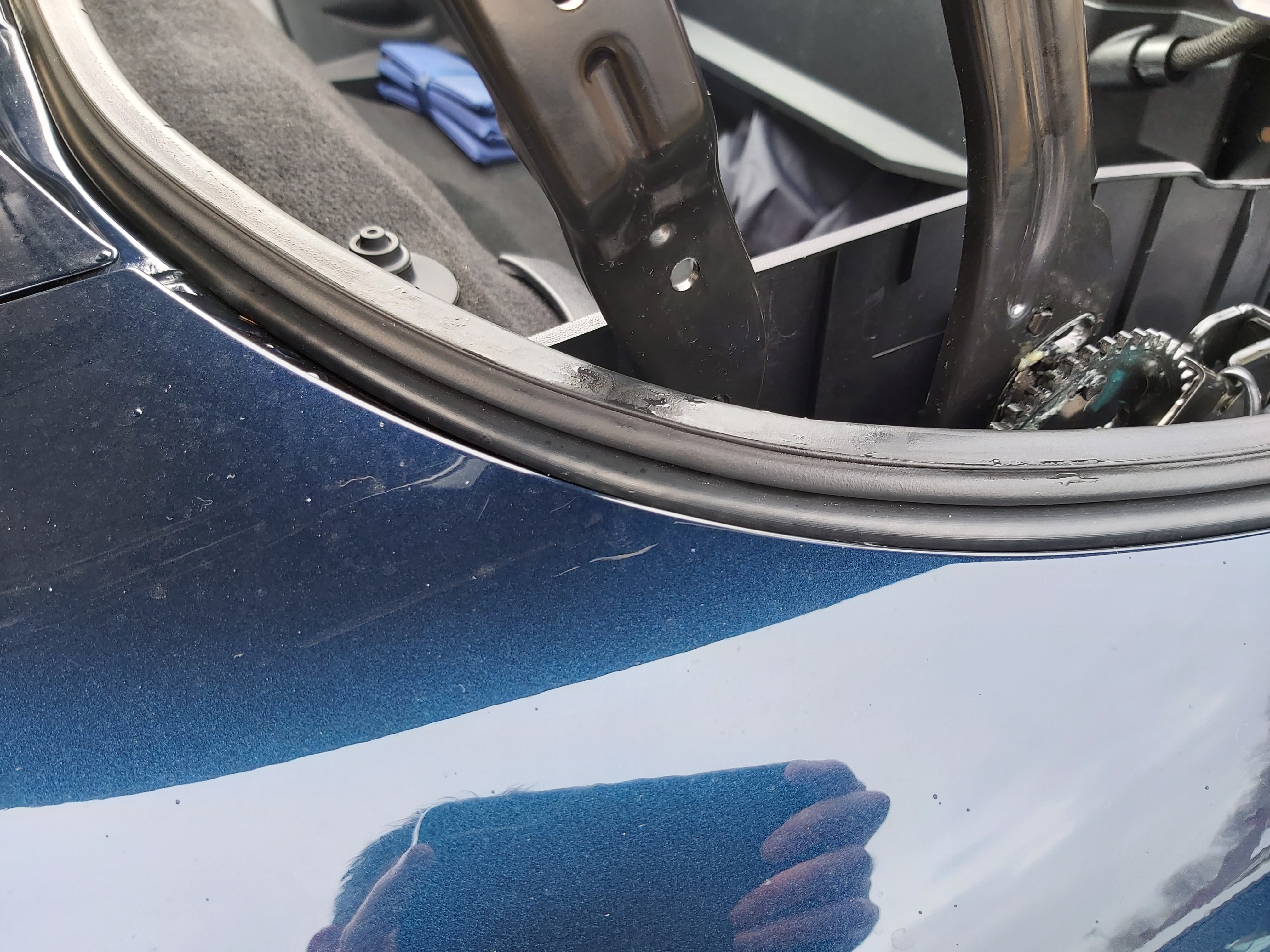

Looks like you have had a similar time to me lately luengonigel. I to had wet boot carpet so took the back of the car to bits sealed the aerial and where the wiring goes through the gromit into the boot as they were letting a little in . Done the high brake light ,just done scuttle gromits today. What you may find is if you have more problems empty all the boot plastics ,fold the roof down half way then take all the plastics and carpet out from the rear shelf . I noticed water coming in over the back two corners of the rubber seal in which the third brake light panel sits down on. This was when parking the car on a hill ,water would sit there then seep over the rubber then trickle down through inside into the boot . If you check that rubber seal I bet the corners will be flattened and the rest will be supple ,I adjusted the panel to squeeze down onto the rubber a fraction more . Just something to keep in mind if you have more issues .
Thanks for that. Interesting what you say as my car is parked on a hill outside all the time with the front pointing up the hill. Any chance that you can take a photo of where you are meaning please then that will complete the MX5 leak story in the one post…hopefully.
I’ll pull her out in the daylight tomorrow and take a couple pictures of where I mean . Thats what mine was parked facing up hill on my drive,I’ve since built a carport to keep it under,
Thanks again for that, will check. Doing the high level brake light seems to have sorted it after the last few nights rain but will keep checking.
Just ben to check the car, the boot is dry now. The inside of the windows was very wet. Partly raised the roof. And did indeed see that the the corners and then running on towards the back window were wet across the width of the seal. Not much water ingress to be seen in the well where the roof retracts into though.
This is the seal in the middle of the car showing a good seal.
This is the driver’s side at the back corner, you can see it’s wet across the full width as opposed to the photo above.
The seal further forward towards the back windscreen is dampish rather than wet as per the above photo.
Where it seems to sit or get in over the seal on those corners look down inside ( back towards the rear inner quarters it makes its way back i belief then eventually into the boot well. Underneath the brake light panel there are bump stops i adjusted them a little to make the panel pull down on the seal a bit more . Try that let me know how you get on . I think this is a area people have been missing

I too had this problem and also narrowed it down to the rubber seal upon which the upper brake light panel sits. However when I pulled the seal off the body I found spots of water and rust on the bodywork ridge the seal is attached to which is horizontal (not vertical like the in the boot). There was small amounts of silicone sealer which had broken down and was letting water through the tiny gap between the seal and the bodywork especially on the rear bends where water sits when parked on my sloping drive nose up.
I pulled the whole seal off apart from the ends which seem to form part of the drainage system then I applied black silicone sealer to the bodywork ridge all the way round then pushed the rubber seal back on.
This has cured my leaking boot completely after both hose pipe soaking and several heavy bouts of rain.
