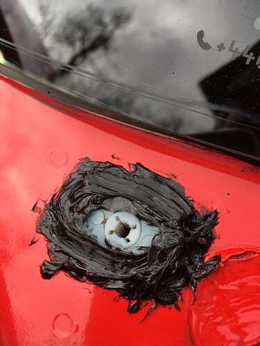

Removed the scuttle panels on Saturday so I could seal the grommets. My silicone application is a bit rough looking, but it should hopefully do the job!

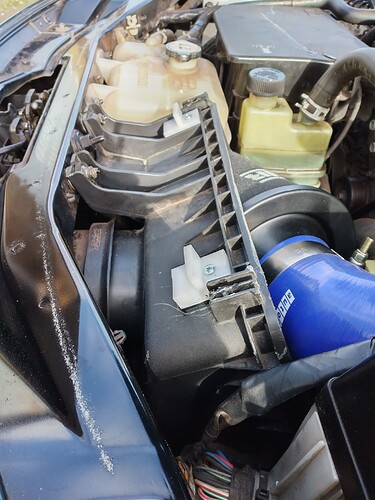

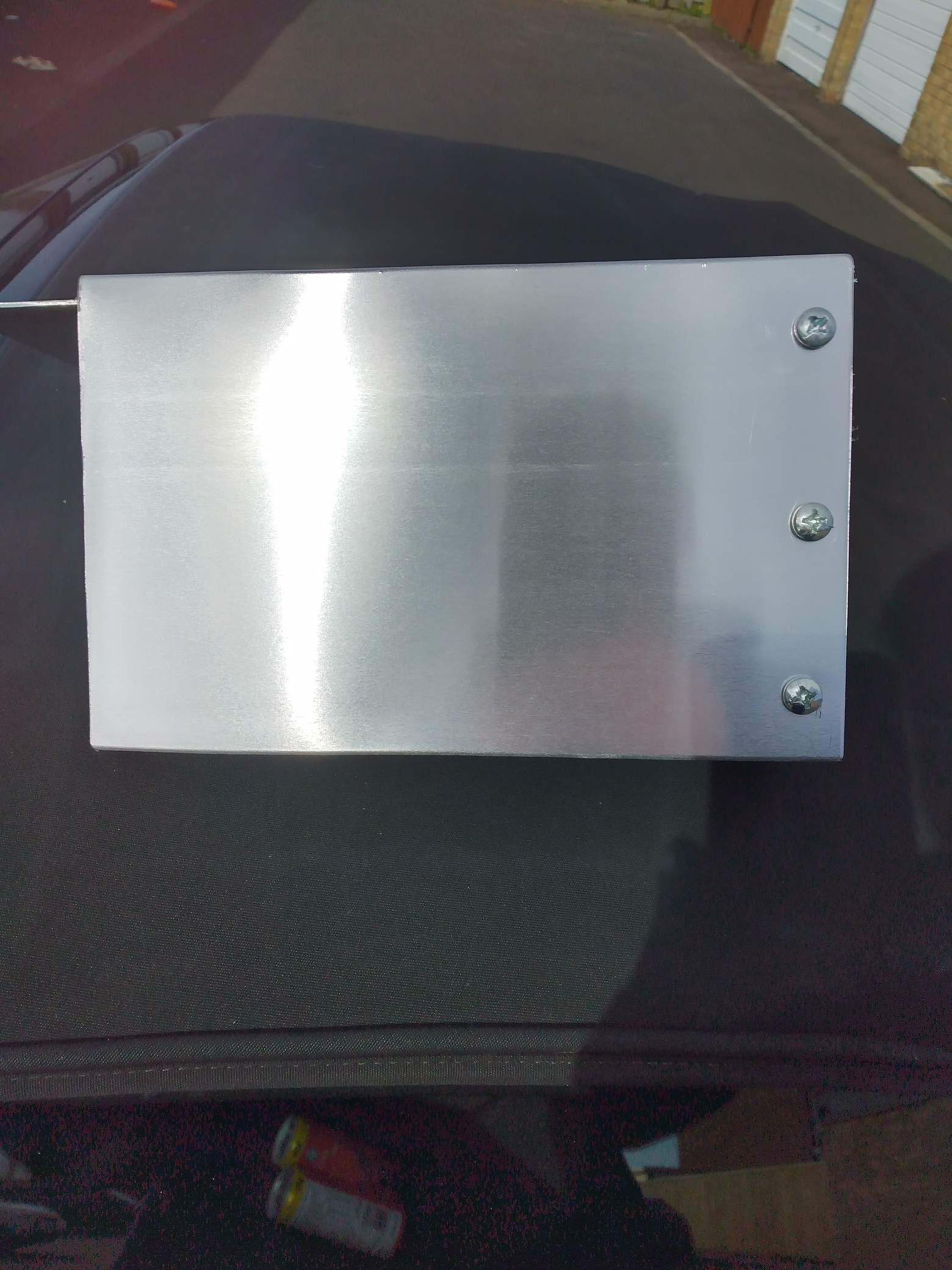

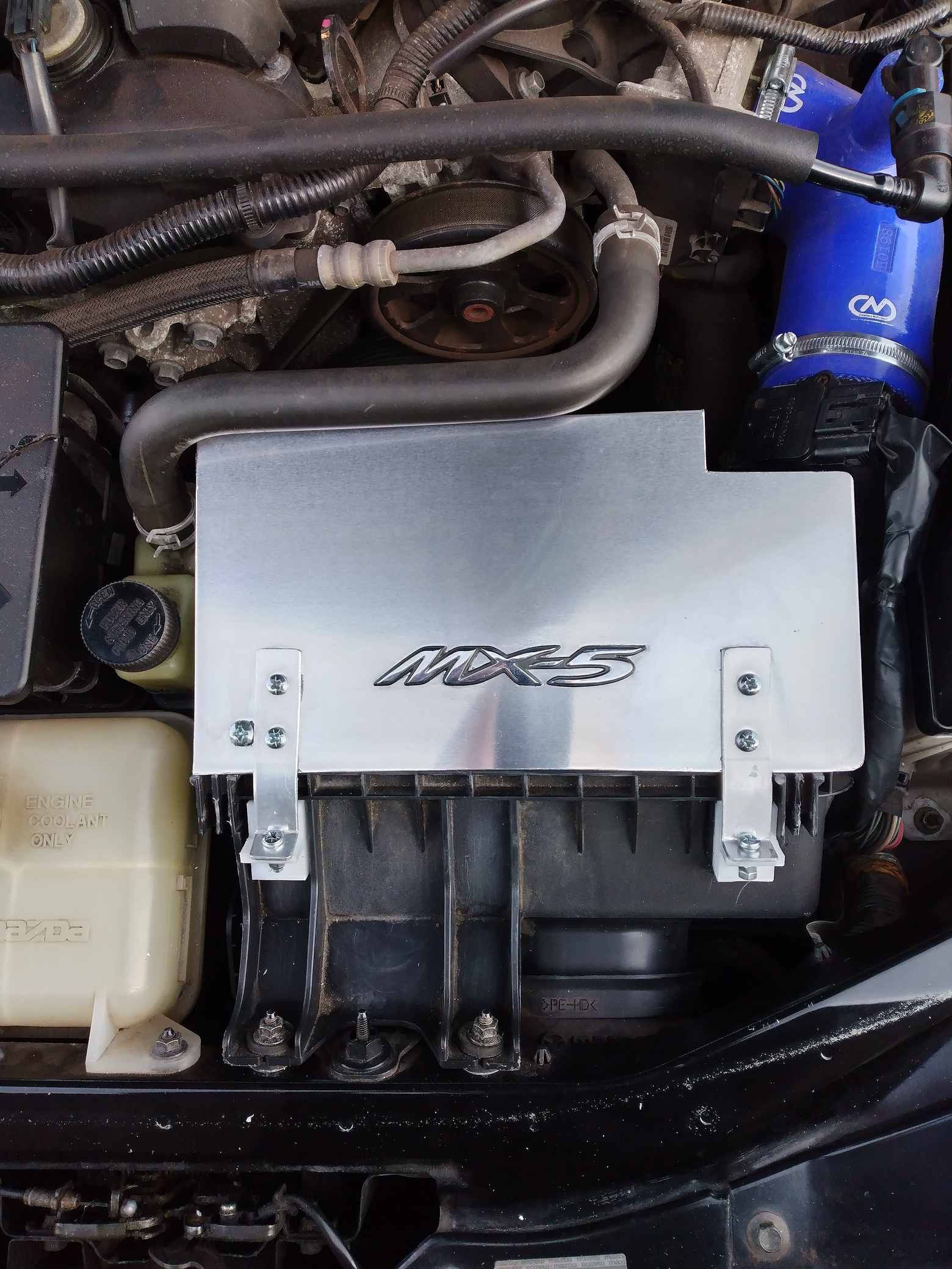

Fitted self fabricated aluminium air box cover.
Hoses and aluminium maf holder fitted earlier this year into modified front housing
Internal mould fins of air box needed buffing out to ensure snug fit (yep I know I need another hose clip)

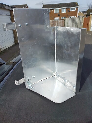

Nylon mounting blocks machined and bonded to housing, also self tapper just incase.
Housing fabricated with only a 4" cutting disc, mole grips and a hammer…lol
Sat housing on top of water pipe location clip with sound mat on to eliminate vibration
The finished article in place.
So its a snug fit, minimal vibration running through unit and I managed to recycle my spare boot badge into the bargain.
Have I gained any ponies ? probably not.
Have I lost any ponies due to altering Mazda’s well designed air box ? Who knows ?
Fairly happy with the finished job, I have on order rubber edge trim to finish off the look and to put a cushion inbetween the unit and power steering hose.
Complete cost of project under £20
Why do it ? Im up north near Newcastle, a Geordie, a Magpie… and we all know magpies like shiny stuff
p.s… I know my engine bay needs a clean up
Looking sweet, job well done.

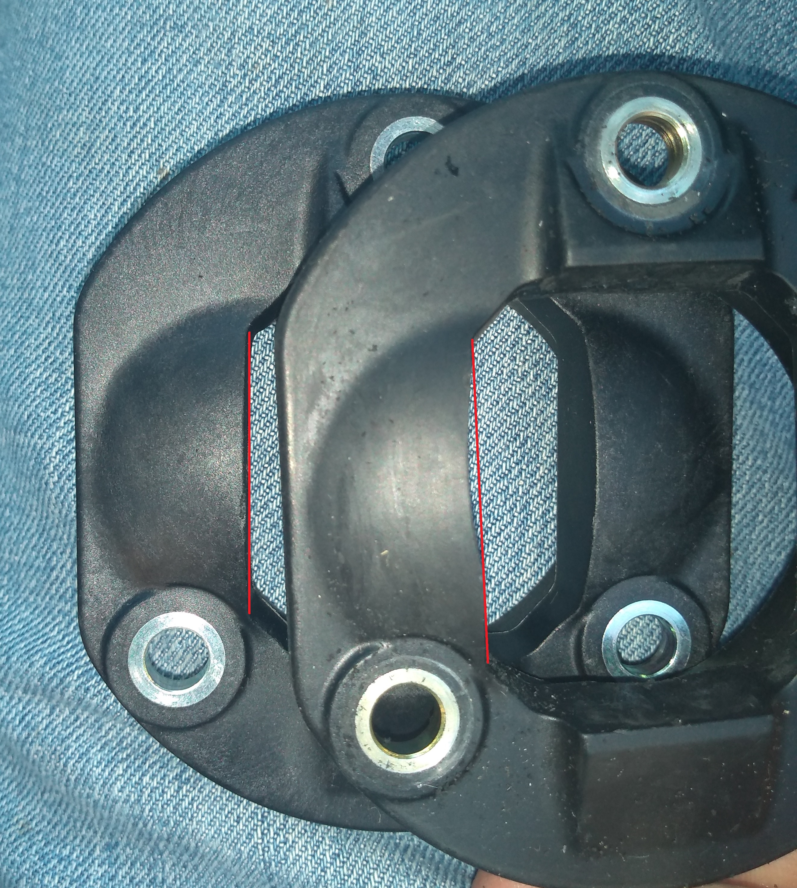

Fitted a new shift limit plate to the NC. Has made quite the difference, more so than I imagined. New on the left and old on the right.
5 or 6 speed box ?
6 Speed. 1st, 2nd and 2nd to 3rd feel better.

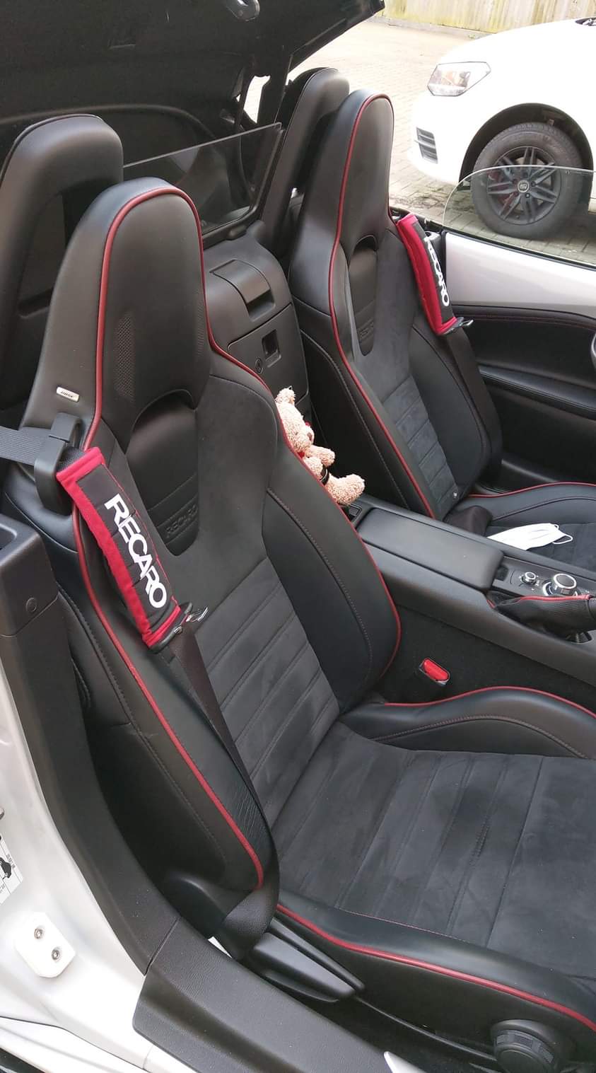

Fitted the Pacomotorsport seat lowering rails today, gives a very useful extra bit of headroom and tips the seat back slightly to improve the seating position.

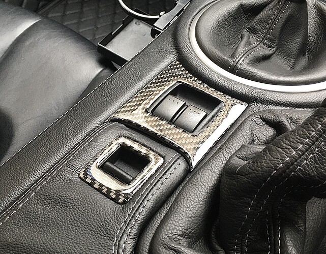

Fitted carbon fibre pieces to centre console.
Nice seats
I would like some carbon fibre trim to cover the silver roll hoops on my nc2 but haven’t found any at a decent price.
Has anyone spotted some??
