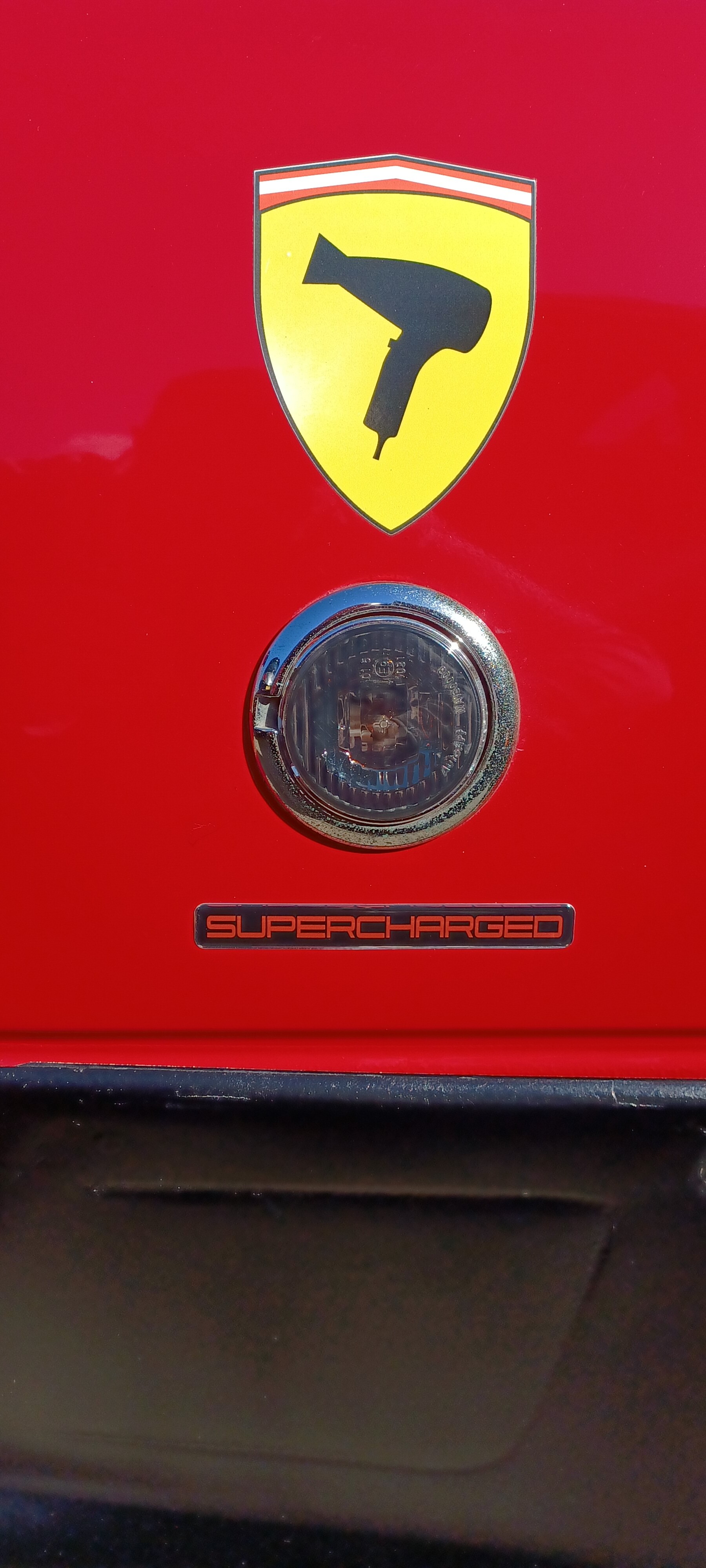

Fitted some stickers

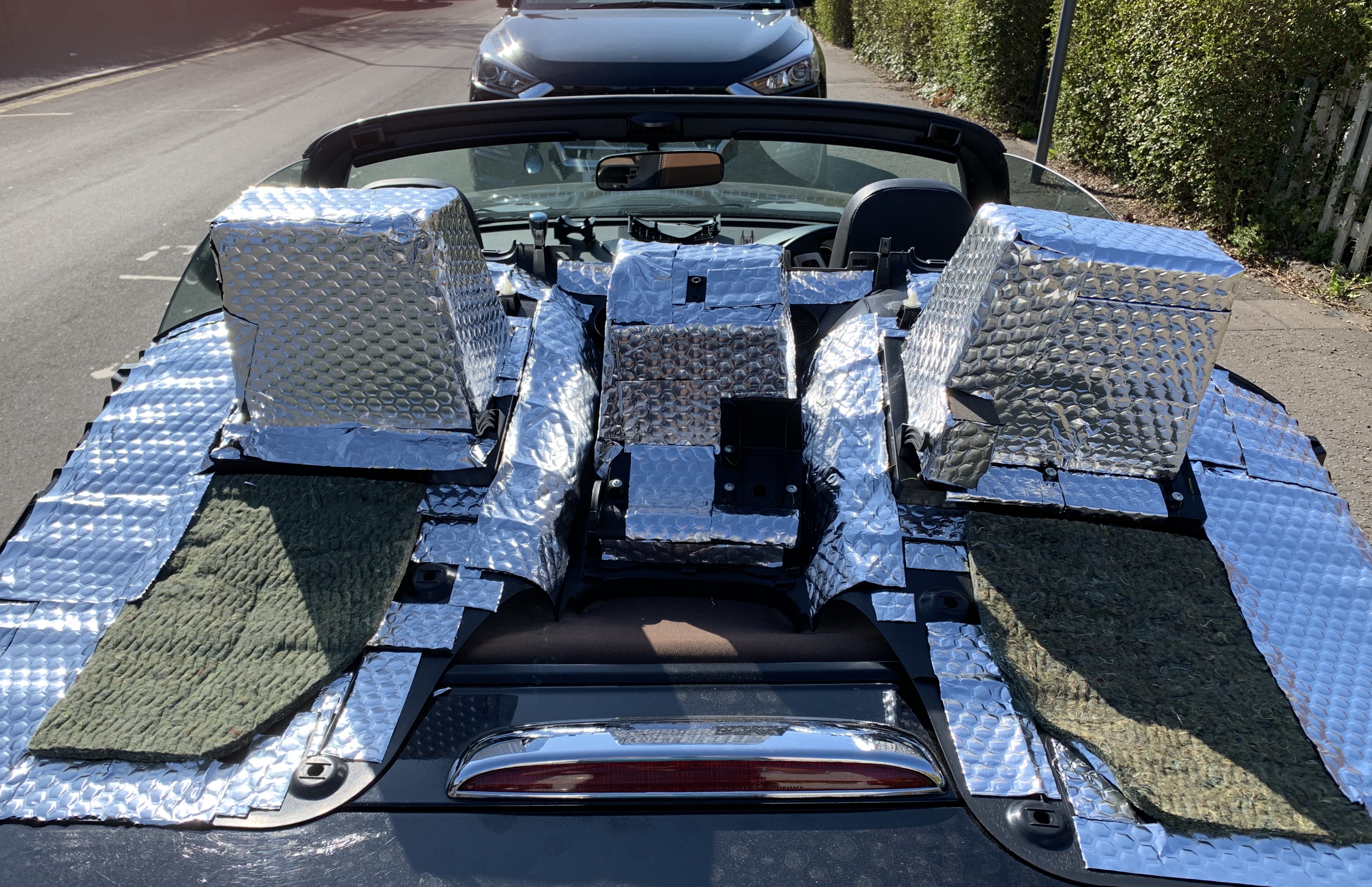

Finished sound-deadening the back panel, gave the cabin a thorough clean & hoover and now all is back, good as new :grin: Not to professional standard but an fairly pleased with the attempt. Got the doors done the other day so just got under the carpet to do now.
Are you going to put some under the bonnet to restore the 50:50 weight distribution?

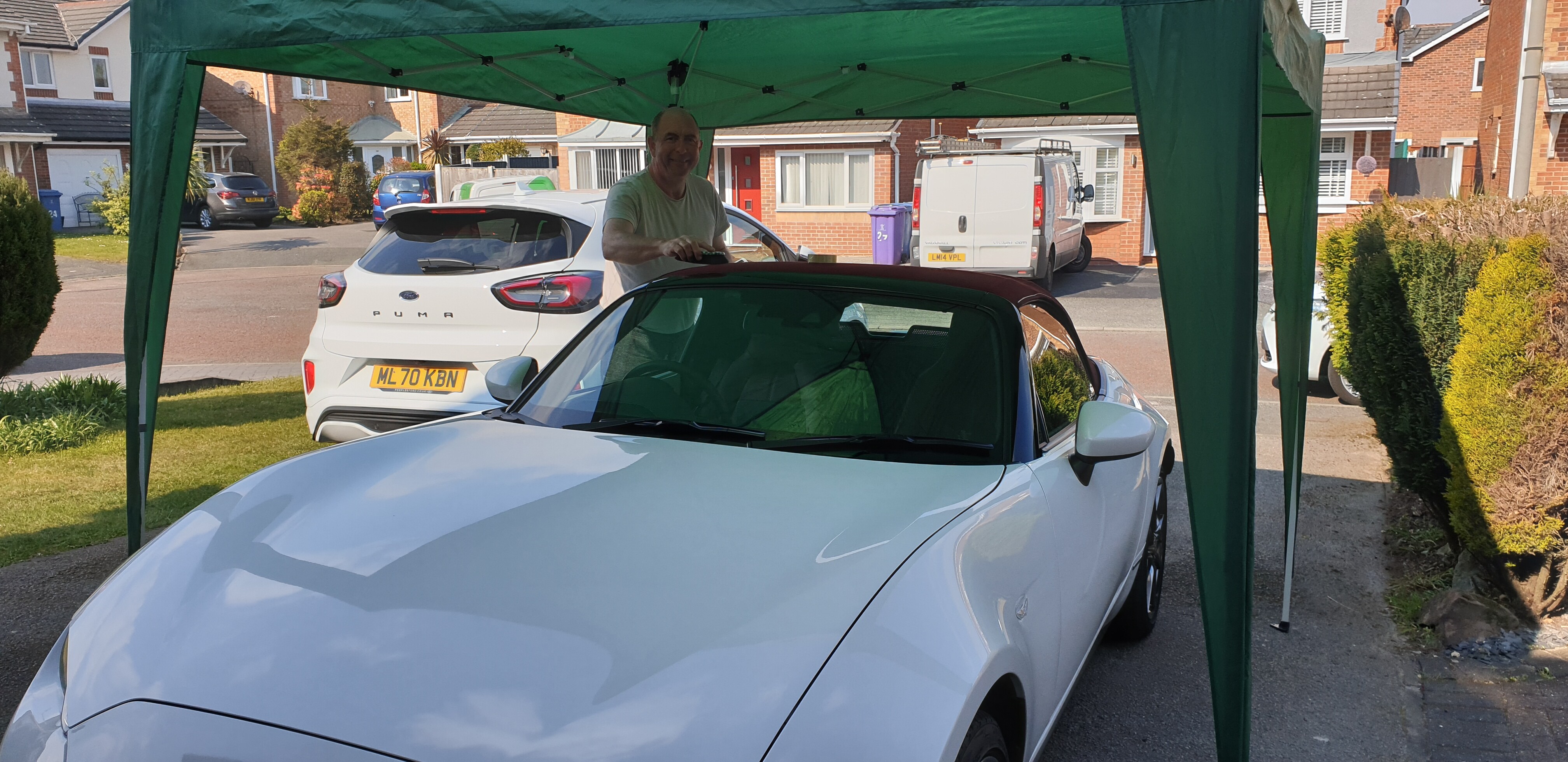

It has been a loverly day in Liverpool today, didn’t have any trips out but we have washed three cars… properly :joy: including my MX5. Today however was all about my MX5’s roof. I have treated it with two coats of Fabsil.
After following advise and recommendations here and the instructions, I am going to report 100% success with the application process, time and a rainy day will tell if it actually works.
Process was:
Brush and vacuumed the roof.
Thoroughly wash with Autogylm fabric roof cleaner.
Thoroughly rinse and let fully dry in the warm sunshine :sun_with_face:
Apply two coats of Fabsil Gold (£11.99 from Amazon)
I put my gazebo over the car to keep in out of the sun while I was applying the Fabsil
I have to admit I was very nervous having never done this before, but the application was very easy, the Fabsil “soaked” into the roof lovely. The change in colour of the fabric (when wet) was a good guide to where the Fabsil had been applied an where I needed to coat next.
In the picture below, the roof to the left of the brush had just been treated, the roof (quarter panel) to the right of the brush had been treated and was already dry. The main roof was still to be done.
It’s only been a couple of hours since the treatment was applied and I am going to report no change in the colour of the roof… it was cherry before I started :joy::joy::joy:

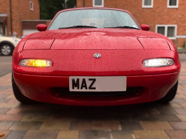

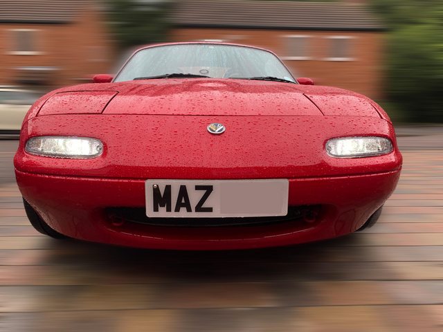

I purchased from MX5Parts a set of non-OEM side light / indicator units WITHOUT the sidelight bulb holder
Instead of a normal orange indicator bulb, I installed switchback bulbs that are white when lit / orange when indicating.
They are the same as were fitted to my NC where I had fitted them in the front AND the rear. Fitting them to the rear meant that I had very bright extra reversing lights and great indicators.
This is what they look like fitted to my Eunos. In my opinion, much clearer and now very bright.
On sidelights . . . .
Indicating . . .

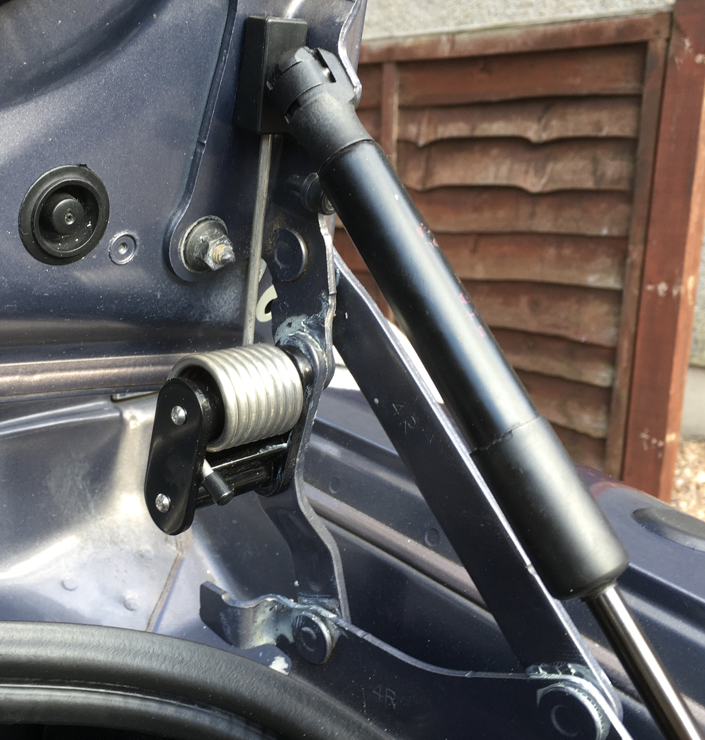

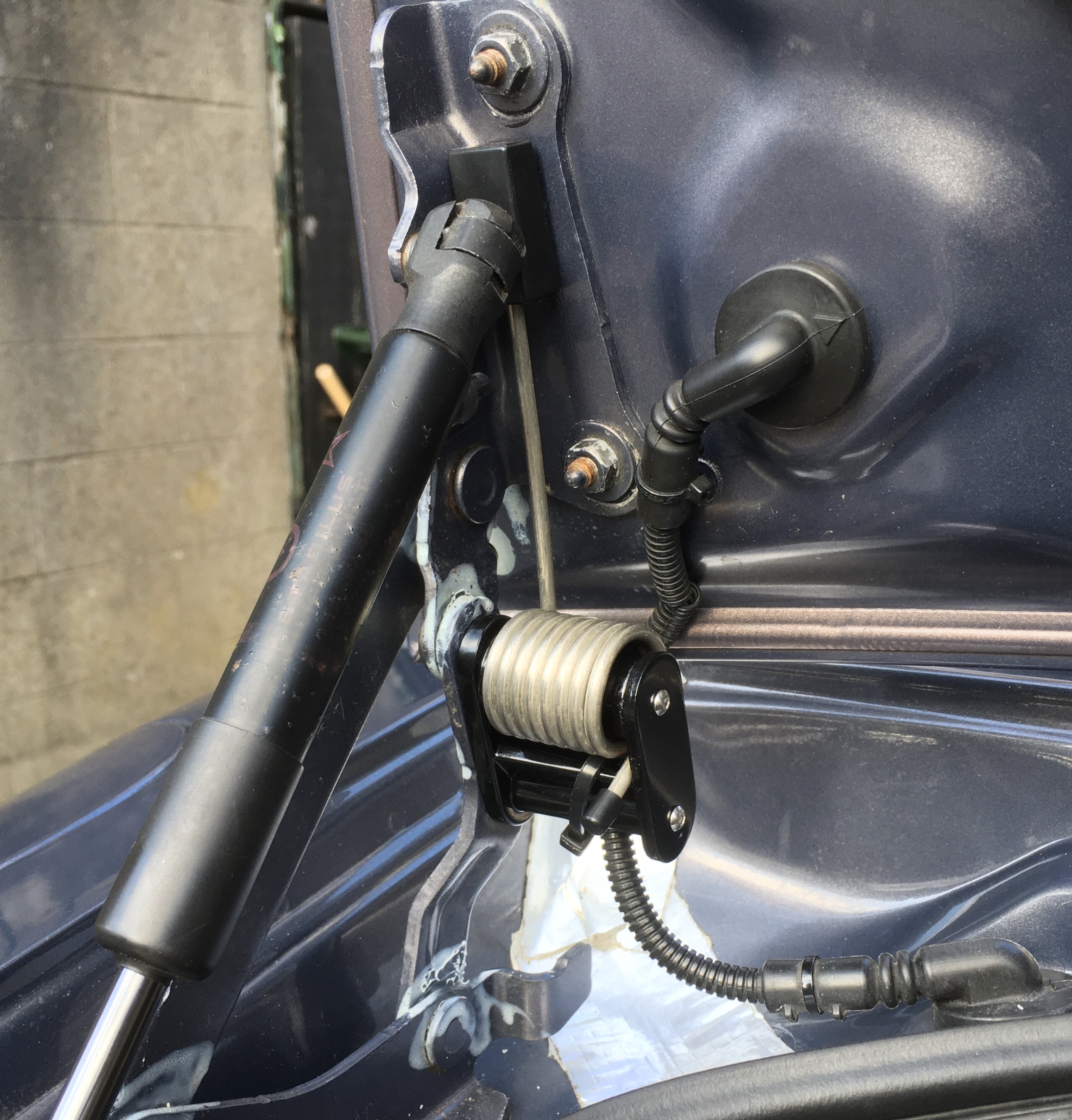

Fitted boot lid poppers. Now when I press the boot release button on the key, or under the dashboard, the boot opens fully by itself. The left hand one is secured using the hole from the cable stay, but the right hand hinge doesn’t have a hole (on the NC anyway) so you have to drill one (the ND has both holes). Here are the fitting instructions so you can see what I mean.

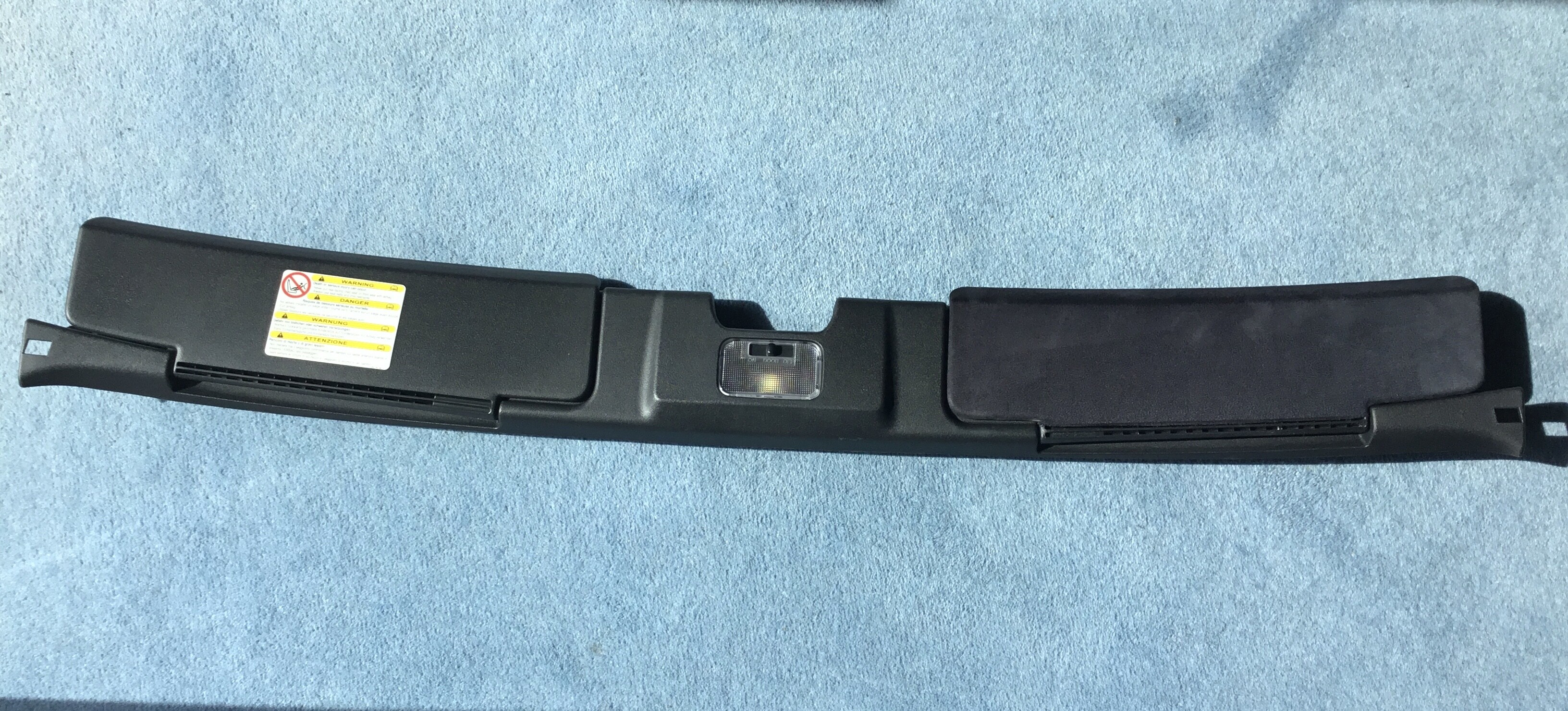

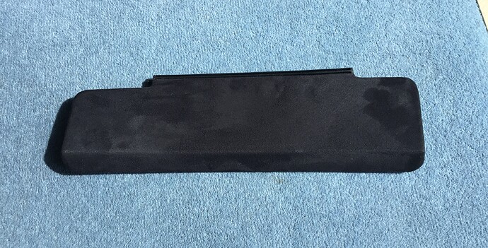

I still have quite a bit of the ‘Alcantara’ material left over from doing my A pillars, so decided to have a bash at covering the sun visors. One down, one to go.
That looks much better than OEM. It amazes me there aren’t any mods for the sun visors out there - would be nice to able to turn mine to the side for instance. I know there is a solution out there using old Audi A4 ones but it’s a lot of work, and the visors required are rarer than hens teeth at the moment.
They’re the ones I have fitted :+1: wired up too so they illuminate as well as swivel to the sides? They’re a bit deeper than standard ones so also give more protection (if needed) from glare. A very worthwhile modification IMO :nerd_face: Being padded too, they’re much nicer than the OEM plastic efforts!

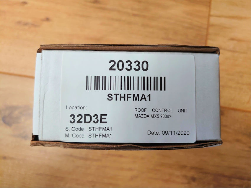

Third time lucky …Fitted my replacement SmartTOP module
