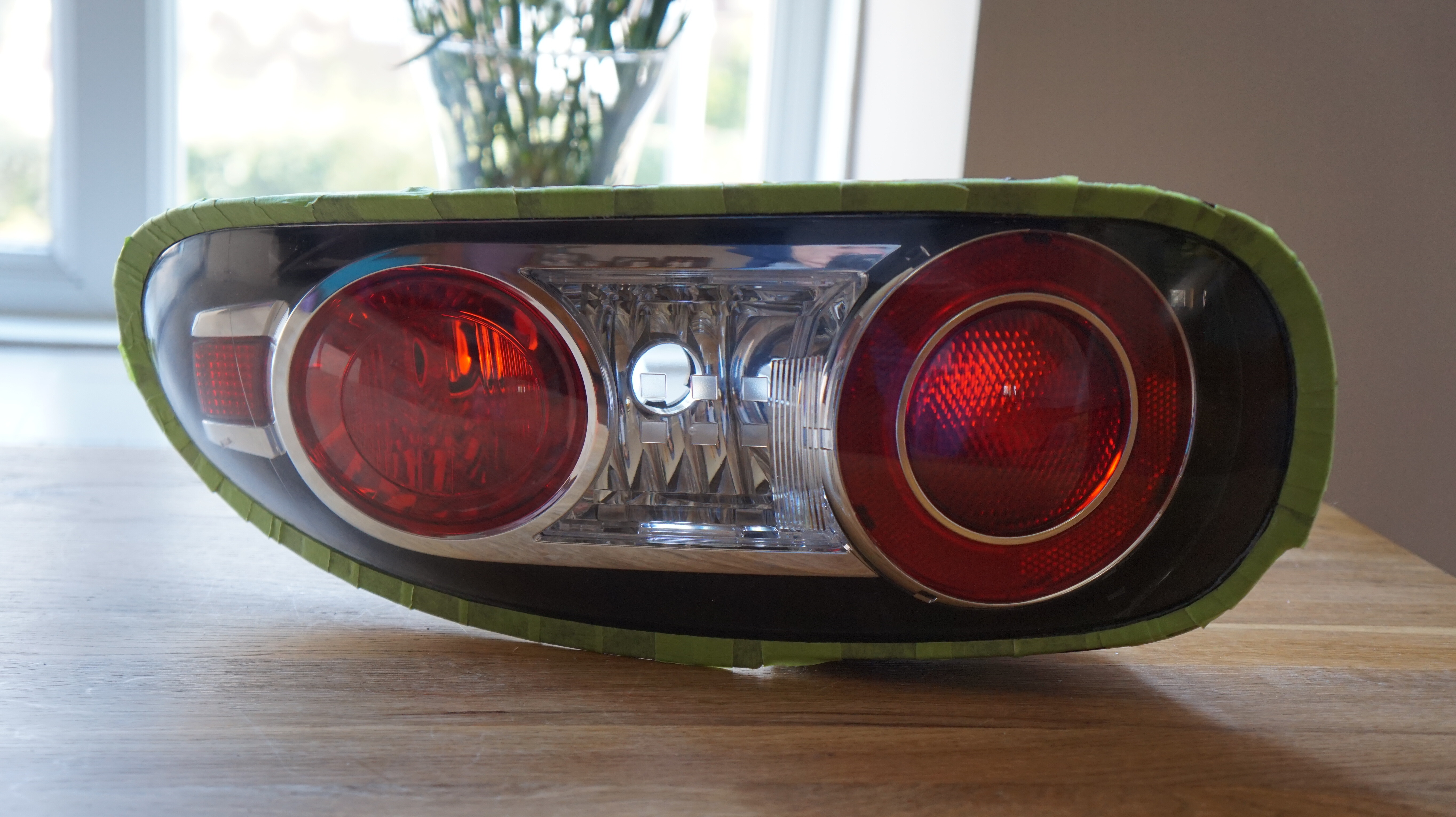

I dislike the rear lights chrome, looks very 90s Japanese.
Little bit of tape work to protect the black plastic edges

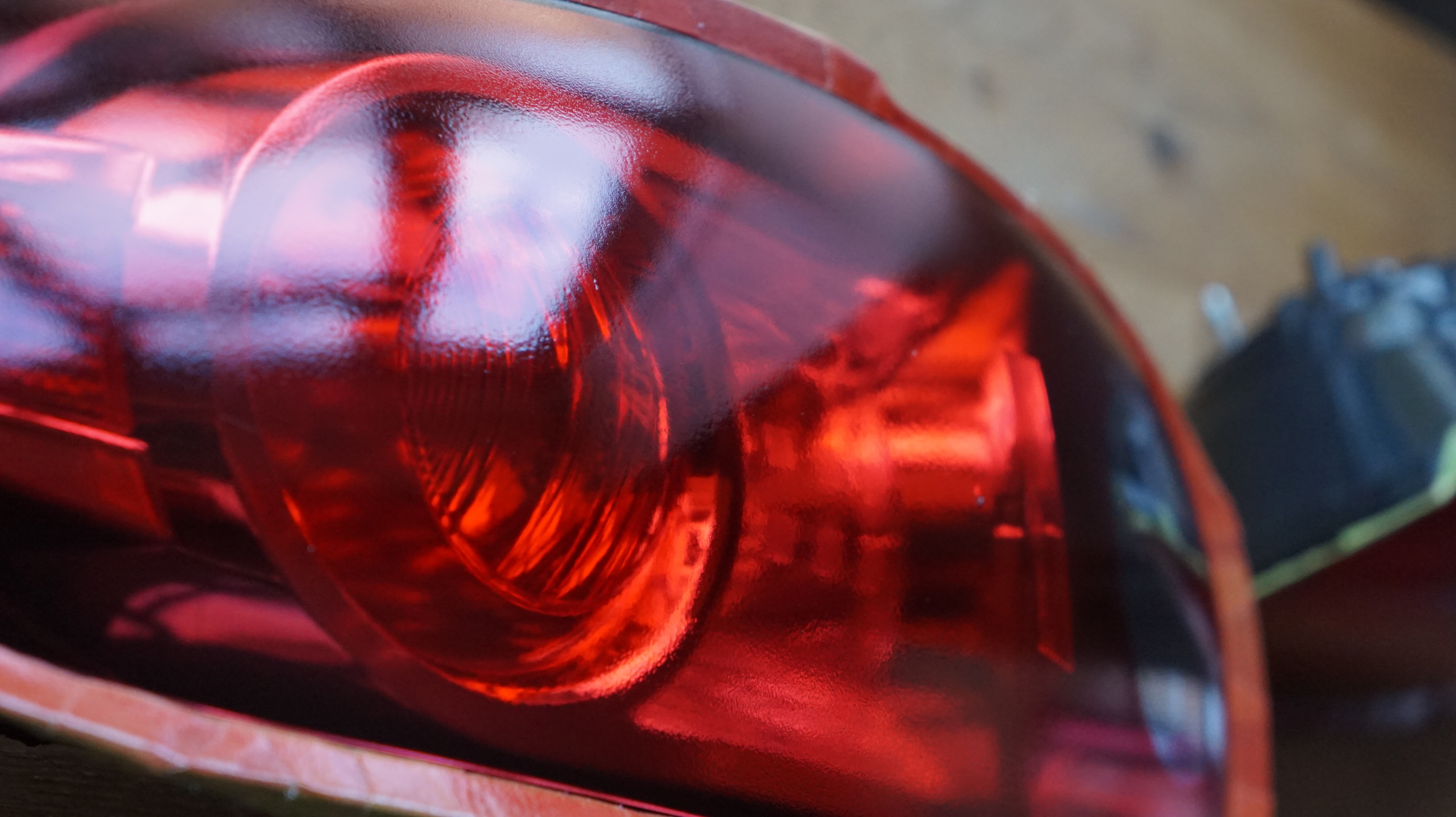

After the lacquer you can see they have the classic orange peel effect, I think this is because I put it on too heavy. Was rushing because the can was so inconsistent.

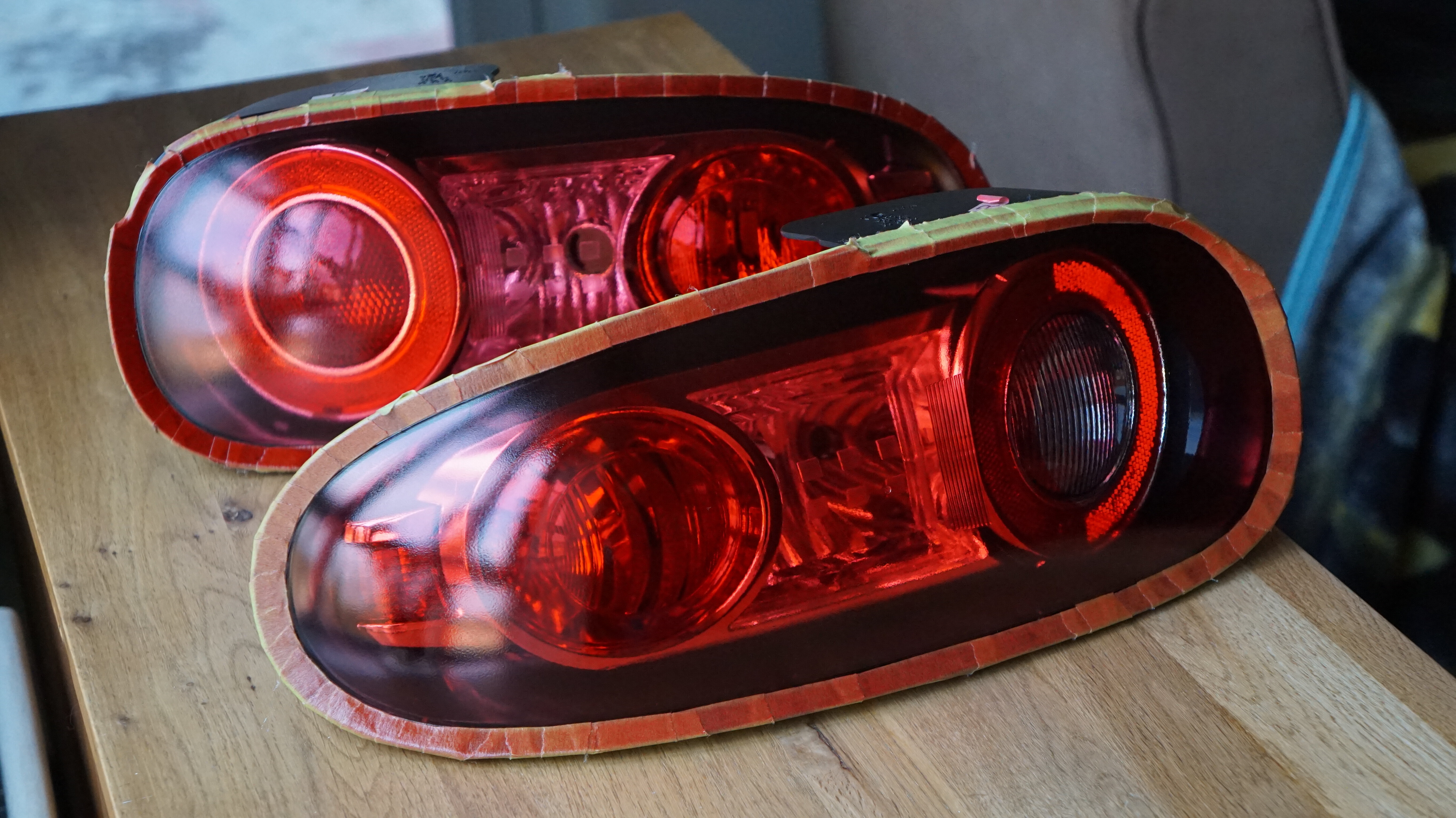

The reverse light I covered with a 75mm sticker so the white light still shines though when reversing. From directly behind it’s totally clear so should be MOT worthy but as you can see from the side you can see the outline, where the circle sticker stopped the red tint covering the area.
After some 2000g paper, 3m 3000g disc and a quick rotary polish with novus fine polish (the stuff soft top users slap on the rear plastic window) it came out okay, needs a bit more work before refitting. (death to the chrome!!)

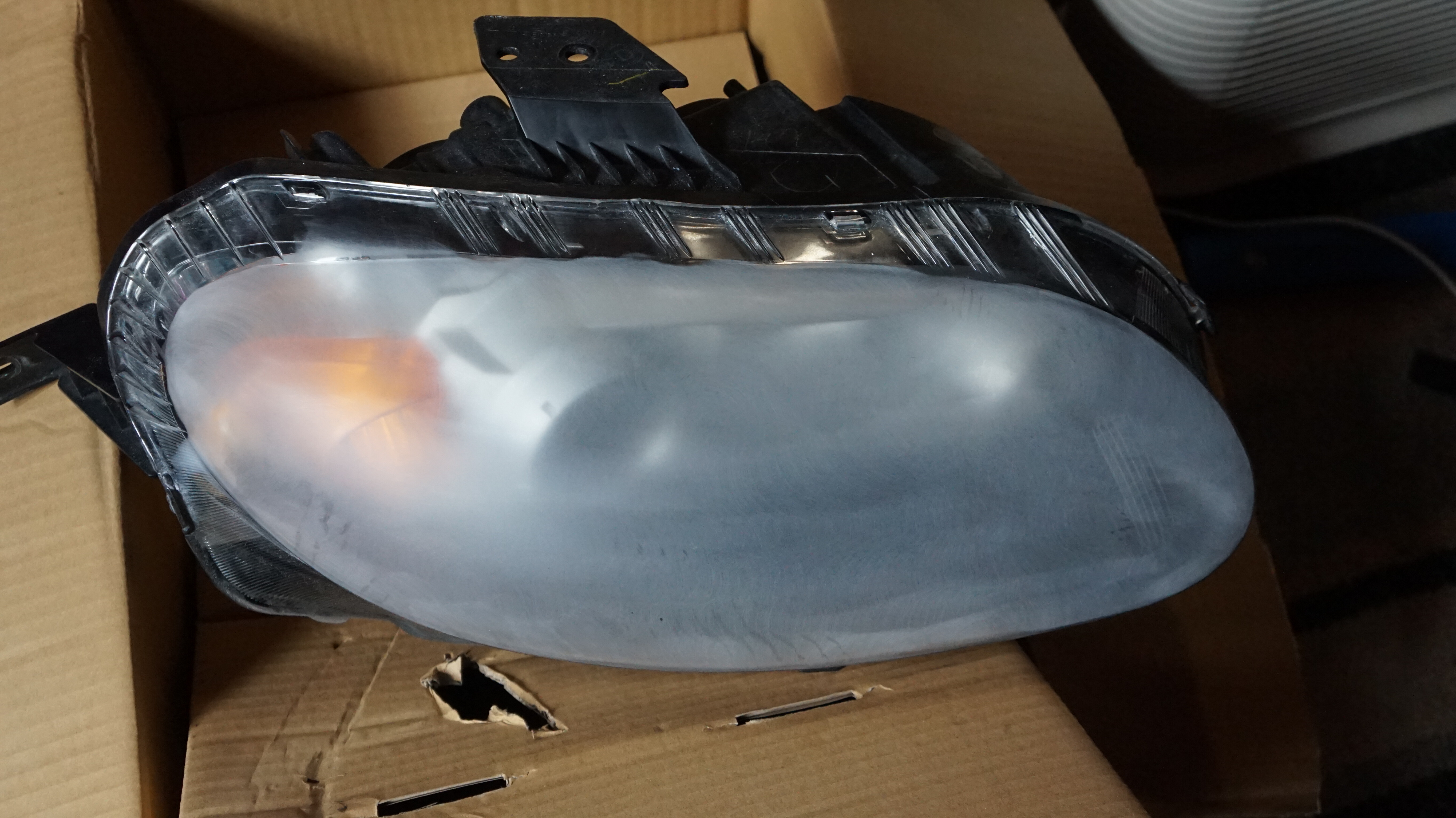

Done these a while with the 3m headlight kit. Need to apply 2k lacquer to finish them off.
