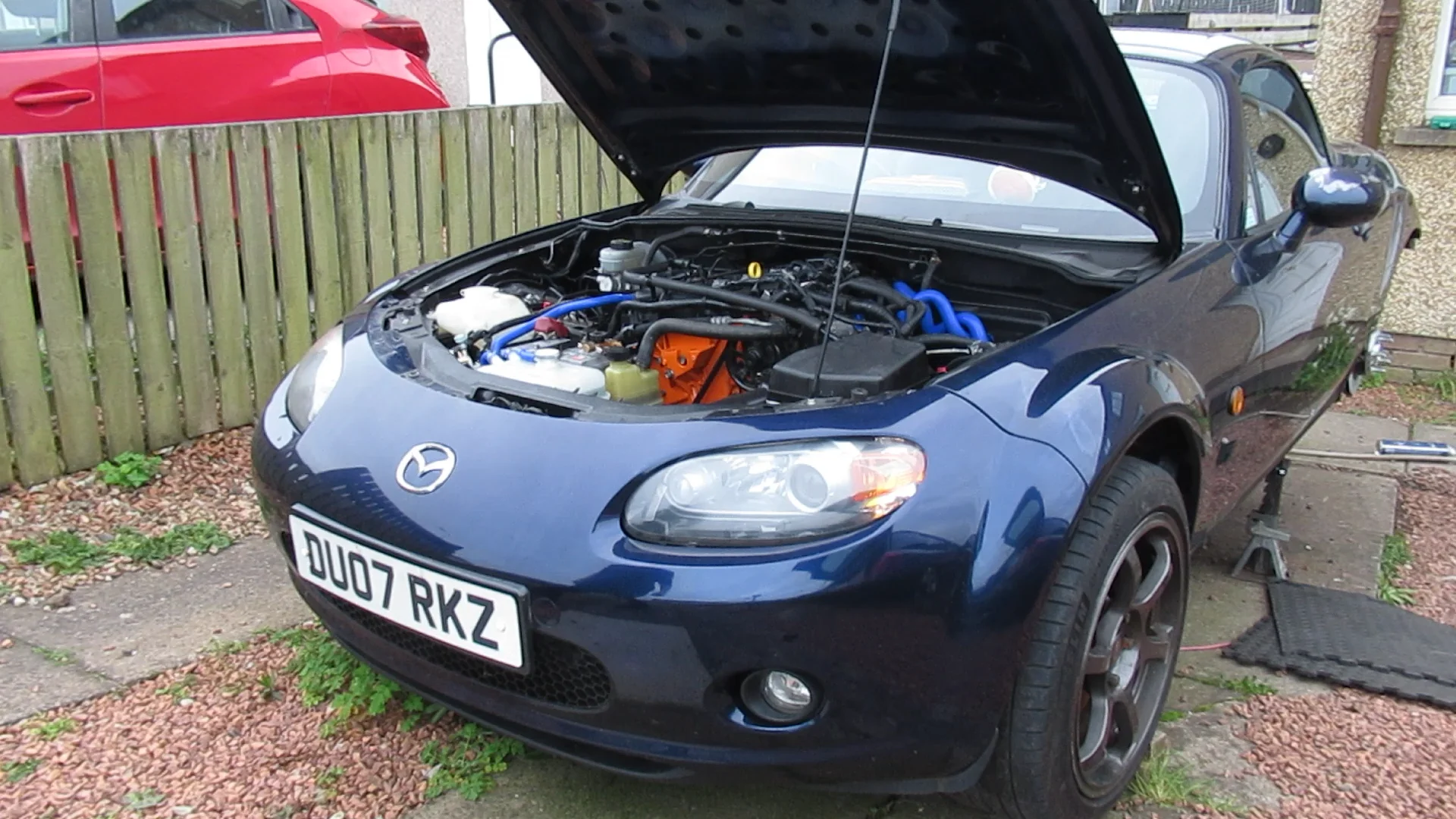

Not running perfectly because it’s a brand new map, but feels good man. Just shy of a year since I took it off the road, that quick 2.5 swap snowballed a bit :stuck_out_tongue: But now it has new everything. Last time it ran it pissed petrol everywhere because I had the wrong injectors, time before that it ran on 3 because one of the donor injectors coincidentally died while the engine was out. But if those are the biggest problems it has then I’m very happy.
Got the rear brakes together at last too, the last bits of exhaust and underbraces fitted and coincidentally finished the arch rustproofing yesterday so it’s back on its wheels, it’d drive but tbh I did a rubbish job of the coolant so I kind of want to drop it out and redo from the start (though, needs a bunch of small stuff sorted before the MOT).
Bit of a holdup on brake discs which is a bummer, I really don’t want to run the new PBSs on the old discs. Not sure how that’ll shake out, I think I still have the old pads so might just slap those back in just to get it going.
