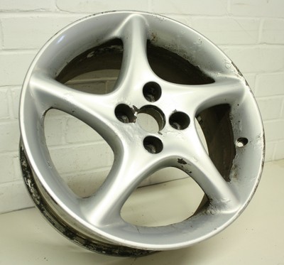

Sounds like someone powdercoated those wheels. If you just need 1, either keep an eye on ebay and buy a used one, or buy 1 wheel from MX5parts. Heftyprice for 1 wheel, but its better than buying an odd wheel, and crashing into a ditch because the fitment is wrong:

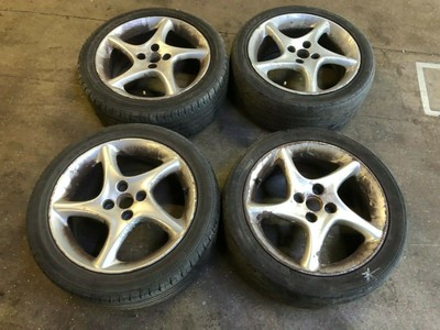

yeah, locking nut, that’s what i meant. i know these photeys aren’t great quality, but can you tell from these if they have a locking nut on? :anguished:

Look like standard chrome Mazda dome wheel nuts.
The 205 width is for the tyre, not the wheel which, as others have said, is a 6.5inch wide standard NB face-lift 1.8 Sport item, so not standard for any Mk 1. Any replacement wheels need 6.5 inch with the same offset and PCD. I would not consider wheels that use a spacer to achieve the PCD as offset and hence load on bearings and steering geometry could cause premature wear. Another issue is the brake calipers and discs you have on your car, as if someone has fitted the ā€œbig brakeā€ setup you will have 11inch 275mm diameter front discs and you can’t fit anything less than 15inch diameter wheels and some aftermarket 15inch wheels won’t fit. If you don’t have big brakes, a correct PCD and offset set of 15 inch wheels and tyres might be cheapest option, otherwise find one or more wheels of the same type at a second hand spares provider, and get it powder coated if it is a bit scrappy. As for locking nuts, the Mazda OEM fit are obvious and you should have a been given a key socket when you bought the car. Your car looks like it has standard nuts.
Just to be certain, how do you know you have a cracked wheel - do you have a photo of the crack ?

There is a second hand set of 4 of these wheels in Peterborough for £70:
