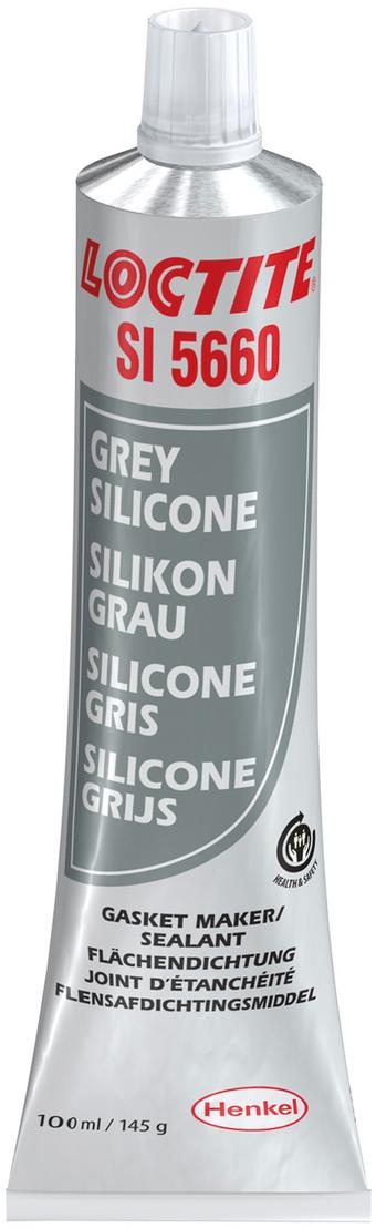

Not sure about the baffles, but in the corners of the cam cover seals this is a good one to use and is available from your local Halfords
I’ve used Permatex on my Mk3 for sump, timing cover and other areas and it works a treat. It’s oil and water resistant and can stand temperatures ip to 500°
A couple of small dobs in the corners of the cam brackets.
