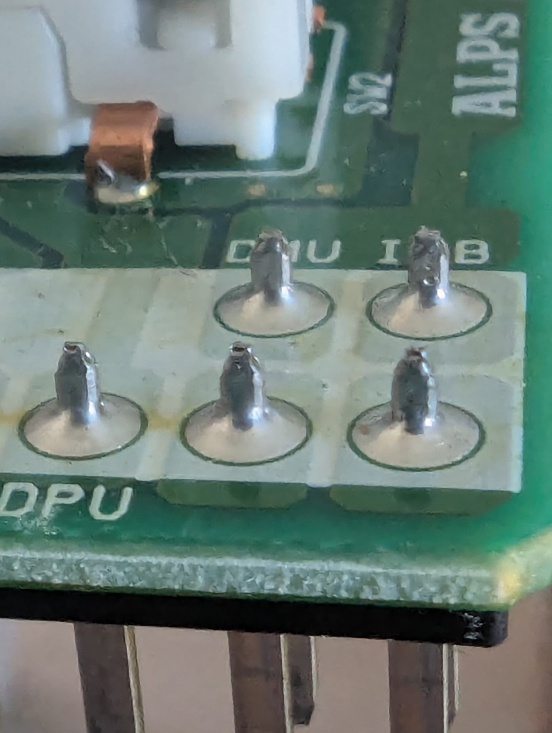

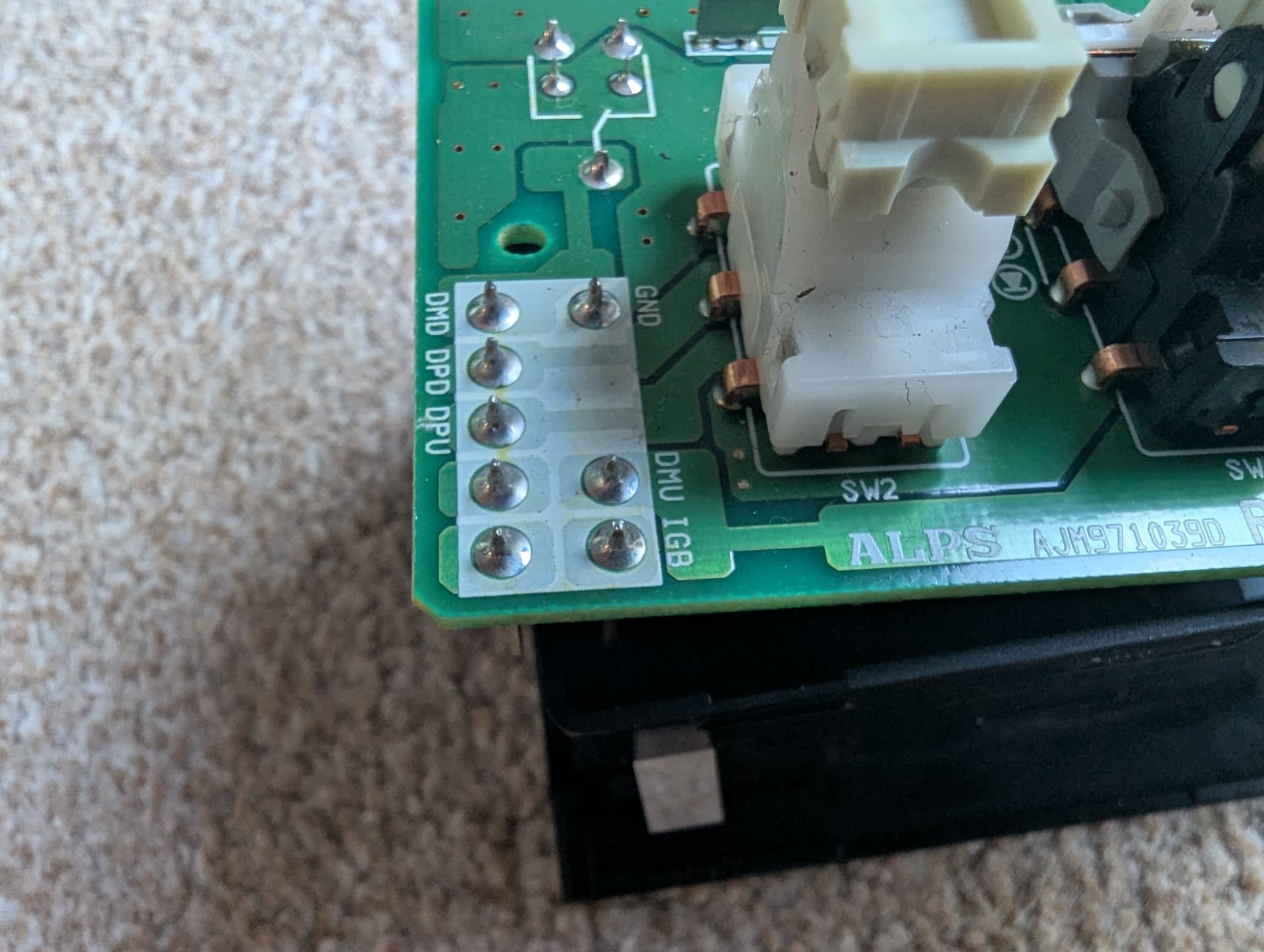

Hi again everyone. Managed to remove the switch box. The board inside looks different from the one shown in the video up in the thread. I’ve attached a picture here: that’s what it looks to me. Unsure if it’s a non-OEM board which was replaced from the previous owner, however I can’t see any damaged contact (unless you can tell me orherwise?). The cracked one in the video was the DPU on the board.
What else can I try before I buy a new switch box?
Can’t really tell from your photo, I loose definition when I try to zoom in. If you buy a replacement switch pack remember to get the same part number because there are more than one type and they are not interchangeable.
If you have a soldering iron try re soldering all those joints before you buy a replacement.
There is a photo in this link and you can clearly see a crack on one soldered joint.

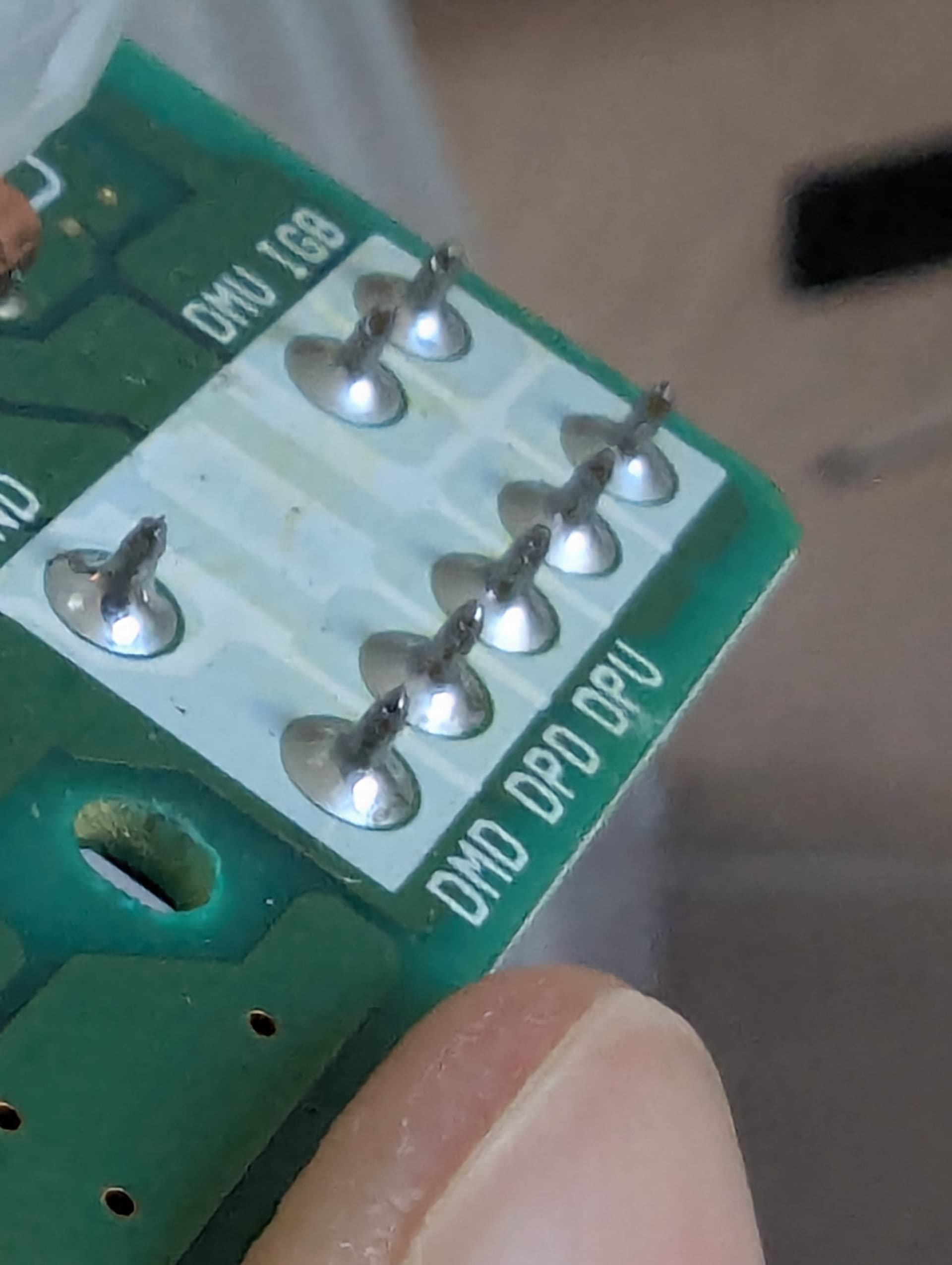

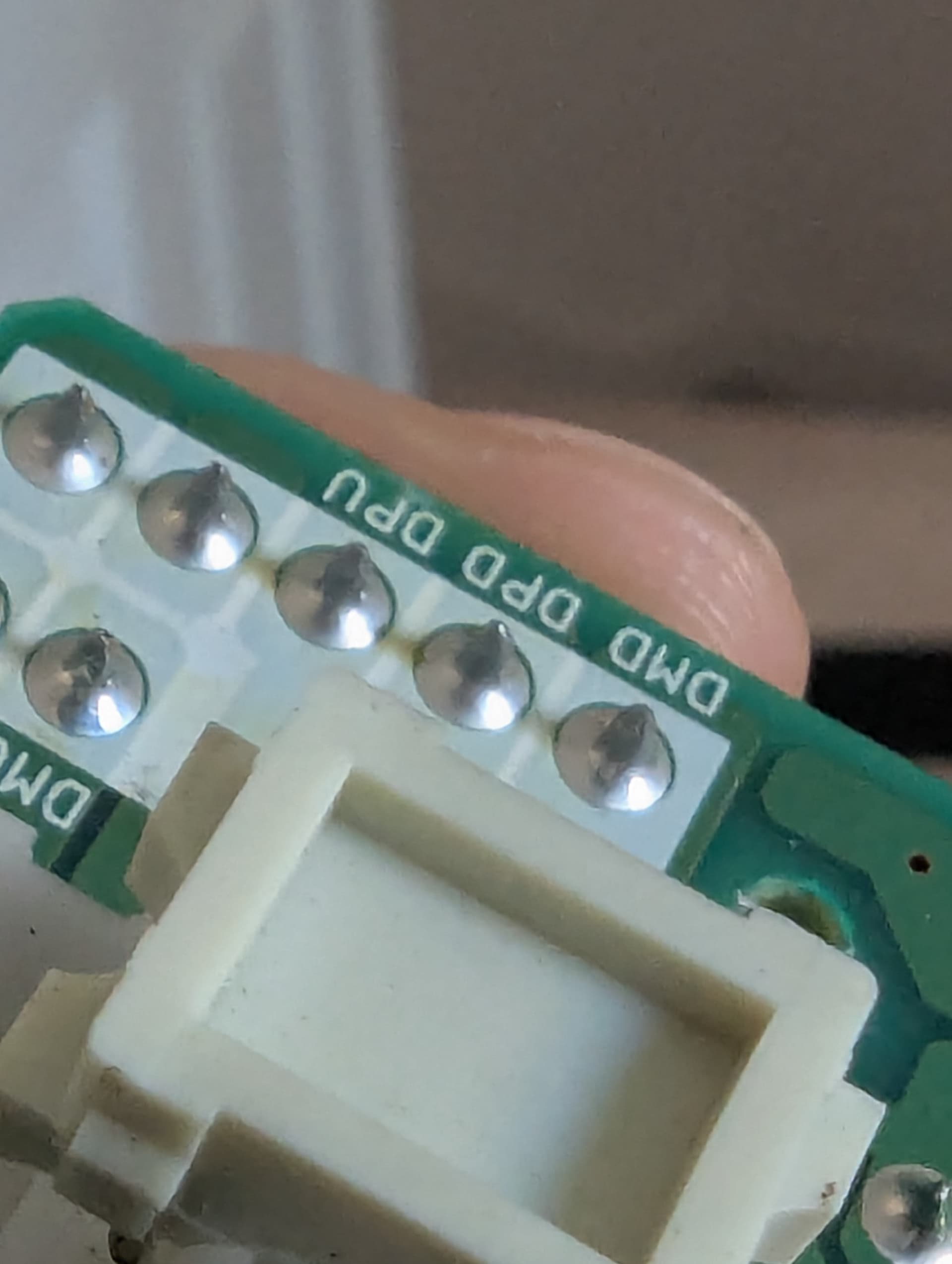

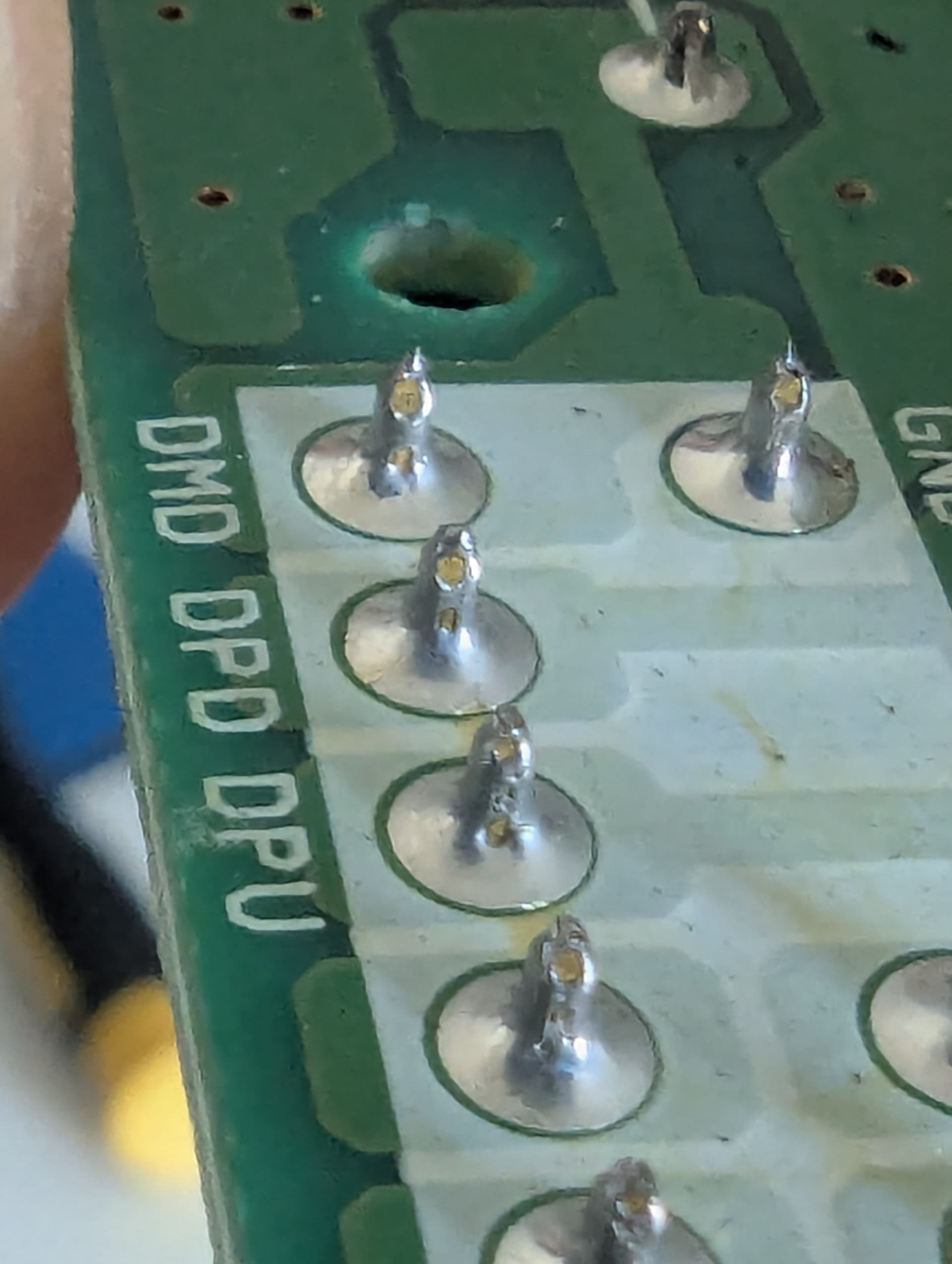

Thank you. Tried to take better pictures. I can’t see any cracks on DPU (or any joint) however the soldering does not cover the entirety of the joints.
Never soldered anything so I’m willing to invest in a soldering iron and giving it a go however I wondering if adding some soldering where the golden bit is exposed would be too much? Is there such a thing as too much soldering?
As near as I can judge from the photos, there isn’t a crack on any of those joints. (I think the joints were probable soldered by a machine.) still worth resoldering them though. Might be worth asking family and friends who have experience and a soldering iron to help here. ( have you got a local radio repair shop?)
