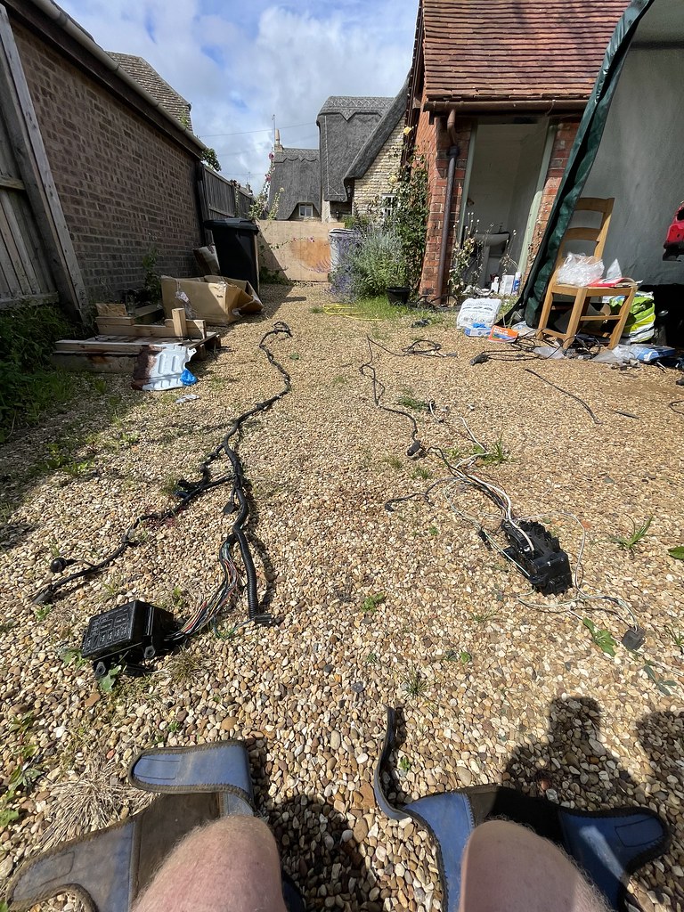

I purchased a second hand manual loom from ebay, as it wasn’t very expensive and I figured it might be easier than rewiring my auto loom to fit my manual gearbox. The other plus is this ā€˜new’ loom is out of the car so I can have a look at it more easily than I can at mine currently.
Imgur
First job was to remove 30 year old stickiness and rusty brackets. Rusty Brackets, by the way, will be the name of a band i’m in in the future. If I ever learn to play an instrument. Or sing a song.
Imgur

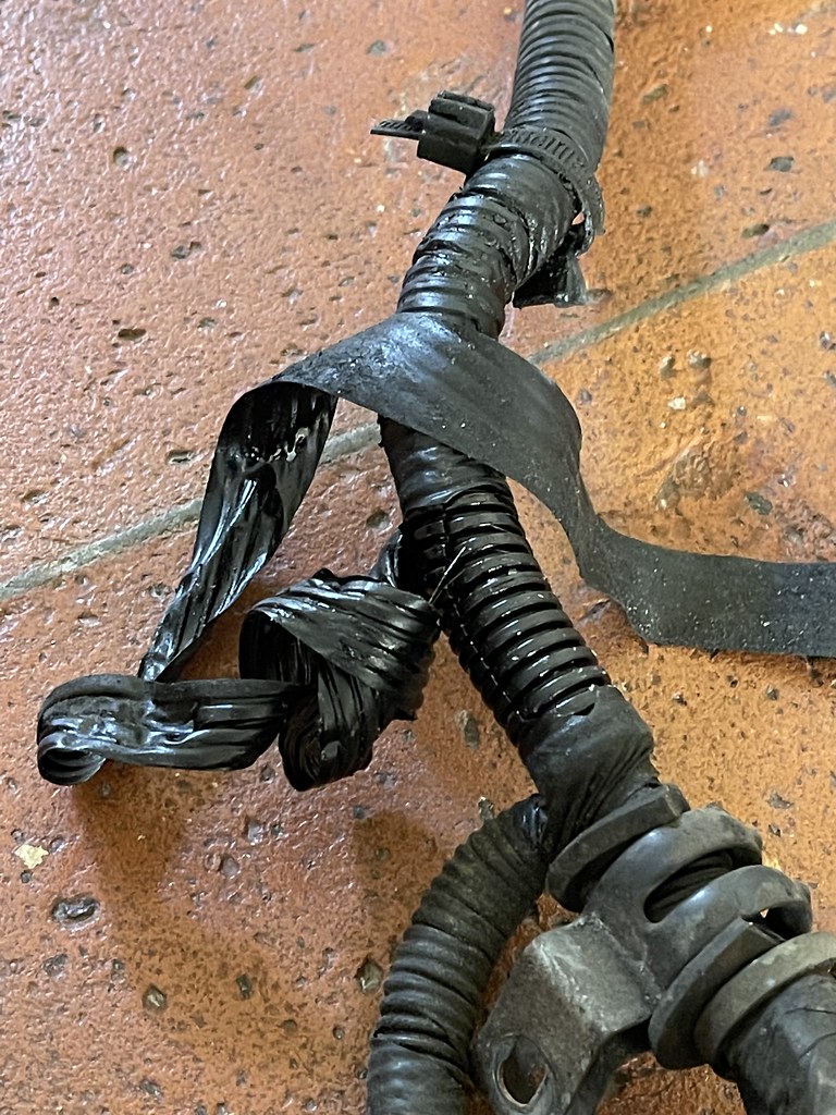

Once I’d taken the sticky tape and brackets off, I removed the conduit. Lots of it was knackered and it just looked horrible and the whole point of doing all of this was to be able to mroe easily check and identify the wiring.
Imgur

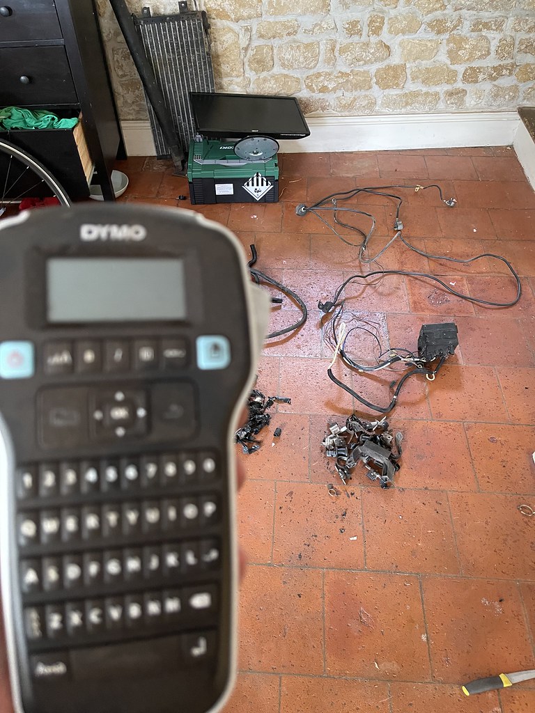

This is where my label printer should be handy!
Imgur
Now to consult the wiring diagrams!

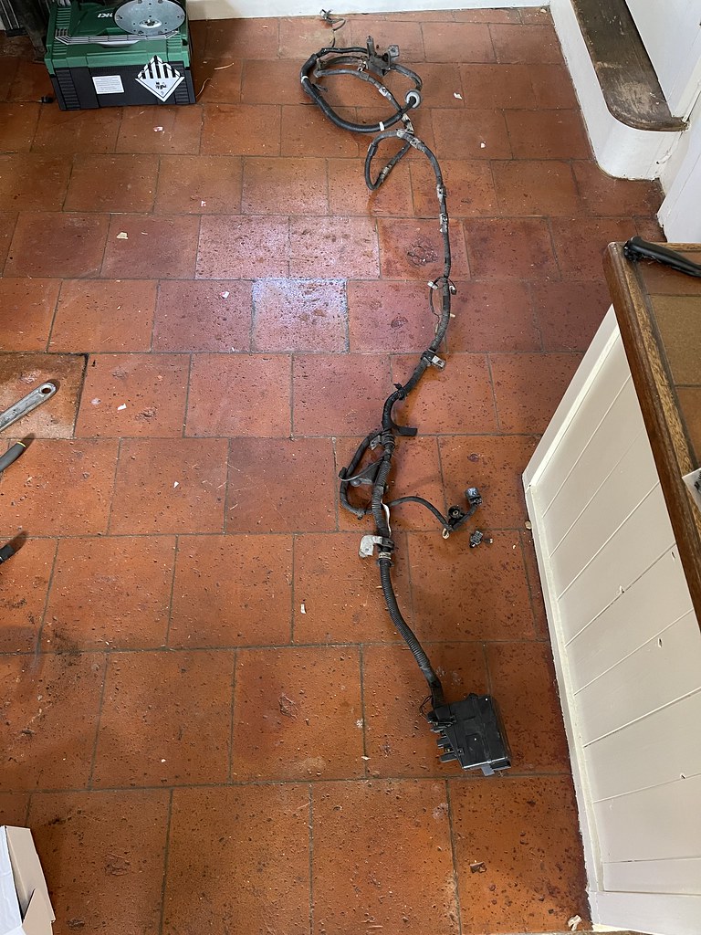

As I think I mentioned earlier, I ordered a used loom from eBay for a manual 1991 car. Here is the ā€˜new’ loom next to my loom which I removed over the weekend. When I say loom, I should say this is the one that runs from the battery to the engine bay fuse box. As you might be able to see if you look closely, the auto (possibly obviously) has a lot more wiring and connections. The auto box has its own control unit for starters and my original car had air conditioning.
Imgur

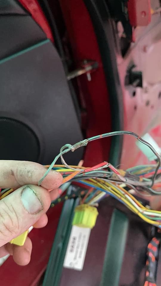

I stripped both looms down so I could see the wiring more closely and check there were no obvious gremlins. Using Project Binky for inspiration, i’ve ordered some fabric electrical wrap to re-tidy-this-up when i’ve got it all sorted.
Imgur
I found the four gearbox connectors, woop! This means I don’t need to do any modification of the auto loom.

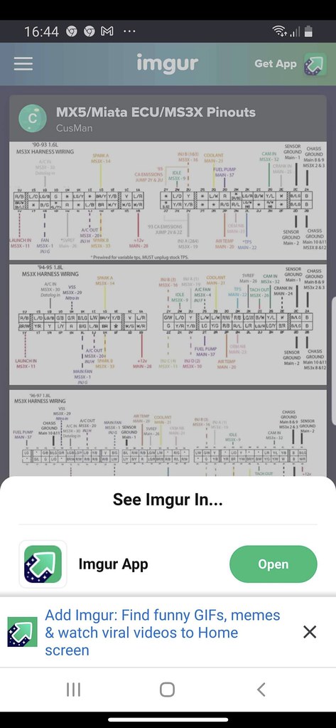

Once i’d had enough of that particular set of wires, I decided to consult the dreaded Rocketeer instructions for the tapping in to the OEM ECU wiring. As is ever the case, the instructions were limited and as is ever the case, my understanding of automotive wiring was limited.
Imgur

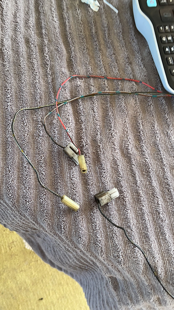

However, after much head scrtaching and a lot of help from the Rocketeer community, I managed to find the wires I needed and labelled them up ready to solder or connect up to the ECU wiring. All bar one.
