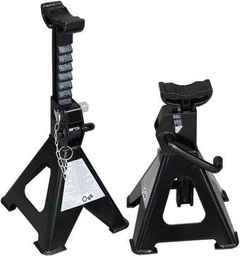

My axle stands and low profile jack arrived today (both Halfords professional ones), the car is snugly in the garage, so all I am waiting on now is the house move (paid the holding deposit :)) and the kit from Rocketeer. I know people love to hate Halfords (me included - even though I couldn’t tell you why!), but these are all highly rated and good value, and i’ve got to keep all of this under control.
