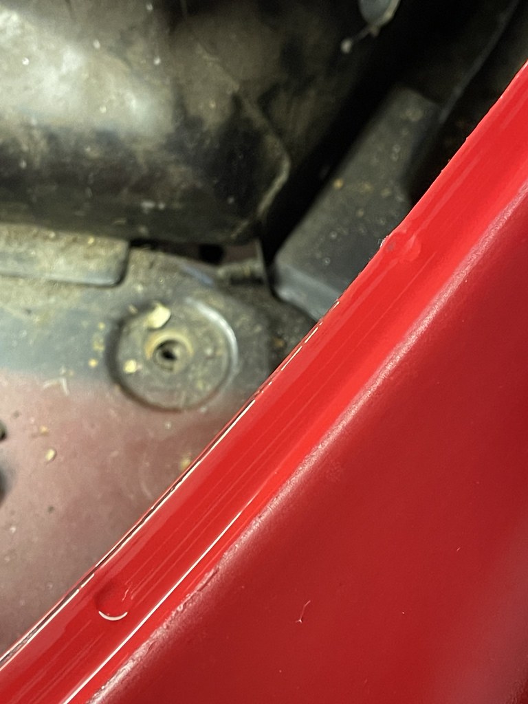

After tentatively looking at the idea of painting or wrapping the car myself i’ve decided that it’s best to leave that job to a professional. a) because i’m not a proefessional, b) because my wrapping ended up looking like a Christmas present wrapped by a child and c) I haven’t gto any time.

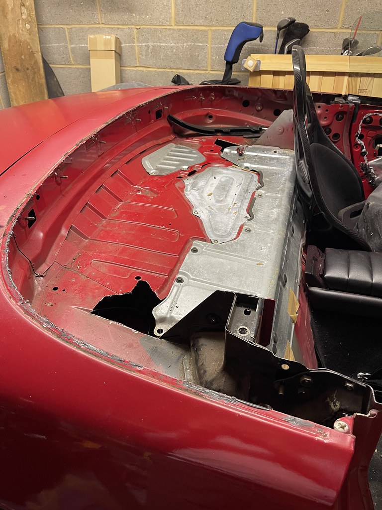

I’ve stripped the car of any trim (and purchased lots of brand new Mazda trim pieces to fit apres the painting) and have been flattening the paintwork in preperation for the car to be painted.

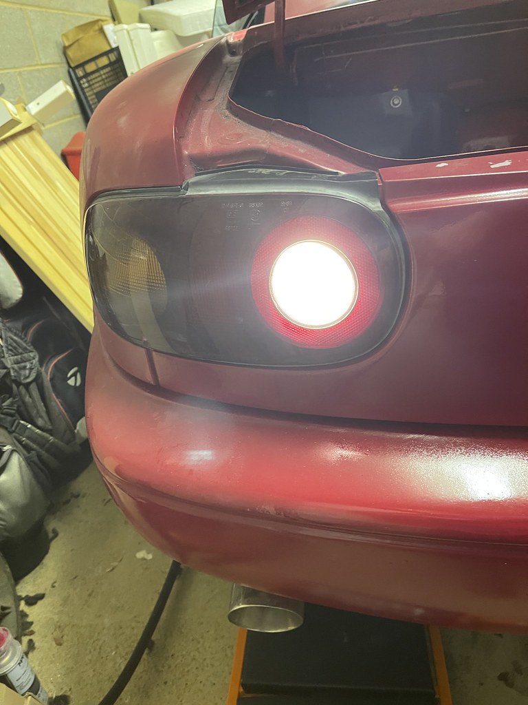

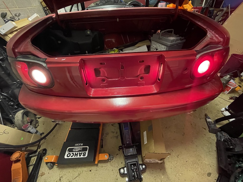

BIG news.
The reverse light is working.
Imgur
The reverse light and the fog light mod are working at the same time!
Imgur
Hurrah!
Many thanks to @Benji93 who has been an absolute legend in providing me with help.

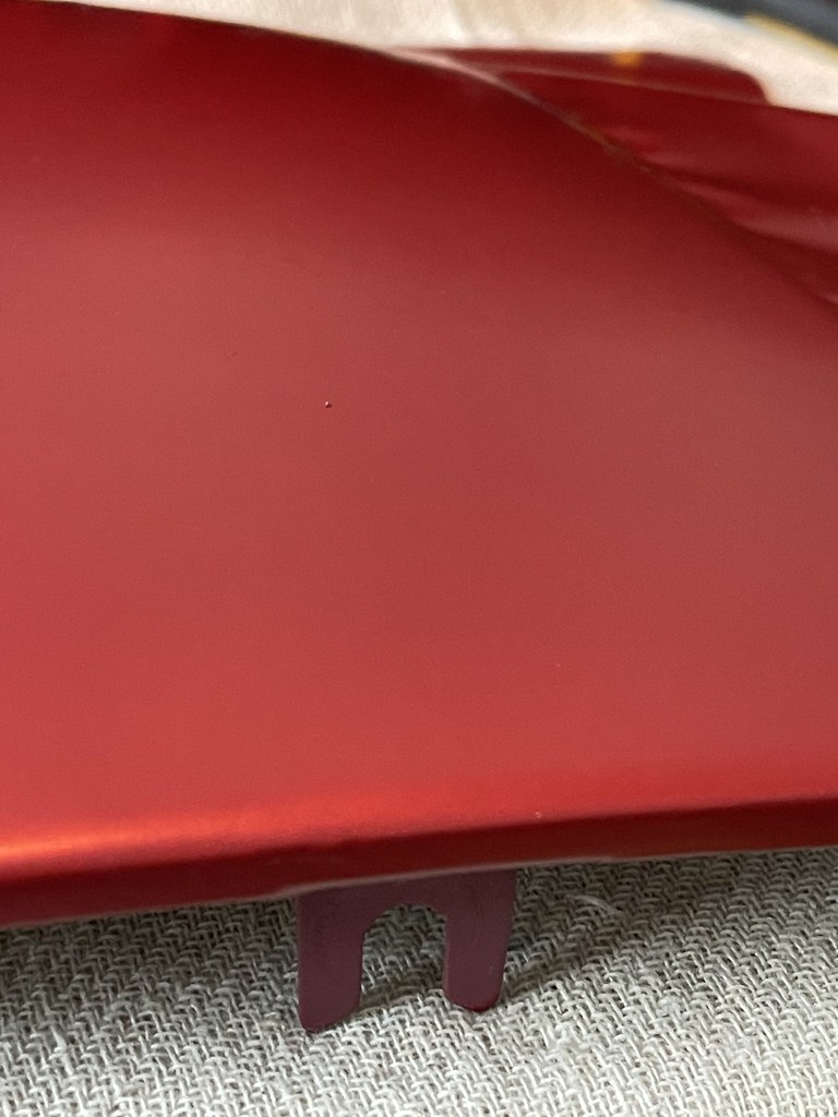

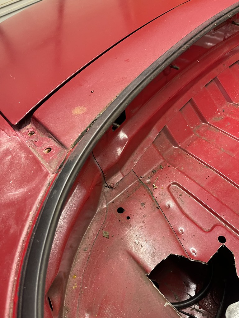

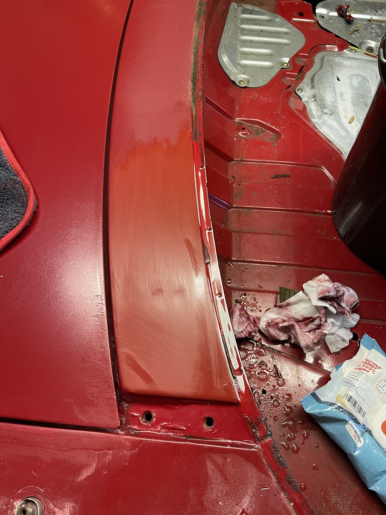

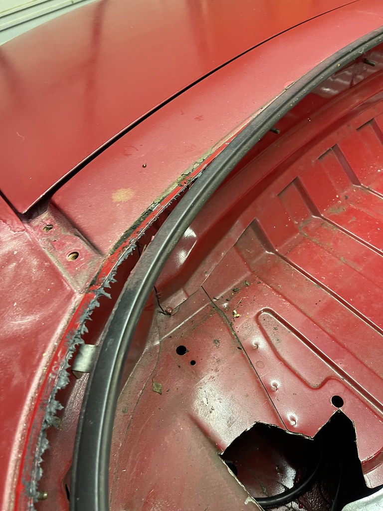

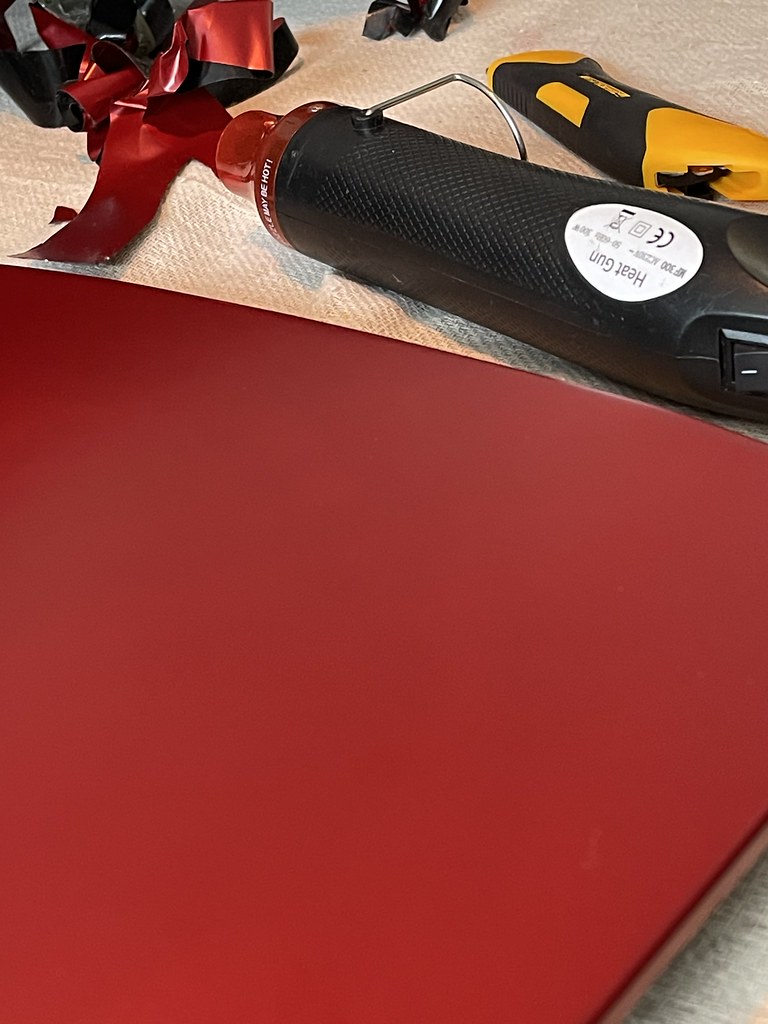

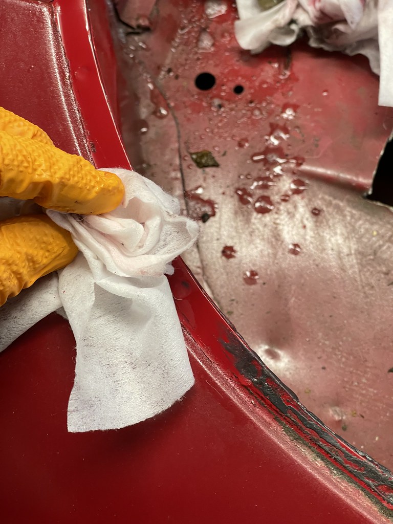

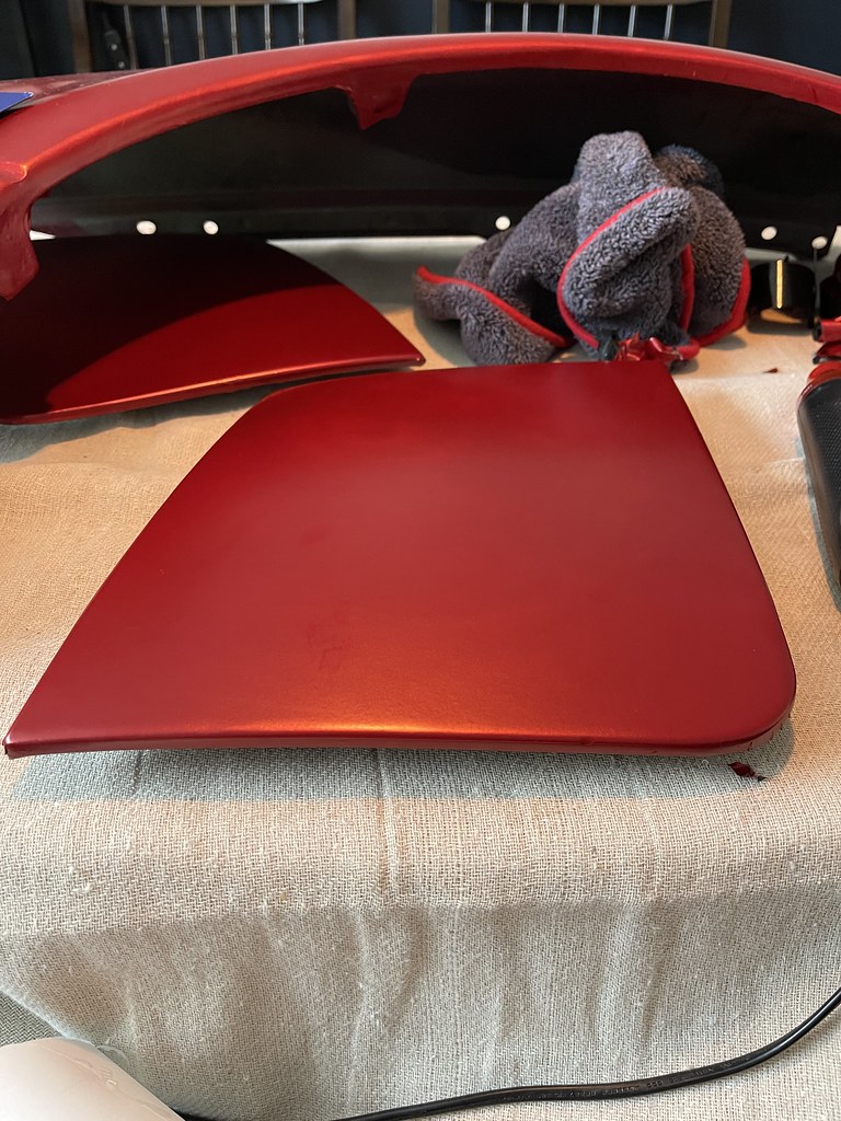

This update brings some good news. After all the messing around with paint, I was hit with financial constraints and coupled with the poor finish (I was looking for a standard which isn’t possible!) of the rattle cans, decided to go back to the 6 metres of wrap I had in my garage.
Having previously watched many hours of how to videos, I watched some more and set to it. I’m delighted with the results!
This was the closest colour I could find by a good brand to the Rocketeer red which they use on the cam covers.
Imgur
Imgur
Imgur
Hopefully the new seal for the cam covers on my engine will be arriving in a couple of weeks, so (with a few days off coming up) i’m hoping to get the whole car wrapped before then…and dare I say it…MOT here I come?
