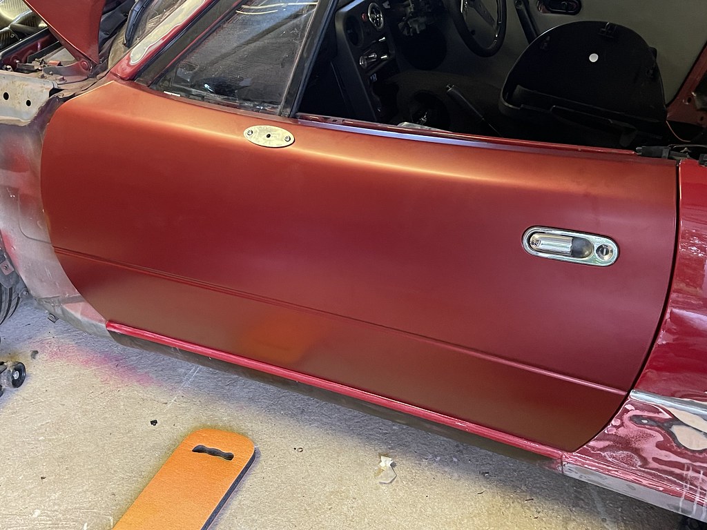

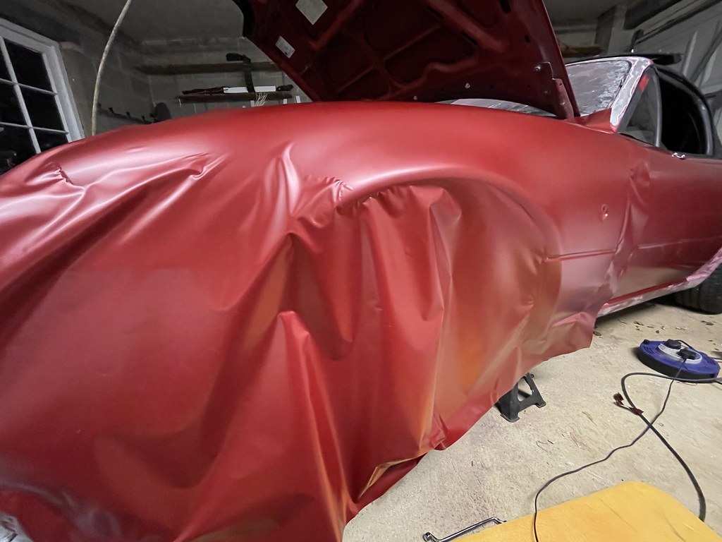

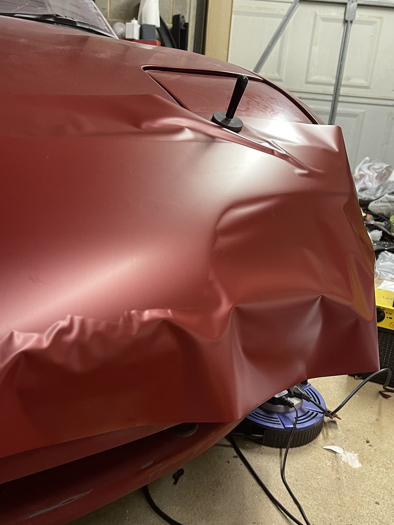

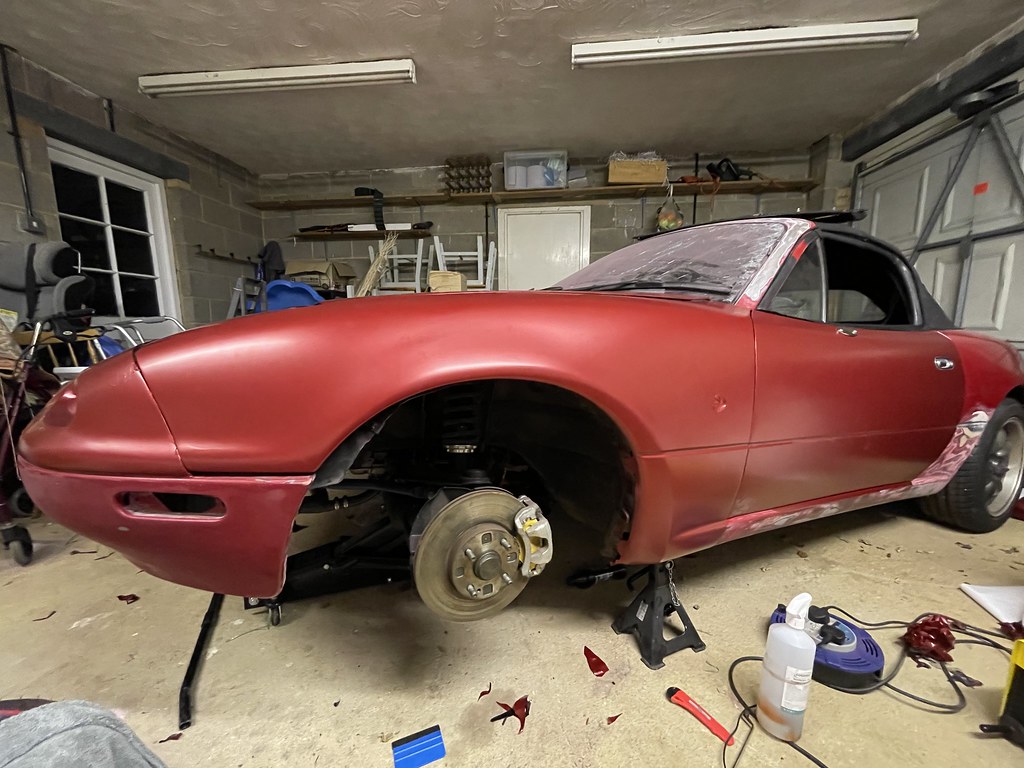

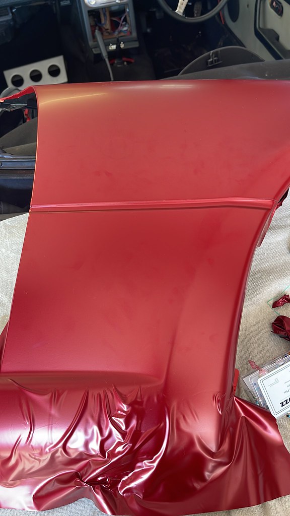

Wrapping

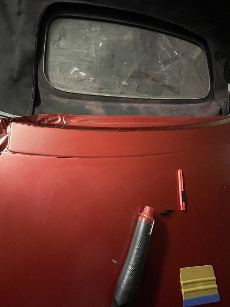

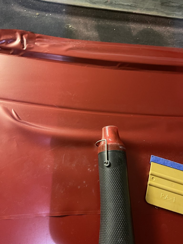

The wrapping is coming along fairly well, but as i’m a complete novice i’ve obviously had to redo some bits and i’m not entirely happy with all of the finish. But anyway, here is where I am up to.
Imgur
Imgur
Imgur
If any of you fancy giving it a go yourself at any point, feel free to drop me a message and i’ll run you through the things I have learnt. I am by no means an expert but with practice I have managed to get decent results.
The key to getting a good finish is the same as using any other medium really - making sure the body panel is prepped well; sanding to an even and smooth finish, cleaning thoroughly, using isopropl alcohol and lastly using an airline to make sure there is no dust.

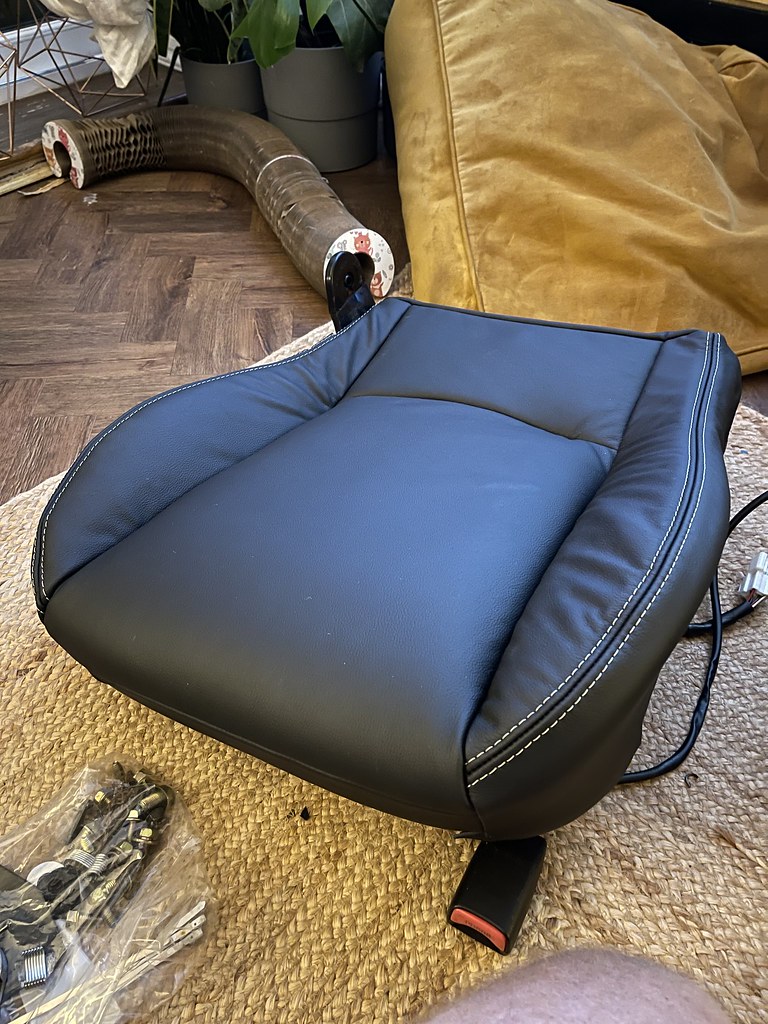

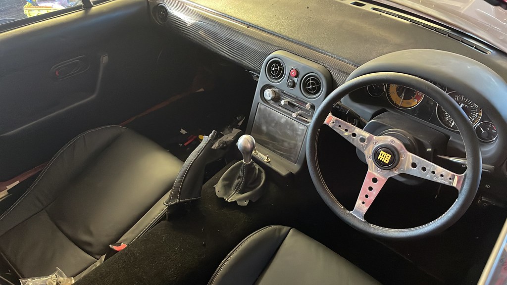

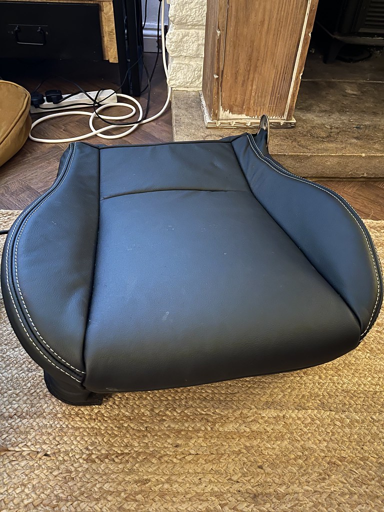

Seats

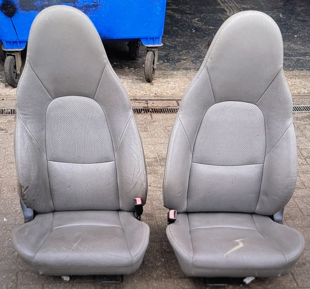

As you may be aware of by now, I frequently change my mind on just about everything. This is now about my 5th pair of seats. I’ve decided to use seats from an NB2 which I am currently through the process of retrimming using the ā€˜kit’ from mx5parts:
https://www.mx5parts.co.uk/leather-seat-cover-mk25-p-3417.html
I say kit. No instructions and I.L Motorsports themselves told me that the covers were not meant for home install, instead I should send them to a saddler! Anyway, I thought i’d crack on and they aren’t looking bad.
Again, if anyone else fancies a go, let me know - i’ve discovered some workarounds to make it easier if you are blessed with Cumberland Sausage fingers like me.

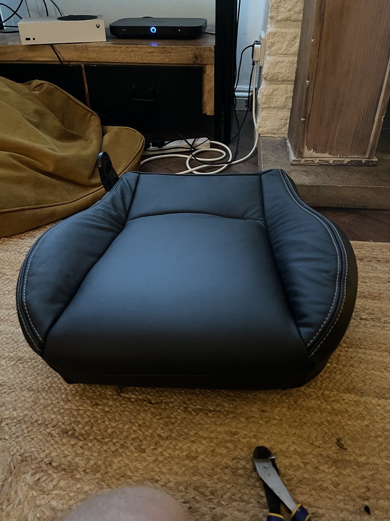

Anyway, the seats started out looking like this:
Imgur
And currently look like this:
Imgur
Imgur
Imgur
A little bt of fettling is needed but i’m probably be overly harsh on myself - I guess overall they are looking good!

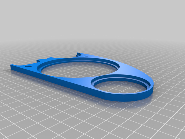

Linked to the above, i’ve decided to get a gauge face made for prototyping purposes with the Raspberry Pi and screens. The internet as they say, is your friend. I don’t know who they is, but they’re mostly wrong and it’s full of anker :smiley: :smiley: But Thingiverse and this forum at least, seem to be frequented by mostly sane people! Someone has gone to the trouble of designing a KG Works style gauge face here:
which I then uploaded to a website called Sculteo:
And for about £30 they will print it in a 3D resin which is smoothed and coloured.

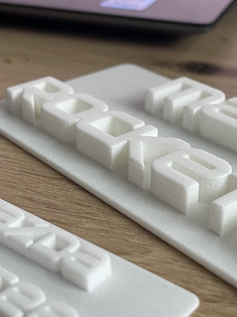

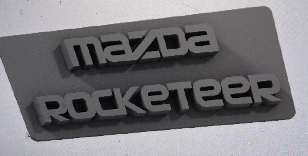

As well as that, I custom made a Rocketeer badge. Many people would argue (quire rightly) that I should be spending more time finishing my car and less time pissing around on the internet. But as I do spend too much time pissing around on the internet, here we go (I took the photo on my phone which is why it looks weird!):
Imgur
I used the Mazda font and then sent it to a designer on Fiverr. If you are in to this kind of thing, Fiverrr is a brilliant resource for all kinds of things. For £9 a guy created it in a 3D format for me which can also be printed out by the guys on Sculpteo.

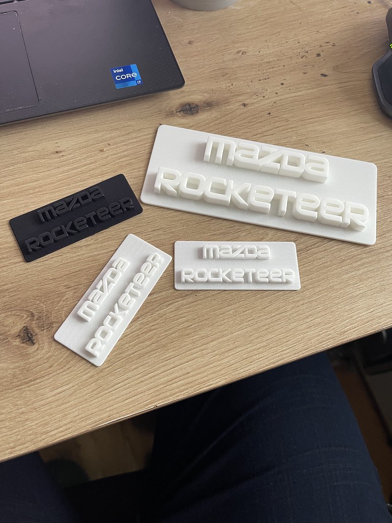

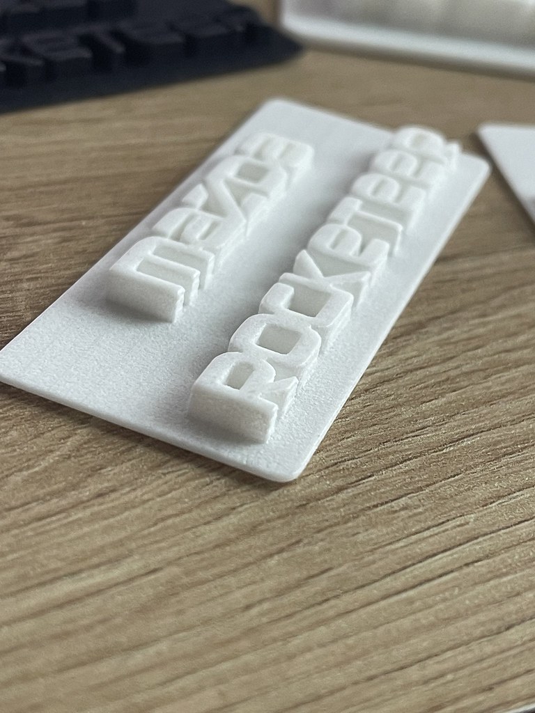

Just a little update - my 3D printed badges arrived and despite some warnings from Sculpteo about the smaller ones having the potential to fail, they all turned out really well.
Imgur
Imgur
Imgur

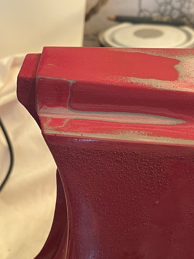

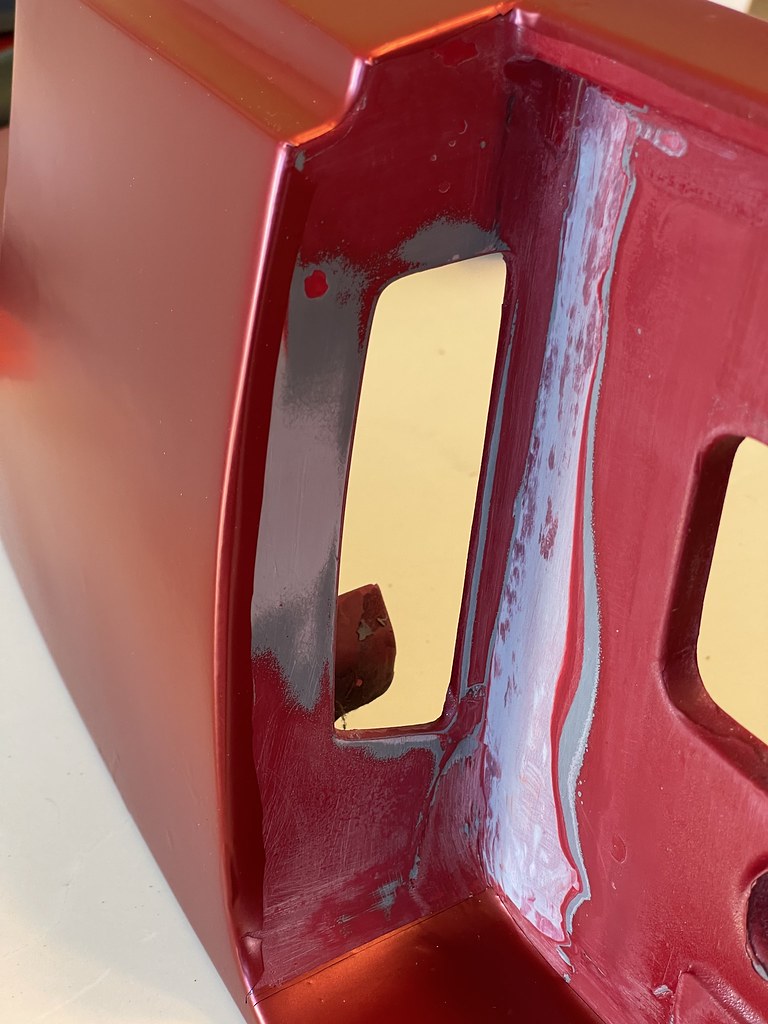

Has anyone got any experience of painting these kinds of surfaces?
I’m unsure on the colour - they were printed in white and black. before I ordered them I thought I would go with black but the lettering kind of gets lost in the darkness of the black and white looks a bit tacky. Gold?

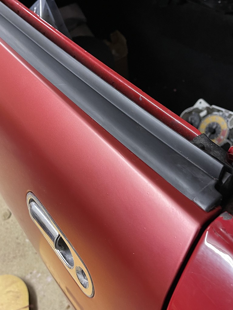

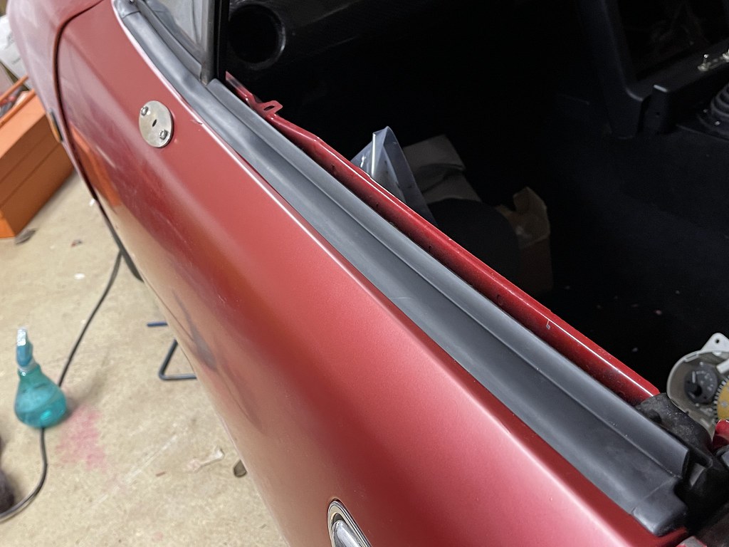

I also fitted new Genuine Mazda window seals. A note about these learnt the hard way…install the new clips on the seals first rather than fit the clips in to the recesses and then try to fit the seals on to them. With my sausage hands, it took far too long to get those clips back off again!
Imgur
Imgur
Imgur

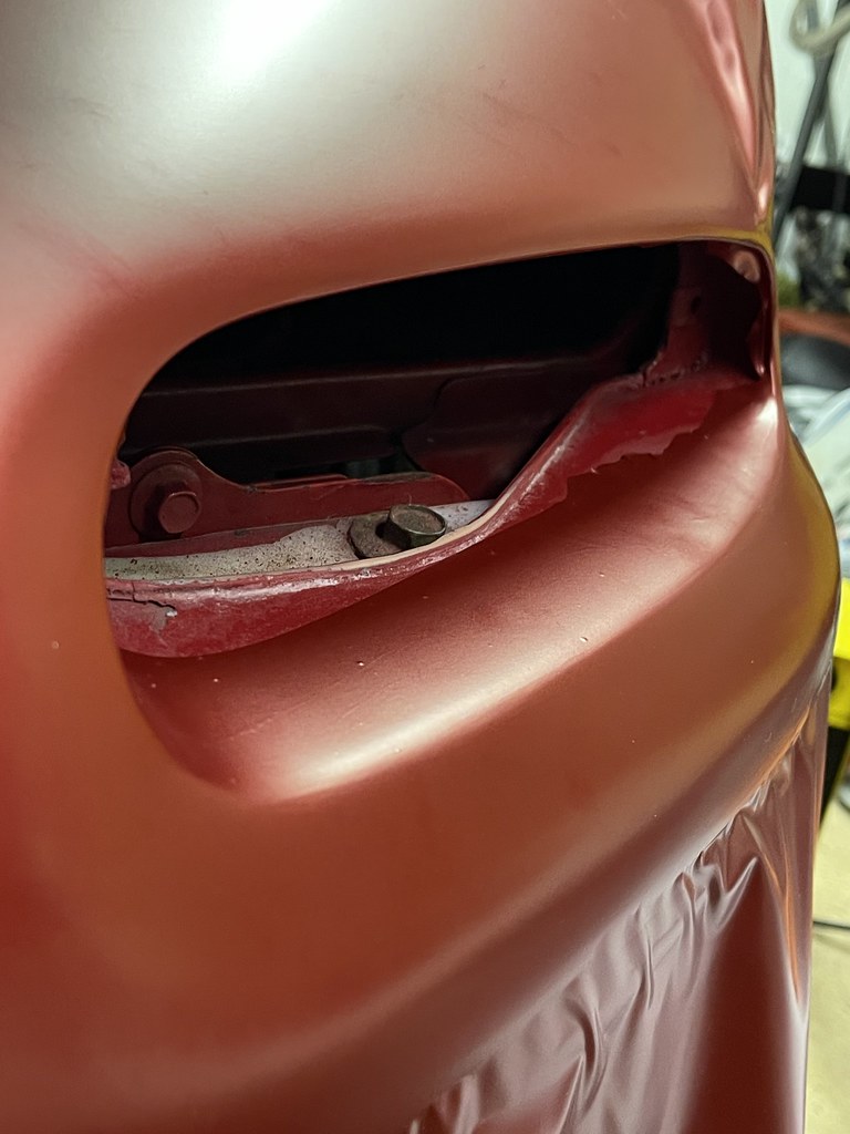

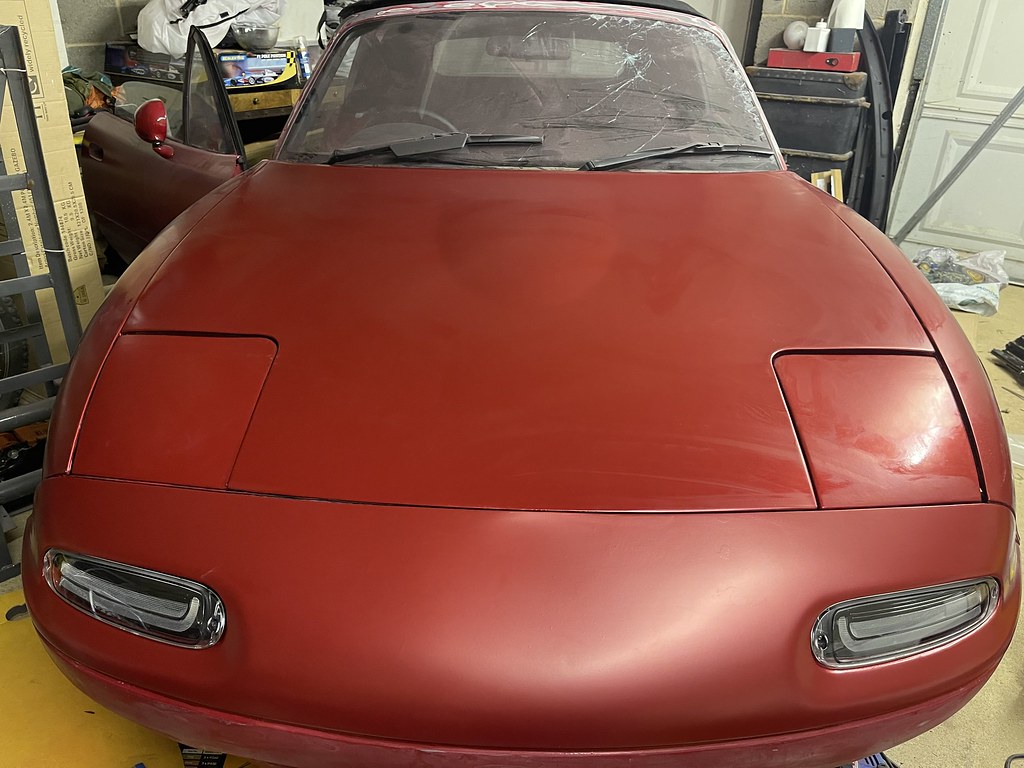

Hi all,

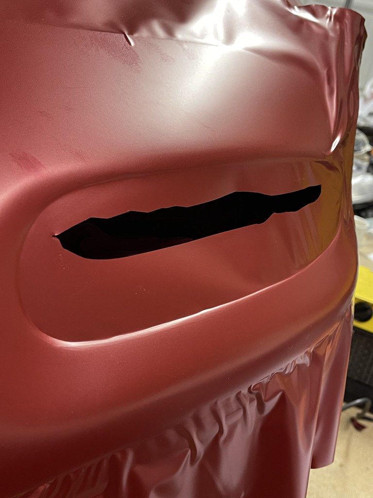

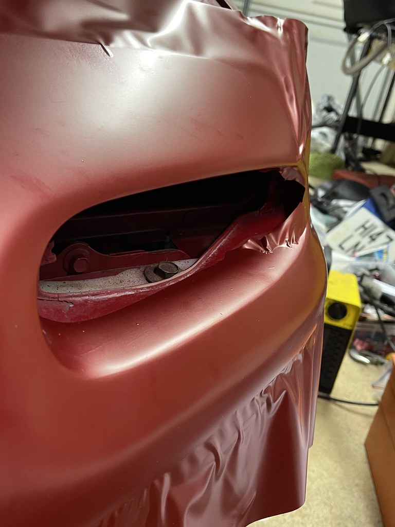

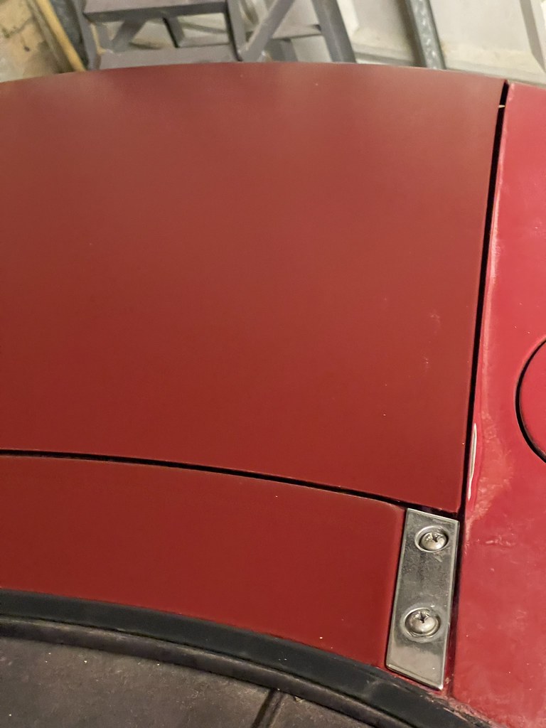

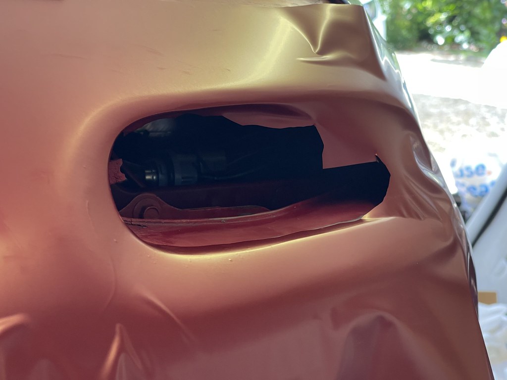

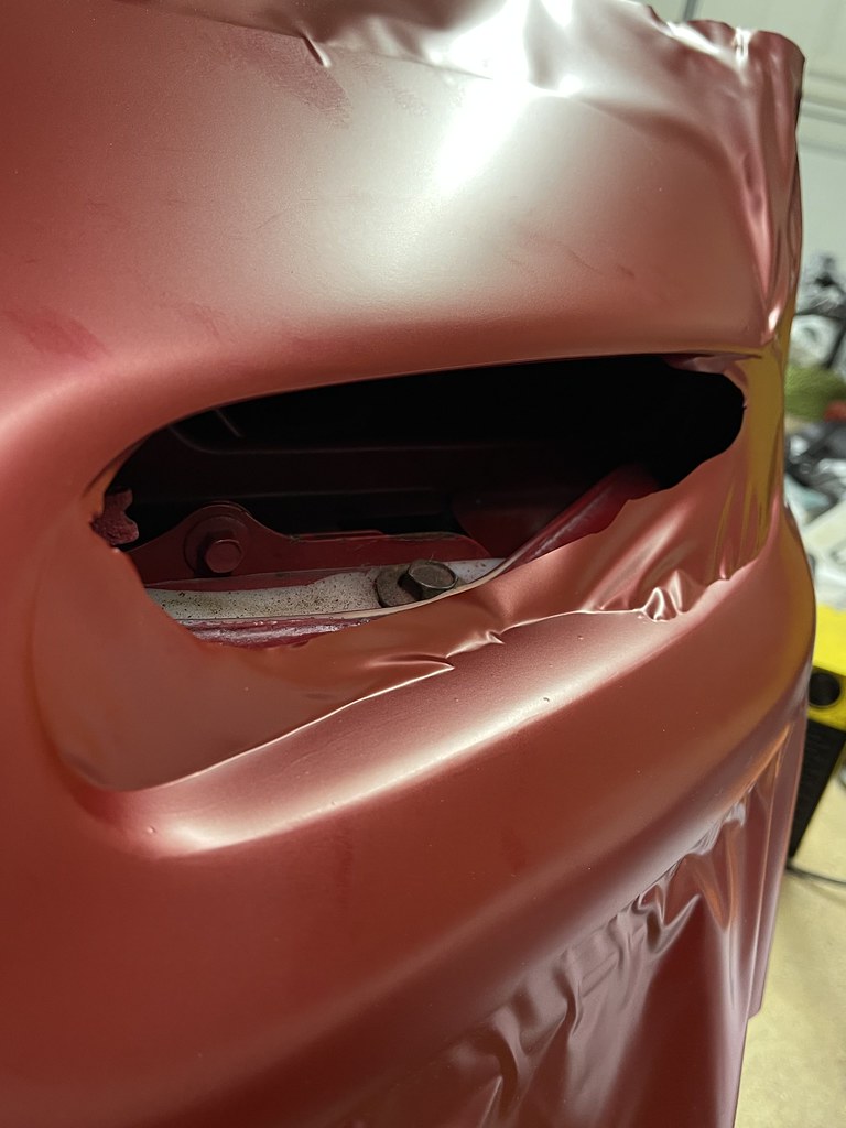

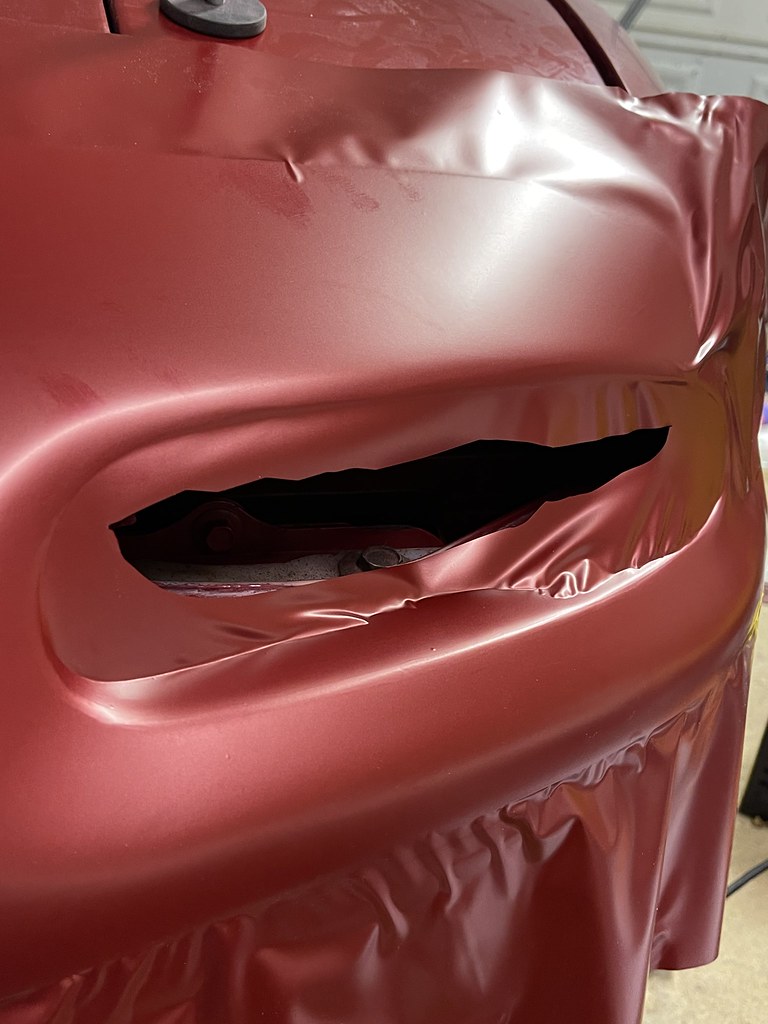

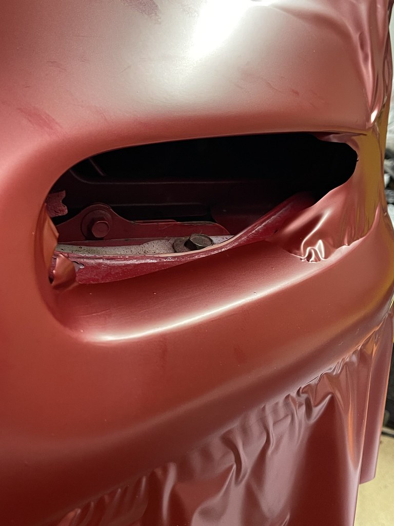

Not much of an update this week, but I decided to re-wrap the top half of my front bumper as I wasn’t happy with the finish around the sidelight area.
These kind of recesses are tricky as the depth you need to wrap to is probably slightly too deep just to use heat to stretch the film. However, getting a good finish with an inlay is also not easy! Last time I did inlays, this time I just used heat and it certainly looks better.
Imgur
Imgur
Imgur
Imgur
Imgur
Imgur
Imgur
Imgur

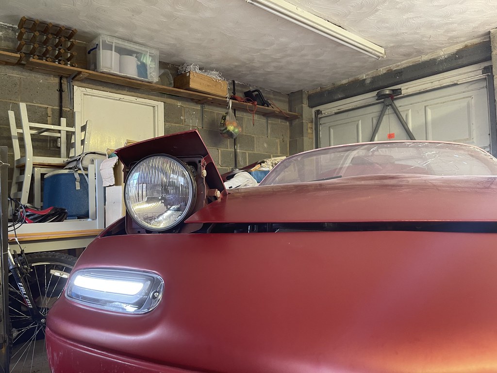

Not sure why the headlight lid on the drivers side looks a different colout - must be the lighting!
Anyway, it is looking quite good I think for an amateur job.
Next job is the lower front bumper, then I can fit the number plates and front badges which is going to be a BIG moment!! :smiley:

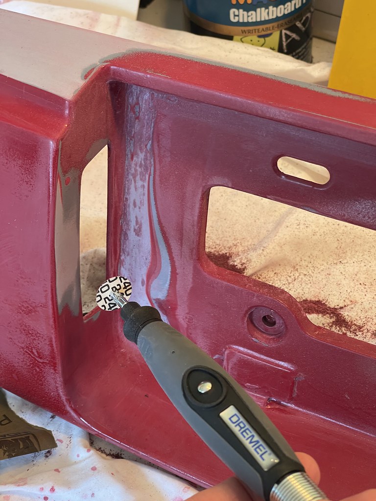

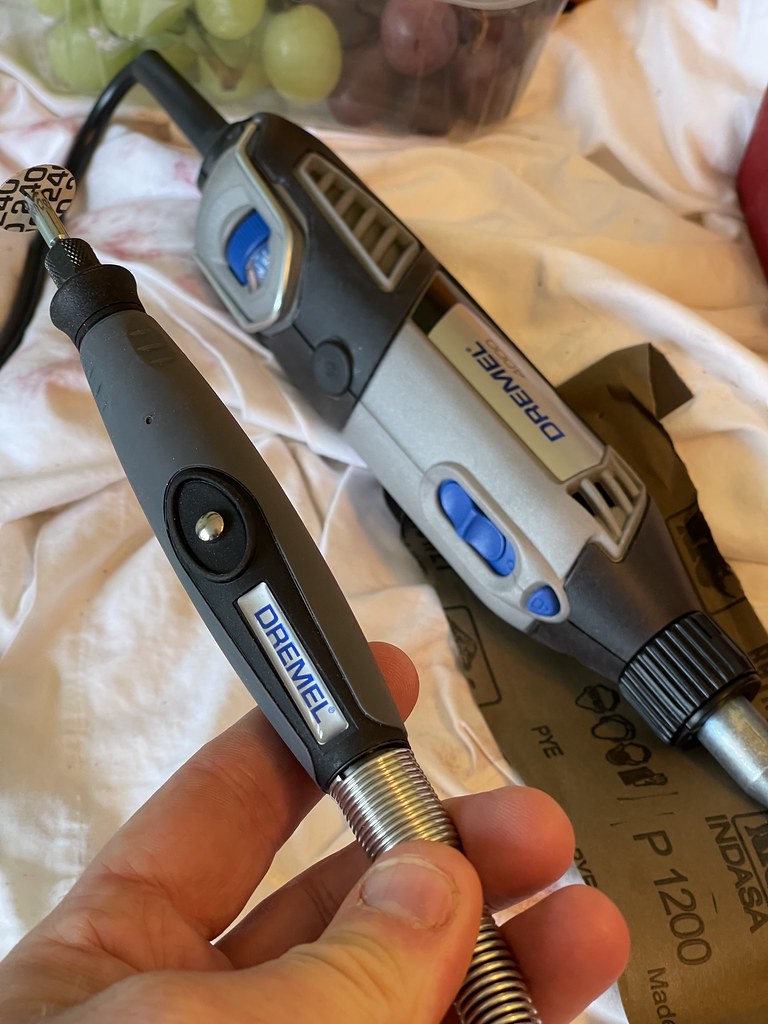

I got myself a Dremel with the flexible attachment which is a handy thing for getting in to the nooks and crannies of the rear number plate surround. I used it to try and get the panel as flat as possible which was quite a bit of work as it had had some dodgy paint done in the past.

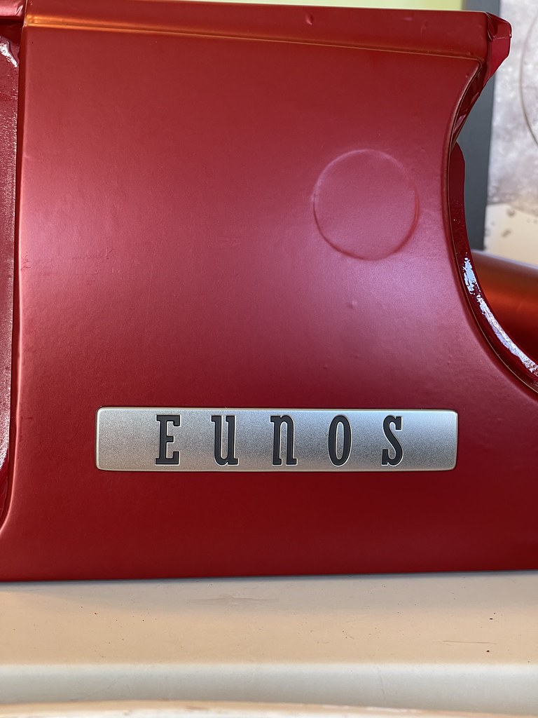

Because of the number of shapes and coves in the back panel, I am having to wrap it using multiple pieces, which is a lot of work and hard to get a good finish. Like with the rest of the car i’d score it as quite good which I am having to convince myself is good enough as I have been pi**ing about with this for long enough!
Imgur
I also wrapped the piece ahead of the bootlid, so now the back of the car is coming together.

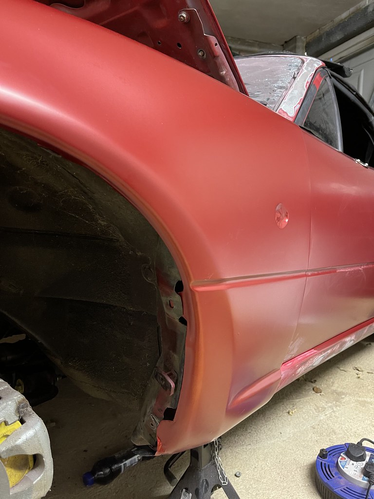

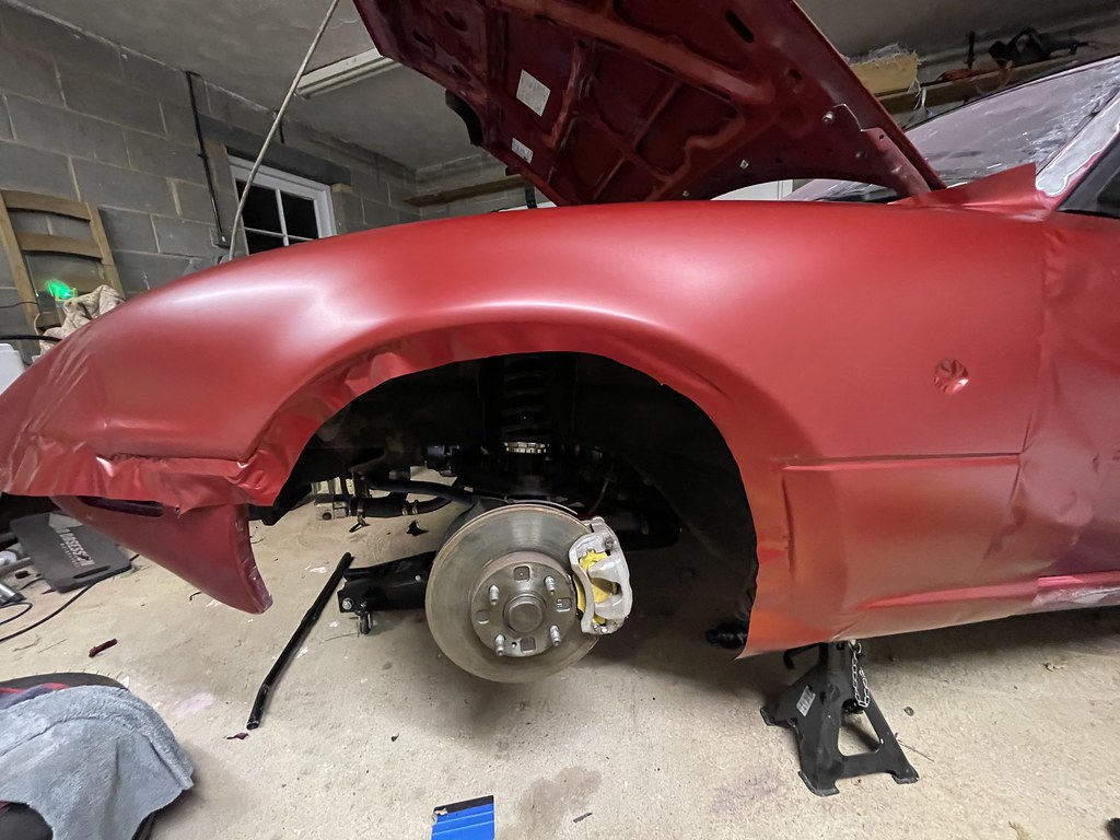

So aside from writing a list, I managed to complete some of the things from the list and the interior is now starting to look quite nice. It needs a clean and a hoover but the seat bases are upholstered and in and it’s all looking quite matchy matchy. Pleased that the MOMO steering wheel trim (which was a 40th present from my brother) alsmot exactly matches the stitching on my leather seat covers I got from ILM, it looks like I planned it that way, Result!
Imgur
I re-wrapped the front passenger side wing, which is probably the best panel I have done yet.
Imgur
Imgur
Imgur
Imgur

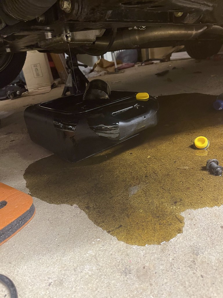

Believe it or not, I had to do a two year oil change on my Rocketeer even though it has never been on the road. All was going well, removed the old oil, changed the filter, put the new oil in…i’d failed to put the drain plug in. Classic. Waste of money. Oil all over the in-law-to-be’s garage floor. Pride (which there was still some evidence of) vanished. So, we’ll try that again today…!

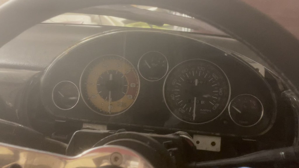

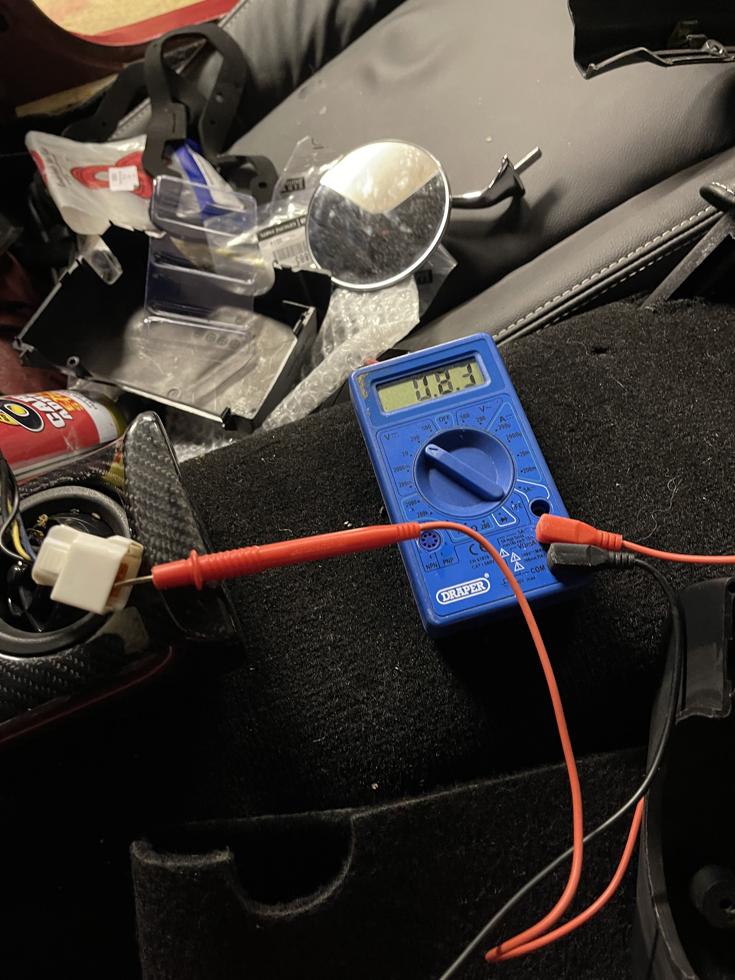

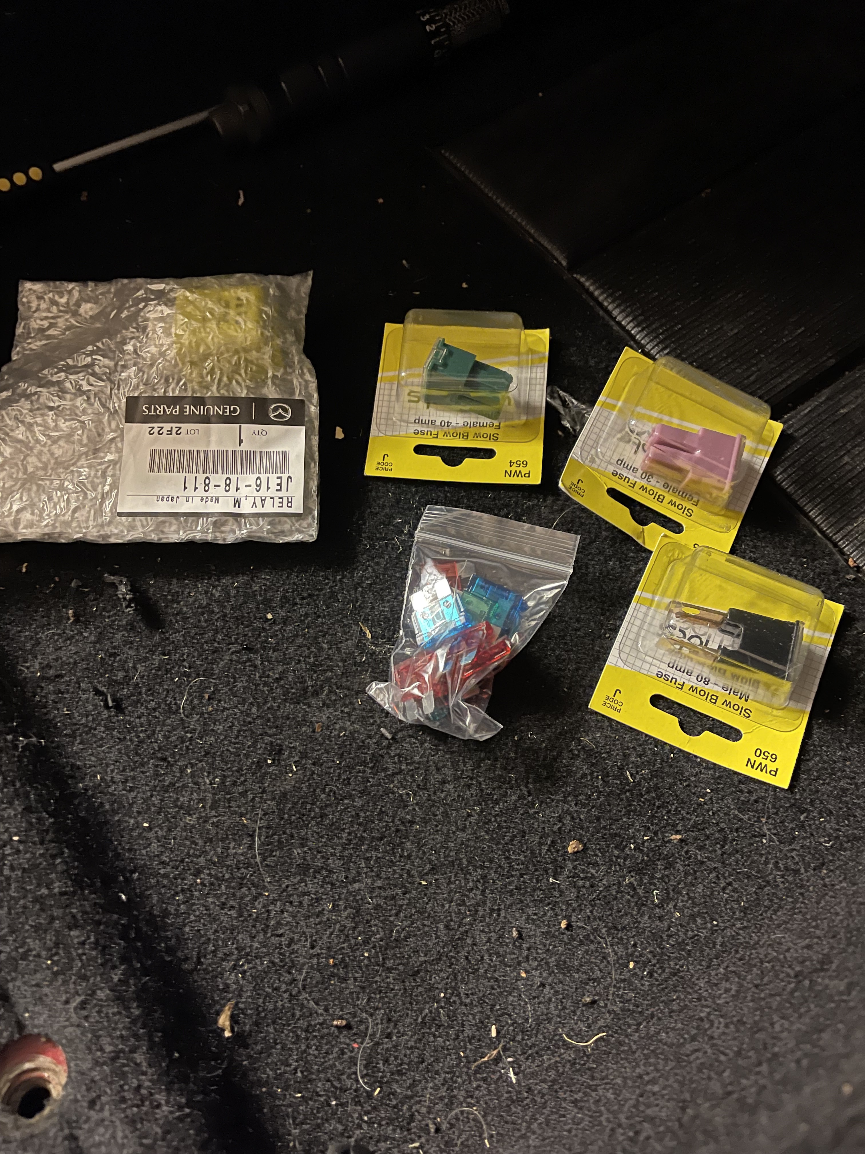

My fuel pump isn’t priming anymore.
The behaviour in the video suggests a grounding issue no? The dash lights are coming on until the relay clicks.
Imgur
The only thing Ive changed since it last worked was removing the Zoom starter button. However, I’m fairly sure that the wiring wasn’t modified for that to be installed.
When I say the wiring wasn’t modified obviously the button was plugged in to the existing loom but that was just via the connectors that were already there.

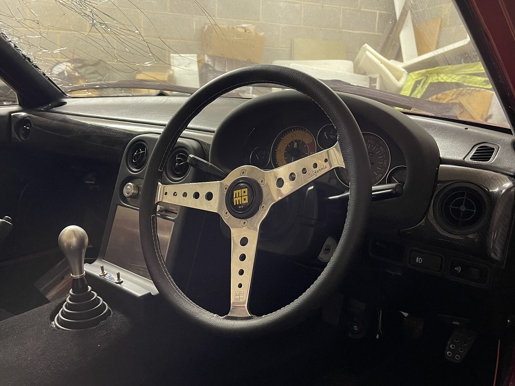

I haven’t really done anything with my car, having gone back to that place of just wanting to set fire to it.

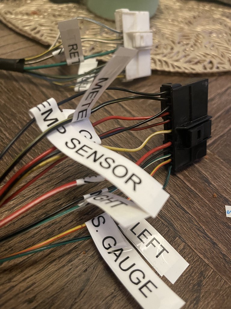

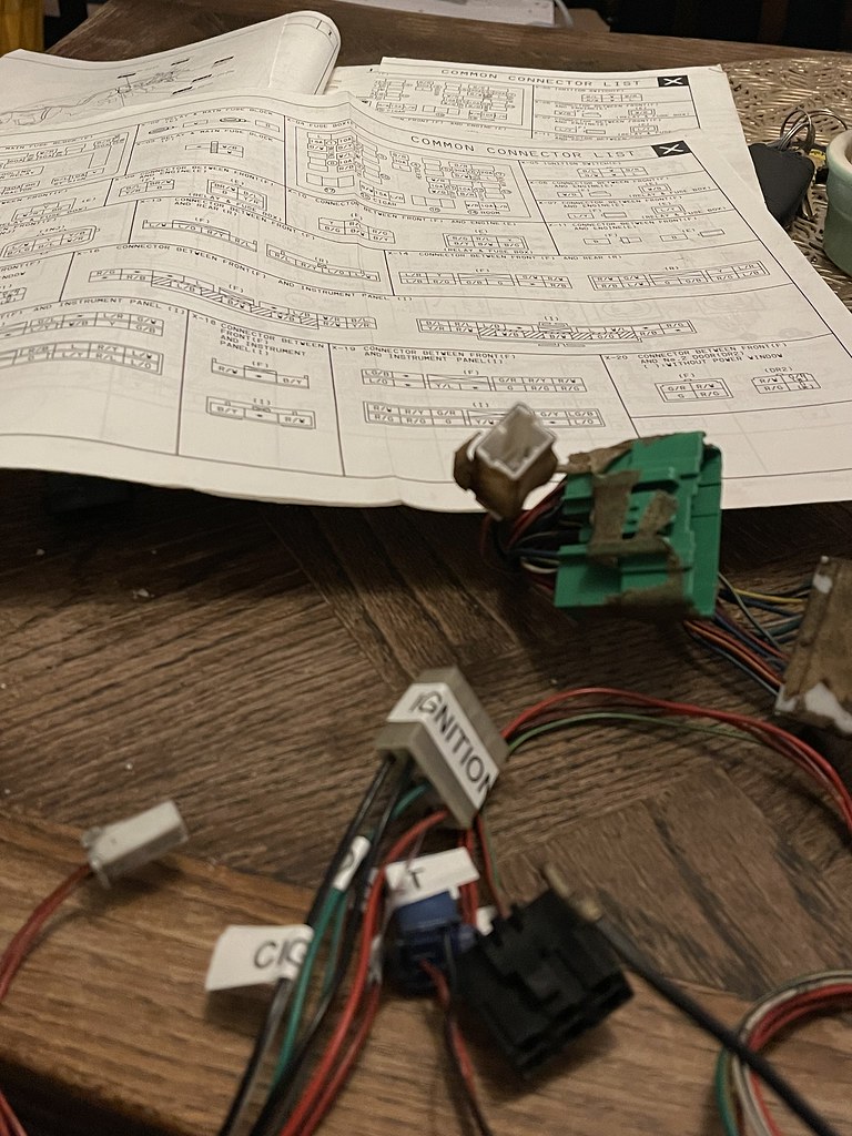

However, I got the label printer out, purchased a secondhand dashboard loom from eBay and set about labelling as much of it as possible to assist with working out where my electrical issue is.
Imgur
Imgur
Imgur
Unfortunately, the loom I purchased has been hacked about a bit so I can’t simply swap that one in, but hopefully it will help!
If anyone wants detailed photos of the loom (with labels) to assist with their own projects, let me know and i’ll send them over! It will save hours staring mindlessly at schematics!

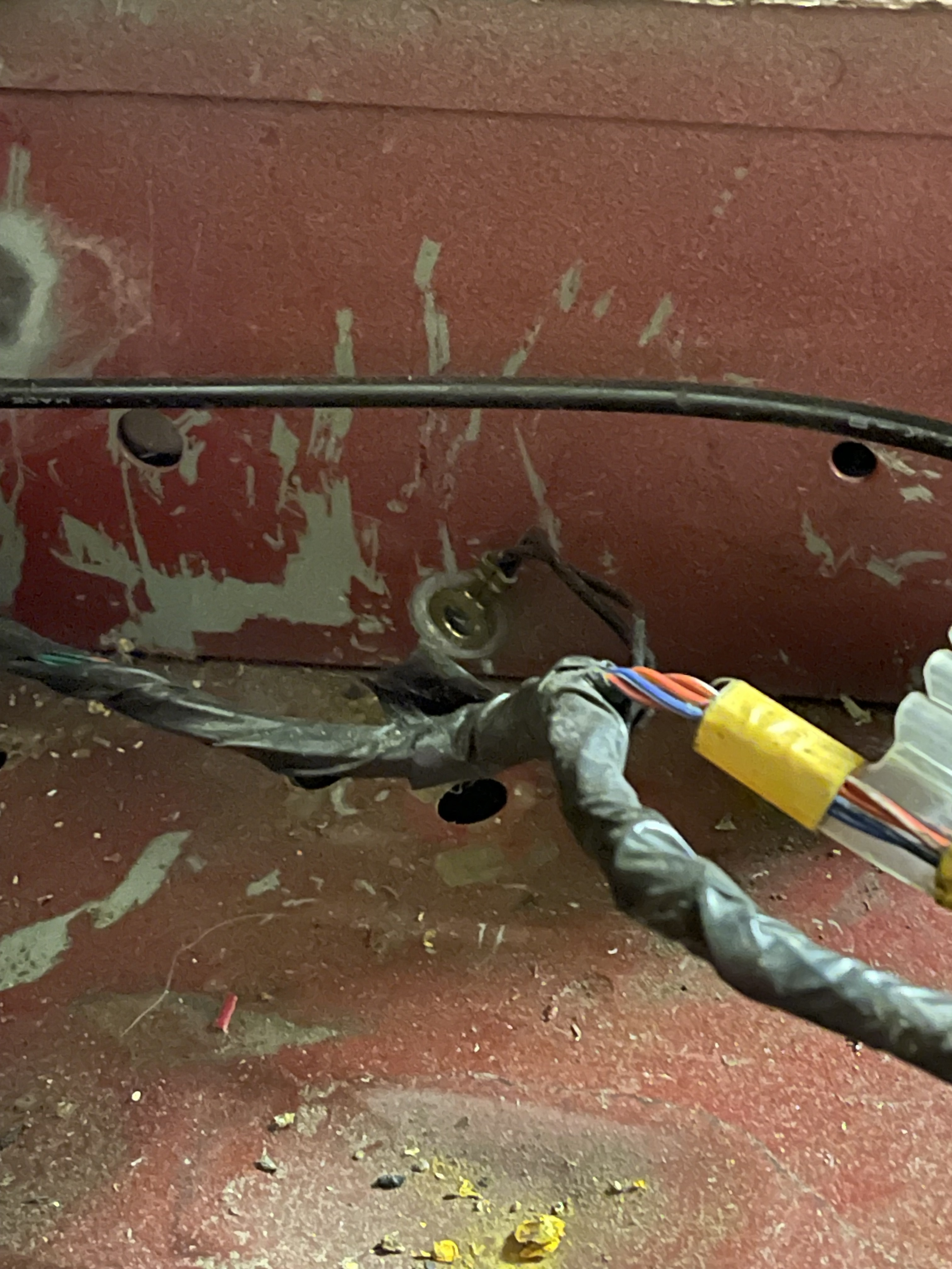

So i’ve changed fuses and fiddled about with the wiring and still not getting a song from the fuel pump. Honestly, the weirdest things seem to have happened to my electrical system during this build! Luckily, i’m a patient man :smiley: :smiley: :smiley:
I have spent a lot of time with my genuine wiring diagram (a great find on eBay!) and after removing the plug from the fuel tank, tested the blue and red wire with the engine cranking to see whether any power was reaching the fuel pump.
My hope was that it was! Whilst buying and fitting a fuel pump is a pain, it’s much less of a pain than trying to trace wiring issues!
Well it turns out it was neither! The ghost of the ground. This grounding point has been unattached for months and months and has run perfectly fine without it.
Anyway, after checking that there was voltage to the fuel pump (and what with the fact that it just randomly stopped working one day) I gave it a go.
Hey presto! She’s running!
Another annoyingly obvious and easy fix to something I was approaching in an overly complicated manner!

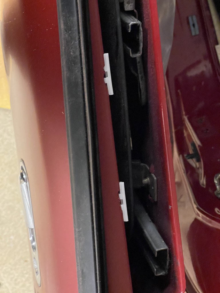

For anyone that is likely to want to take their door apart or change the glass heed my warnings - a) it’s a bit of a pain and b) don’t take your door off until you have got the window down halfway, I learnt that the hard way! You need to do that to be able to properly get to these screws:
Imgur
When removing the quarterlight, there are two screws at the top, one is fairly obvious whilst the other is not - you have to look under the rubber flap on the corner. Mine was infilled with 30 years of detritus, so I wouldn’t have found it if I didn’t know it was there.
When you get to actually removing the door, the hinges are very easy and obvious but this little check strap can be a fiddle - the best thing to do is use a punch and a hammer.
