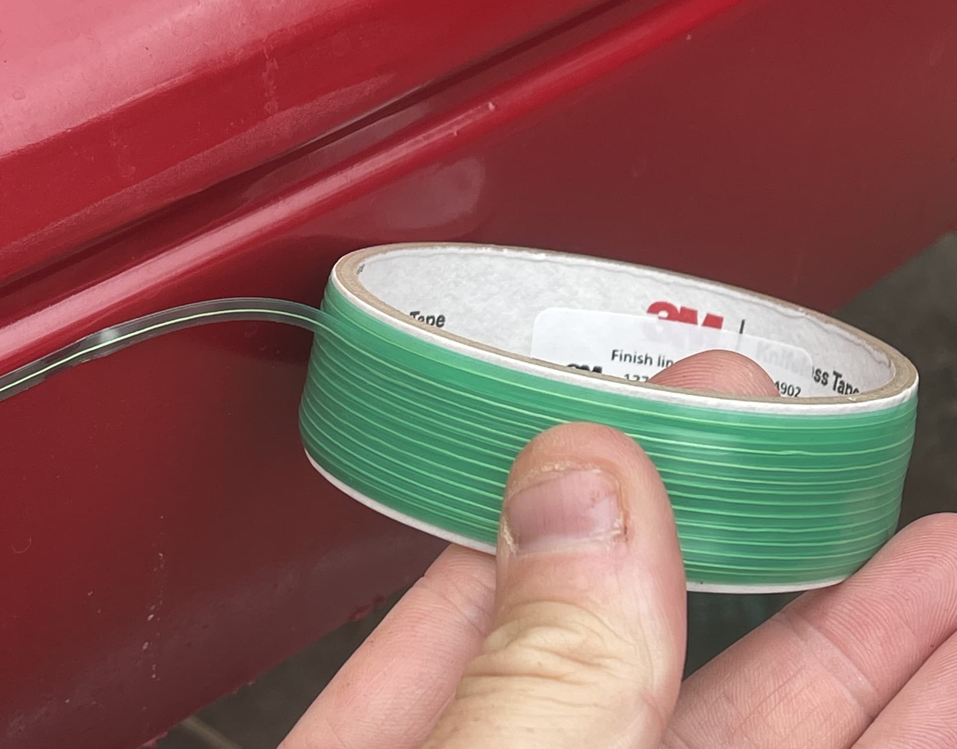

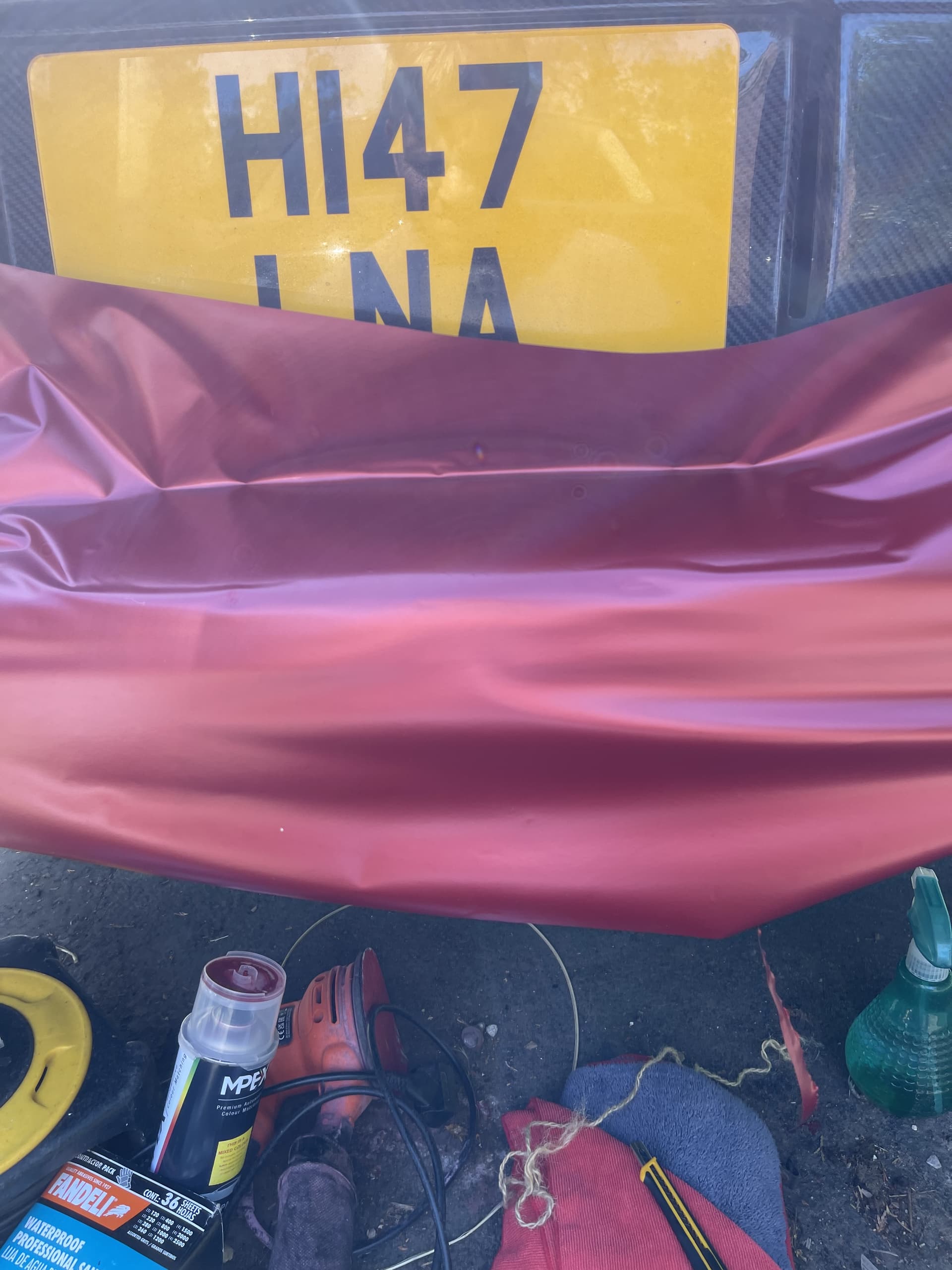

Wrapping
As I have mentioned before, bodywork prep is as important for wrapping as it is for painting. I havenāt done loads more, because getting the paint in to a wrappable state takes longer than the actual wrapping. However, the windscreen surround has now been completed. Aside from a couple of dodgy bits (which I havenāt pictured deliberately!), it looks quite good.
I also did the filler cap (small victories! :D)

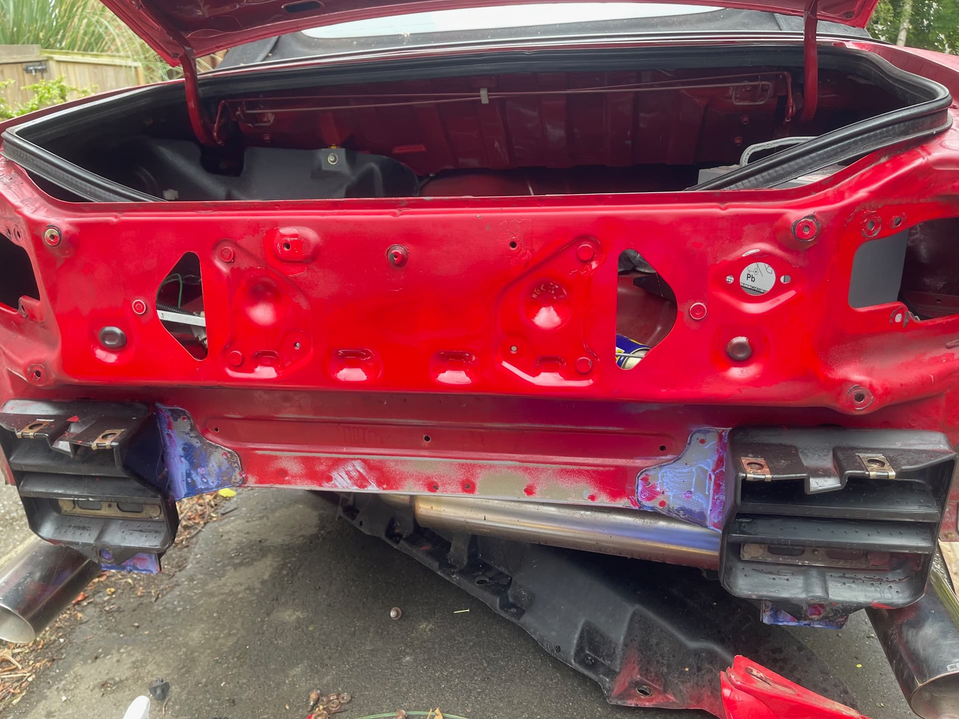

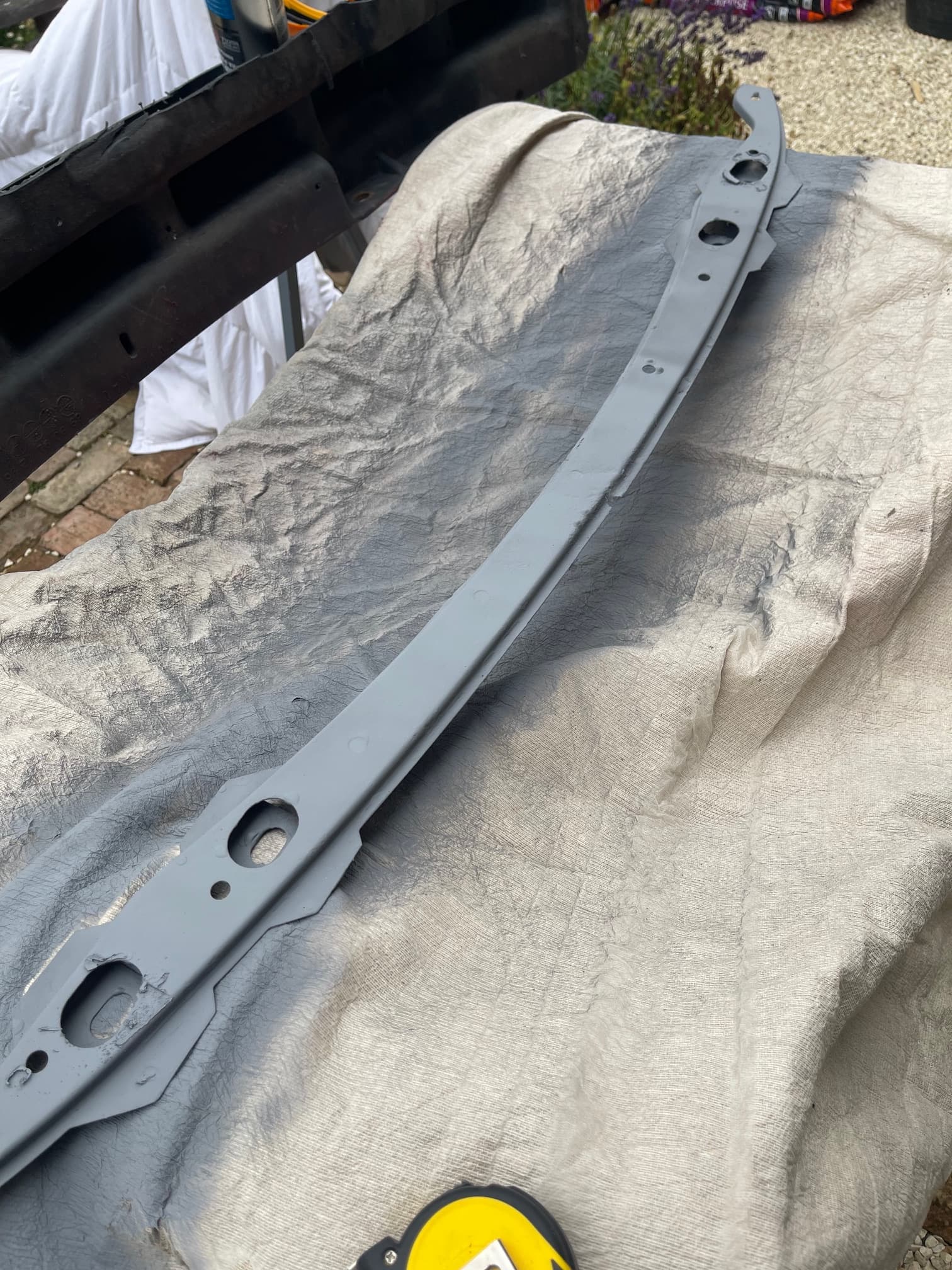

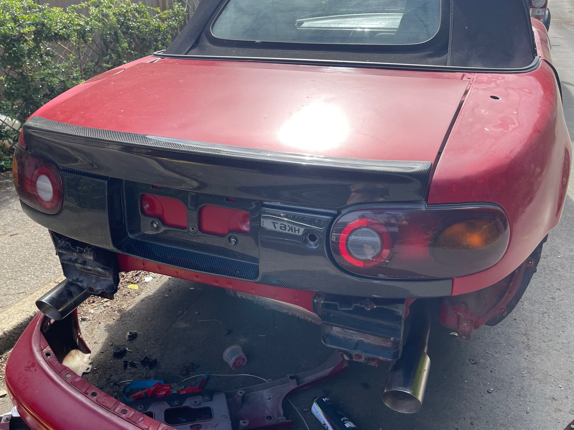

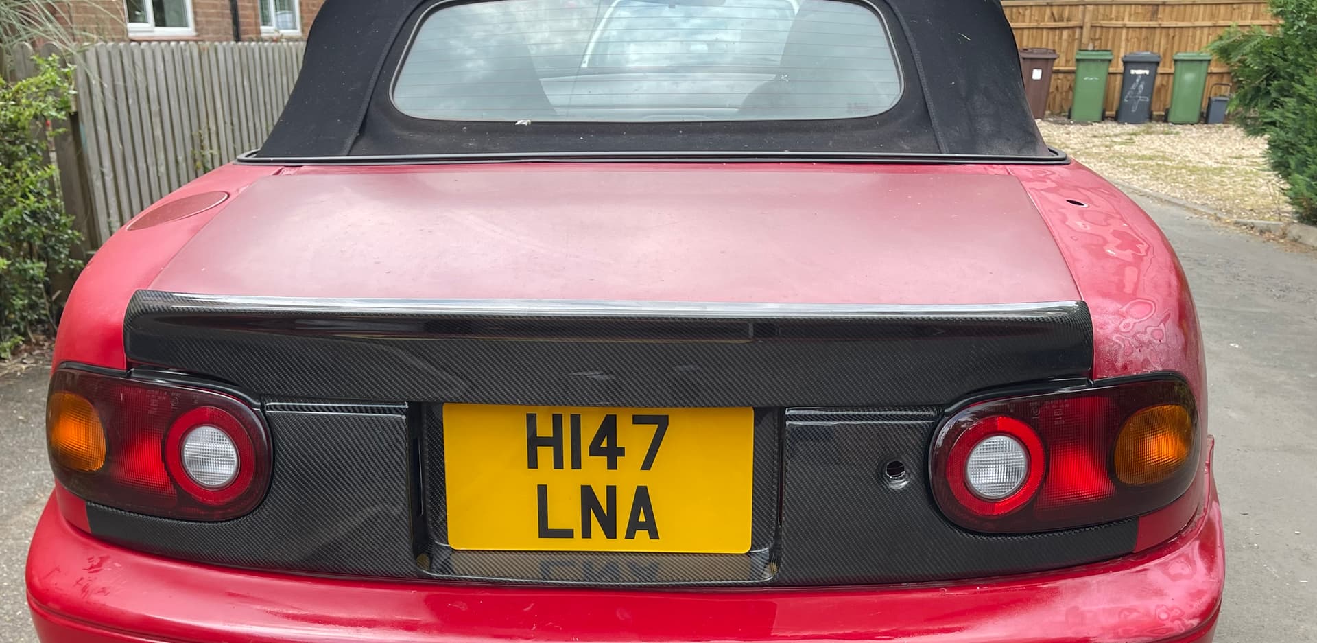

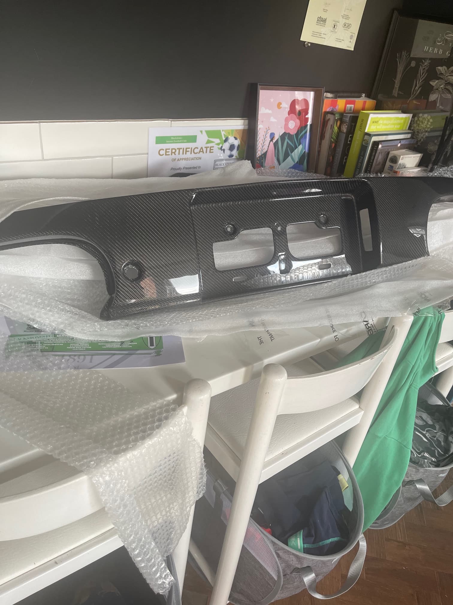

On that note, I decided to buy myself some carbon fibre so I donāt have to wrap that bit!

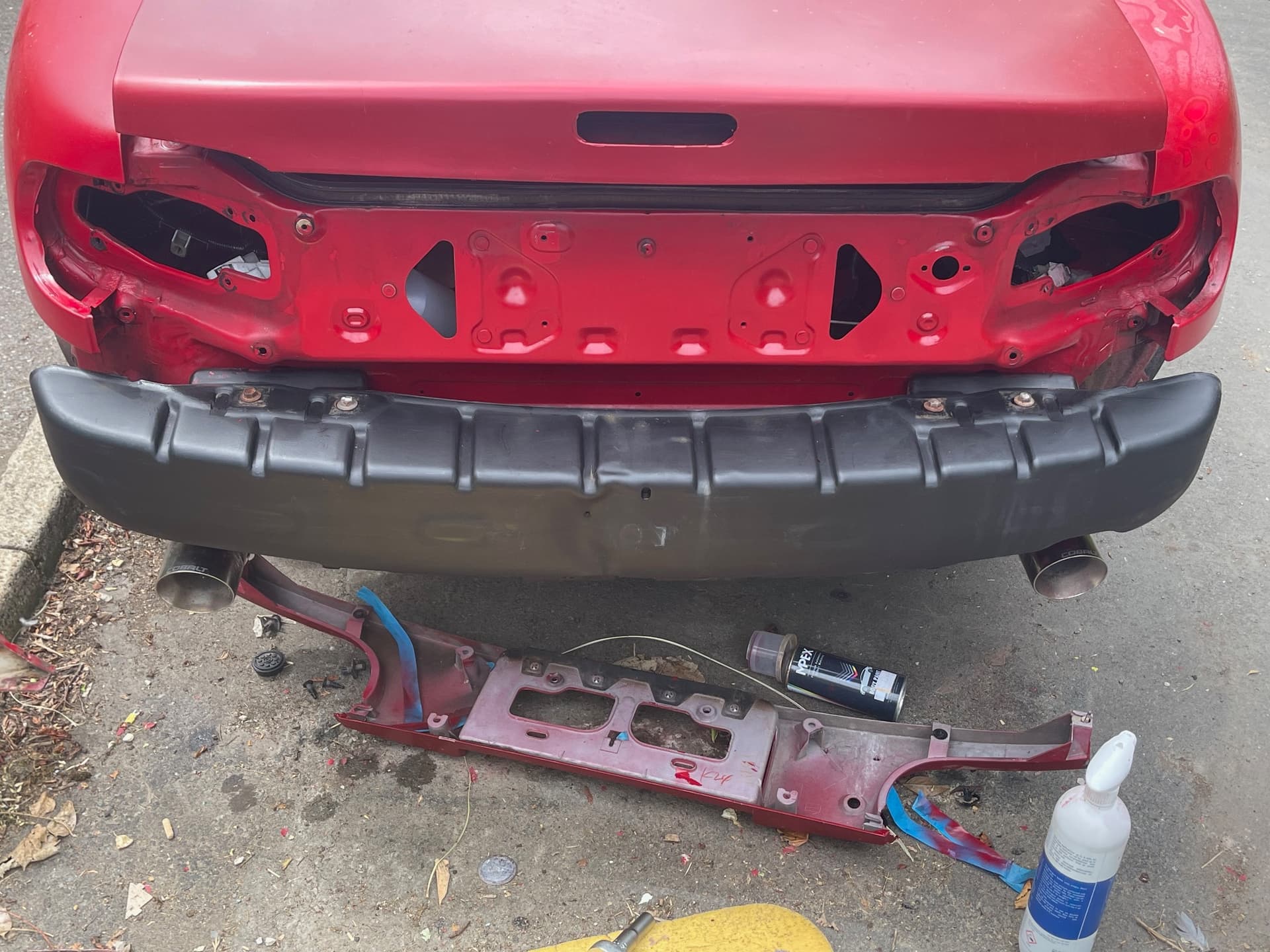

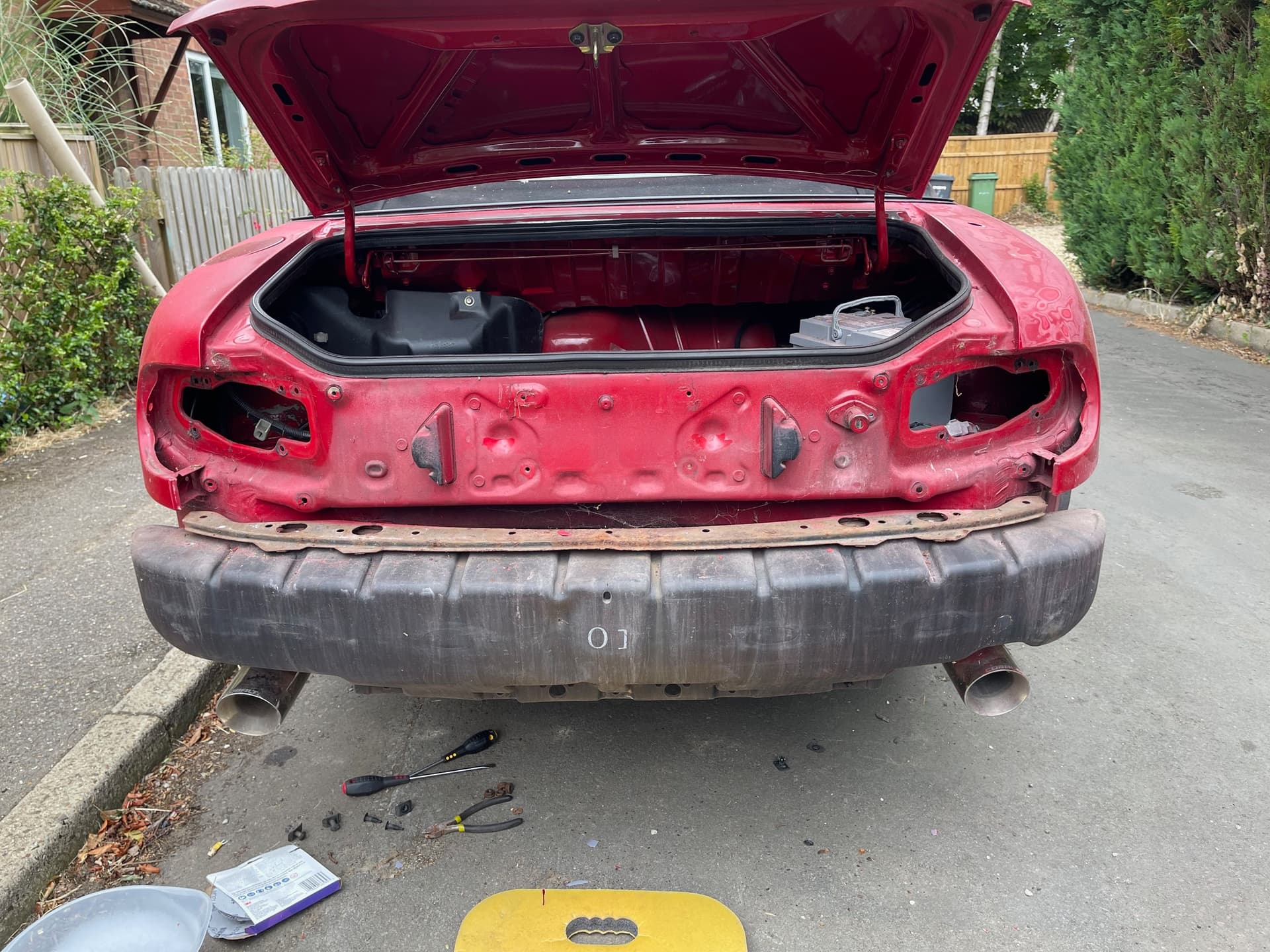

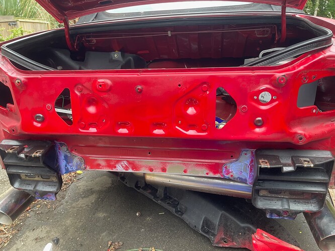

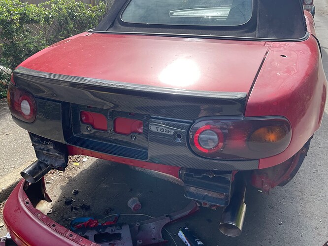

Obviously, me being me, I decided to take my entire rear bumper assembly apart and clean it before installing the new rear panelā¦and also me being me cleaning dirt in to wire brushing rust, rust converting, painting, yada yada yada.
Before cleaning
During Cleaning
After cleaning/and a bit of re-painting

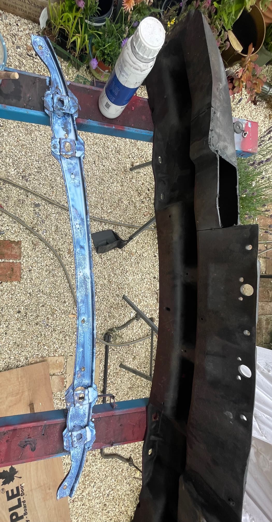

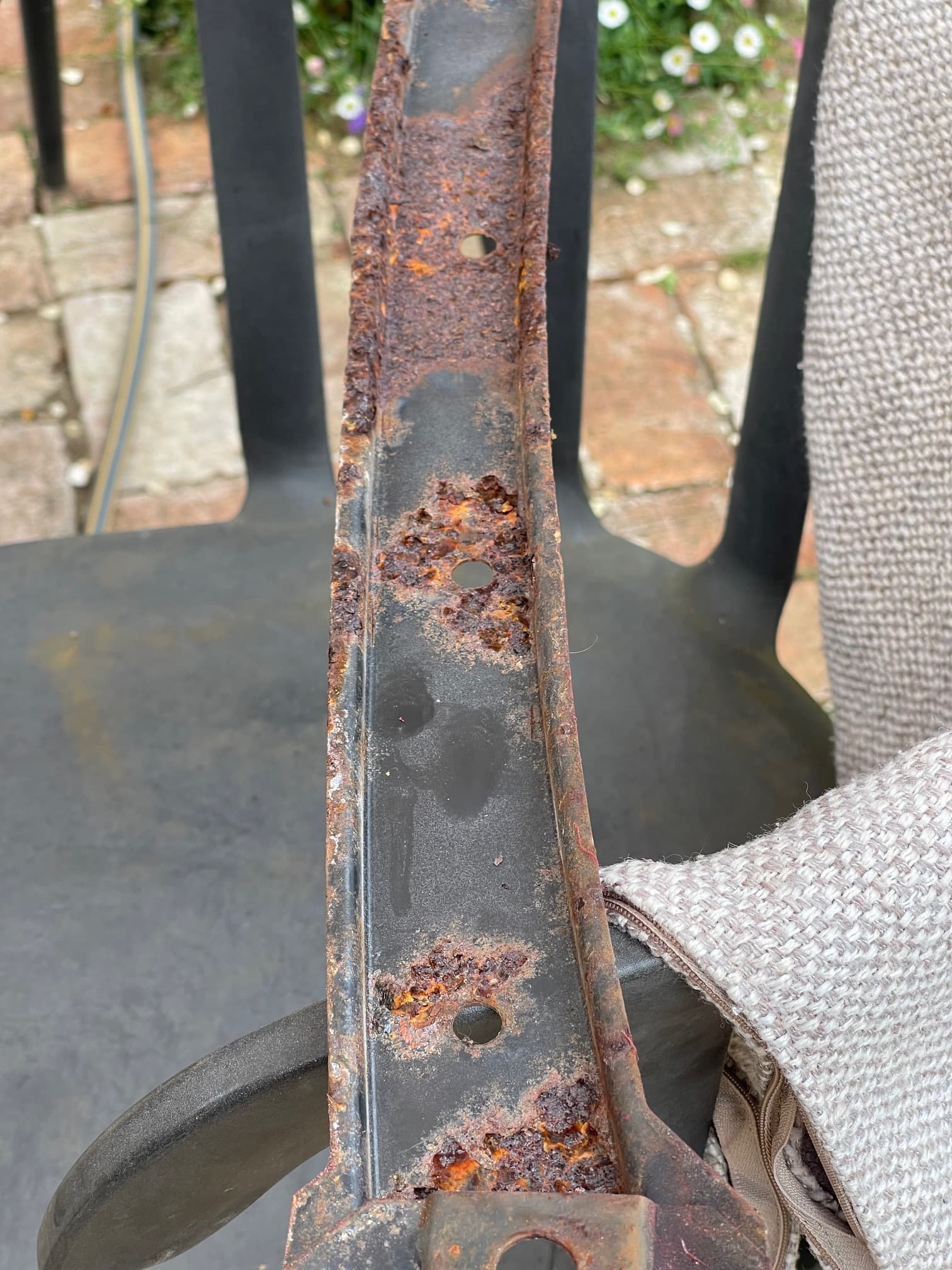

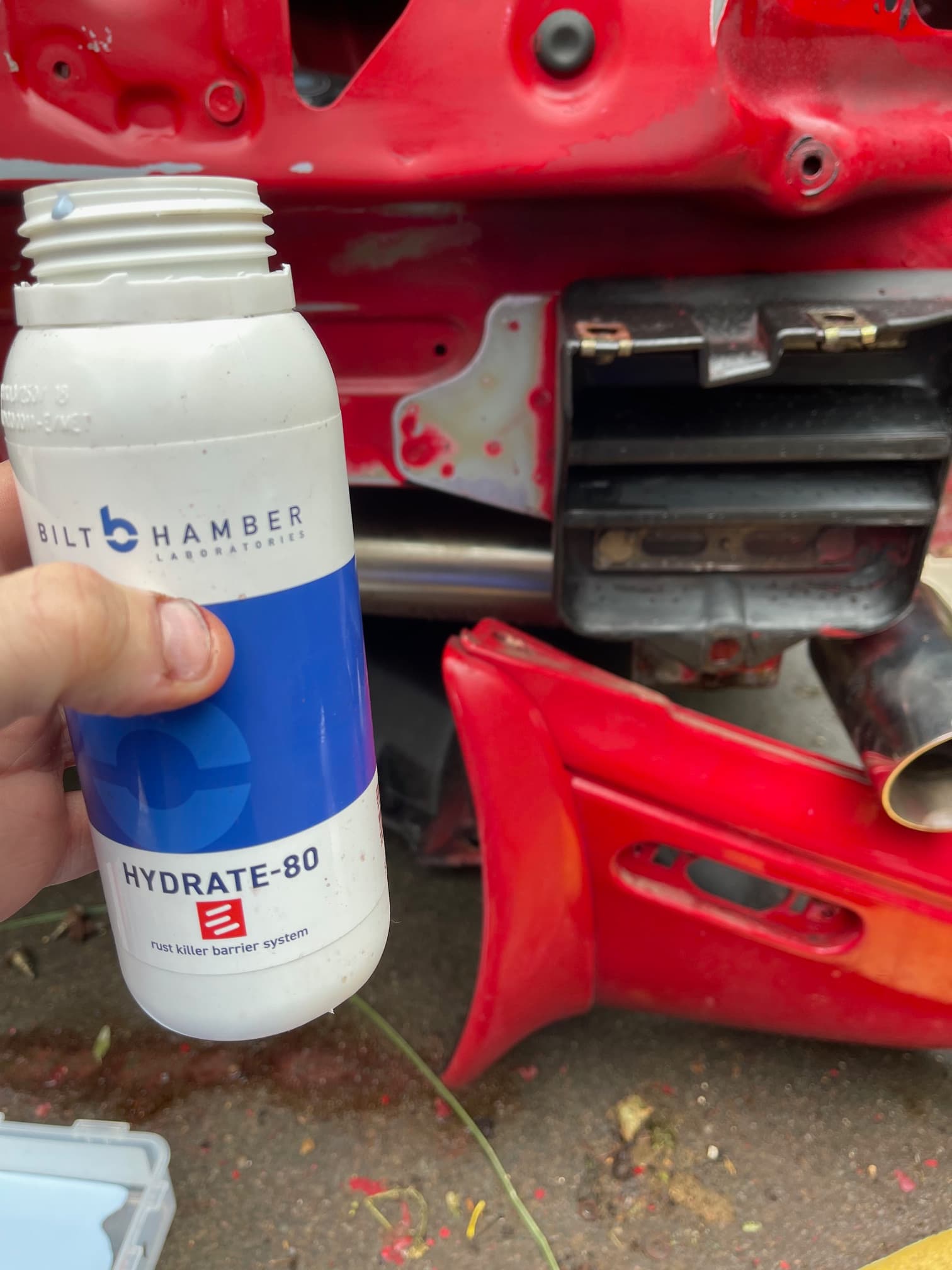

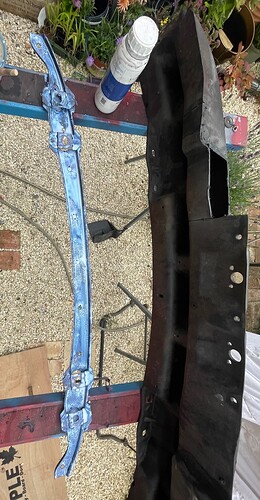

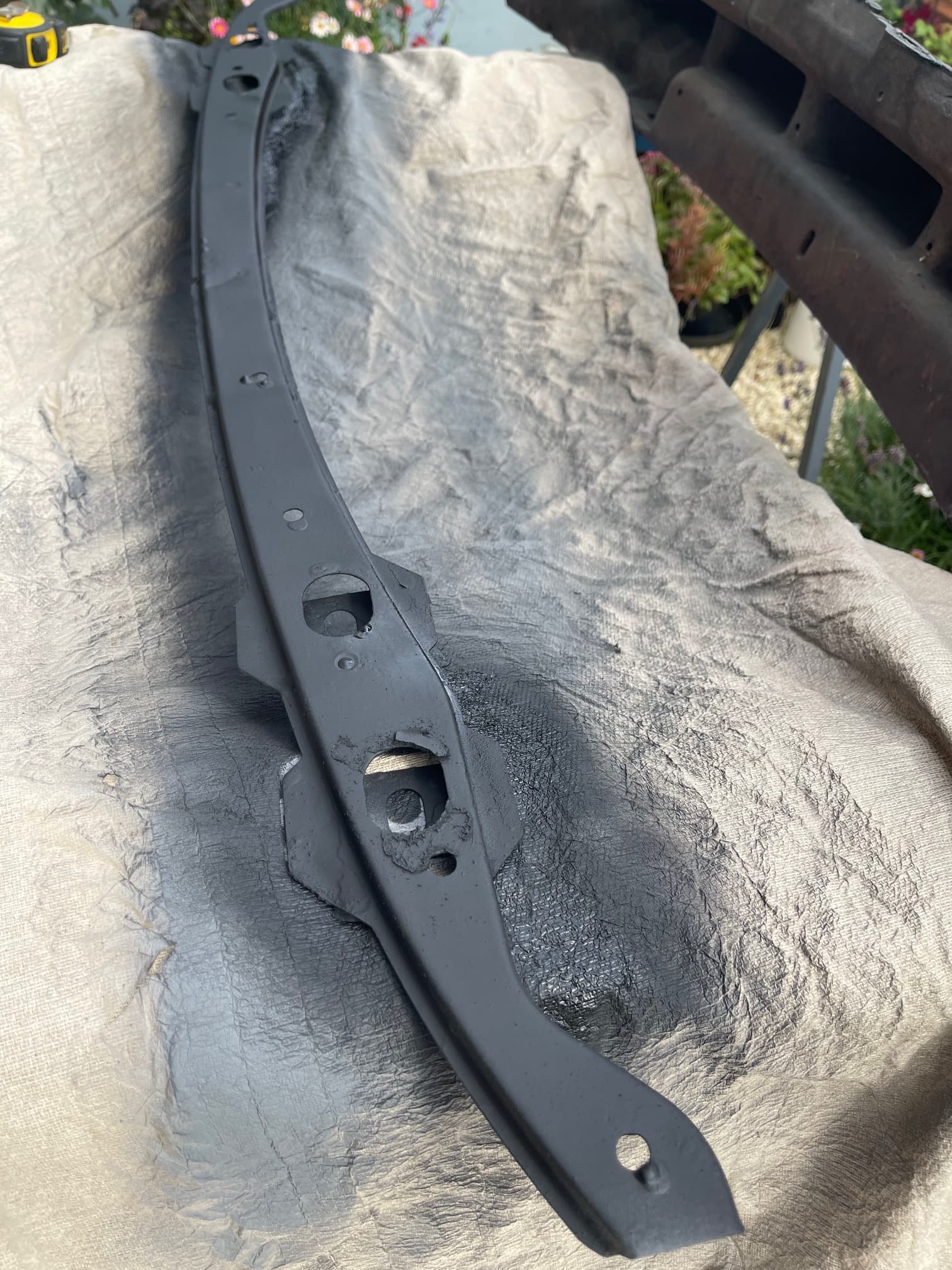

I swear by Bilt Hamber products so I used Hydrate-80 to give the rear bumper bracket a new lease of life.
Rusty Bracket
Protected bracket
Primered bracket
Painted Bracket
Hopefully now, that will last longer than me!
This is just a mock up of the rear carbon fibre bits. The spolier covers up a dodgy bit of wrapping!
So, progress. You could argue that what Iāve done is take more things OFF my car
but what this whole process proves is that to do it āproperlyā, sometimes you have to go backwards to go forwards!

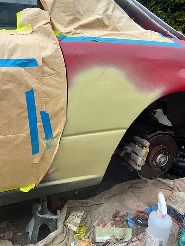

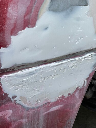

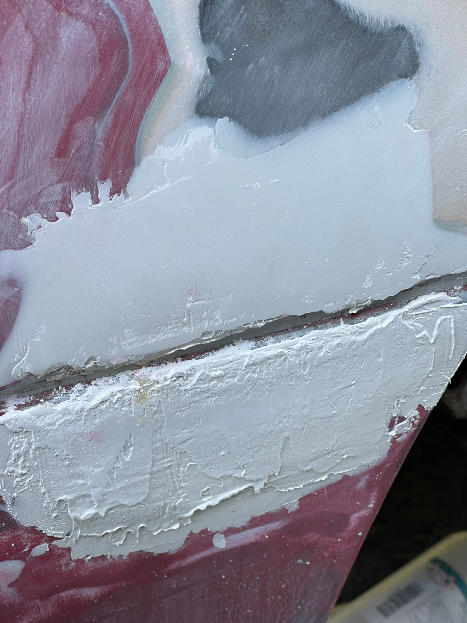

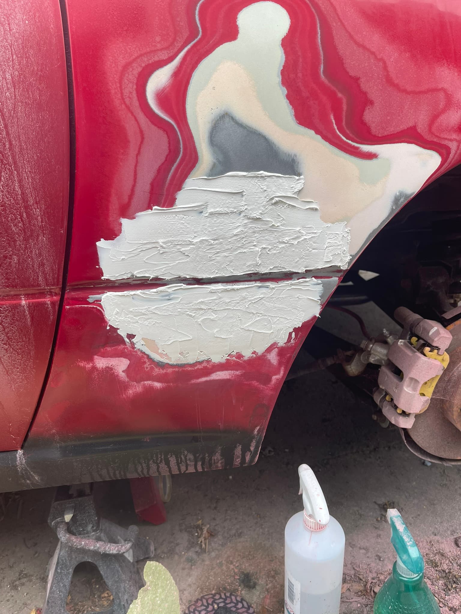

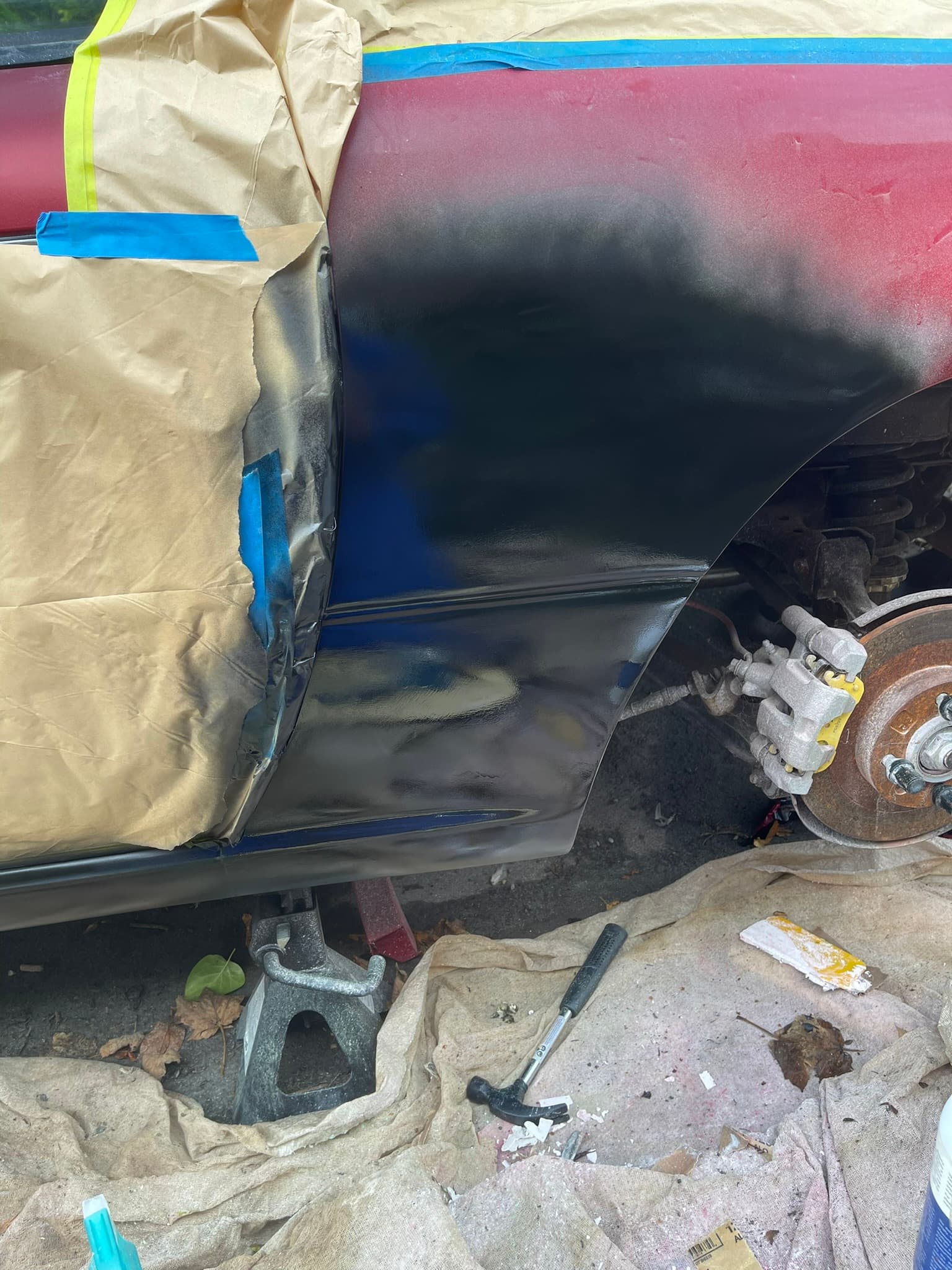

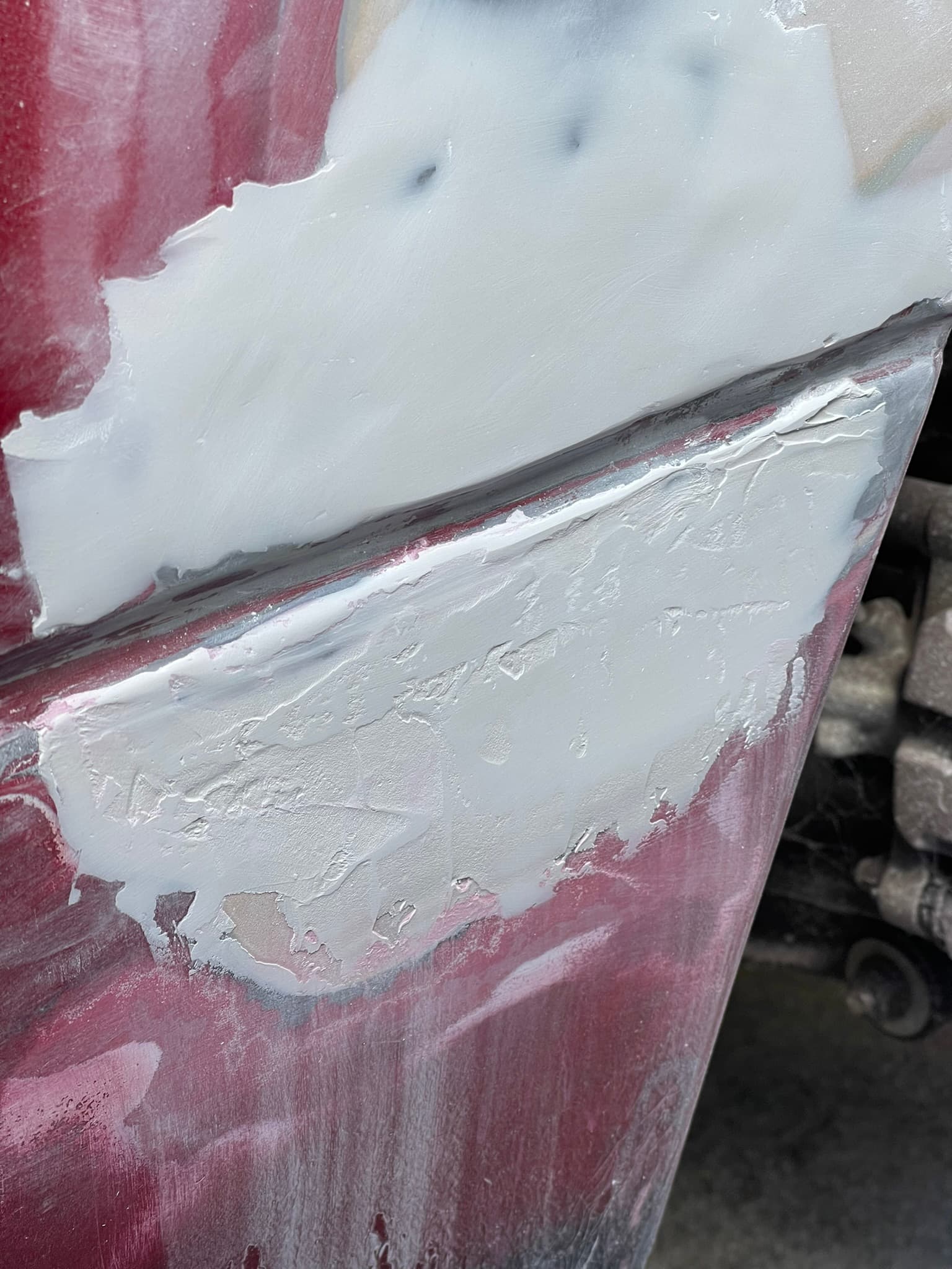

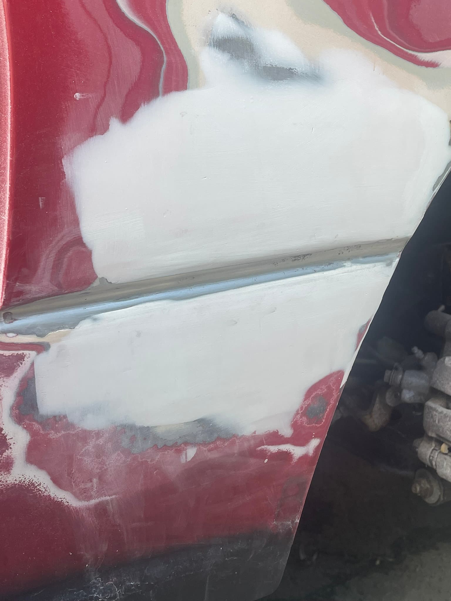

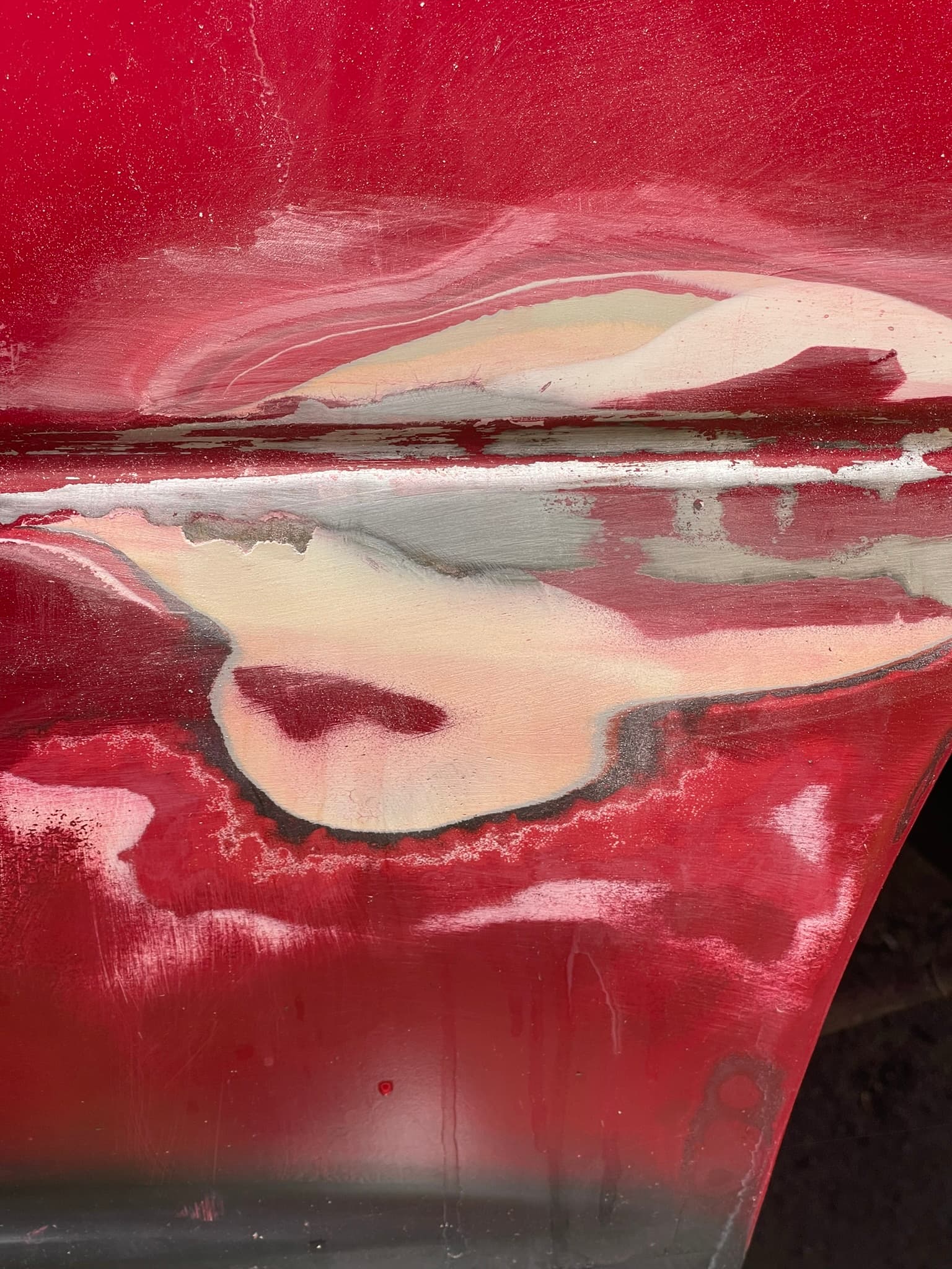

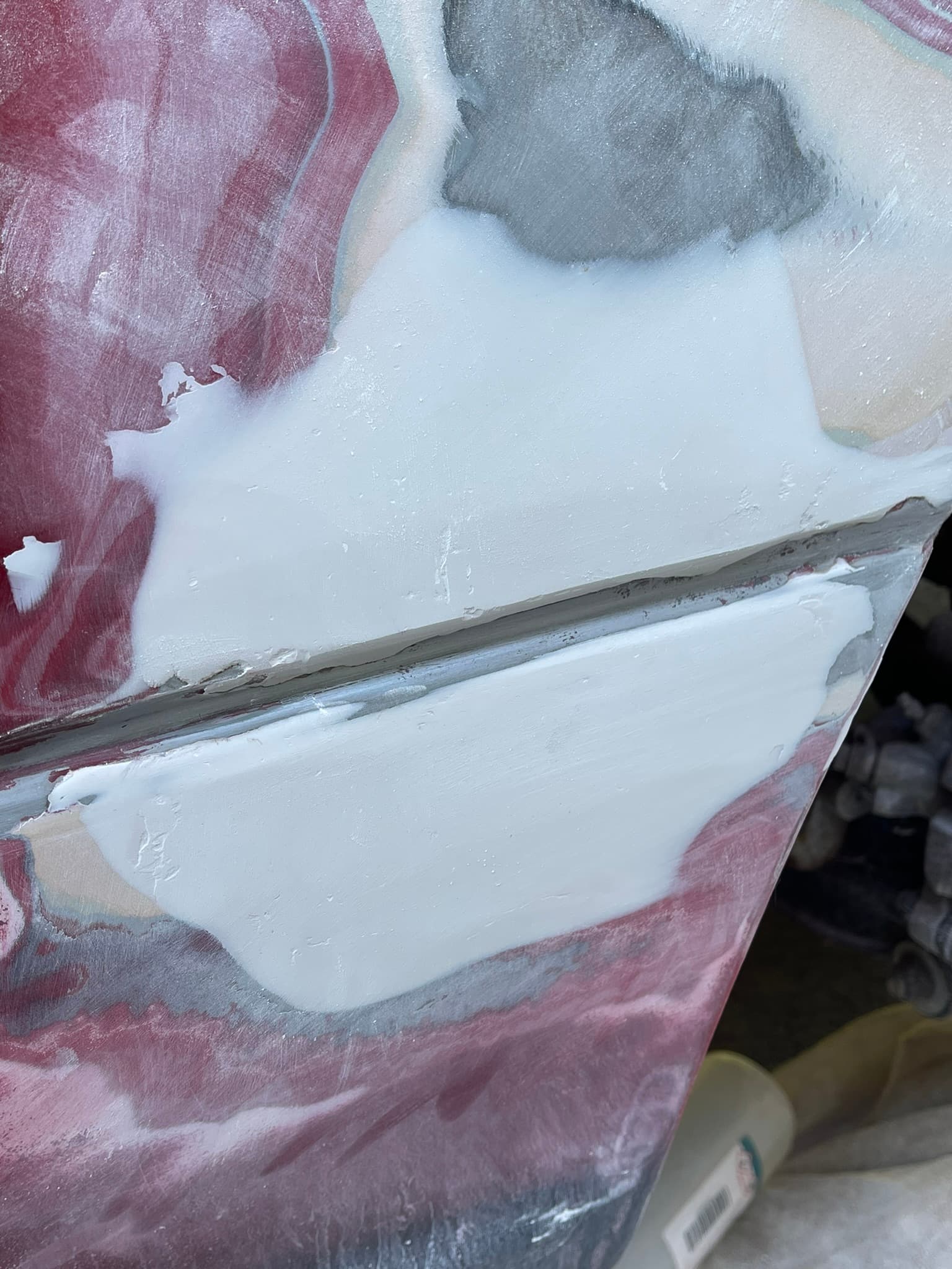

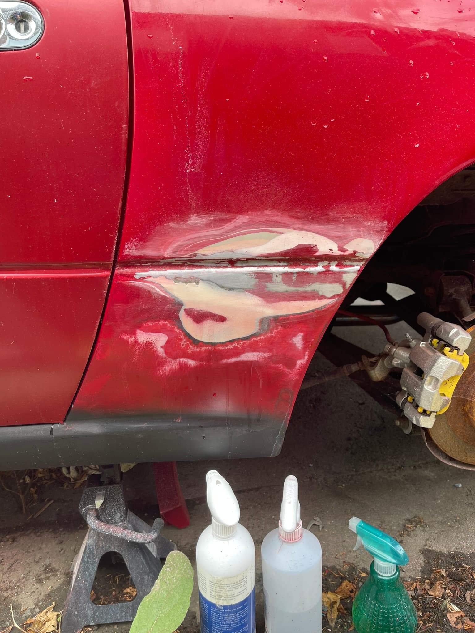

Since the last update I decided to tackle the filler on the rear P/S wheel arch.
I sanded down all the cracked stuff that had been put on by a previous owner.
Then set about applying thin layers of filler until I got the filler proud of where the bodywork āshouldā be.
I then used a combination of DA sander, sanding block and a sand paper paper covered pencil (for the crease line) to try and get it looking rightā¦an exhausting process!

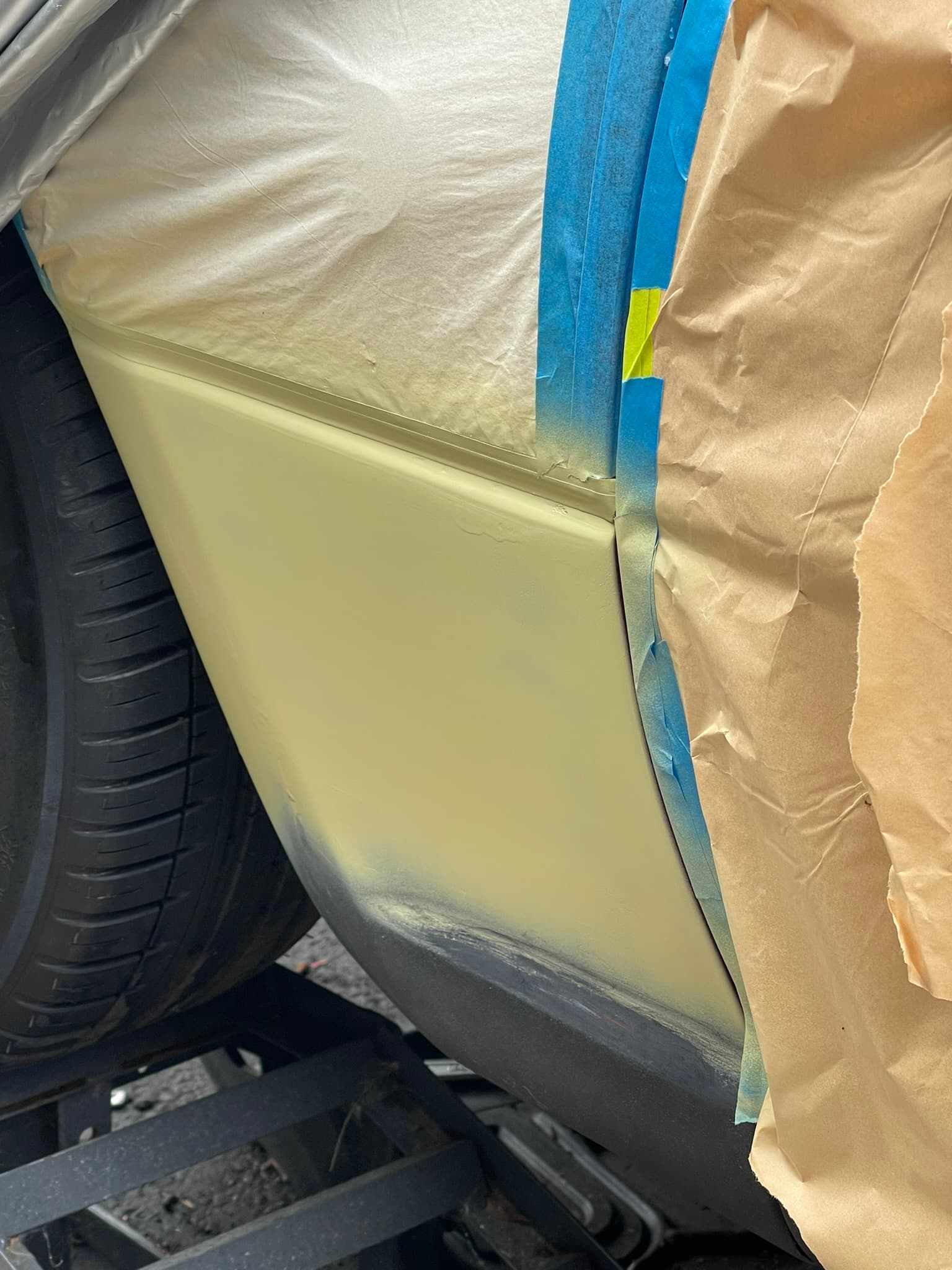

Once that was done, I used some filler primer (to fill any minor imperfections) and covered it in some paint ready for sanding.
My future-parents-in-law are letting me use their garage for hte next couple of weeks so I can finish the wrapping indoors which is good timing with snow potentillay on the way!
