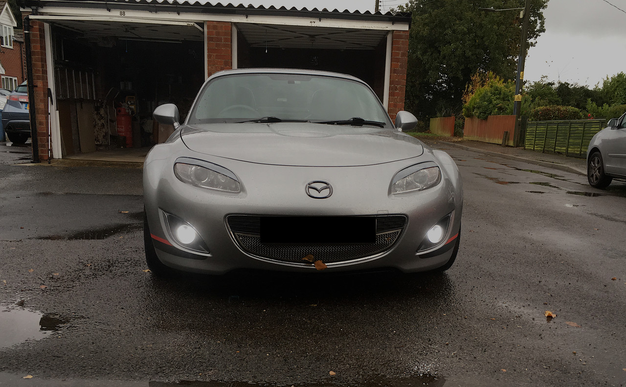

I’ve just fitted some round DRLs ( led type ) in the blanks where the fog lights would be. I did this for cosmetic reasons rather than anything else as I think the blanks look rather dull, and couldn’t stretch to the £200 MX5 Parts want for fog lights. They are connected to the wiring for the fog lights so behave in the same way. I asked my friendly MOT garage about this and he said he didn’t see any problems. ( I might dick with the wiring at a later date but can’t find a mk3.5 diagram that is readable )

They are 70mm diameter and fit the MK3.5 blanks almost perfectly. See picture below. I will work on getting them set up as DRLs with time, but for now I just wanted to fill the blanks, and they work fine using the fog light switch.

Thanks for the link, They were too small for the holes on a mk 2.5, but these http://www.car-mod-shop.co.uk/fogdrl-cob-led-fog-drl-spot-lights-angel-eyes-pair-3.5-3-and-2.5-universal-2400-lumens.html from the same company would appear to be a good fit (the 89mm ones) I have ordered them and will let you know when they arrive and I have had them fitted.
