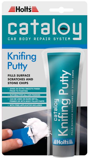

If there is a slight dent, you need to smooth in a tiny bit of filler before to level it up. Let it dry of course.

Thanks all for your suggestions, I think I will order some tocuh up paint and a bit of filler if I need it and give that a go first!
As long as it’s bairly visible (got to look beter than it does now) I think I will be able to live with it!
