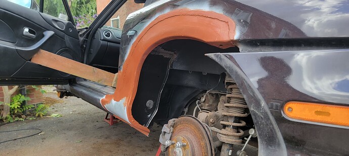

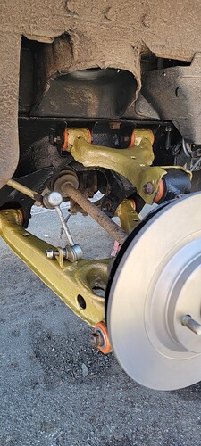

Grabbed a few more hours yesterday, managed to get the inner arch all welded in place and the outer arch fitted. RE applied to everything, with CIO inside the arches (glass reinforced paint, so tough) just the stone guard to go, once i have cleaned it all up and checked for corrosion under the original underseal
More progress, rear sub frame swap completed. and the correct ratio LSD installed (old one was one open unit)…although it may have to take a back seat as my son’s RCZ requires attention after dropping compression on one cylinder. On the plus side, the wheels are due back any day from the powder coaters :smiley:
Interesting colour choice for the refreshed components.
Is that just primer or are you sticking with that colour?
The black and the gold are Buzzweld chassis in one paint, the red coloured stuff is Buzzweld rust encapsulator primer. Promatic stone guard on the underside of the bodywork.
I went with black and gold underneath to compliment the body work colour (Radiant Ebony)
A unique finish. Well done. :clap:

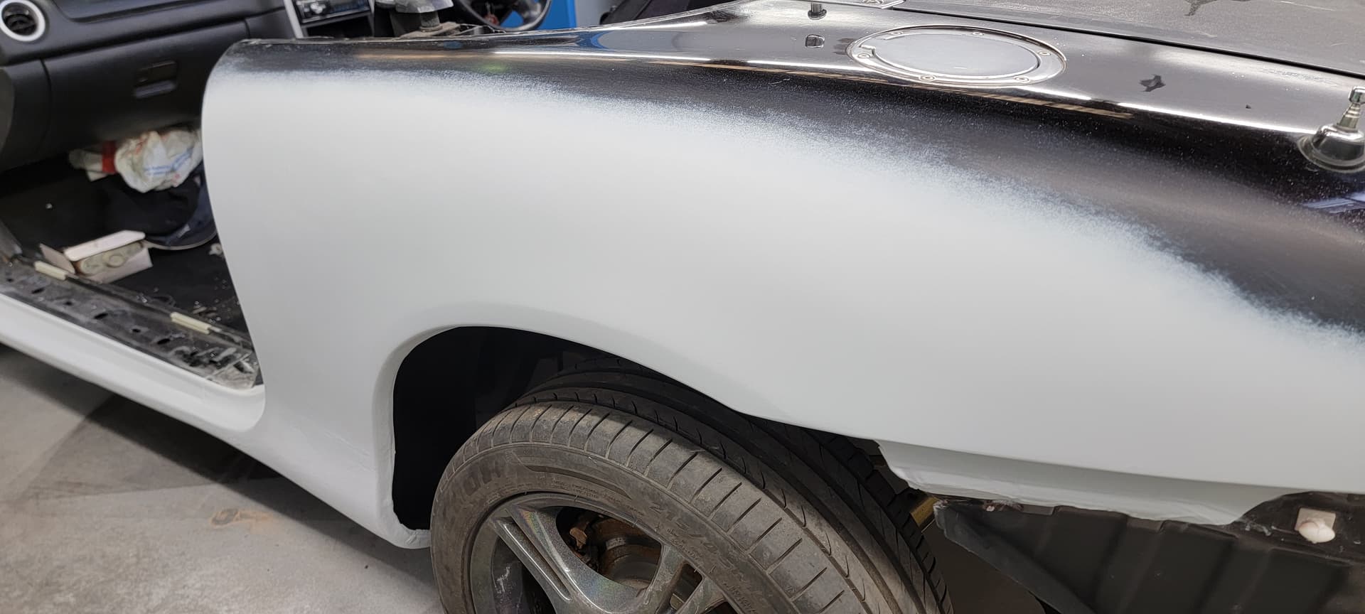

Finally getting close to the primer and paint stage. This part always takes ages to do. As soon as you think “yep, that’s ready” you always find a bit that needs some more work on it - preparation is key though.
Looking excellent. Great stuff. Well done :clap:

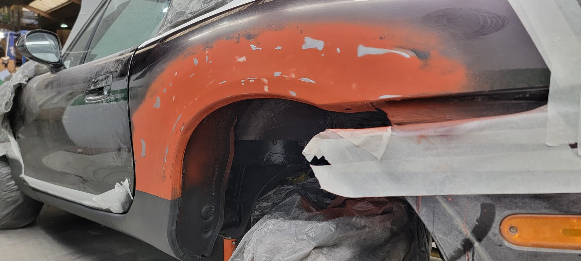

Paint prep is now complete (to my untrained eye anyway) just waiting for a call from the painter now
Smooove :+1:

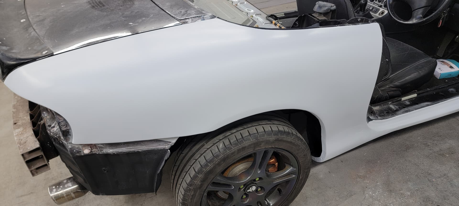

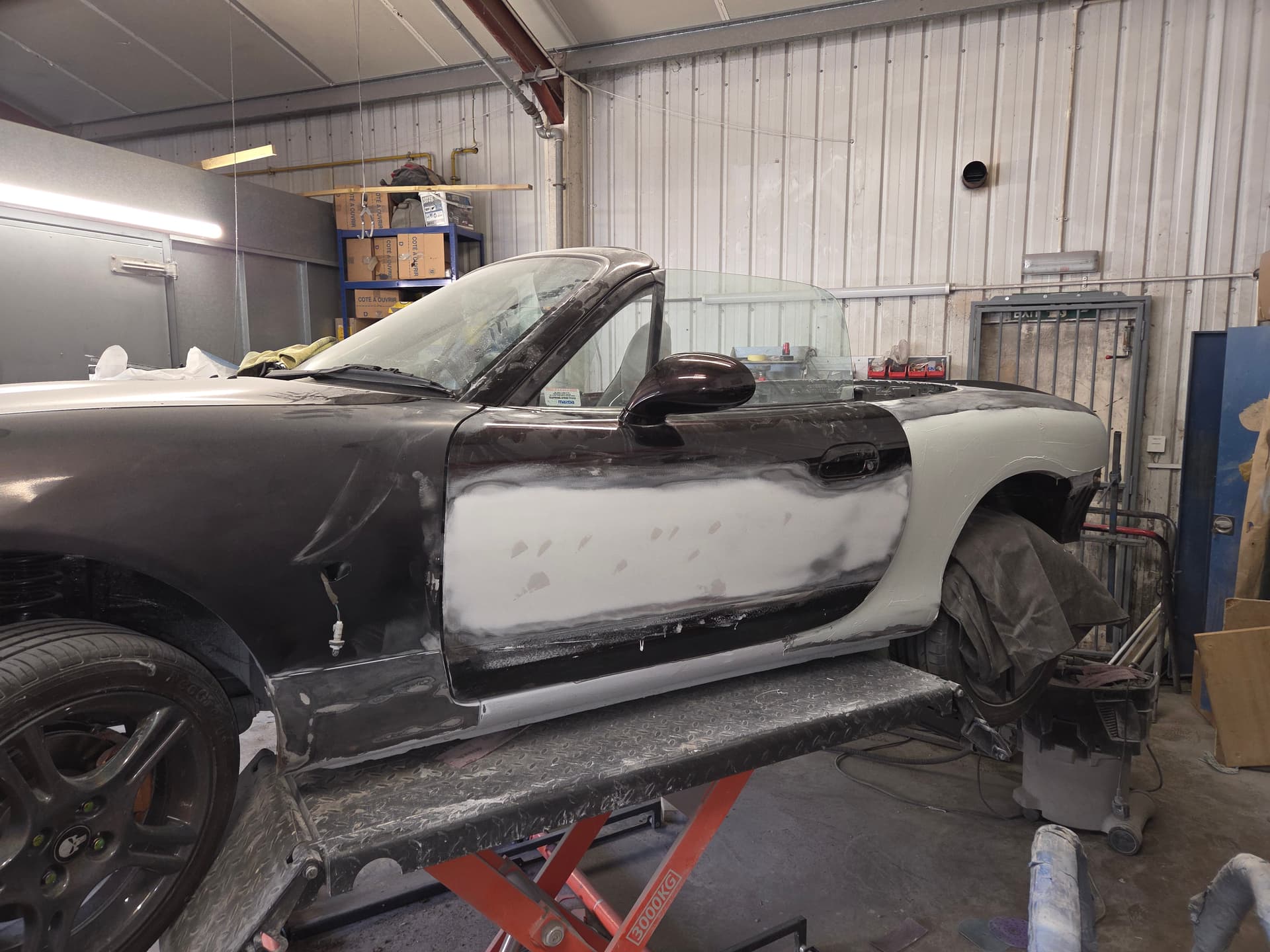

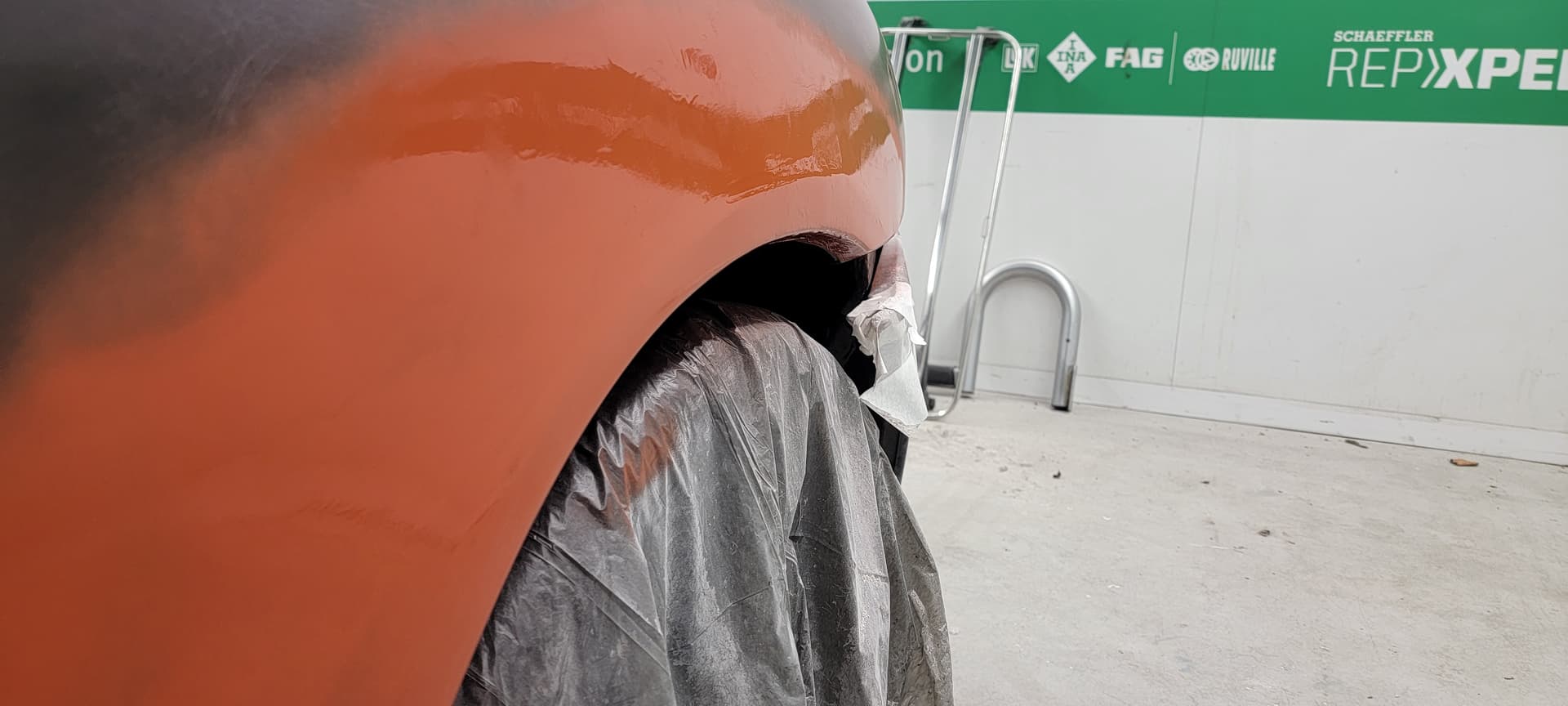

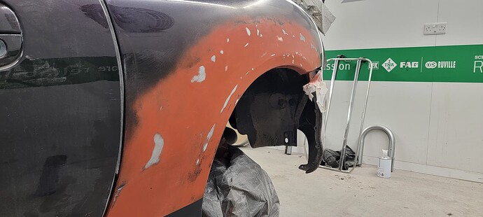

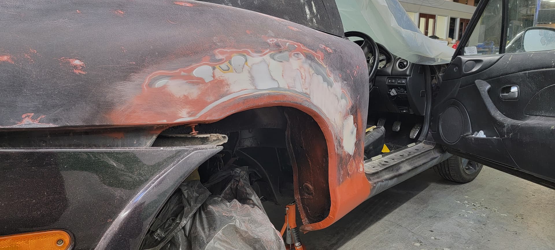

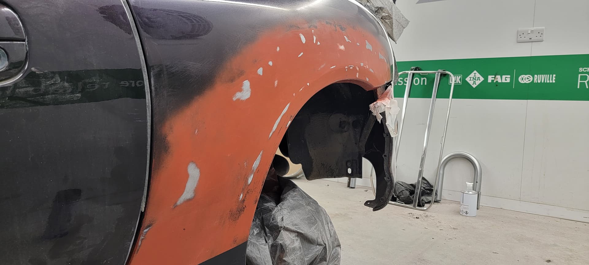

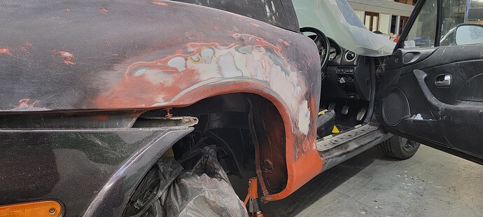

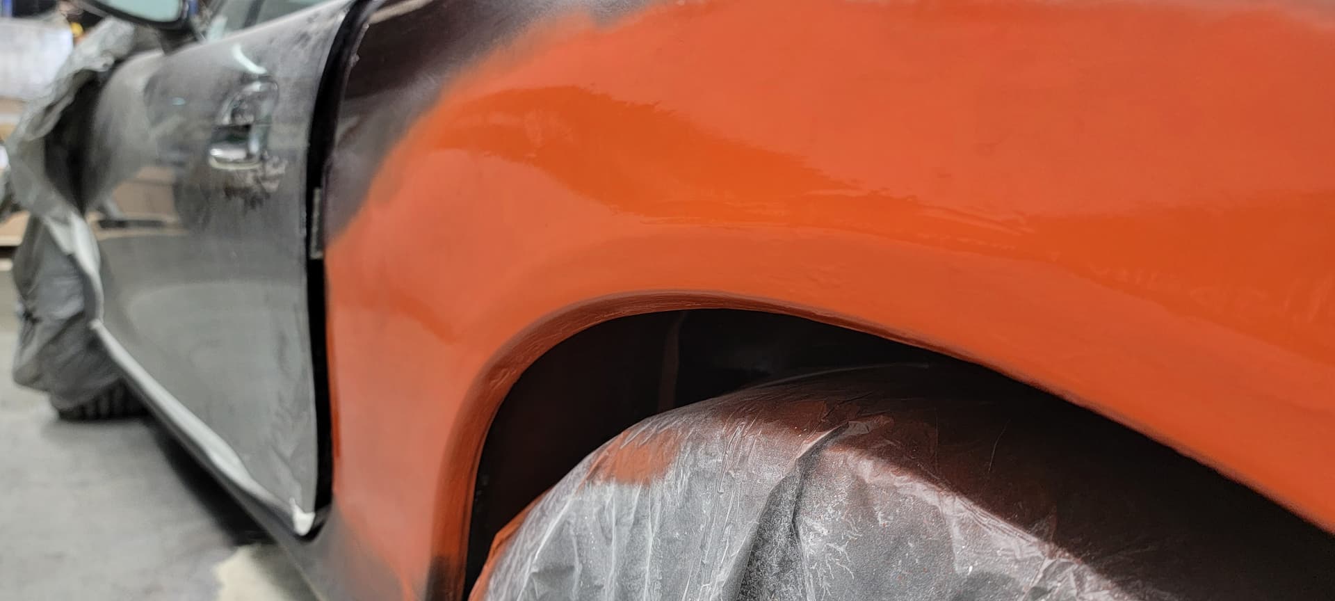

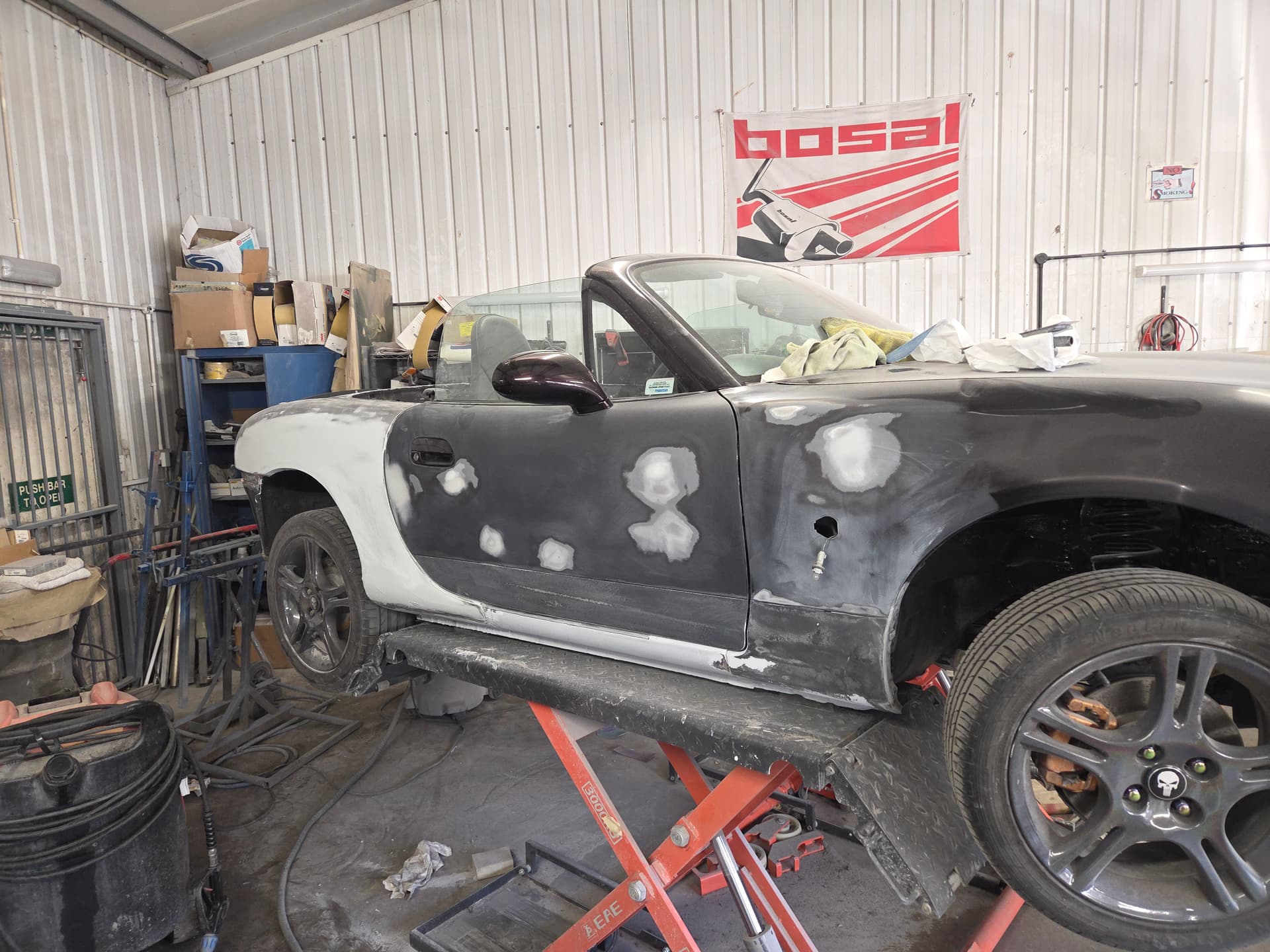

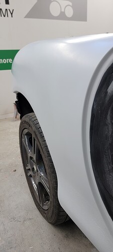

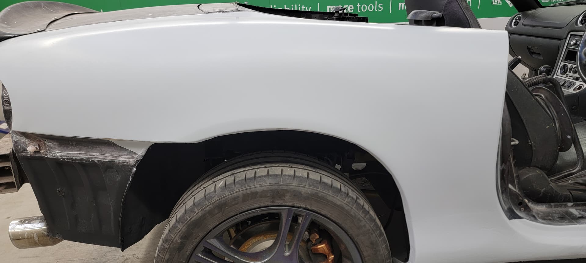

Well, a combination of factors (losing my work area, plus weather, plus poor advice on what primer to use from the original painter) resulted in me having to hand it over to a local body shop to do the final prep and paint - on the plus side it will look stunning when painted, on the negative side the cost is now 4x as much as it was originally. This is how it currently sits, should be ready next week, then MOT time and get out and drive it (it has been 10 months so far).
Both sides are being completely redone and painted now instead of just the arches, sills and lower wings.
Quickly! Hurry up. Summer’s nearly over! :winking_face_with_tongue:
Glad things are still progressing. You’ll be enjoying top down motoring before you know it. :+1:
