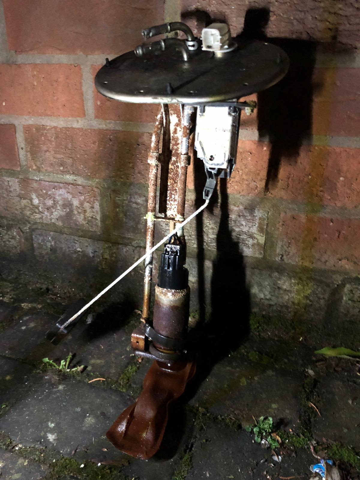

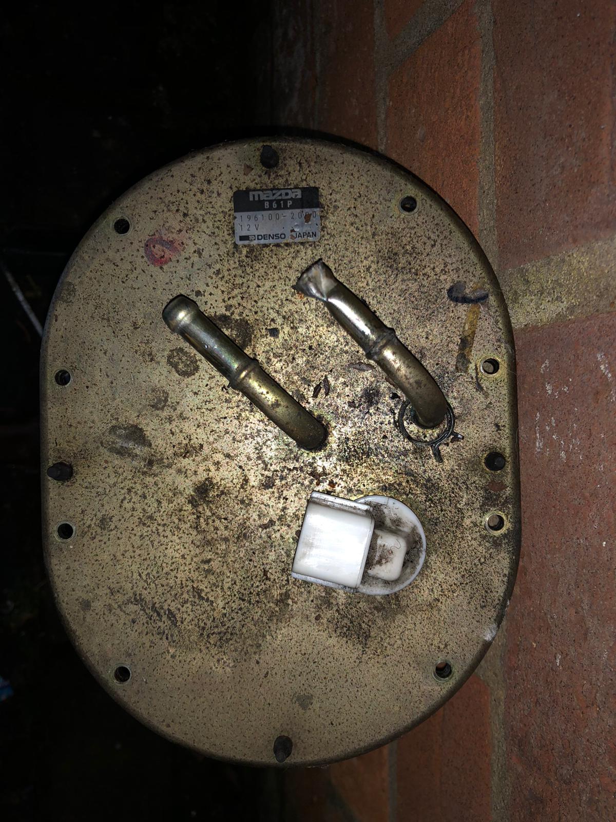

Plugs back in and tried to turn the car over and sadly she struggled but luckily I was missing that pump noise.
Rear parcel shelf off and pump removed looking a sorry sight. Fuel sensor is fine so connection is good.
Removed fuel pump and had a look inside fuel tank and seems fine. Luckily spoke to a lovely chap online who has a lovely fuel pump and sensor for sale. Sold.

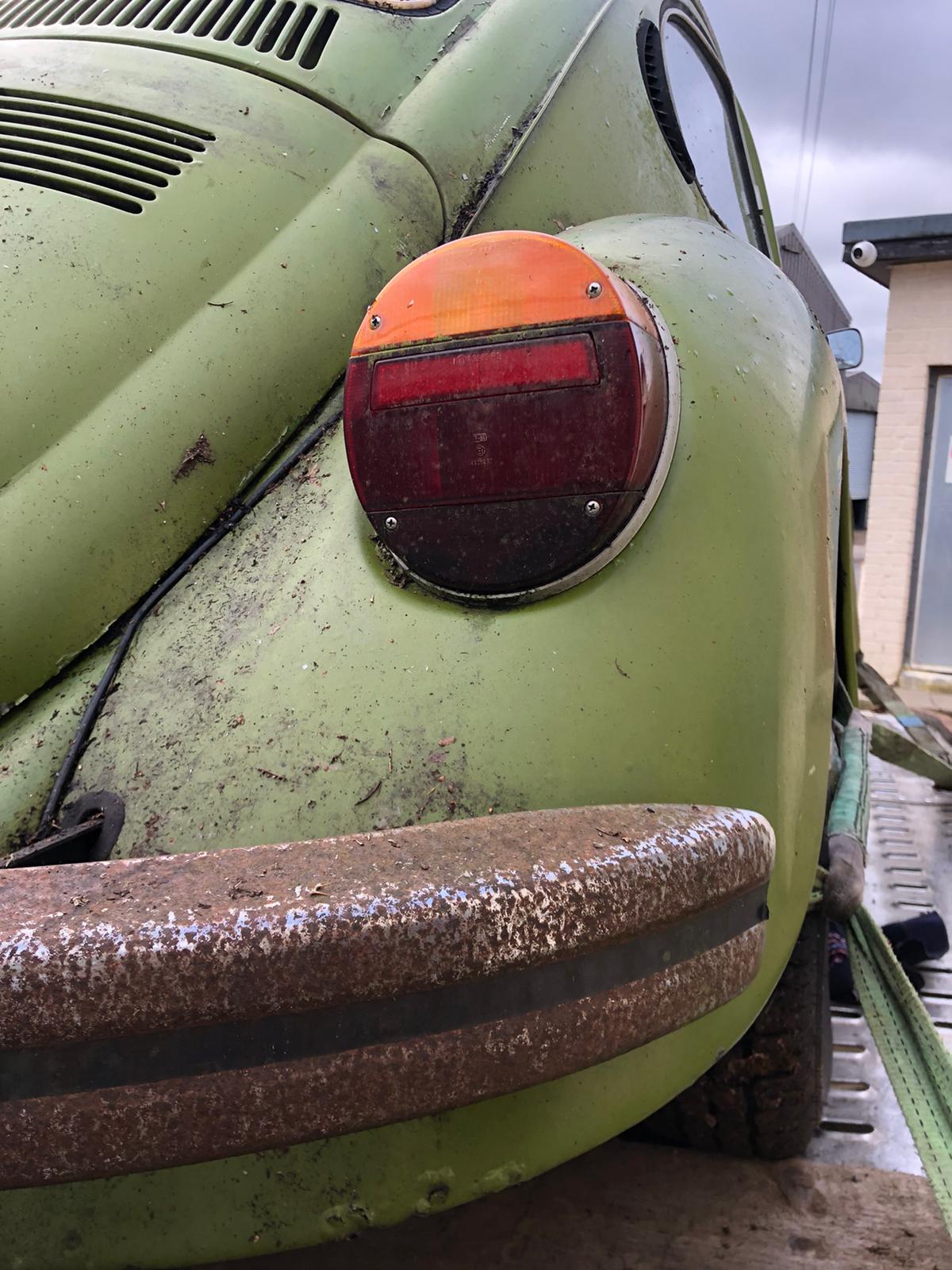

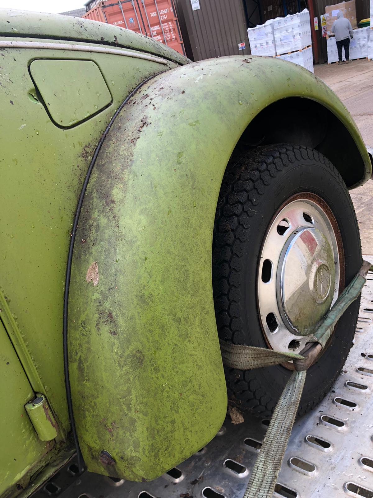

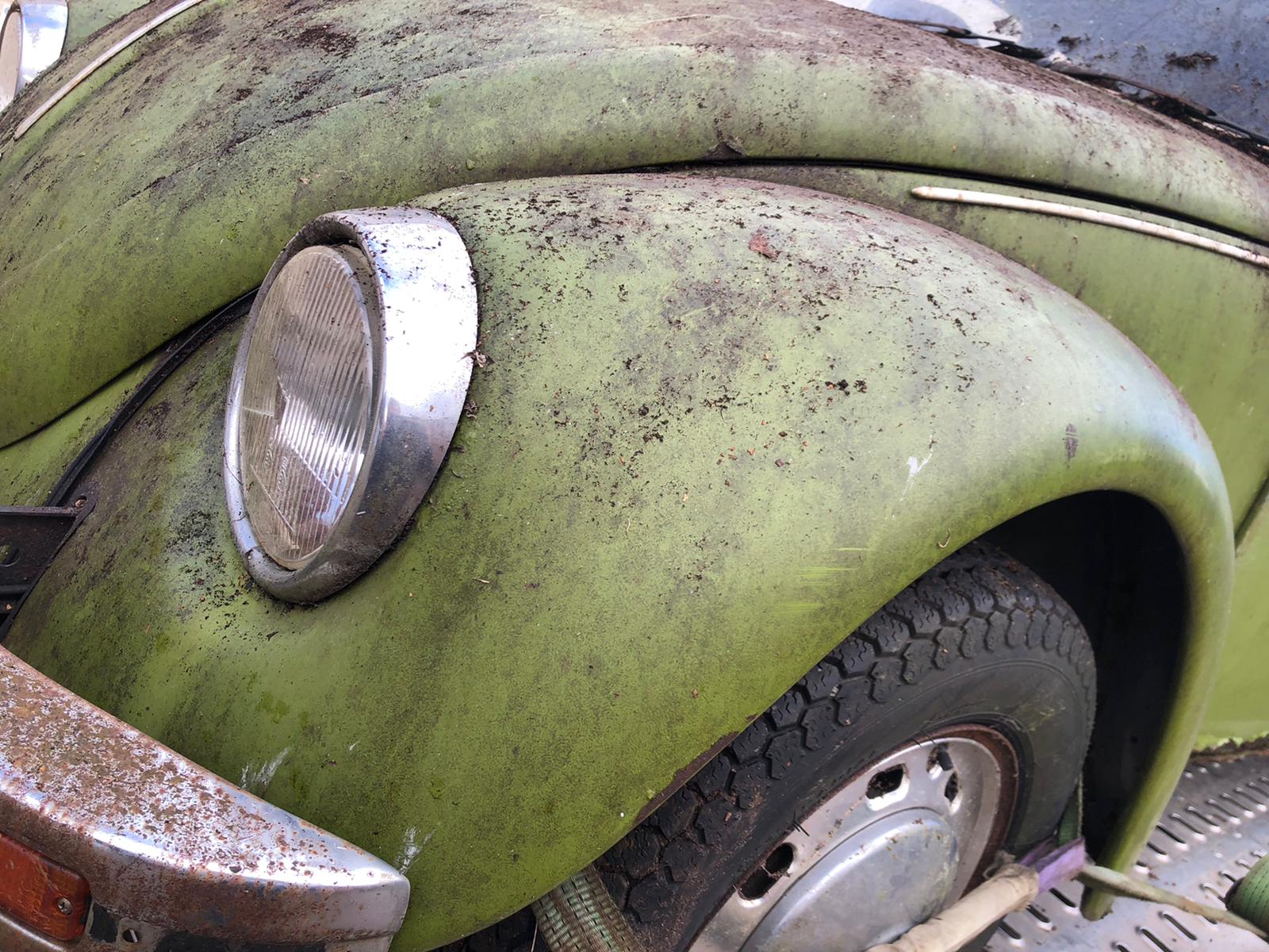

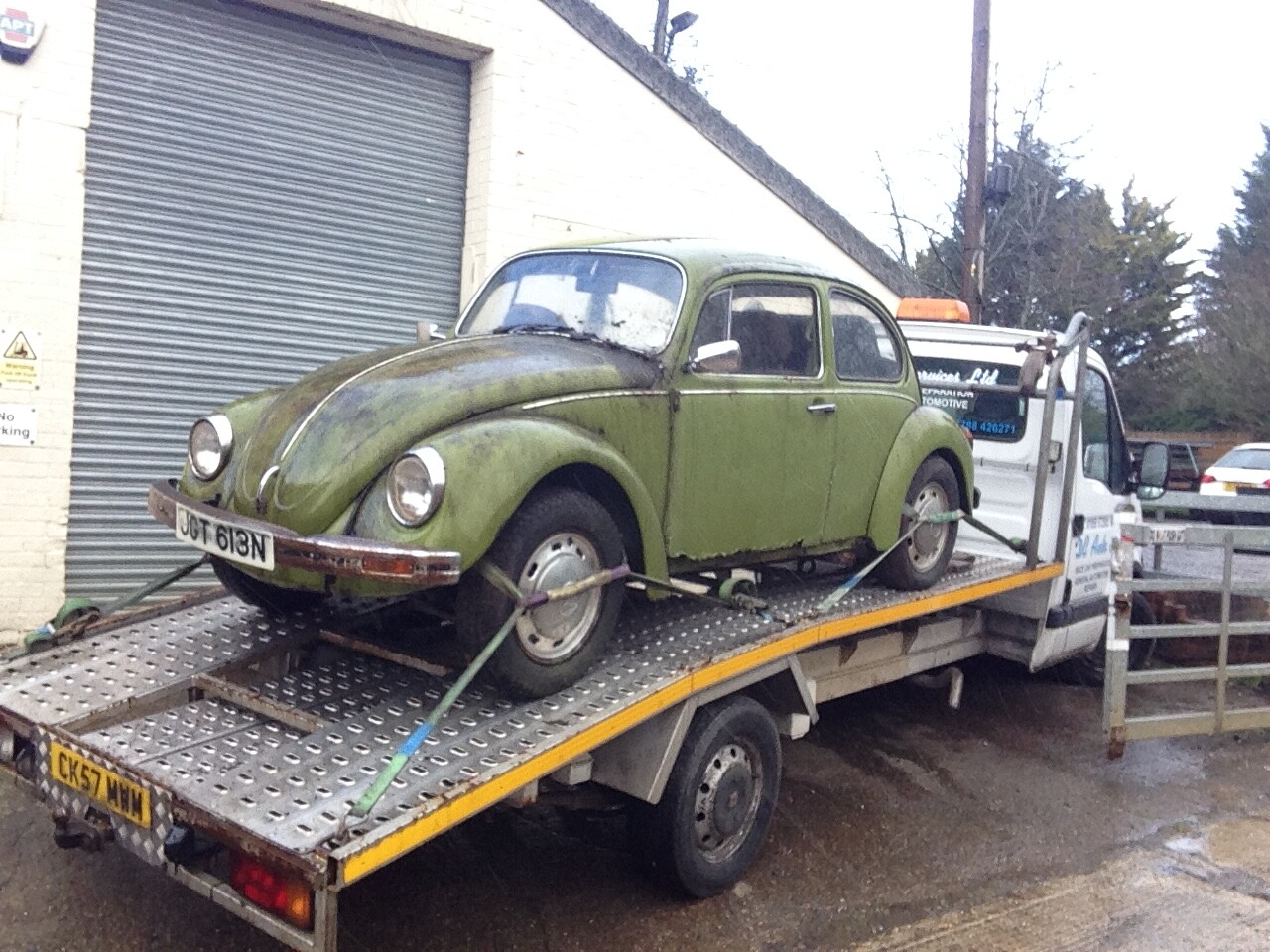

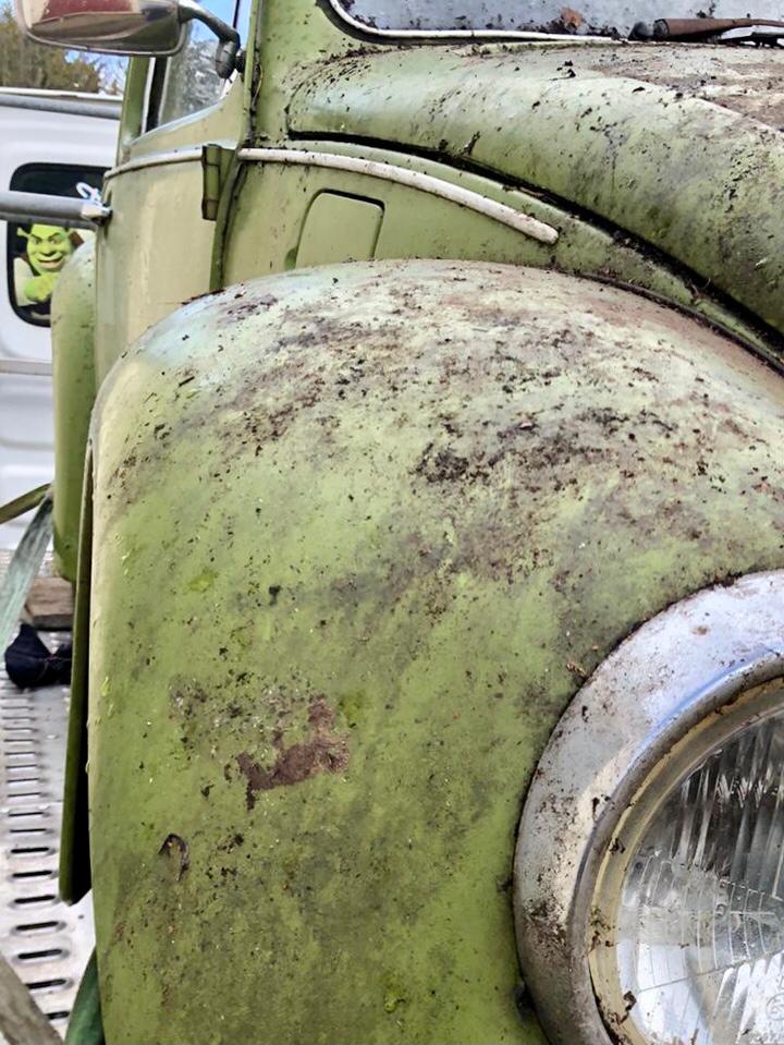

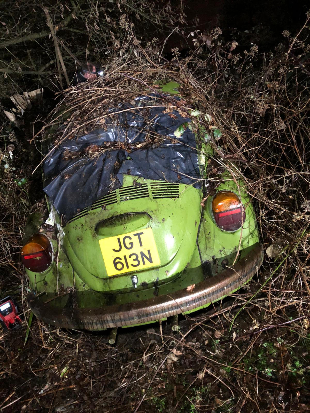

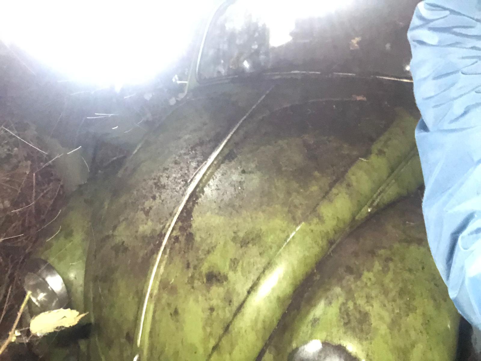

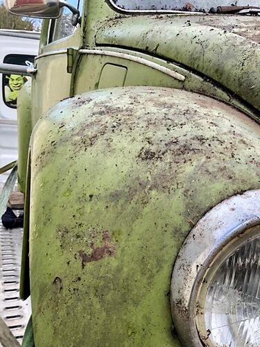

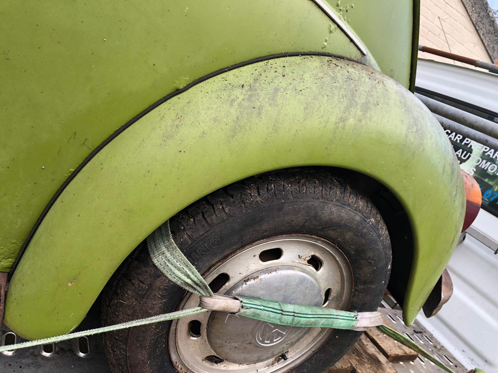

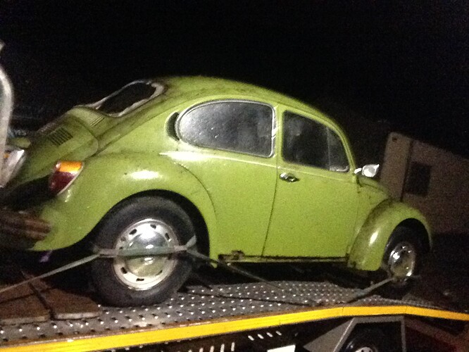

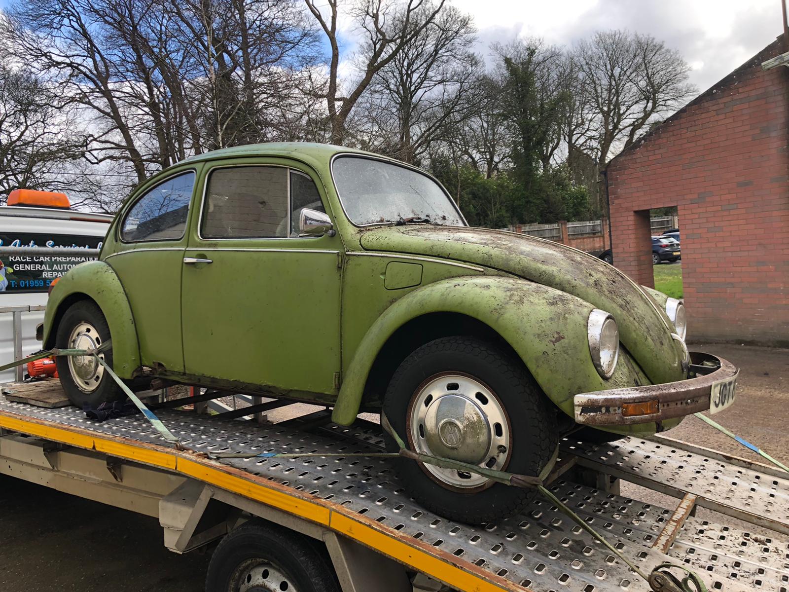

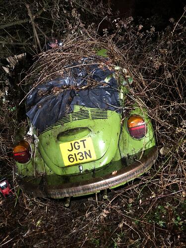

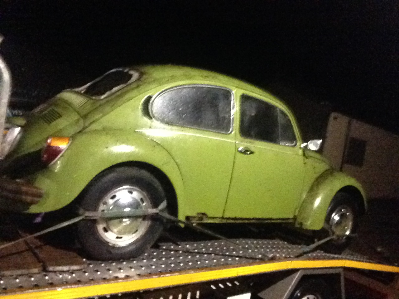

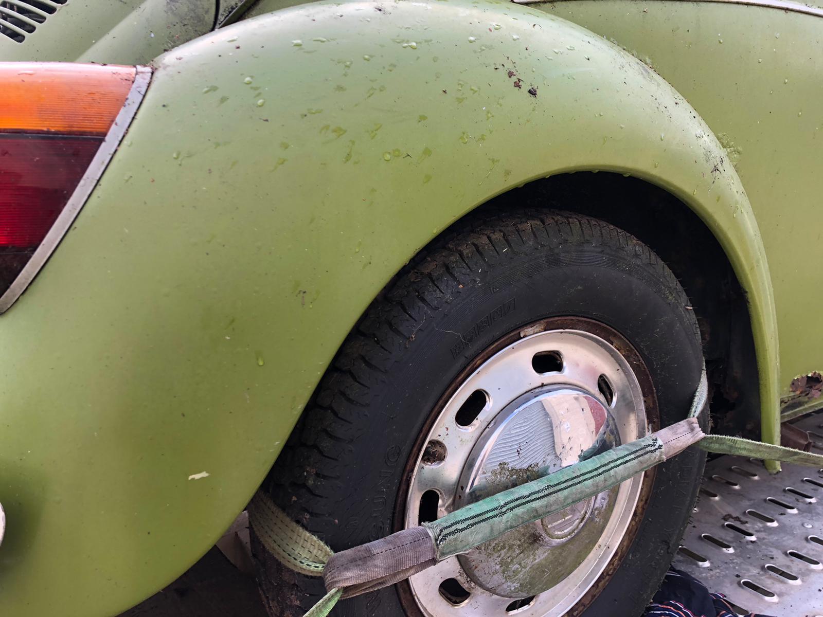

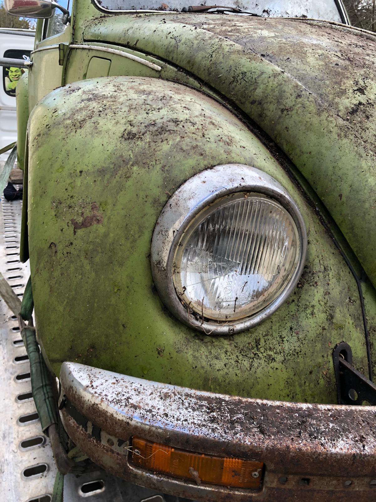

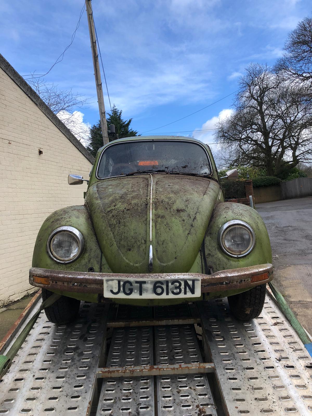

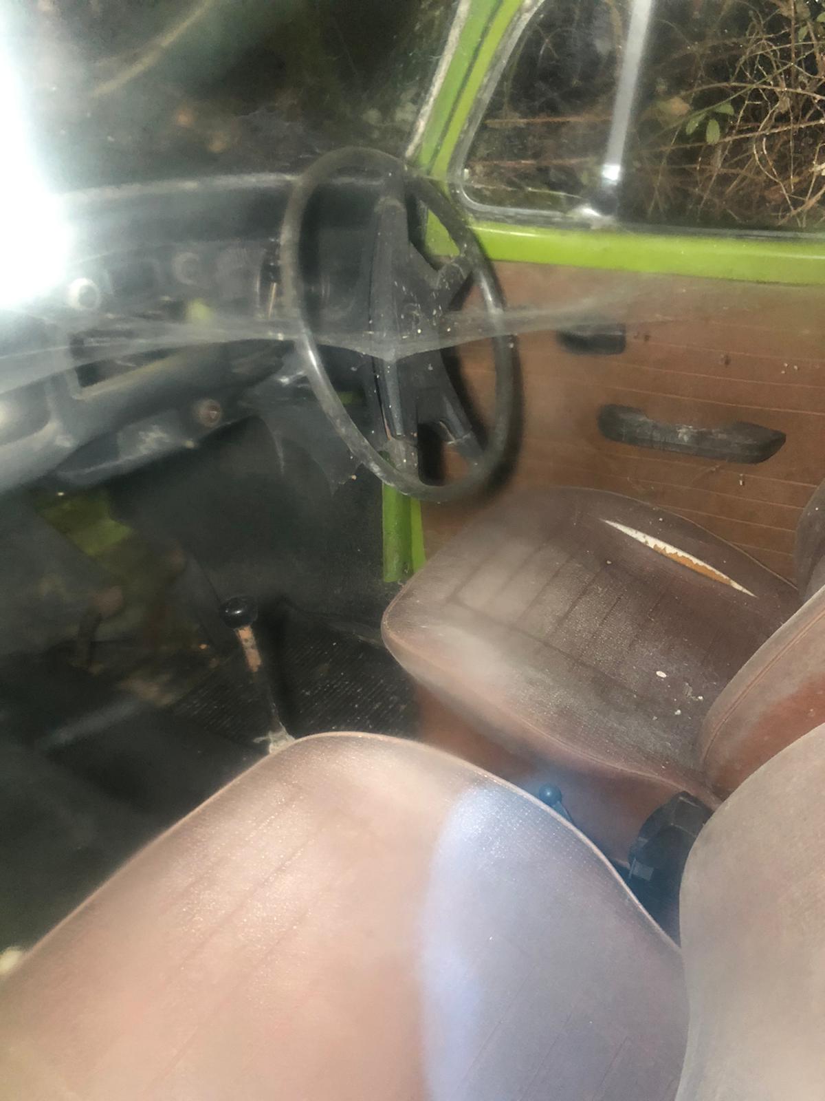

Seeing earlier posts I forgot to tell you I had this away as well from the Roadster owner. The beetle didn’t do quite so well being left for 23 years. Some good parts for resale here!
Enjoy the photos of the rescue
You’ll see Shrek in the back on one photo. He’s my wingman for getting cars out of swamps!
Your pics have kindled an interest in Beetles I never knew I had! I rather like that model/colour combo. Is it rare?
My first car back in the early 70’s, a light blue one. It still had an MOT up to August last year.
I sold it and bought a Vauxhall Viva as I could get all my camping equipment in the boot. Hated the gearbox in the Viva, syncro’s went.
I’d say so. 1975, 70k miles. Last driven 1999.
