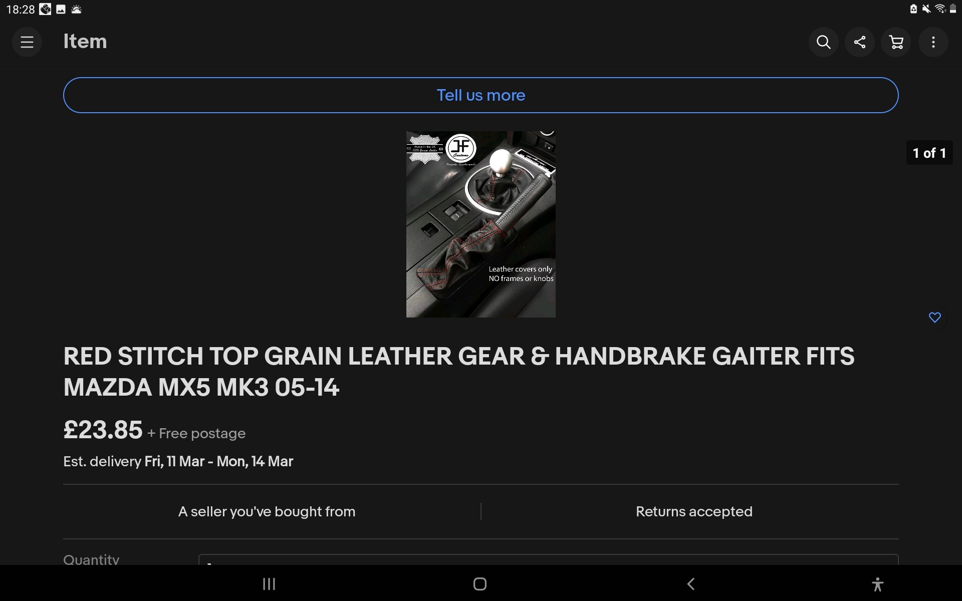

Sorry for the late reply I got them from ebay the sellers name is j-f-customs

Easy to fit, any instructions?
If you can do your headlight bulbs you can do these. :wink:
They are very good mind, did mine last year. :+1:
Very easy, hardest part was disconnecting the window switches to do the gear lever gaiter.
The handbrake gaiter just pulls up and if you turn it over you will see a retaining ring with two screws holding it on, the gaiter just clips over lugs on the top ring. The new leather one comes with slits in the leather and it is just a case of reversing the removal.
For the gear lever the gear knob and centre console needs to come off but once this is done fairly straight forward as it is similarly fitted over lugs and the slits are there for you.
Would say make a note of how the old ones come off as I fitted the handbrake one wrong the first time.

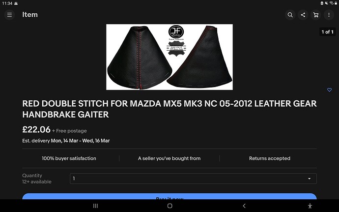

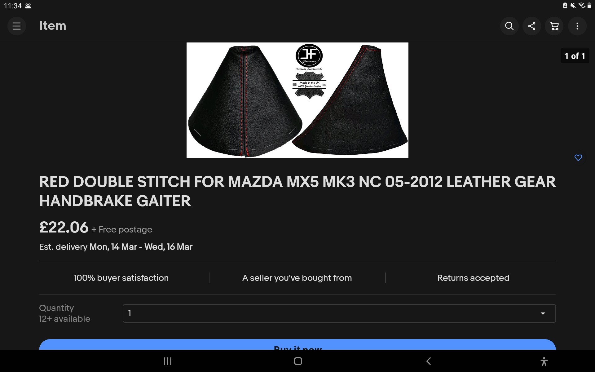

Should have been this pic as it is handbrake and gear lever
