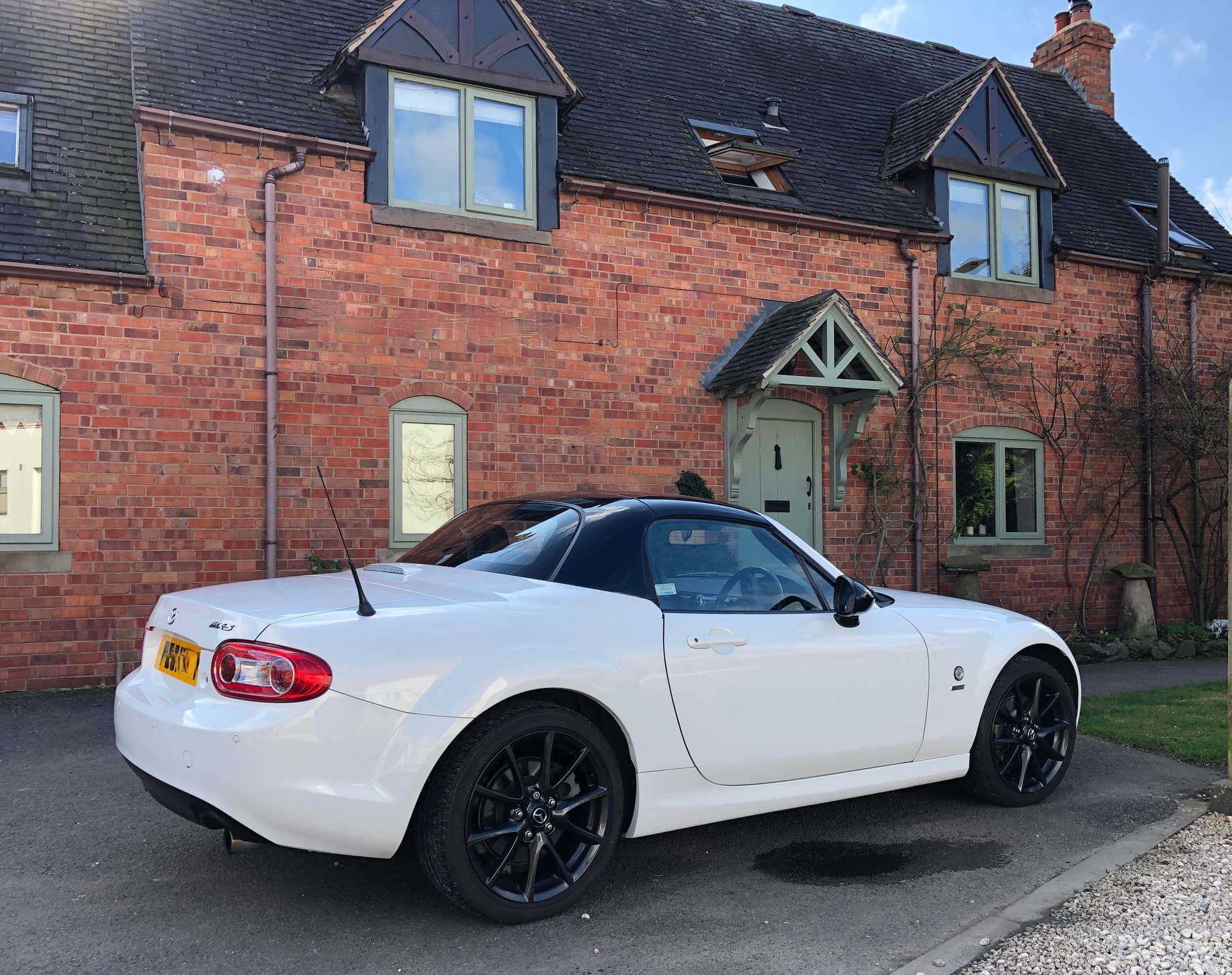

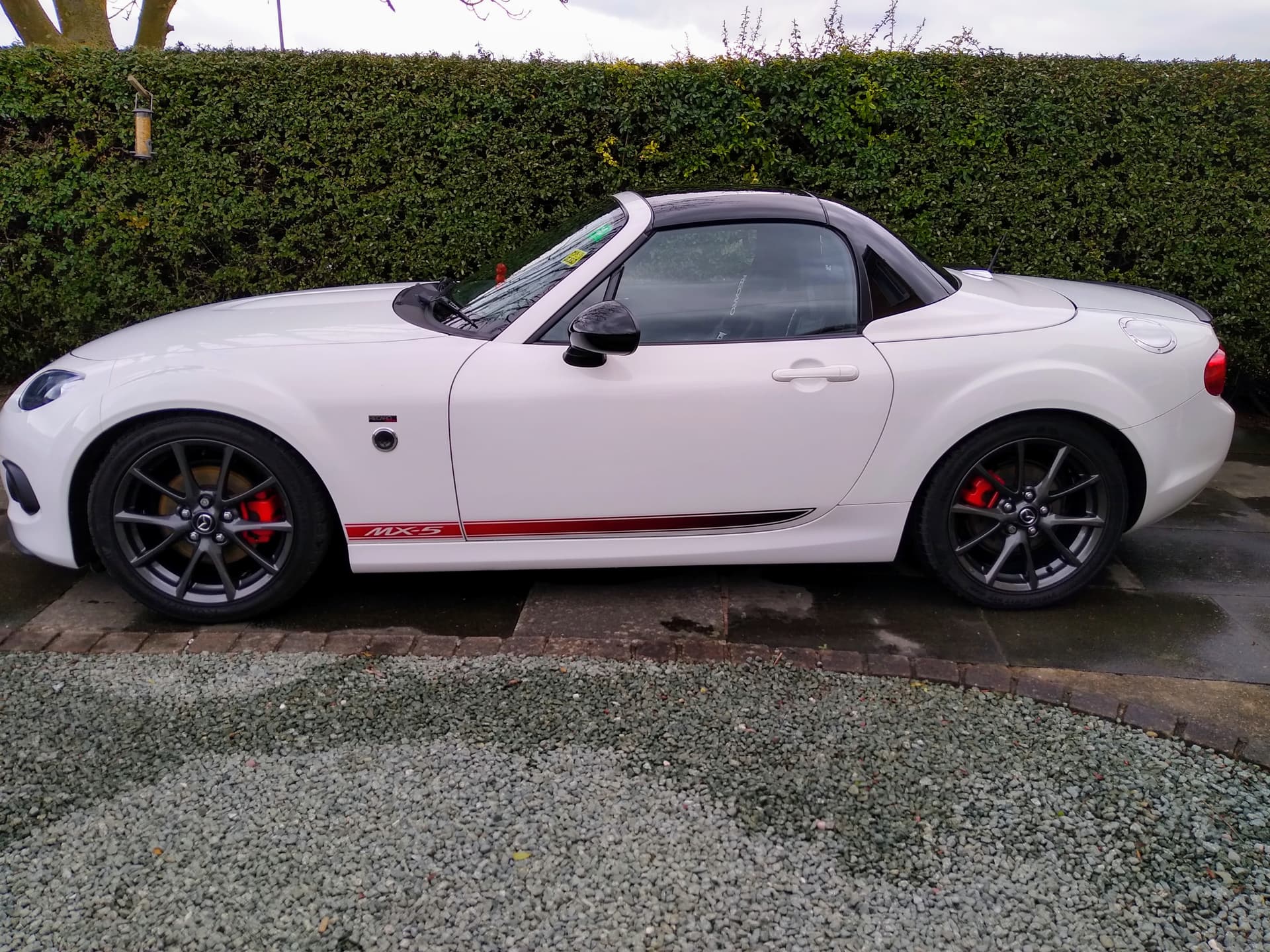

Cleaned and polished for todays sunny drive…

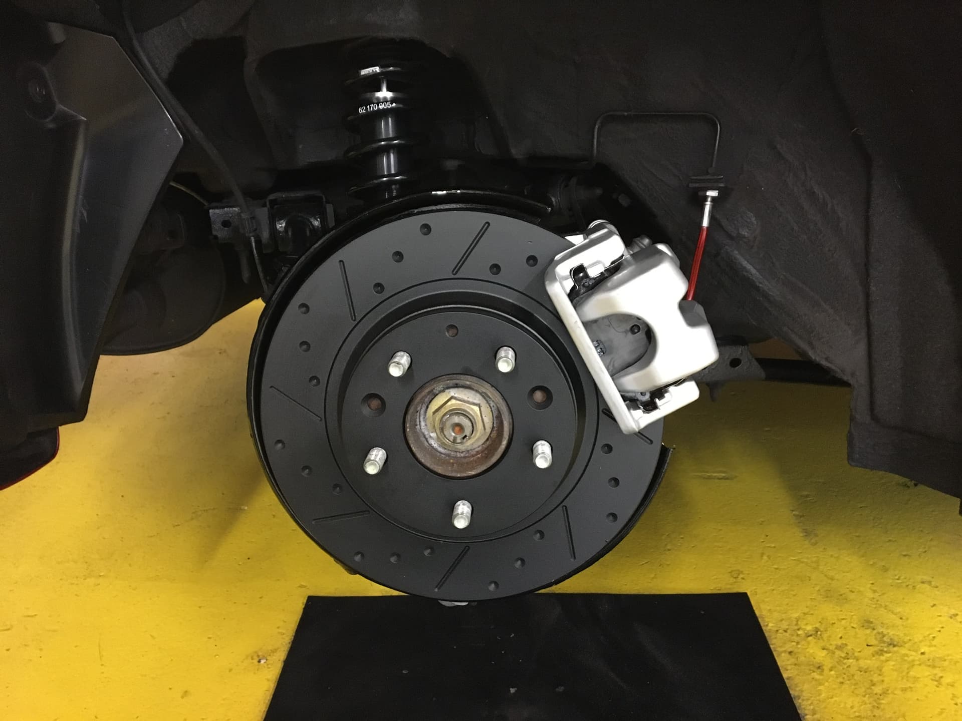

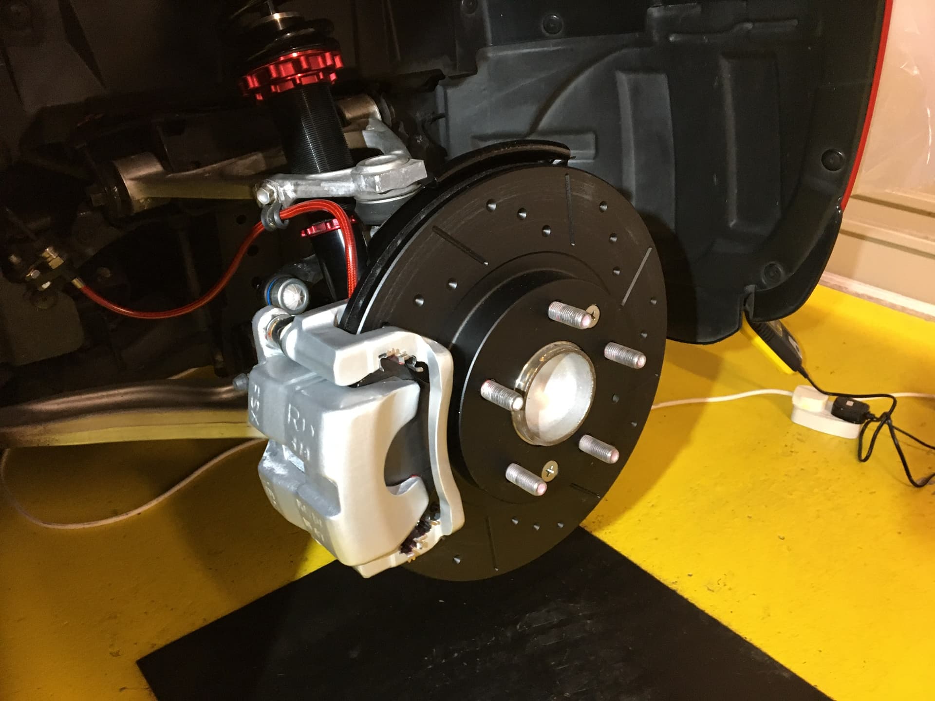

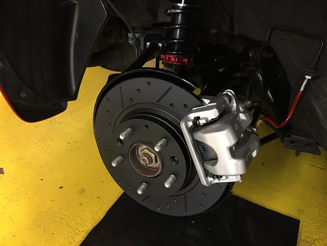

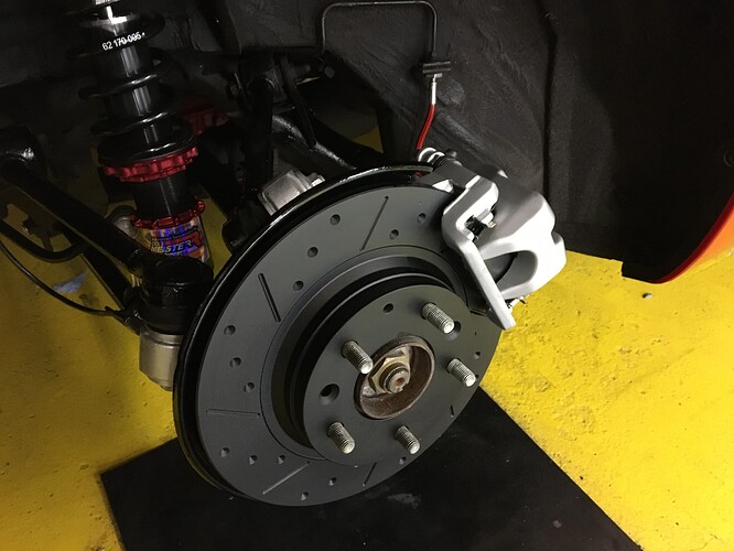

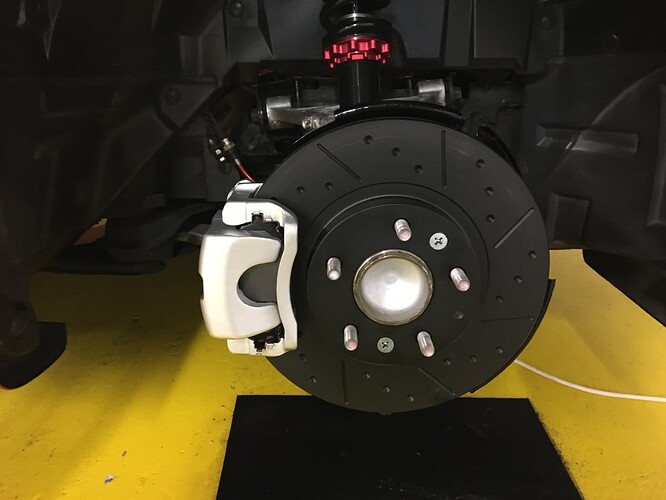

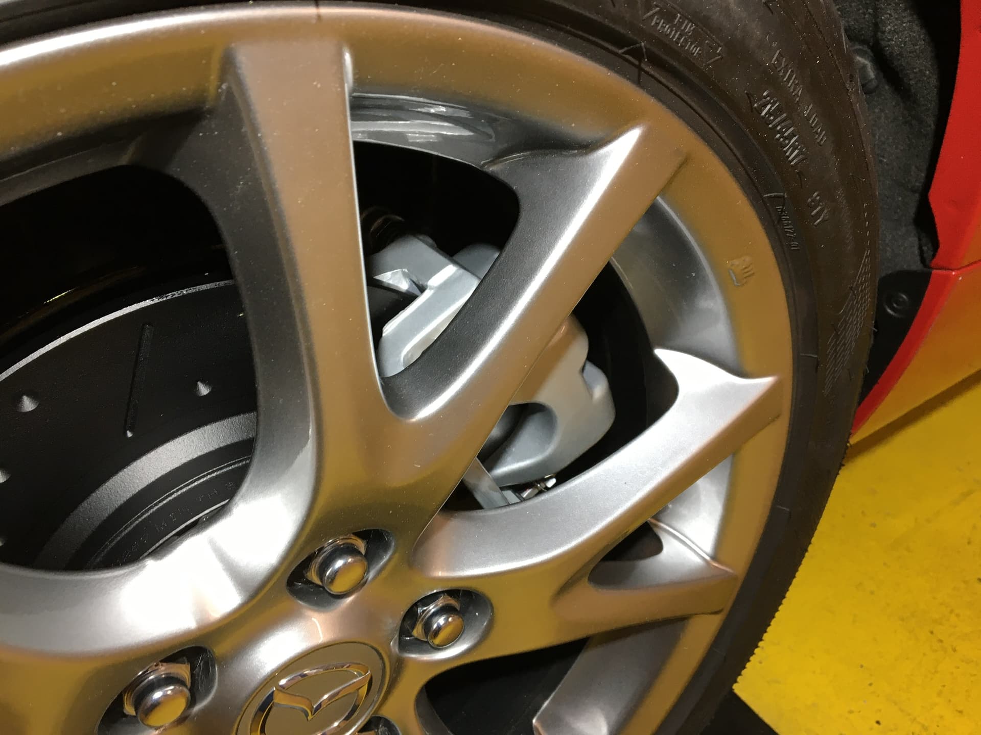

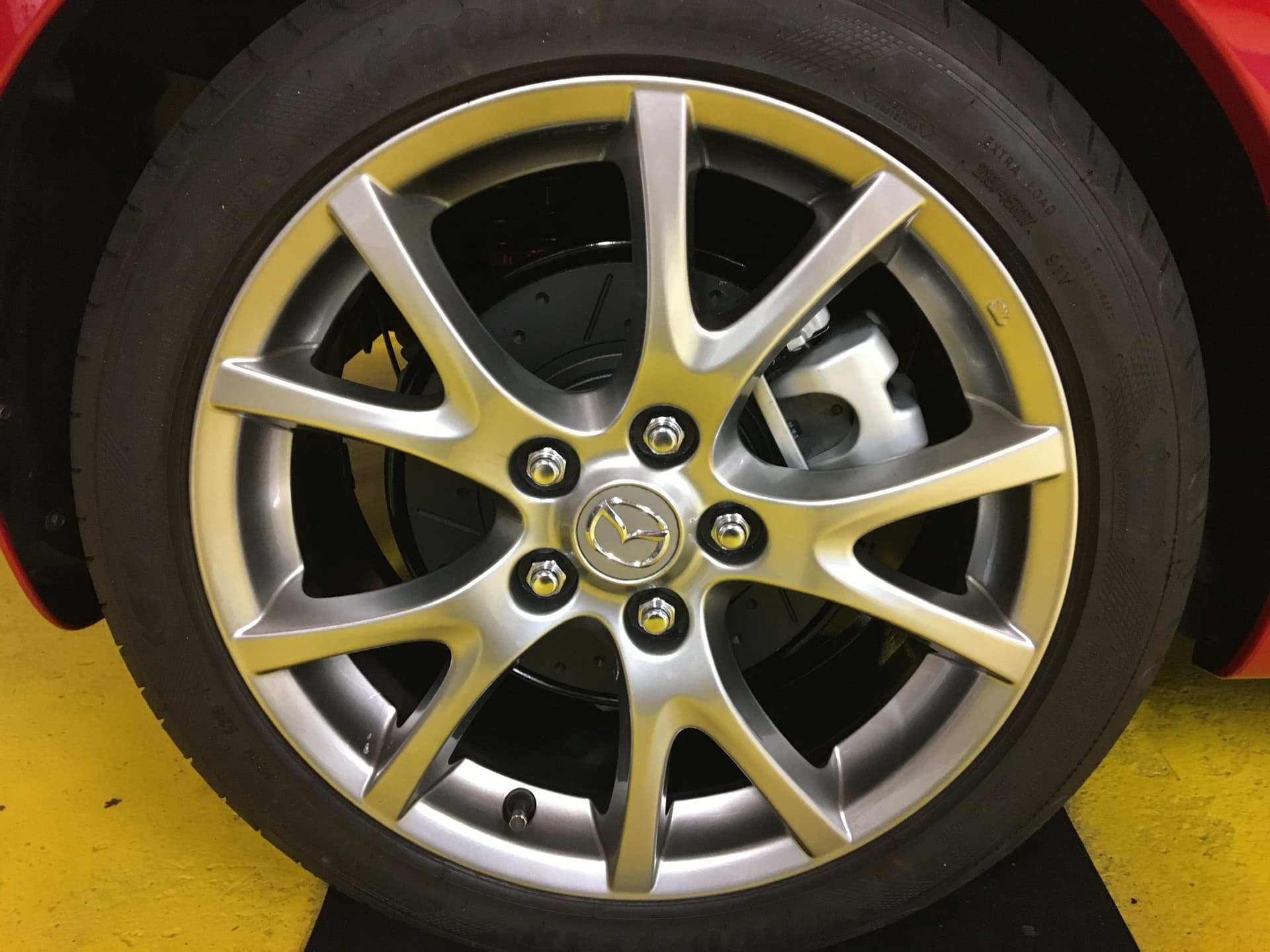

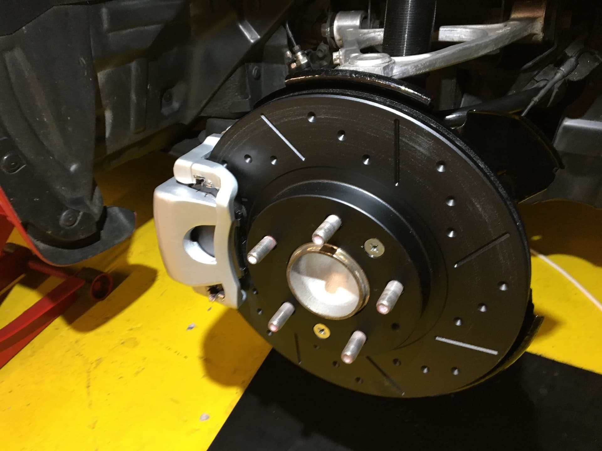

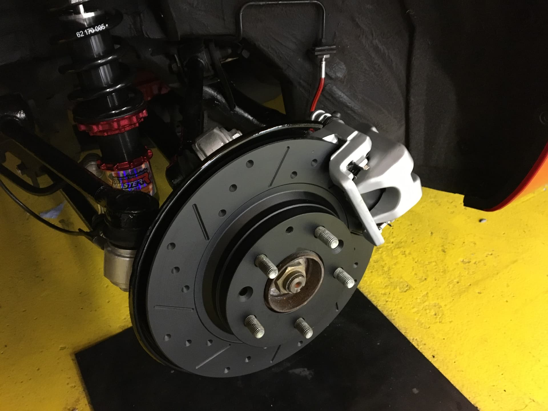

Decided to do a brake refurb before the car goes back on the road. So, calipers and mounts de-burred and smoothed, etch coat, high build primer, high temp silver finishing off with hi temp clear lacquer. New Mtec slot/dimpled discs (the pads will take the surface coating off) and Ferodo pads. Roll on Spring !!

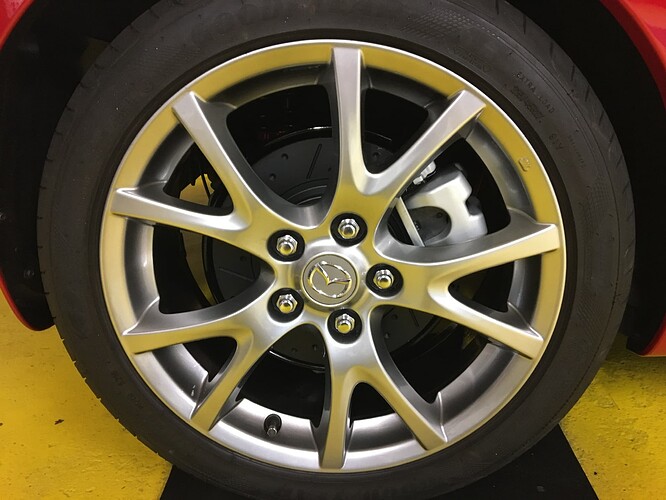

Here’s the rear.

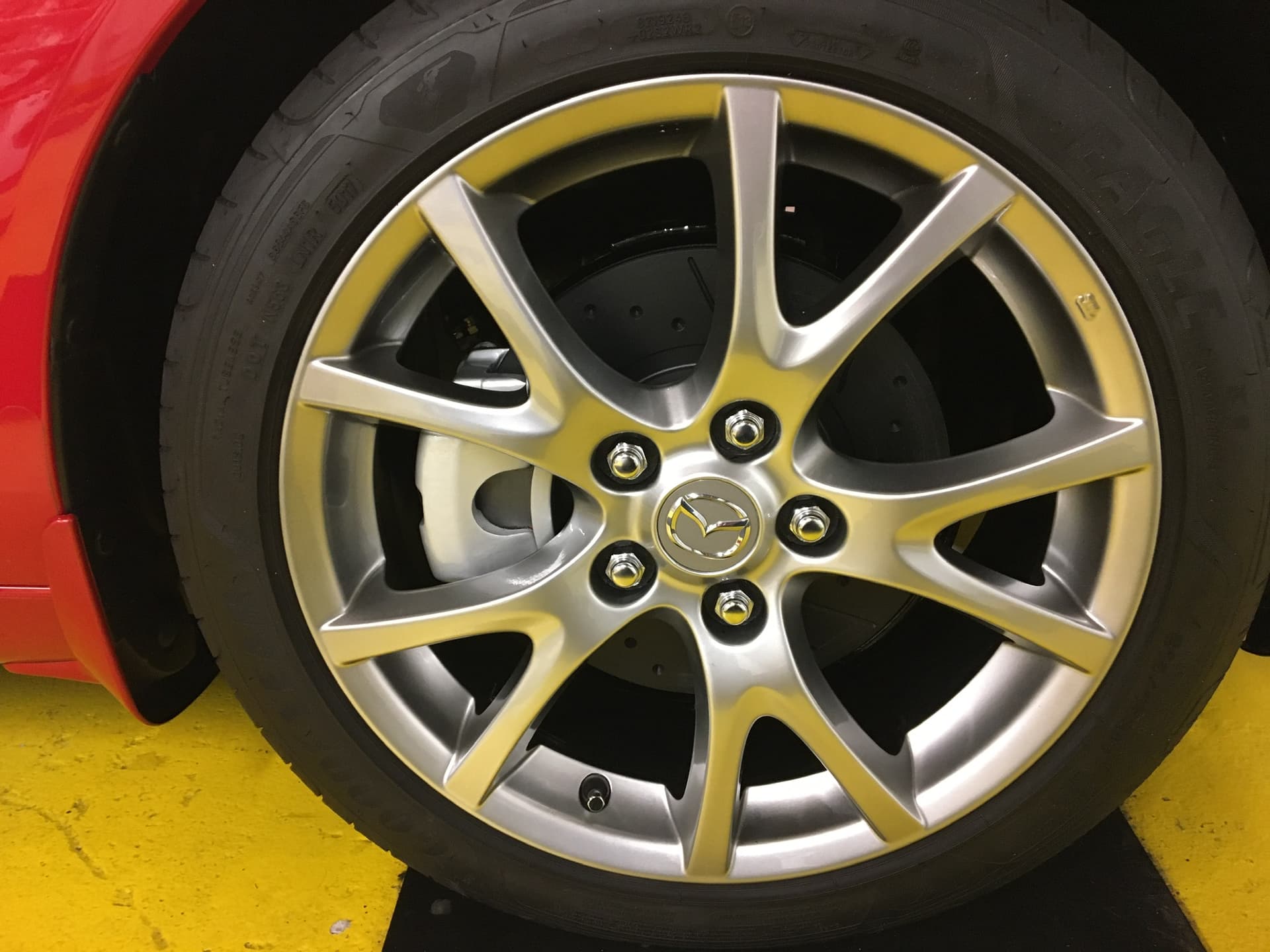

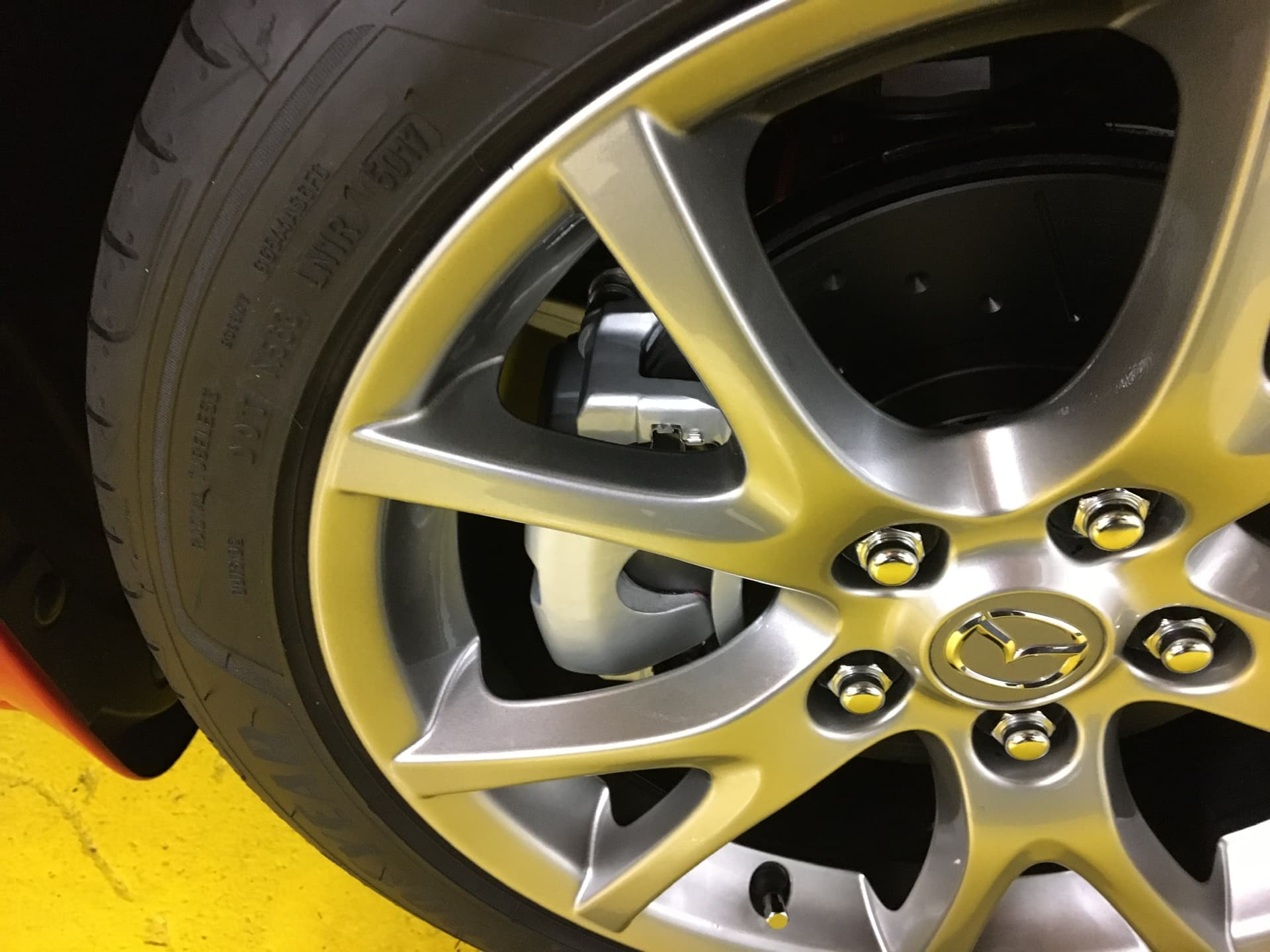

And here’s the front.
Nice job. :+1:

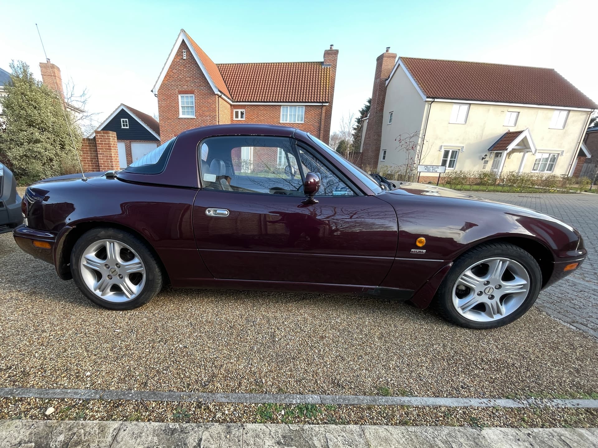

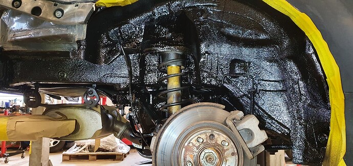

I dropped the Merlot off to have her long awaited surgery (sills, front wings, rear arches, wheel refurb, full respray). Eagerly awaiting the results in a few weeks time! If you look closely you can just see the tape on the front sill that’s been there a couple of years.

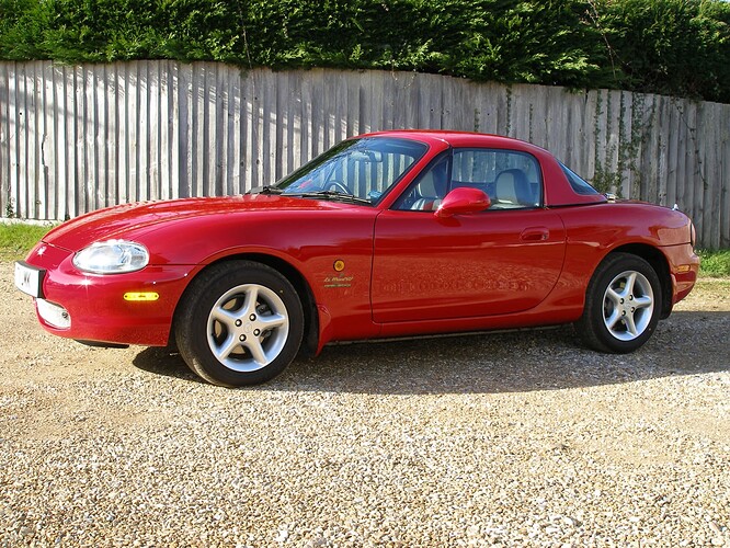

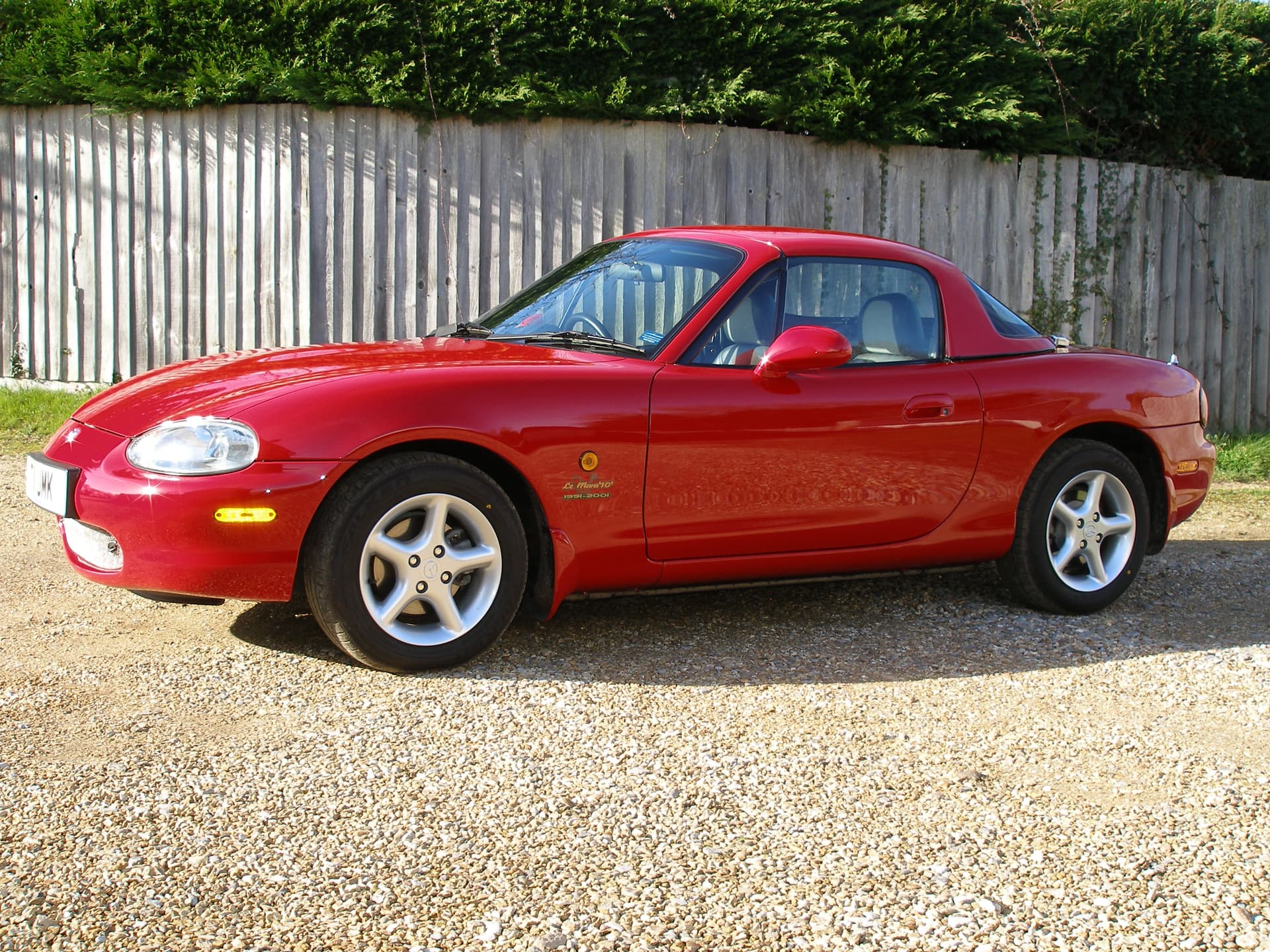

I had wanted to take the hardtop off my lovely little red MK2 whilst it was sunny today, but that plan was thwarted when my husband went out - so I gave the whole car a good polish instead!

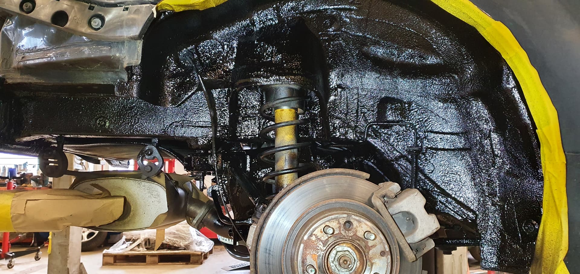

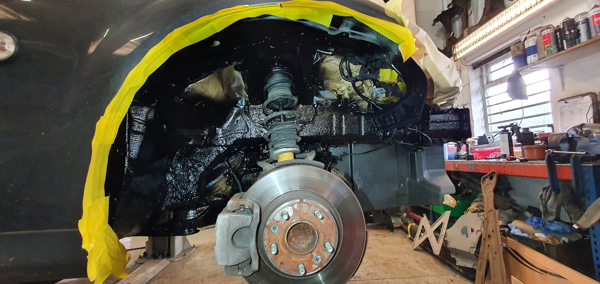

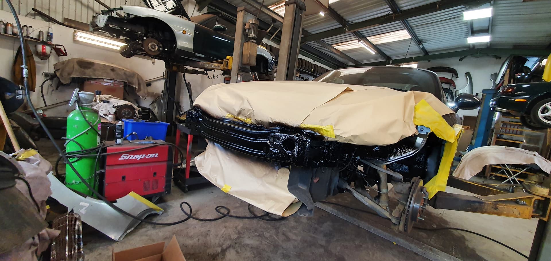

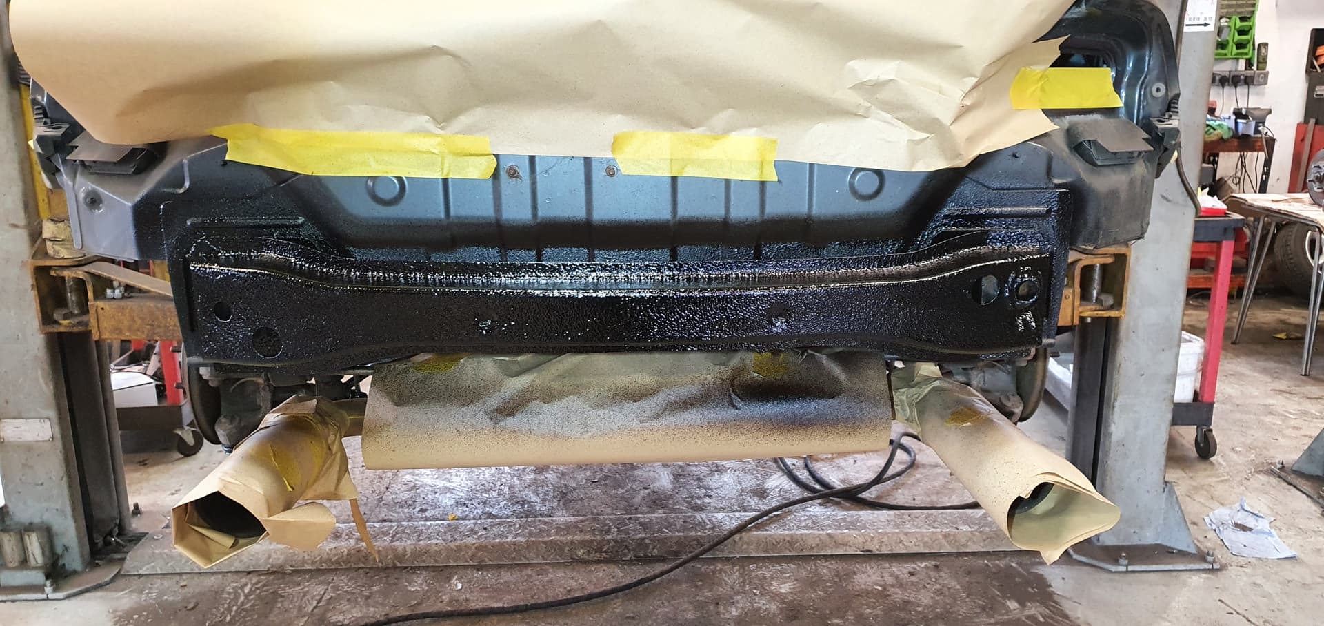

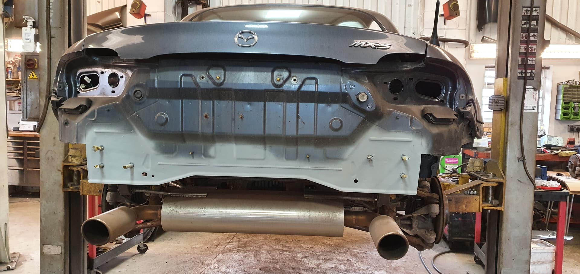

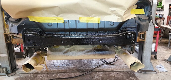

I cant claim I did any of this… The lads from MX5 restorer did all the work and have fitted the IL motorsport Chassis Brace Kit. They didn’t get to fit the front brace (I still have the OEM one) because the induction noise thing has to be taken out to fit the aftermarket brace and I didn’t buy the induction noise delete kit.
You don’t need to buy the kit at all, (unless you want to of course).
Made a bracket, bought a good pipe bung and sealed the bulkhead using the original fitment.
Easily put back if you wish or sell.
I can send you what I did if it helps. :+1:
