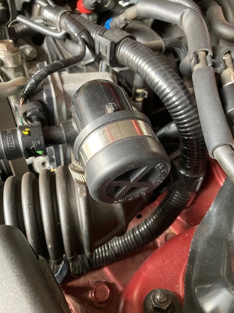

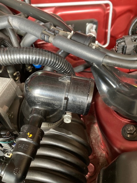

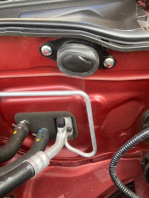

I took all the sound tube kit off and took out the bulkhead fixing.
Put some strong tape on the rear cut to size to act as a gasket.
Filled the hole with foam, taped the outside and used self amalgamating tape to secure.
Then bolted back in place. (Might get a suitable end cap in due course).

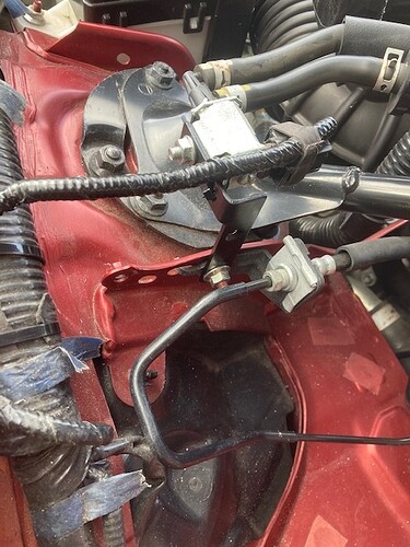

Found a flat 90 degree 3 inch bracket (in the garage) and bent/cut to suit, drilled one more hole, and painted. Fixed using mounting as picture, ( existing holes already there).
Although the pipe is 2 inches, I bought a 1.5 inch end cap, (don’t be tempted to get a 2 inch one it’s too big). I still have the 2 inch one. :roll_eyes:
This ones better.
Job done. :+1:

Thanks. The problem is this pipe though. I think the extra bit thats blanket out it might interfere with the aftermarket brace.
But i will have another look today if i can do something similar.

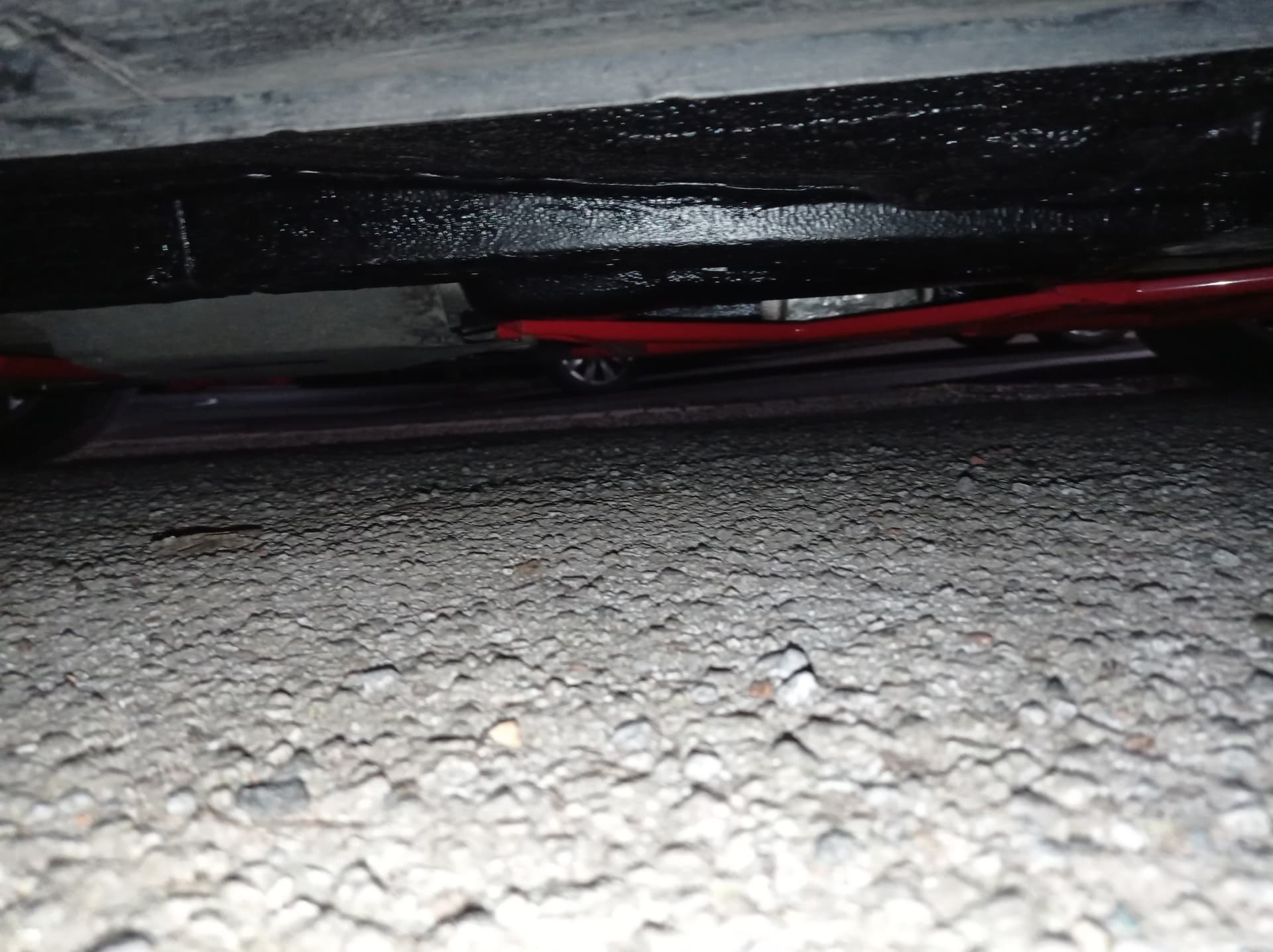

I can definitely tell you one difference. My car on stock mazda sport springs and i hit an empty coke can when i went over it. So if any have their car lowered they are in it for a surprise from that central cross stiffening part. :joy: The rest is fine.

I’m lowered on Ohlins. I put the cross brace on for a bit of fun before driving over to Pevensey. Caught it on a tiny speed bump at local services. If you saw the state of my road (unadopted, shingle/gravel with loads of potholes) you’d laugh and wonder how I haven’t already ripped the underside off my car.
Time to get the tractor in and level it again, methinks. :smiley:

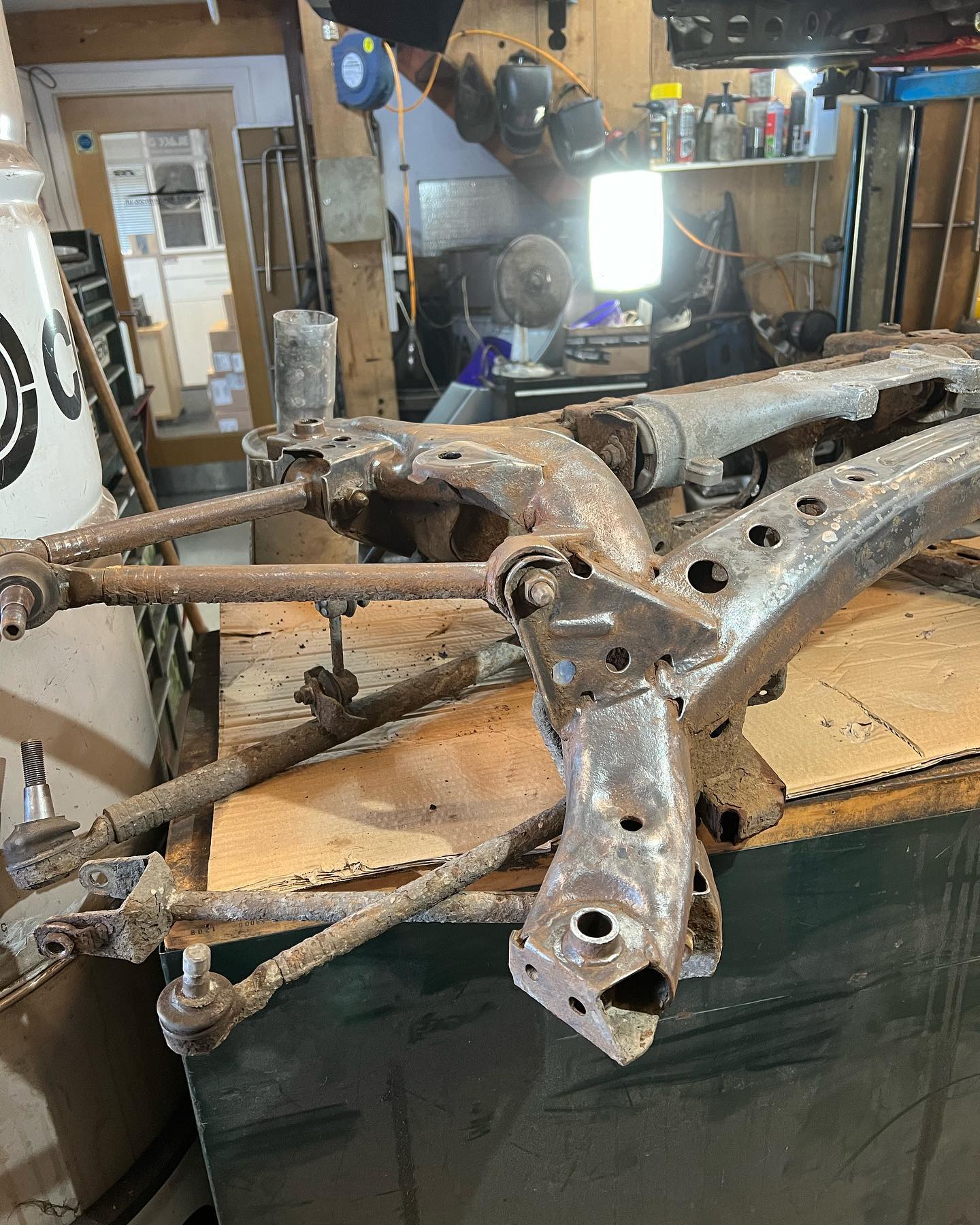

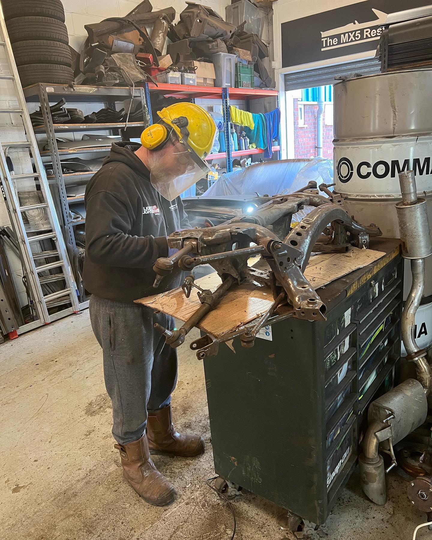

Tizzy’s rear subframe being tidied up at MX5 Restorers.
Love seeing scratty parts brought back to clean metal! Gwed, the restorer lads.
