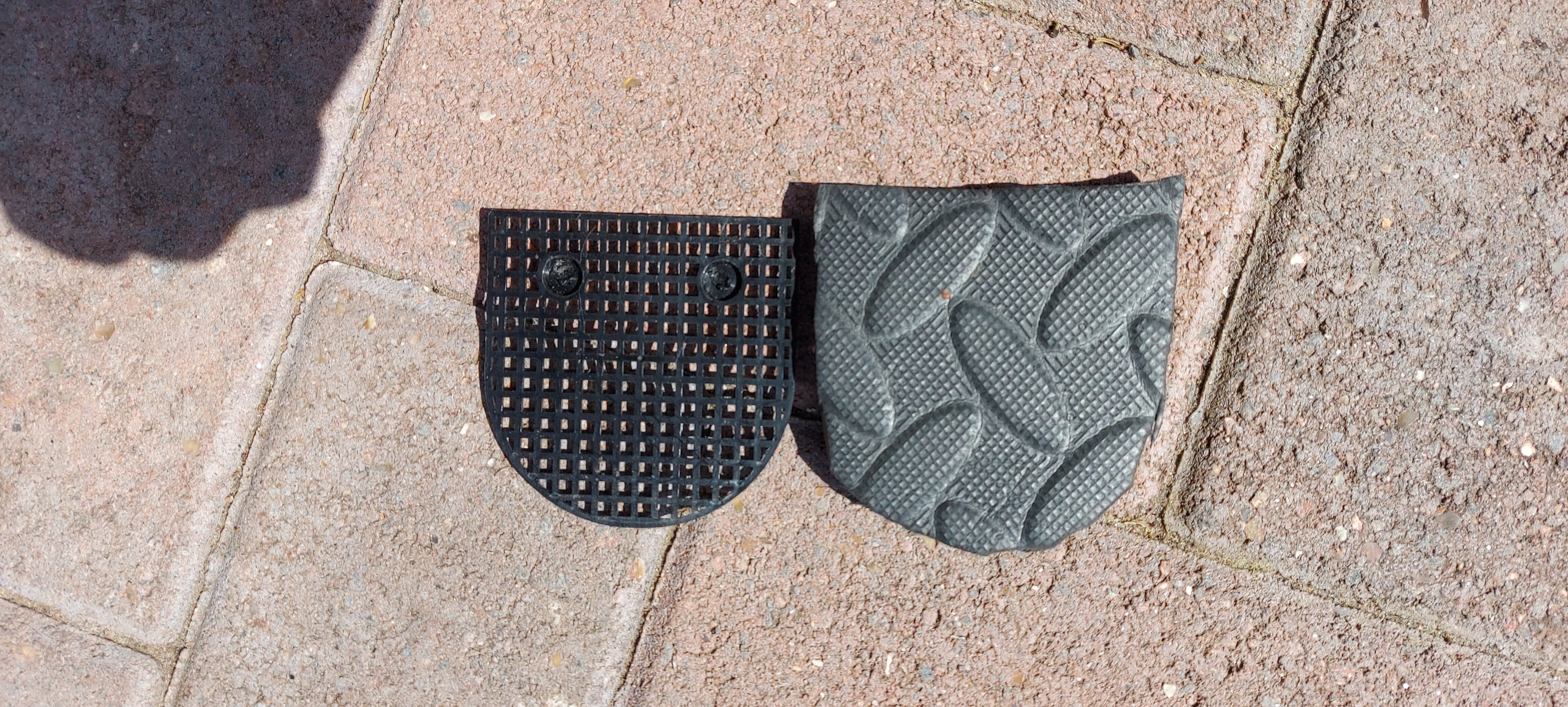

The drain grids are right ay the top of system, you simply part lower the roof and reach in behind the outside of each seat from outside the car and pop them out with your finger tips.
Each side of the PRHT has a tubular drain from the rubber seal around the base of the back window, and a moulded plastic drain from the top of the B-pillar near the seat-belt guide. These discharge onto the grating which then exits through the flaps to under the car.
Looking up at the back window drain tube connection
I’ve not tried to remove the gratings yet, a good strong wet-vac underneath the car held over the outlet with a hand making the seal better seems to be highly effective - no brushes needed.
Hot soapy water seems to free off most dried-on gritty deposits and helps the flaps seal better afterwards.

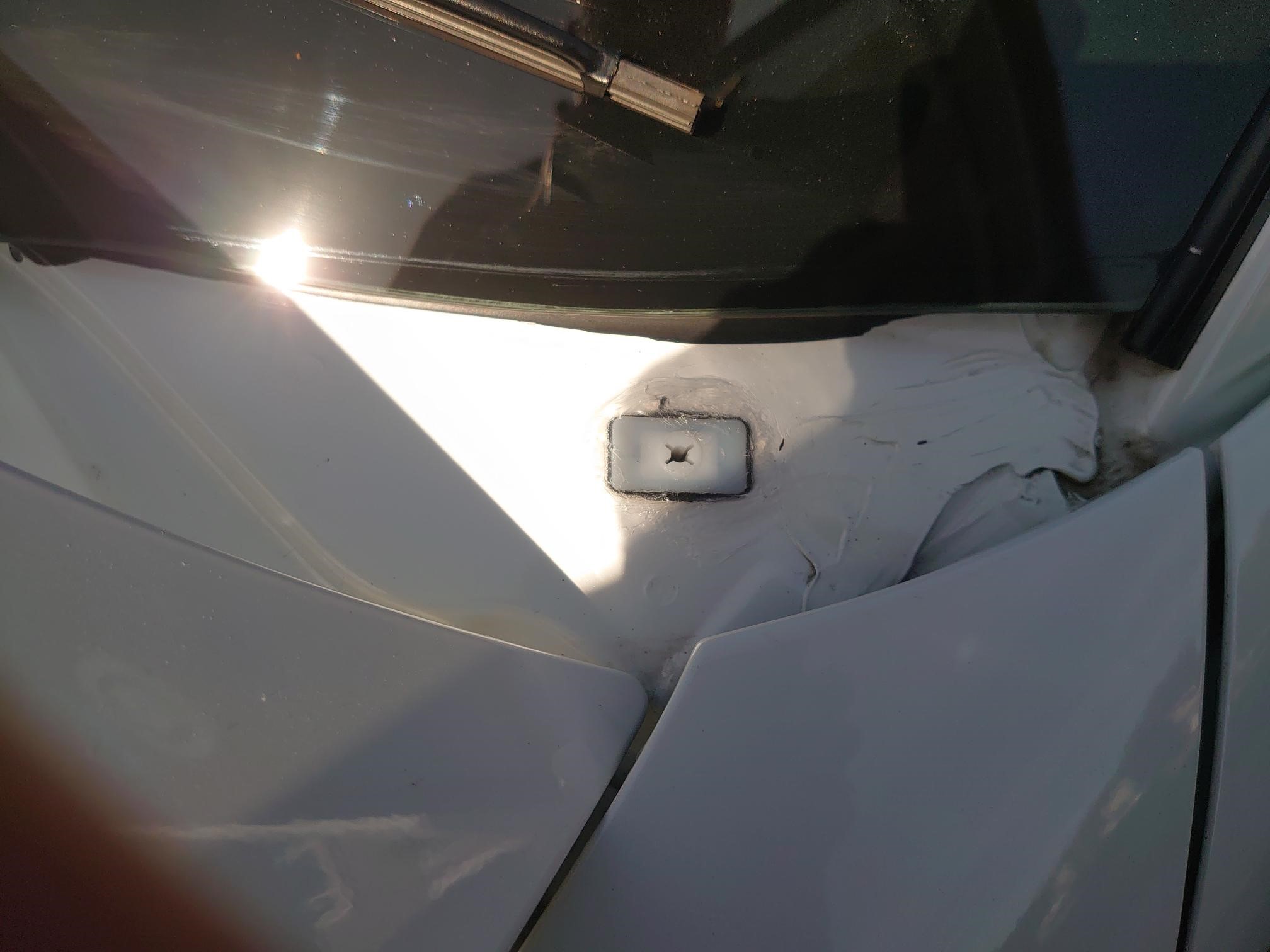

Scuttle grommets done

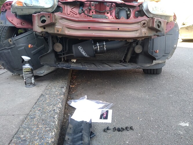

Had this in a box since mid 2020, weather was nice so fitted it.
Bumper removal is very easy on this car.

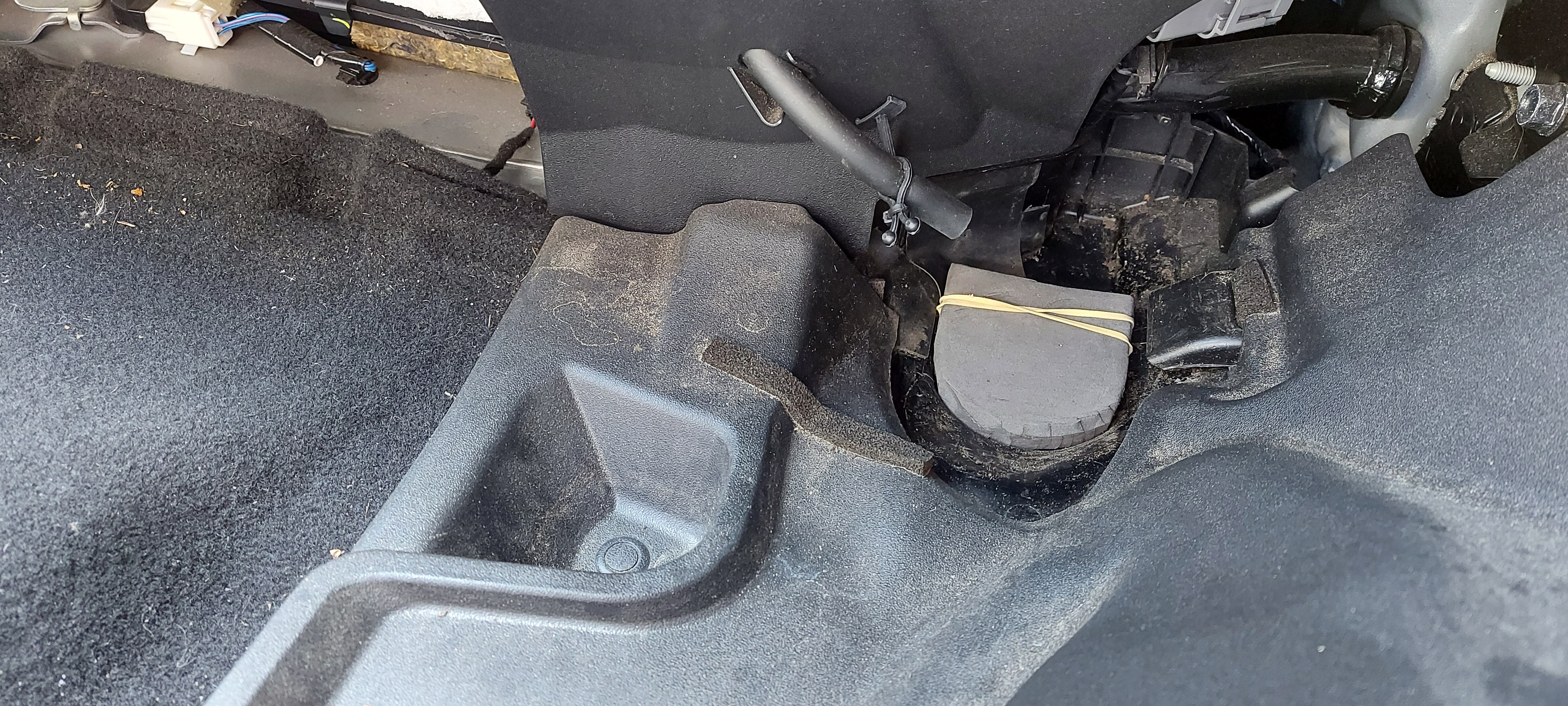

The laccy band is there because I found the foam baffles had moved, perhaps from air pressure up through the tube.
I’ve put the bands at the edge so the foam baffle can operate as a flap and float upwards if flooded with water.
Thanks for posting those. Unfortunately, I’ve got a soft top and the drainage system is different and harder to get to. It may be that replacing the tubes is the only answer.
