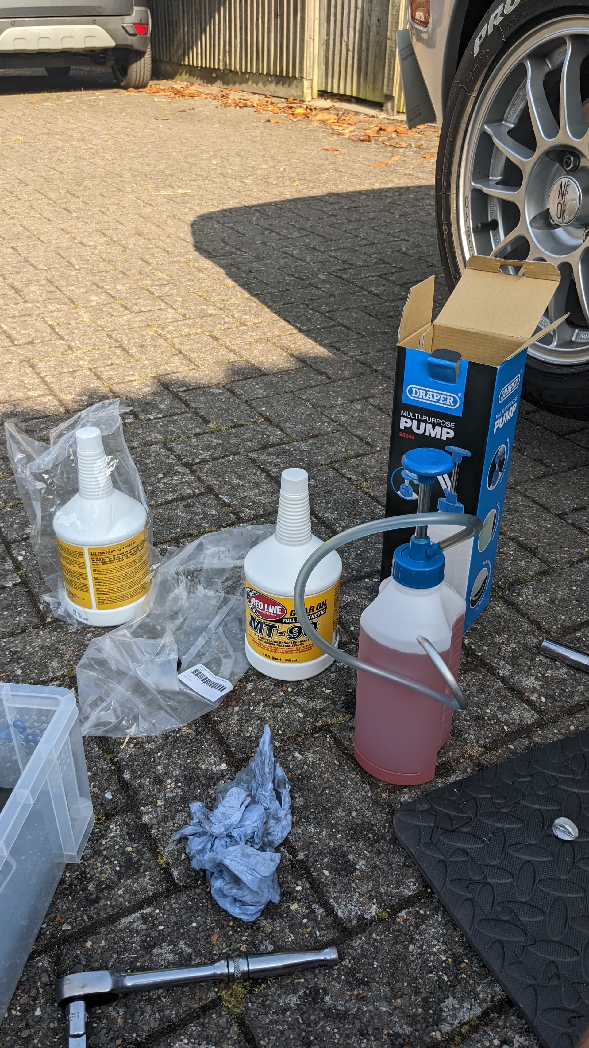

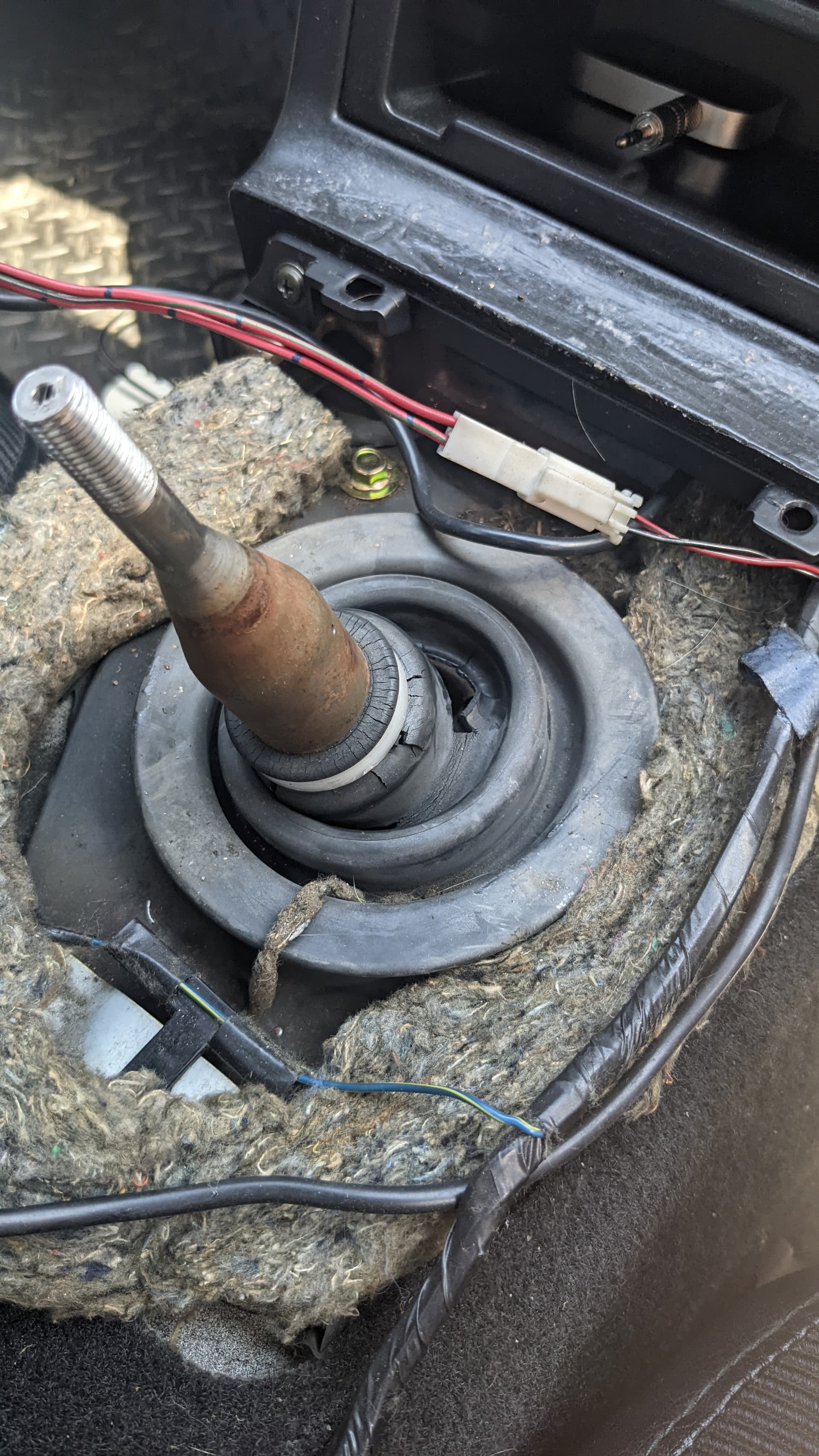

Just fitted new upper/lower shift boots courtesy of MX5 parts, as well as replaced the gearbox oil with RedLine from BOFI. The old gearbox oil was dark brown so it was definitely due a change.
Worryingly, there was no oil in the shifter turret, so I whacked about 100ml of redline gear oil in the turret before sealing it off.

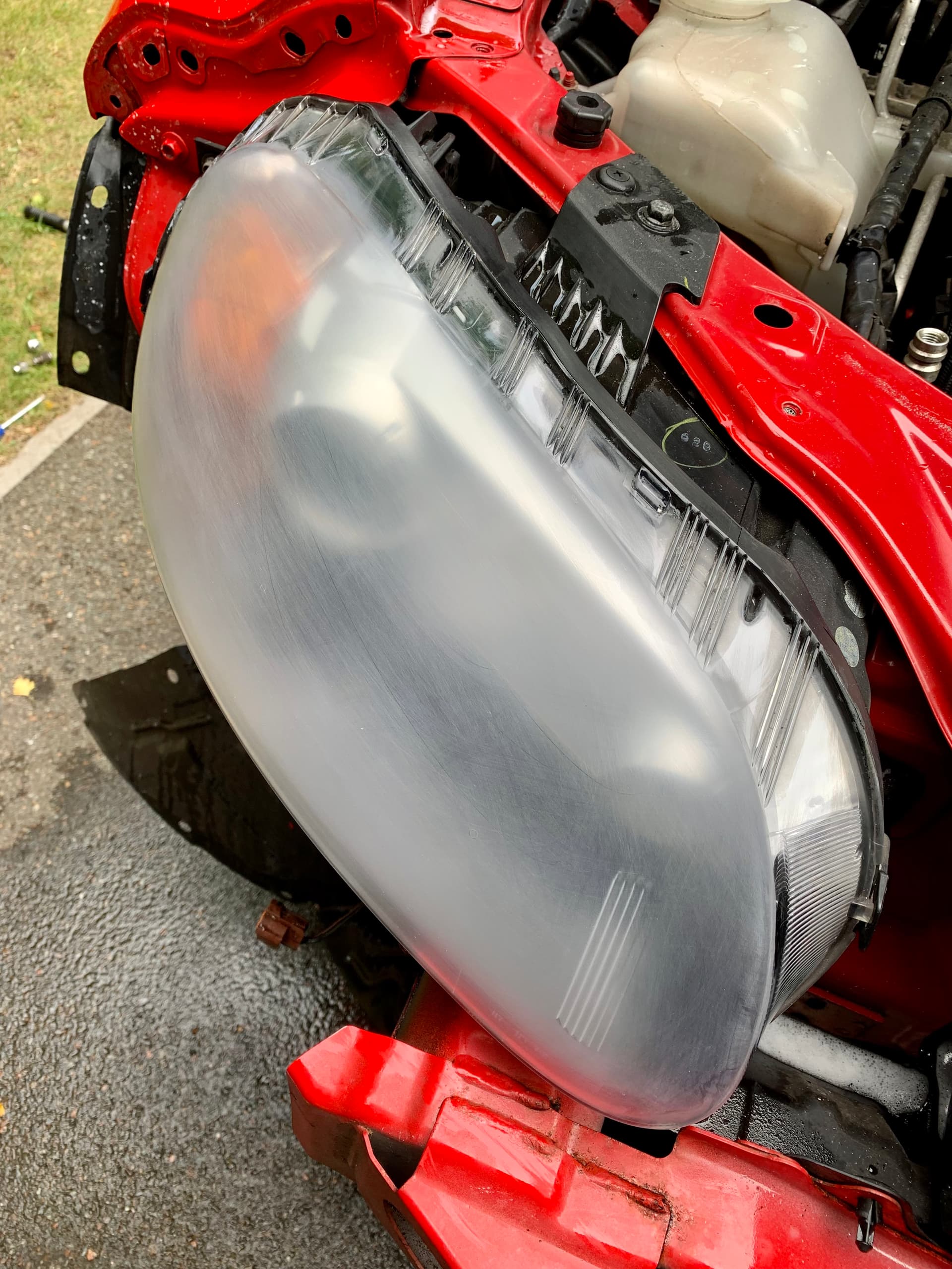

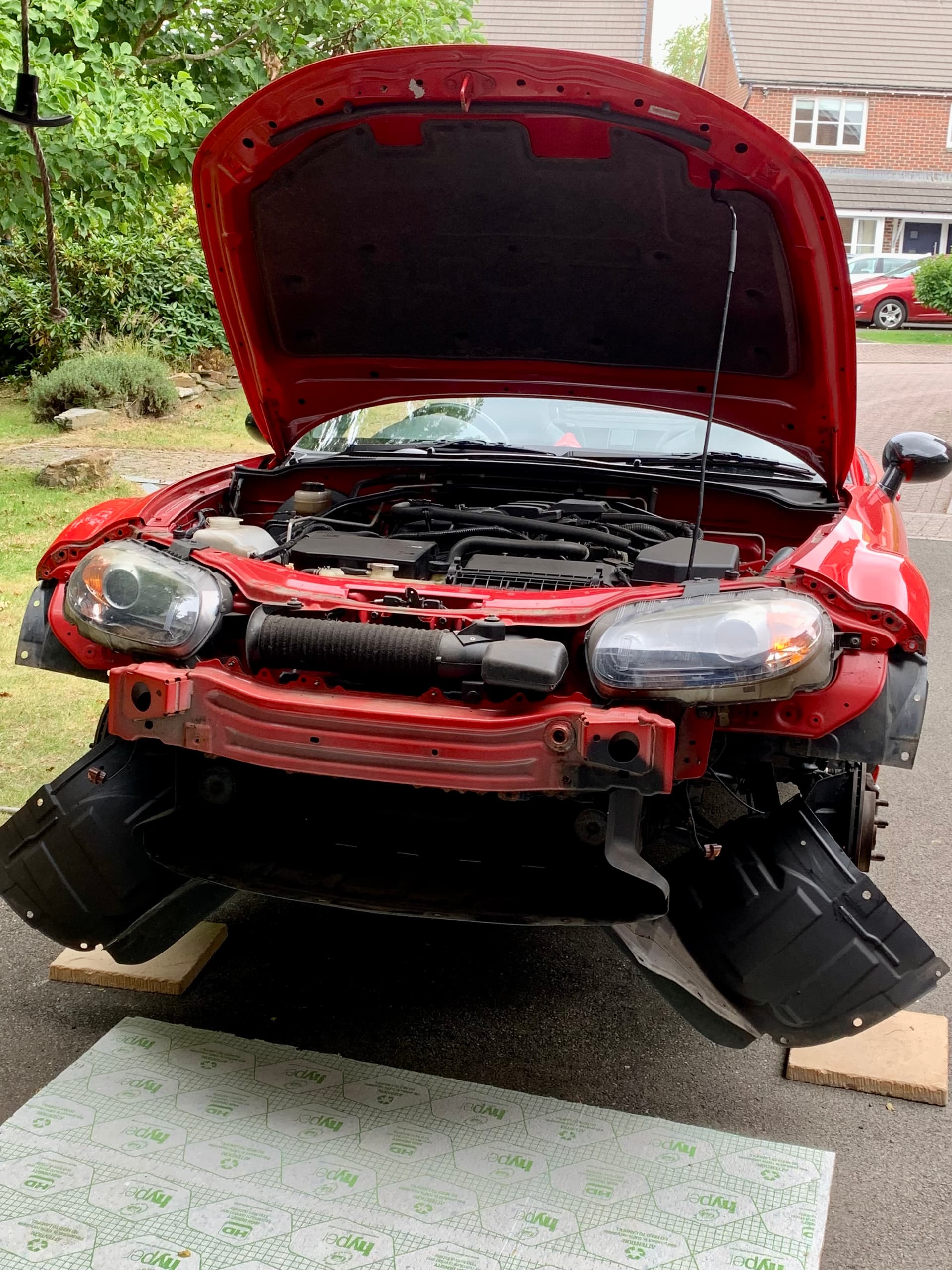

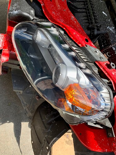

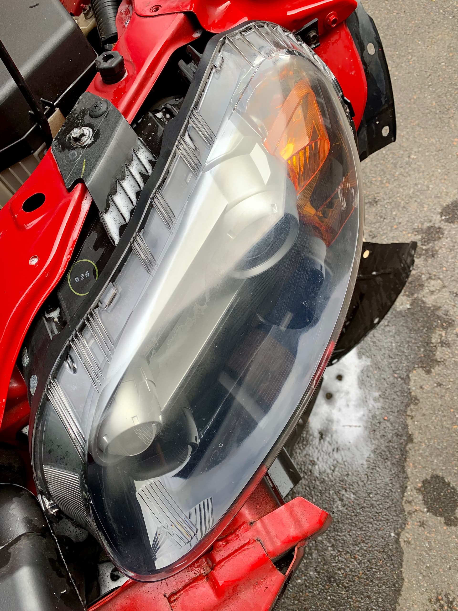

Taking advantage of the fine weather and giving the front of my NC some love.
As many will know, the headlights can take some bashing from the roads and UV. Mine were no exception.
Yellowing and quite hazy so bumper off and using Holts repair kit.
Before
During
After
Can be quite unnerving doing it but with patience and time, I think the results speak for themselves
Good recovery on those.
They look like newđ
Yes, thanks, they do. Well pleased. Took the opportunity to change all the bulbs too as getting to the bulbs on these NCâs is a pig.
Been there and done thatđ
Sparkling result.
Great job well done ![]()
If you spray them with 2k lacquer it will help protect the finish against uv.

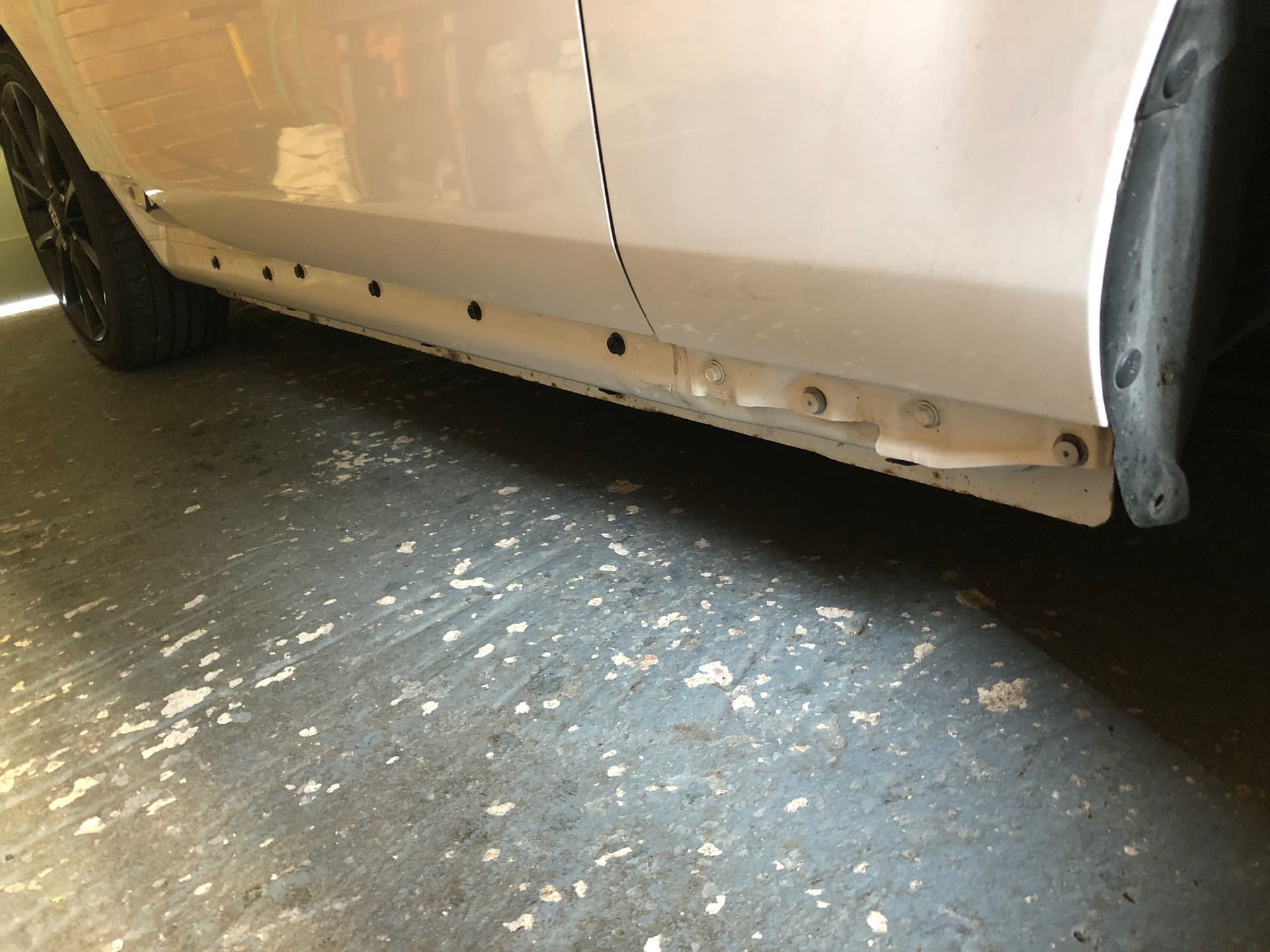

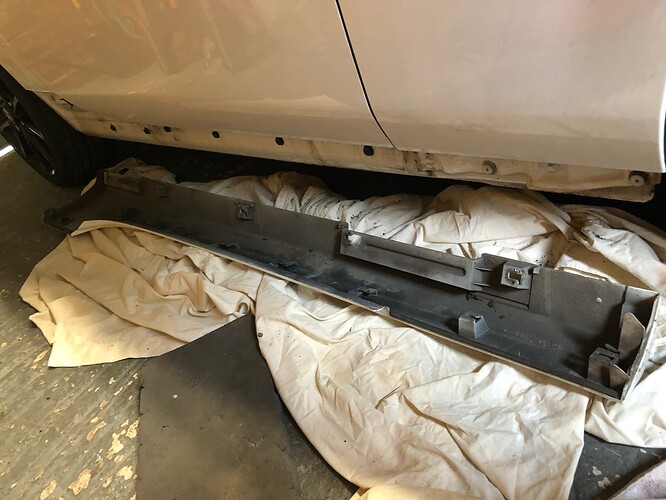

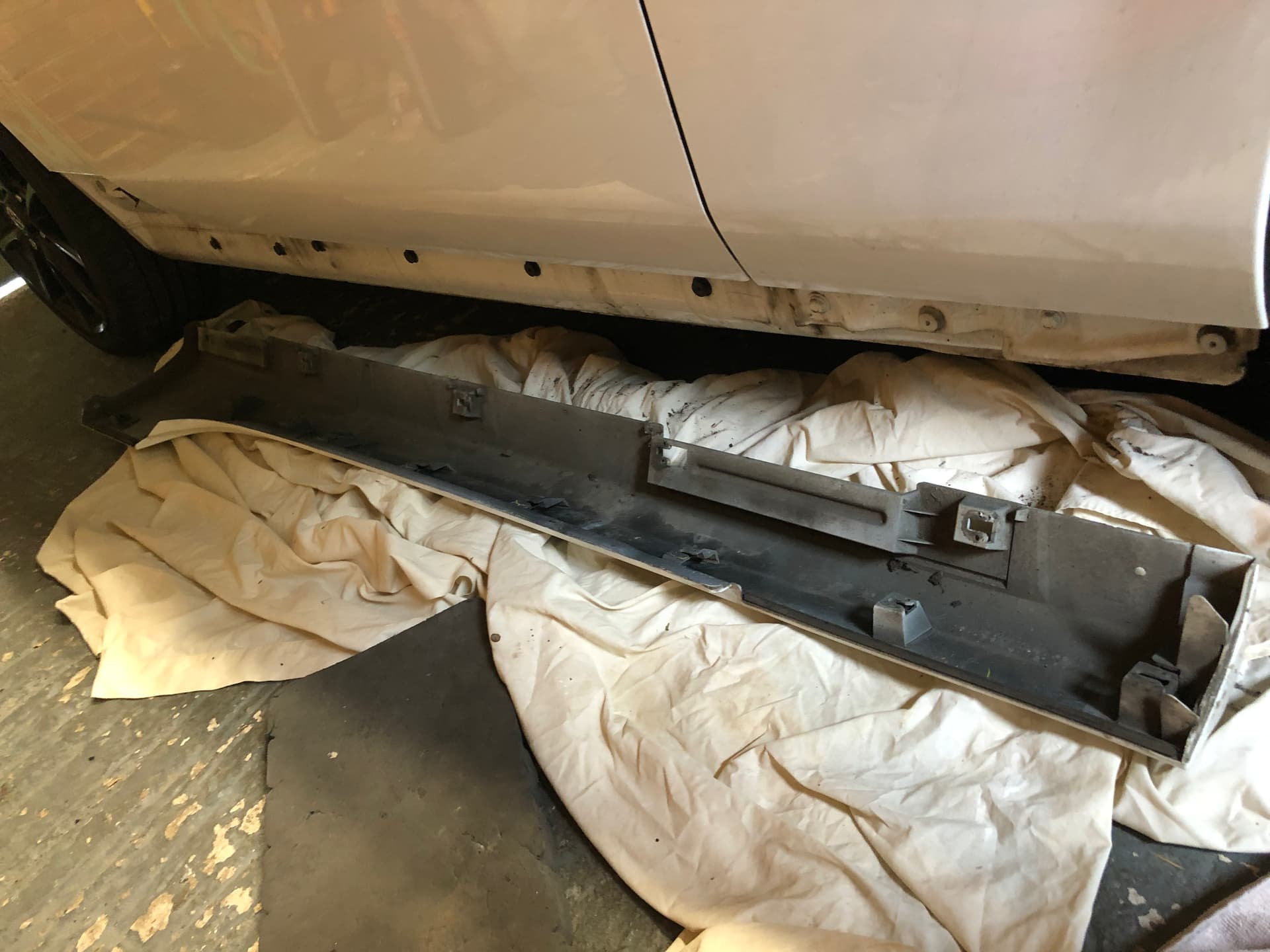

Drivers side skirt removed on Sport Black to see how it looks for rust after 11 years on the road.
Not too badâŚ
I bought replacement clips, prior to removal, from Vehicle Clips.
Less than a fiver for 20!
The skirt bracket on left hand side of drivers door sheared (glued back on) but all the clips were intact.
Passenger side tomorrowđ
Yeah mine pretty much went the same way on one skirt on the NC1, a broken bracket which i glued back.![]()
