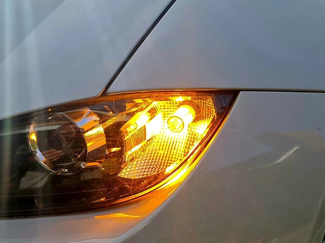

Upgraded the indicators on our RF to full LED all round. Thankfully, no hyper flash! Front bulbs were changed to these units.
They are a lot brighter than the OEM bulbs.
Sides and rears are sequential. Quick video of everything working.

Do you have a link to the front indicator bulbs you purchased? Thanks.
They were these ones, Paul. :+1: Apparently have the necessary resistors built in to avoid hyper flash and are canbus compliant. Certainly worked for me as the photos and video bear out.
