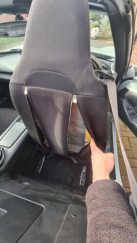

Meshectomy to the back of my ND seats… so much better! Had already done the bottoms, but feel even more “in” (rather than on) the seats now. The “wings” flex inwards as you sit in the seat, hugging your sides nicely. Better lumber support too after I’d played with how many clips to undo. Easy job, disappointed I didn’t investigate this sooner!
Safety note, seats have airbags so disconnect battery and allow to discharge for 20 mins before delving in.

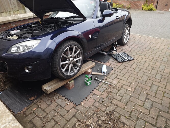

spent the rest of the day raising the suspension by half an inch all round and fitting a front lower chassis brace, Ohlins are now 2 years old and still look new then a clean quick mop and polish its now tucked up asleep till I find something to do on it tomorrow i have some rol bar cavers piano black on there way to me ,next maybe some later leather seats and a new hood
