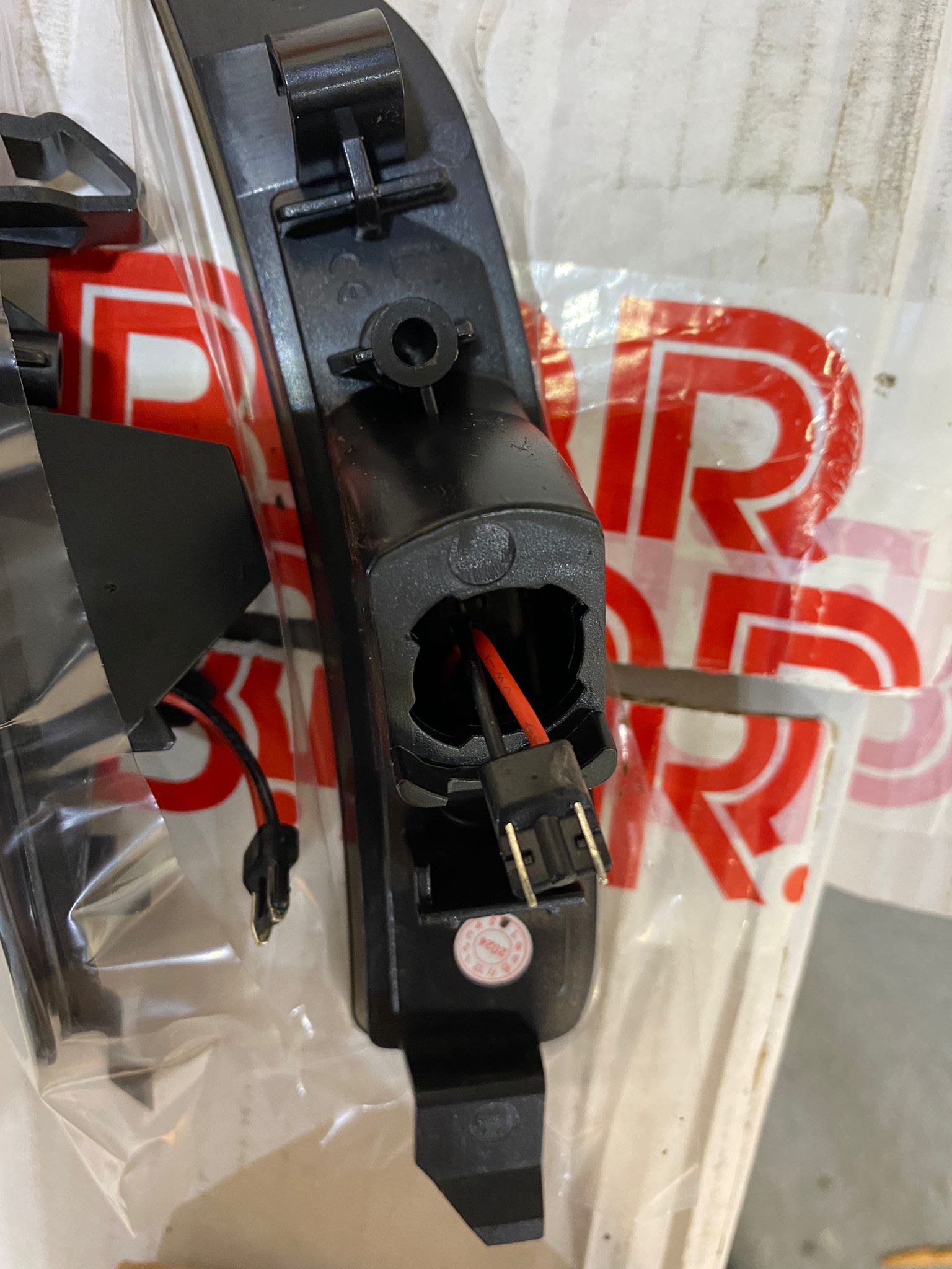

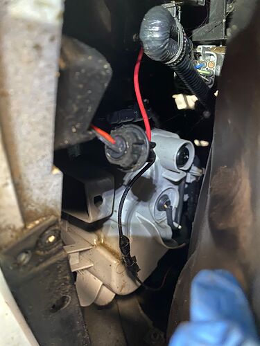

Then comes the next one - the side LED corners. fitted when i purchased the car they were clear. but now a mouldy colour and 2 have stopped worked, presumably due to water ingress. so ive just taken off the fender liner to fit the new replacements.
Some numb nut has decided to run their own wiring! its a non standard live and random earthing! so my plug and play replacement just got launched across the garden at pace.
not bloody happy. officially rage quit for the day.

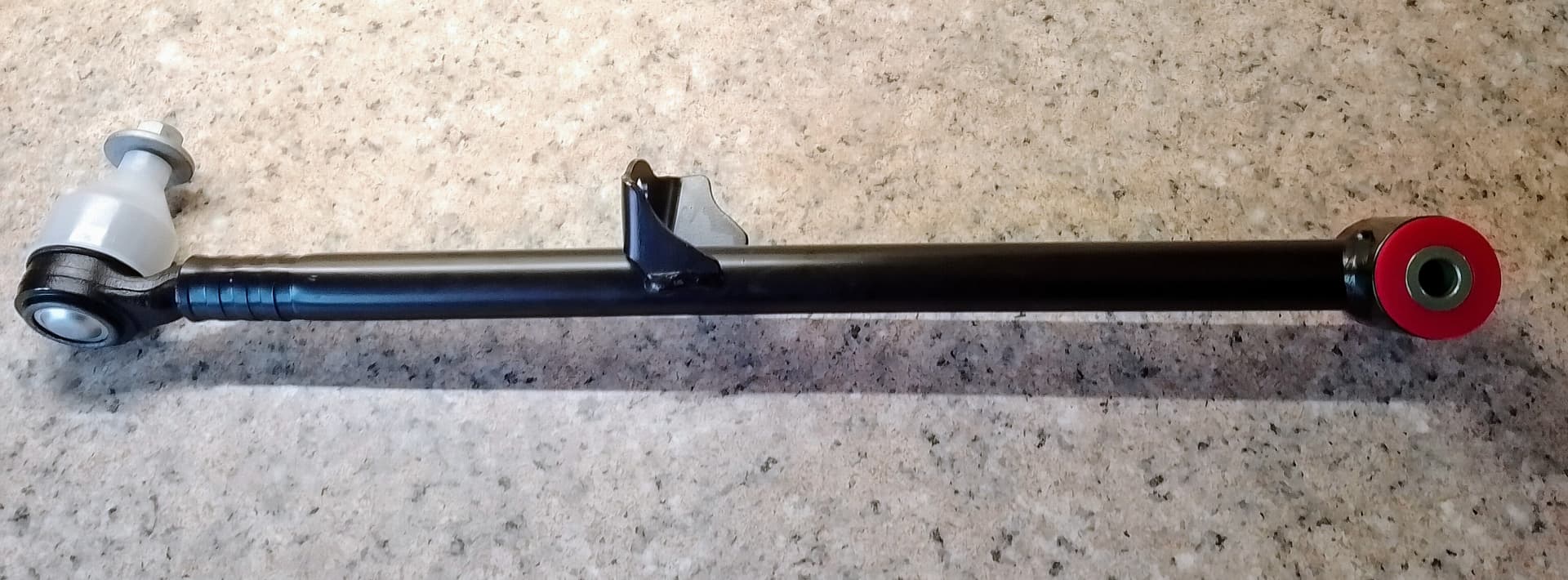

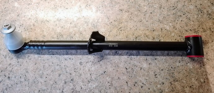

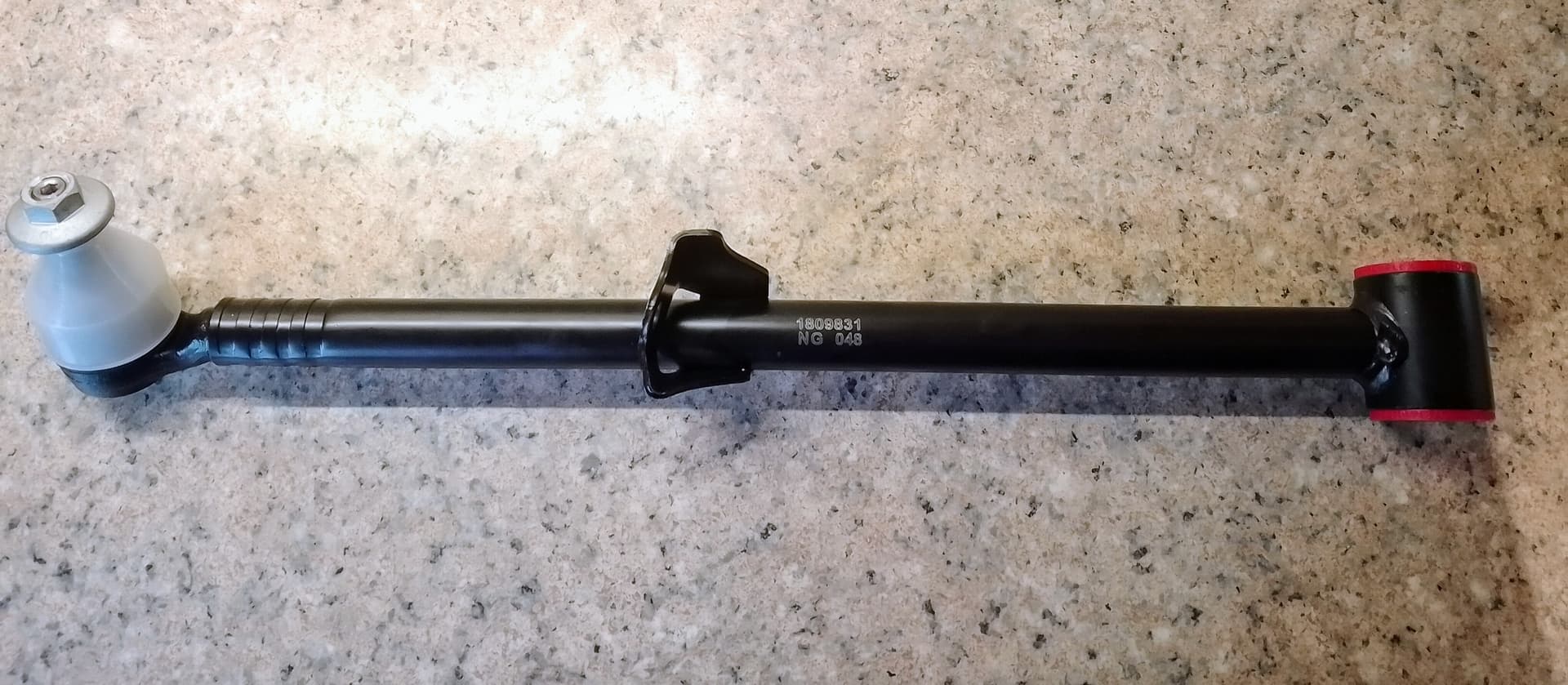

Continued with my poly bush upgrade.
So these arms are new… aftermarket jobs costing Ā£50 apposed to Ā£120 genuine.
Pretty solid unit, good quality welds and decent looking ball joint.
On removing bushes I found rubber to be quite soft, inner sleeve plain mild steel.
Then…bush housing id is 38.5mm new poly bush od 38mm, so they fell right in.
Once inner sleeve inserted they did expand and ā€˜grip’
Think I’ll wrap PTFE tape around bushes before final fitment. Hopefully this will help prevent any possible play I’m concerned about…time will tell :roll_eyes:

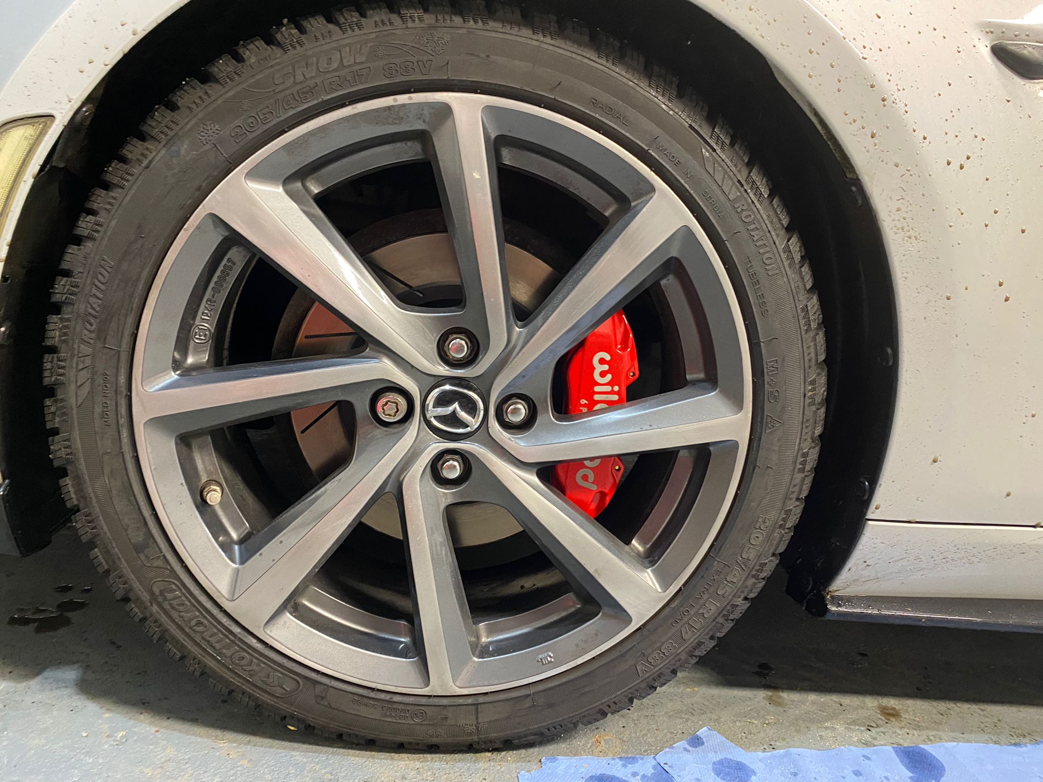

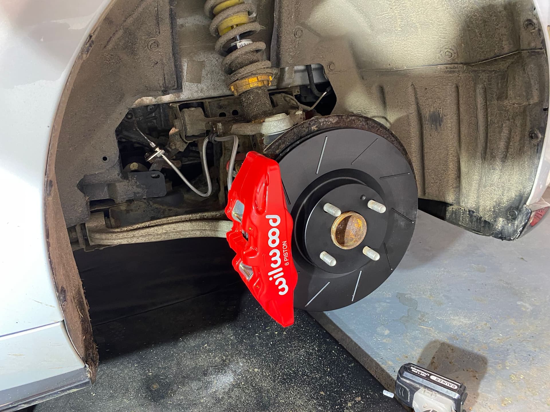

Fitted the 6-pot front calipers :slight_smile:
All went well, except for the brake bleed. after borrowing tool sets from someone else, i had almot everything. but couldnt find an open ended 1/4" for the bleed nipple. so lots of messing around taking the bleed pipe on and off while locking / unlocking it.
aaaand then forgot to check the reservoir. (face plant), just when it was nearly done i took in air and had to start all over from all 4 corners. bugga.
other than tht, all good.
been out for a drive. the fronts feel very smooth and supple. huge braking power, locked the front wheels very easily with what felt like 60% brake force in the foot. (after bedding in for a while).

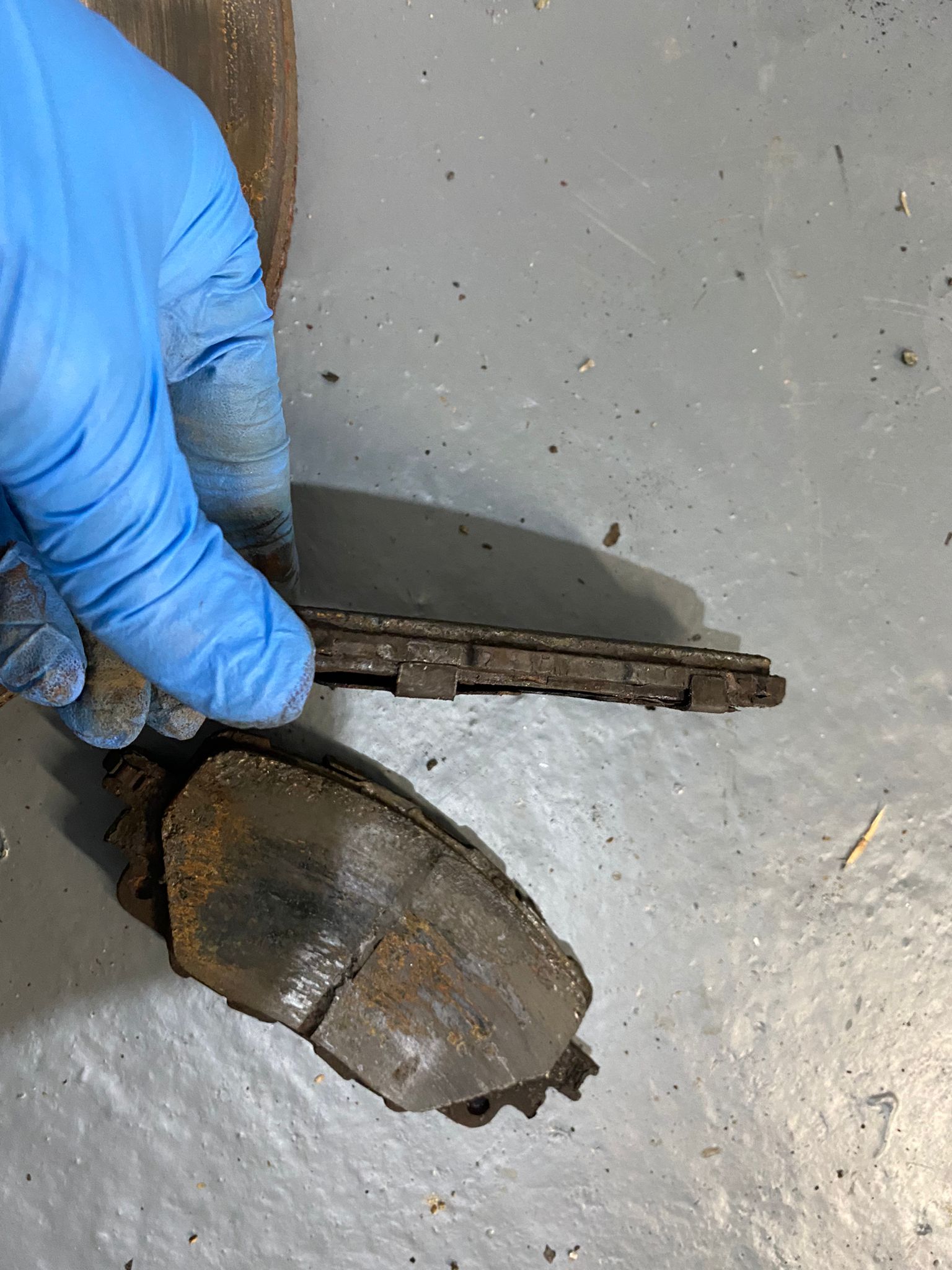

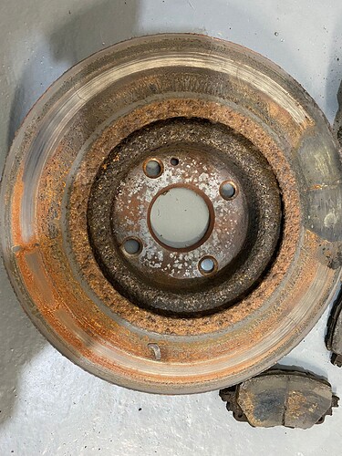

Now onto the rears.
pics below. (look at the state of those OEMs! hadnt realised they were so bad.)
