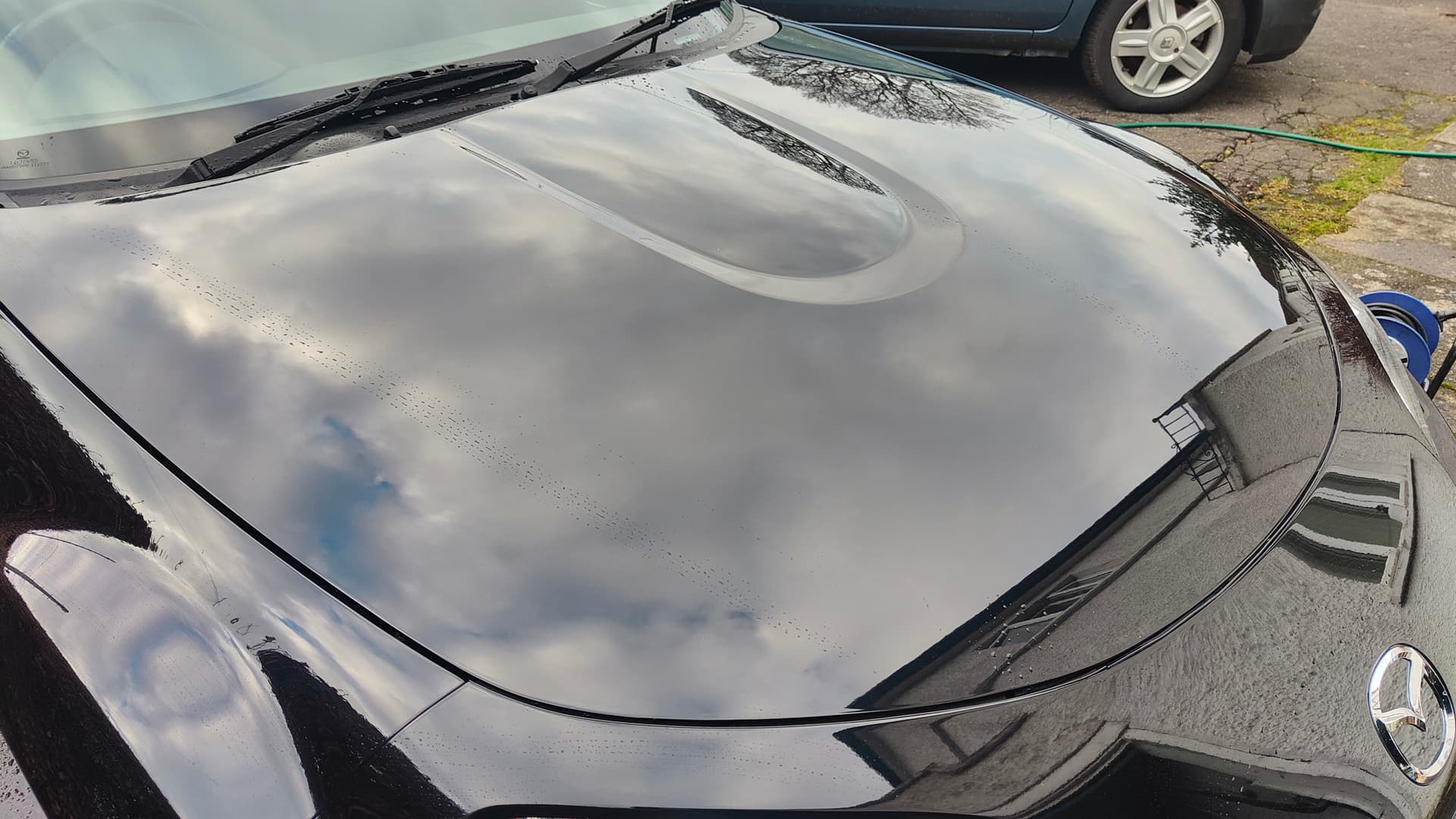

Gave it a well-needed wash. It’s still crying out for a touch up in spots plus a proper machine polish to bring out some of that Sparkling Black flake but that’s on hold until Spring.
Products used were Bilt Hamber Surfex HD and Touchless snow foam for pre wash, Meguiars Gold Class Shampoo, followed up with PoorBoys Black Hole glaze and topped with Turtle Wax Ice Seal n Shine spray sealant. I love the Turtle Wax stuff as you can zip round the car including the glass and results, well, they speak for themselves - useful as a drying aid too.

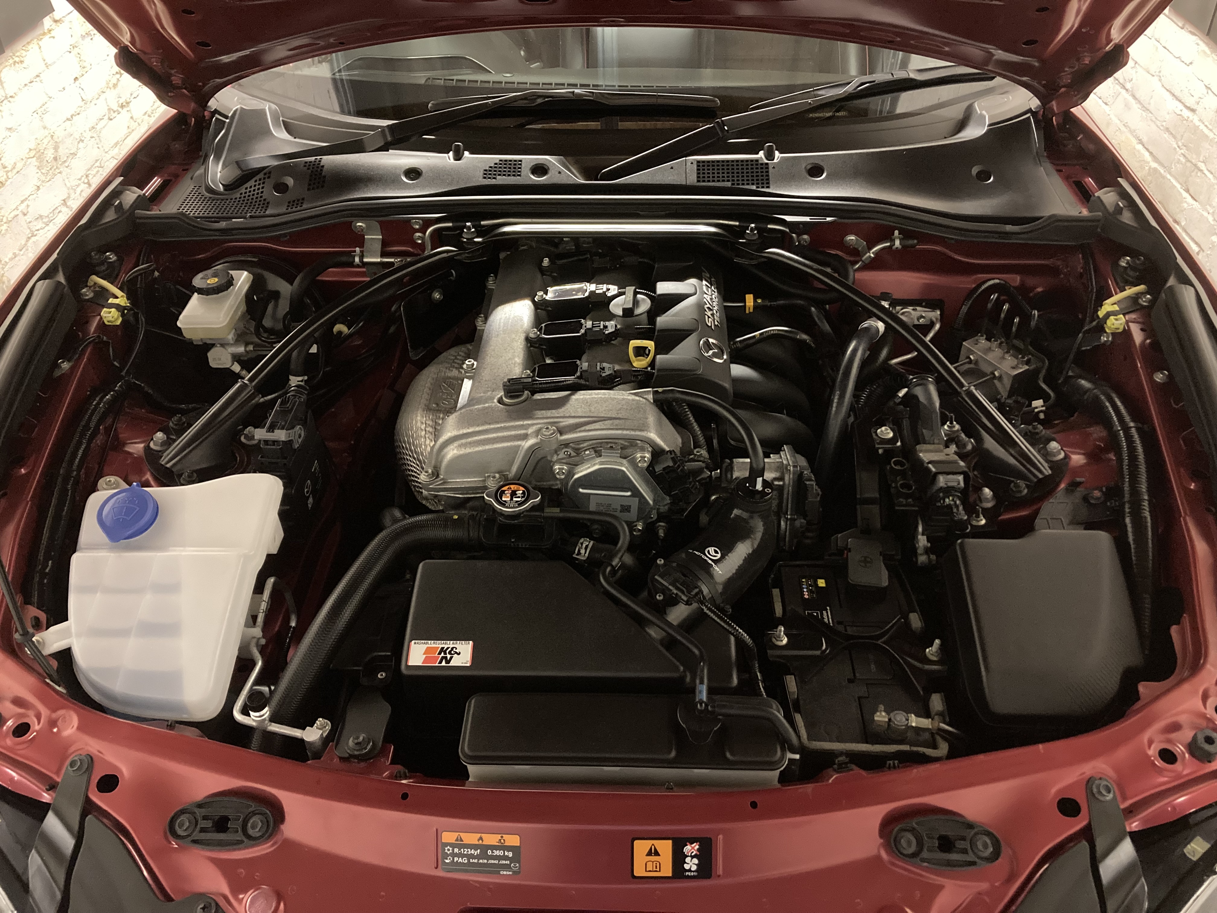

This all started due to OEM clips holding air intake hose needing replacement due to being crap and corroding. Which looked unsightly in engine bay. So…
New silicone air intake hose
Sound tube delete ( purely for uncluttering engine bay, sports exhaust provides all noise needed ), using versus engineering aluminium component

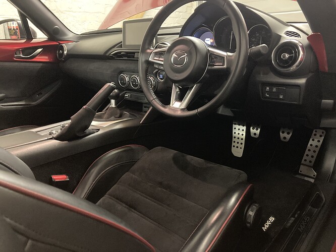

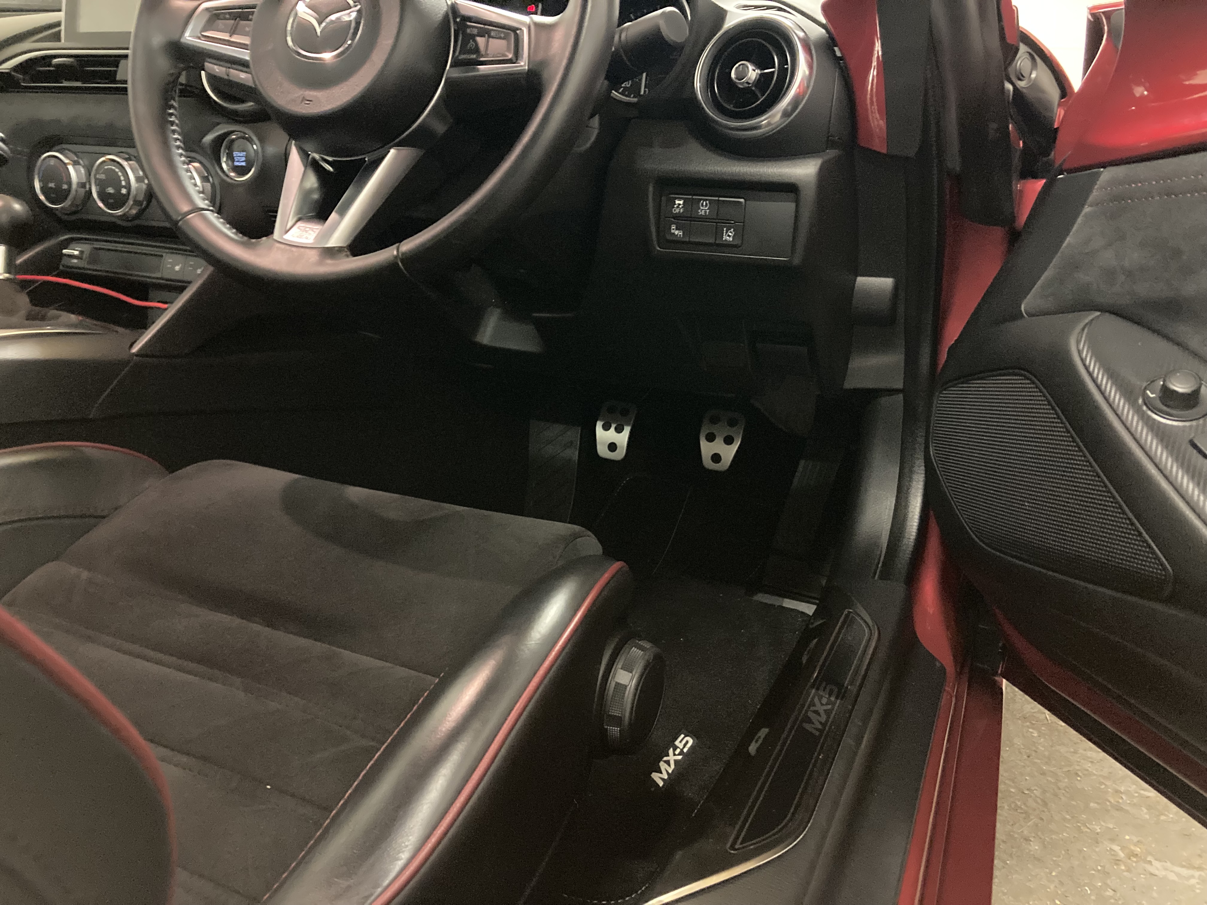

And began the install of aluminium pedals. One thing I’ll say on the IL pedals… ignore the instructions. Heat the rubber with missus hairdryer. start install at top, then use a bicycle tyre leve ( the hook end ) to pull down and over the bottom simple. Doing bottom last with tyre lever gives you space and ability to pull down and over. Whereas at top space is limited and unnatural position to pull up
Accepting that Tizzy isn’t putting out as much power as I thought, the leap from 175 to 250 will be a worthwhile difference. Booked in for a BBR Stage 1 Supercharger for the end of Feb.
Pedals completed.

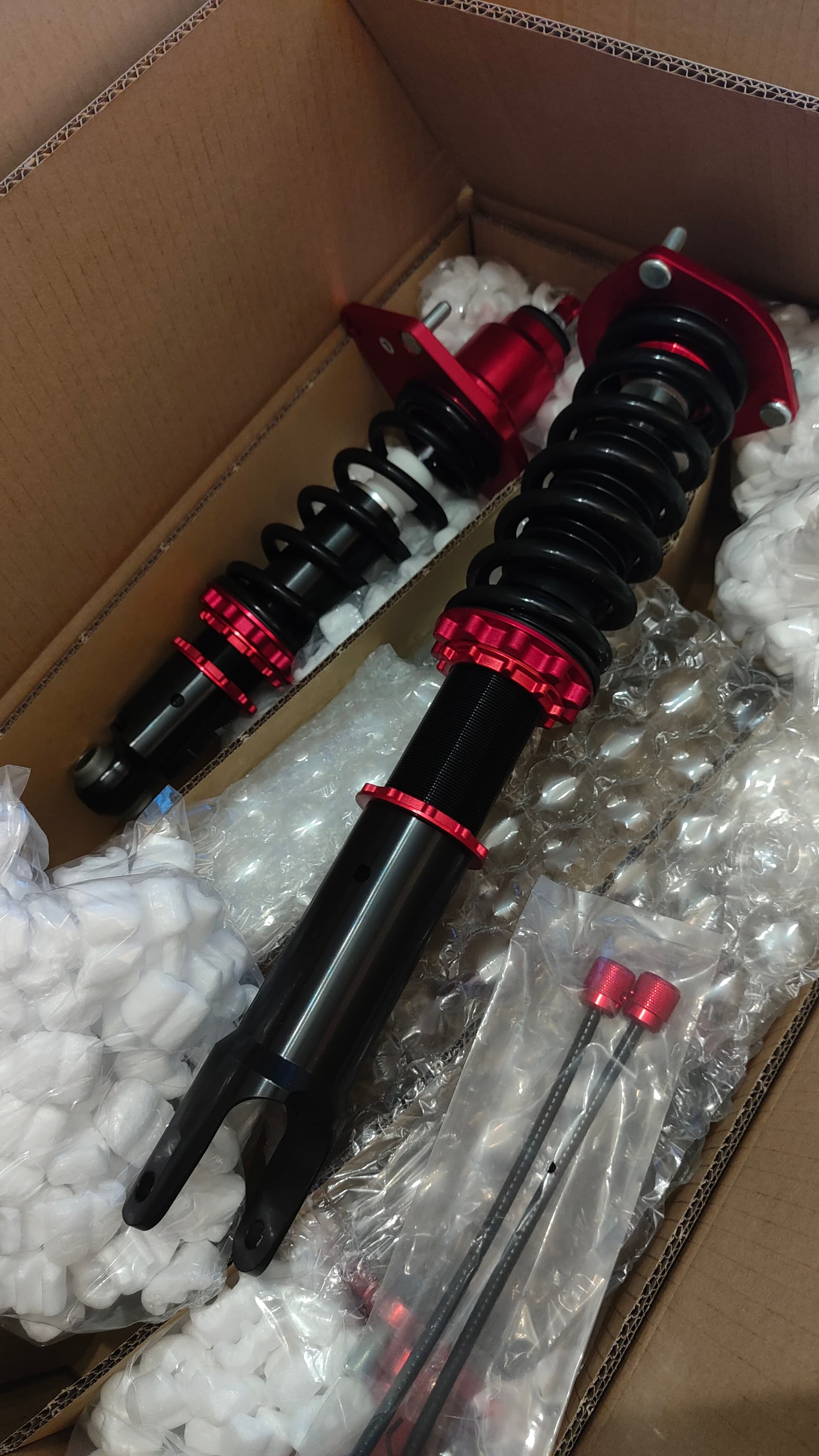

Unboxed these bad boys, new MeisterR ZetaSports and adjusters. Ordered late on the 21st, arrived safely last night. Still a fair bit of work to do sorting bushes and such before fitting but they’re here…finally.

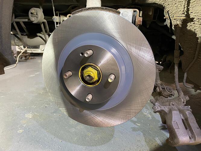

new pads
and discs fitted to the ND. peice of cake doing the rears.

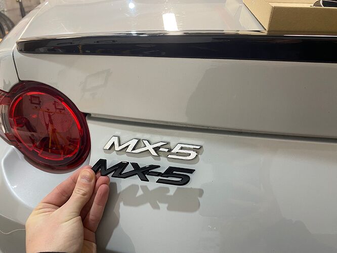

i am going for a black and grey theme on my recaro. and so the chrome had to go… will be getting these fitted soon

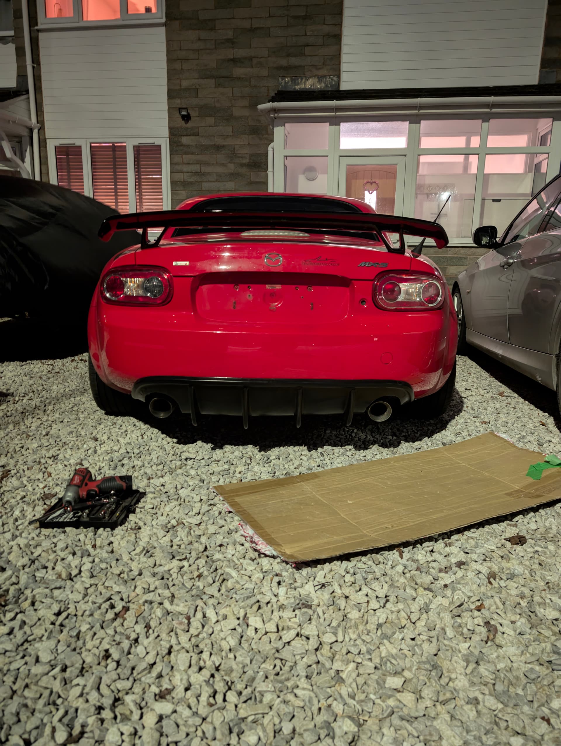

New spoiler, diffuser, and exhaust installed. Finally the car start looks as it should

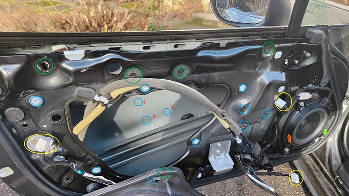

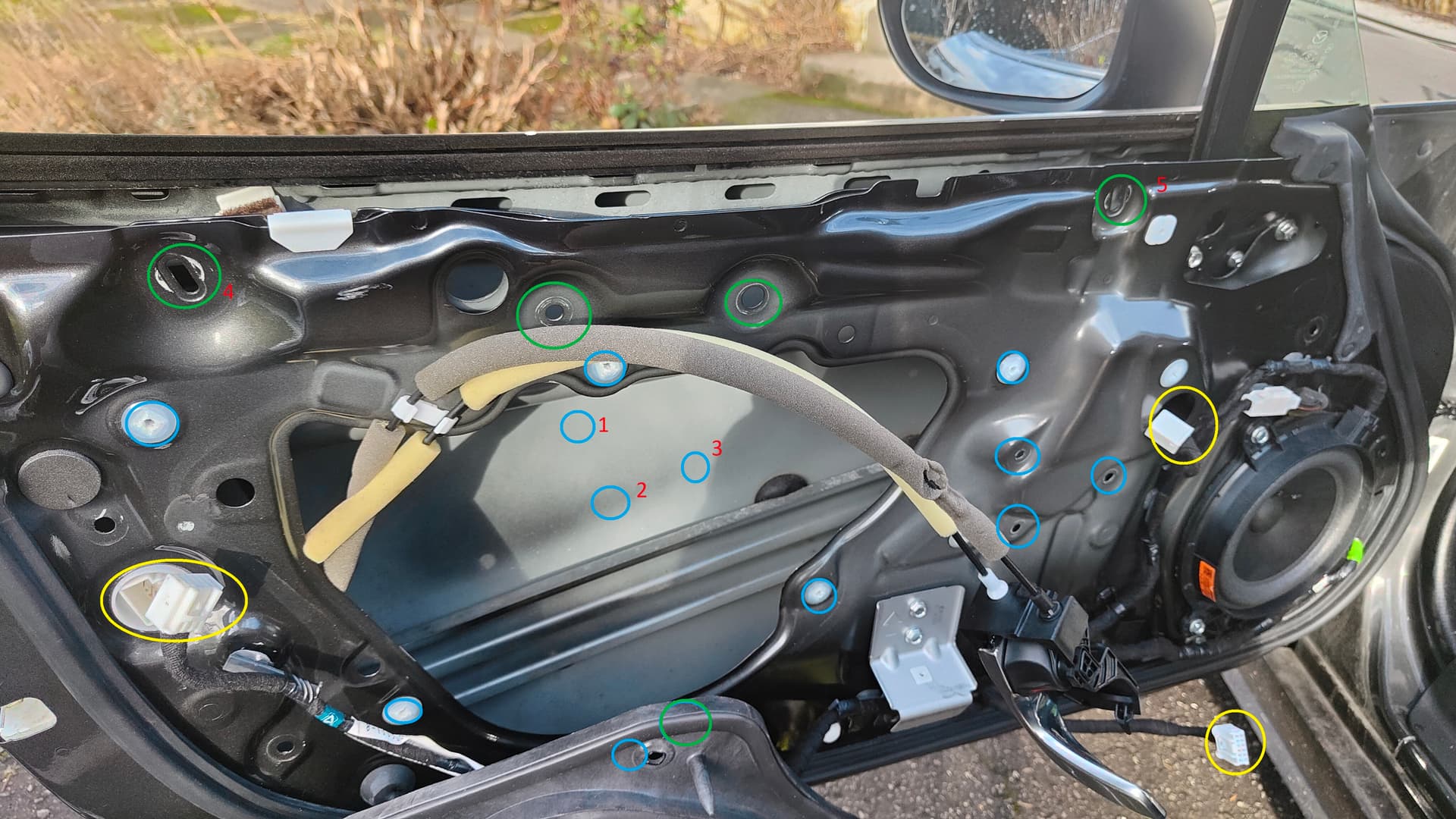

Although technically not mine, I replaced the passenger side window regulator on my sisters RF today after it failed last night. I released the splayed cable from the regulator and gaffer taped a small piece of wood to the regulator arm to hold the window almost (fully up) overnight.
Tools needed:
10mm socket
14mm socket
Philips screwdriver
Small flathead screwdriver
Time: 60 minutes
P/N for passenger (left): N24359590B
P/N for driver (right) side: N24358590B
I was still waiting on my Mazda dealer to call me back so went along to Arnold Clark Parts in Glasgow and picked one up, £58. I always forget to take plenty pictures but hopefully this will explain how to replace it well enough - it was an easy job.

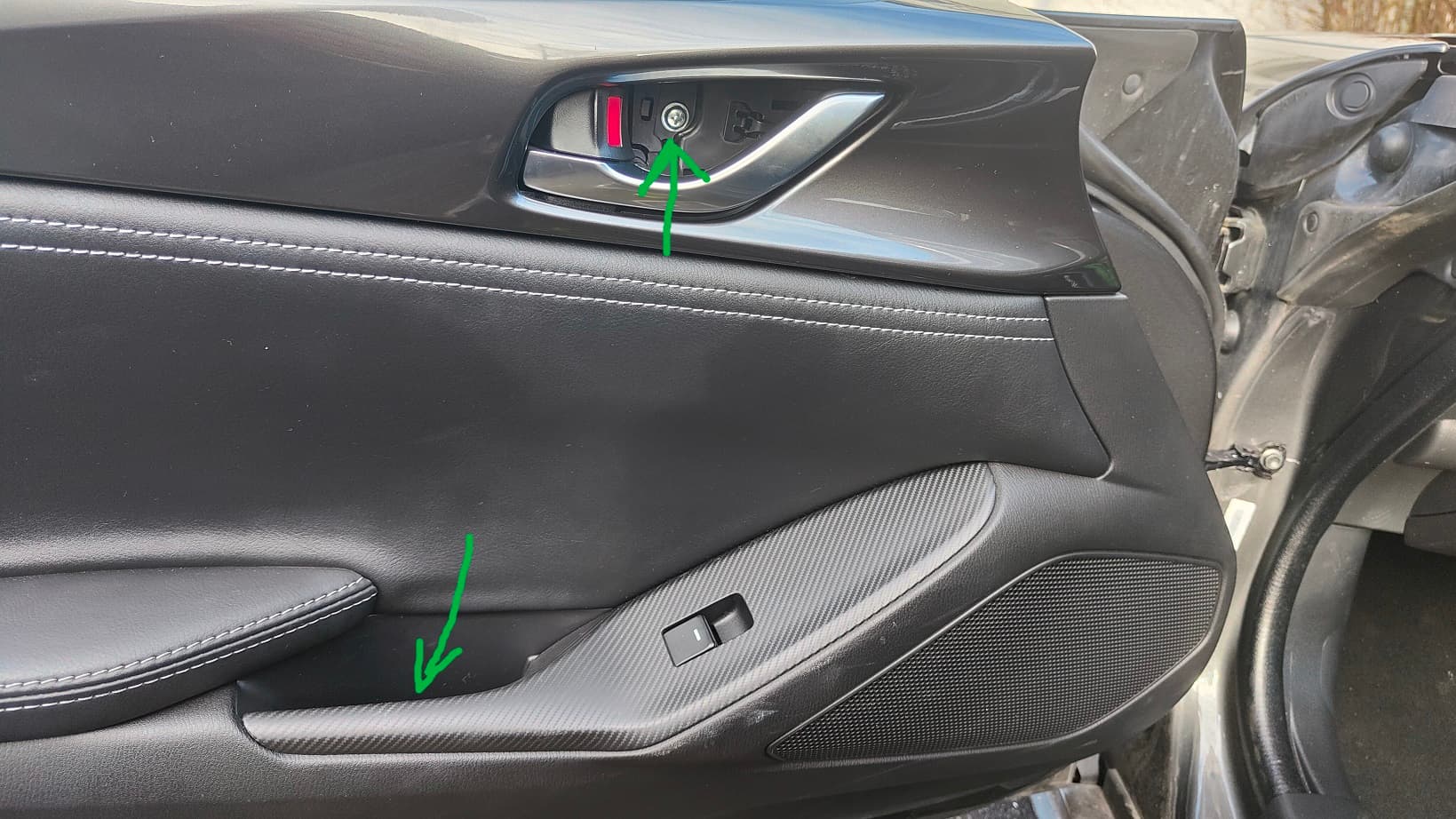

A Philips screwdriver is required for the 2 screws on the door panel. Hold the door pull handle open and from the left just pull the cover off. There is a rubber insert in the the lower section which just “peels” out. There are poppers around the door so I started from the bottom left and pulled out, none broke.
You will need a 10mm (blue) and 14mm (green) socket for the nuts. The plastic cover uses 10mm nuts to secure it, remove these and fold the panel down out the way (I didn’t remove all the cable retaining fixings). Circled in yellow are 3 connectors that need unplugged. To release the glass from the regulator, first undo 1,2 and 3 and then to remove it you will need to undo 4 and 5. These 2 hold prevent the glass from being removed once you’ve undone it from the regulator. Lifting the glass up and out required a shimmy left and right as I went but it came out easily enough.
The motor is secured by 3 x 10mm nuts on the right side. The regulator arm is secured by 2 x 14mm nuts at the top and 1 x 14mm nut at the bottom. The 14mm nuts were surprisingly quite tight. Undo these and the regulator and motor can be removed through the gap.

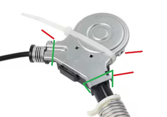

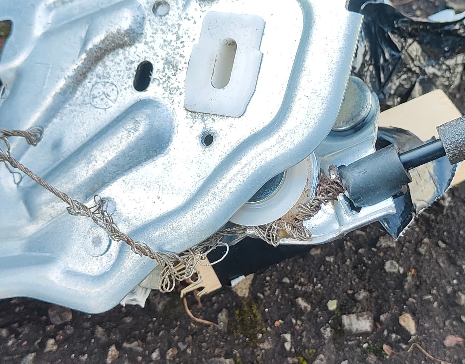

Removing the motor involves bending (flat head screwdriver helped here) 3 tabs (marked red in the pic below)and prying the old regulator out. I found it quite tricky bending the new regulator tabs fully back on to the motor so used strong cable ties (marked green) as added protection against it “exploding”. With only one pair of hands it was easy to match up the new regulator with the motor using one hand to hold them together before using snips to clip the white cable tie off. This stops the cable from spinning out - you don’t want this to happen.

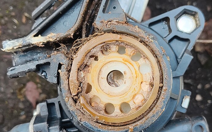

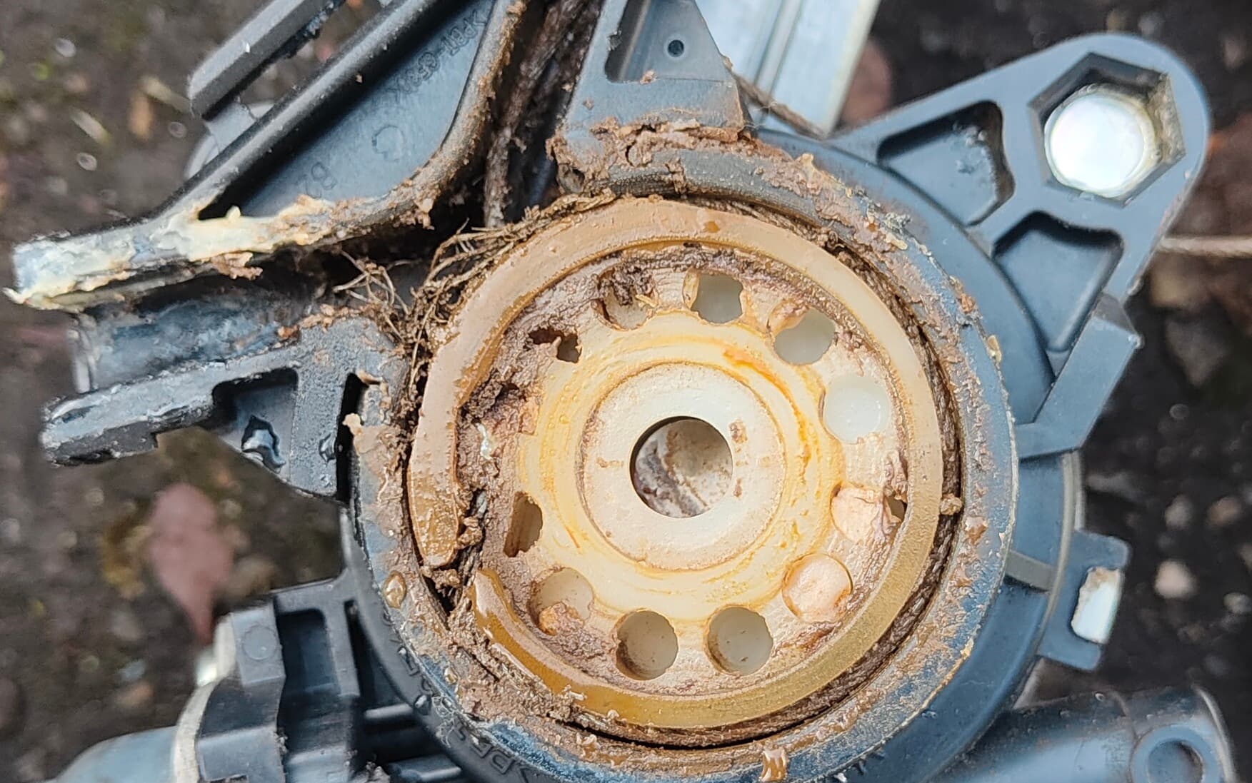

This is what happened to the old regulator…
Fitting the door panel back is, basically, reverse of removal. I’d say the job was 1/5 difficulty and is easily DIYable.
