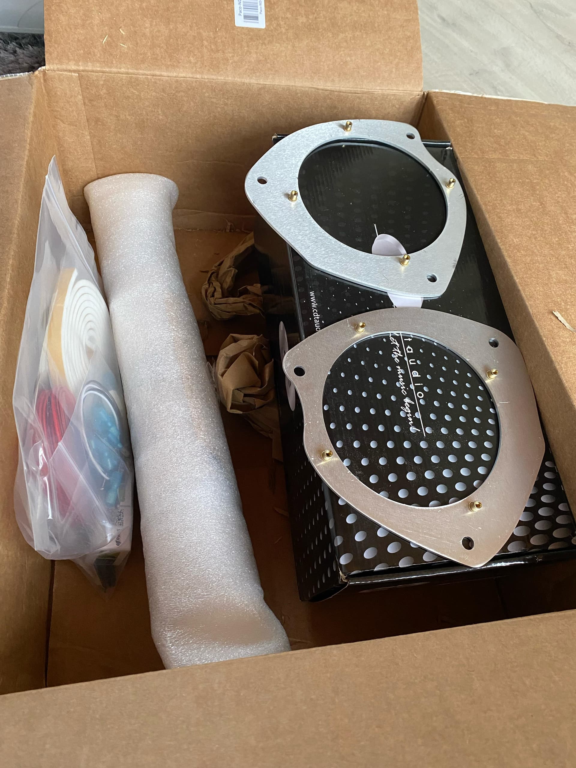

the paco full audio upgrade (for the bose system).
new front speakers, mounting plates, sound deadening, crossovers, tweaters.
bit of a DIY jobby. might get the doors done this week before tackling the soldering and splicing of the new crossovers + tweeters.

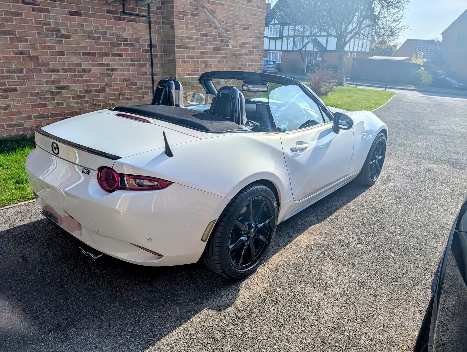

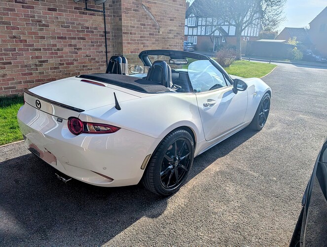

The other one was great, just that I was never going to get round to doing everything I wanted to do to it. So i thought, ‘get yourself a new Homura and have all the work done beforehand’. Lowered, skirted, smoked reflectors, smoked side indicators, full alcantara interior, sports exhaust and a few other ‘nice to haves’.
White is the new blue.

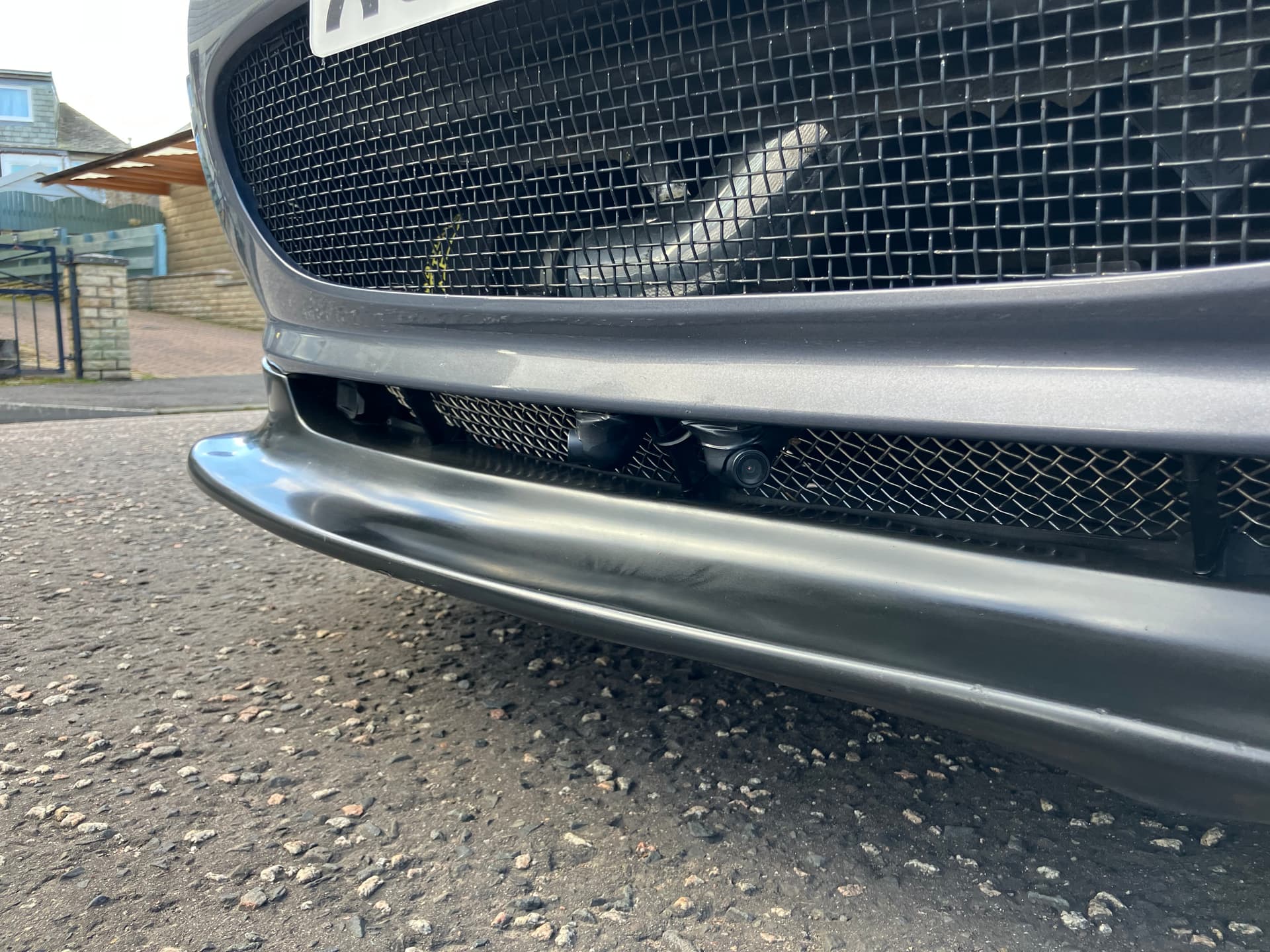

Fitted front cameras to help me see around corners :stuck_out_tongue:. The driveway where I stay has awful visibility and a lot of pedestrian traffic, and my whole bonnet would be across the footway before I could see anyone. These cameras now give me a 180 degree view before my nose even sticks out. The view is displayed on an LED mirror which you can either strap to your existing one or, as I did, replace it completely. The mirror works fine as a mirror, and is able to display the view from one, two or four connected cameras at the same time.

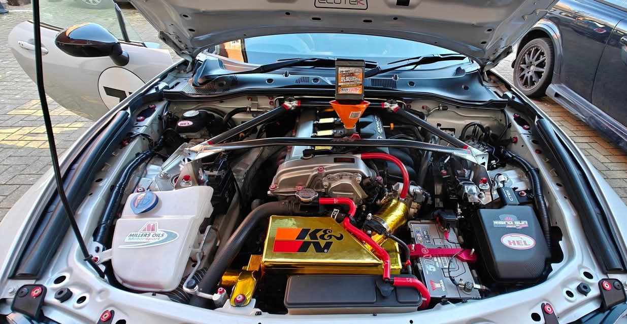

Changed engine, gearbox and differential oils this last weekend. While changing the engine oil I found that when removing the oil filter using a cut down water bottle around it stopped oil going everywhere. Also good practice to fill up the oil filter before fitting it ( it will require several top-ups ) and only hand tightened it.
To fill the gearbox and differential I use an inexpensive pump which works really well.
