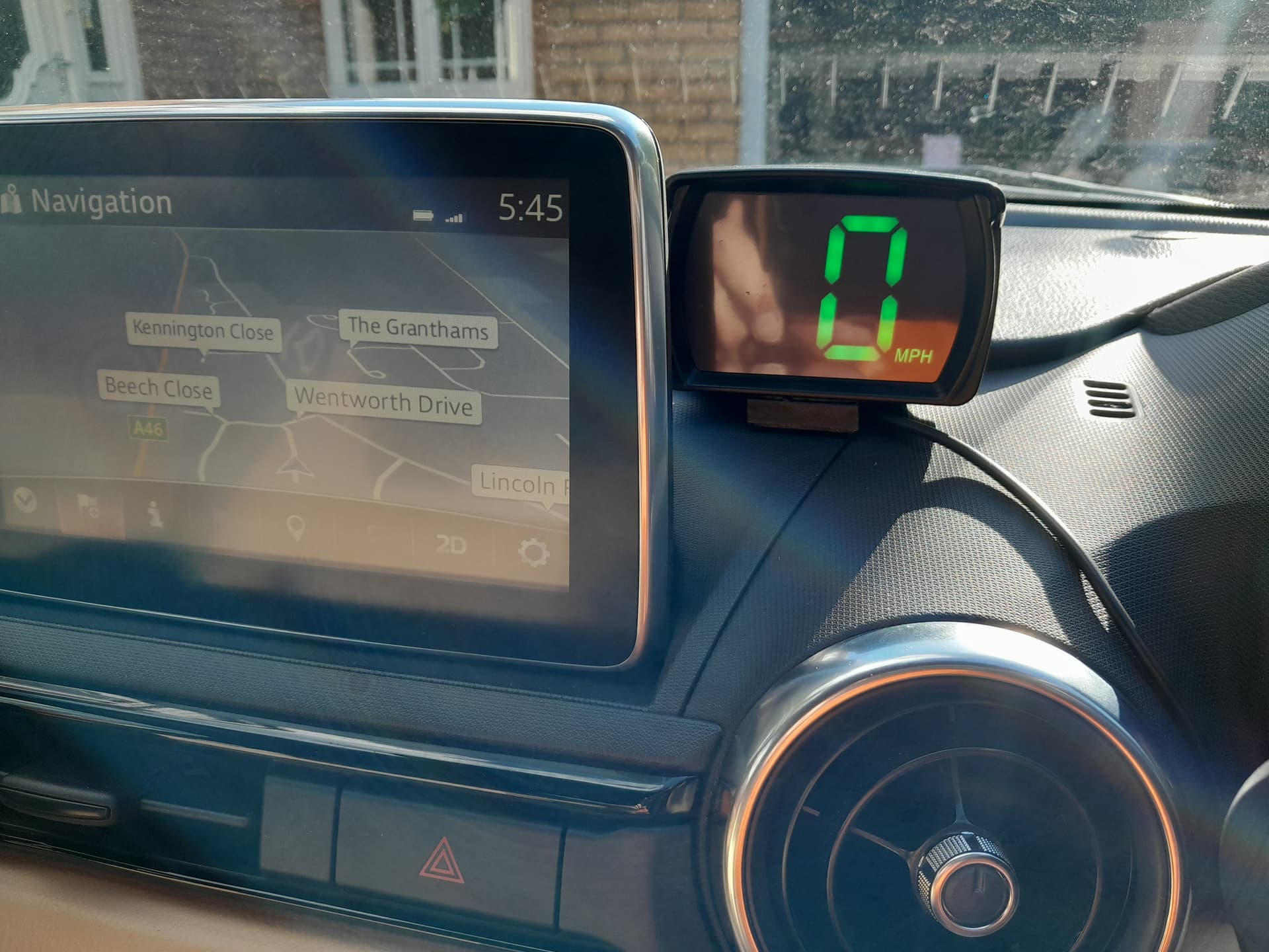

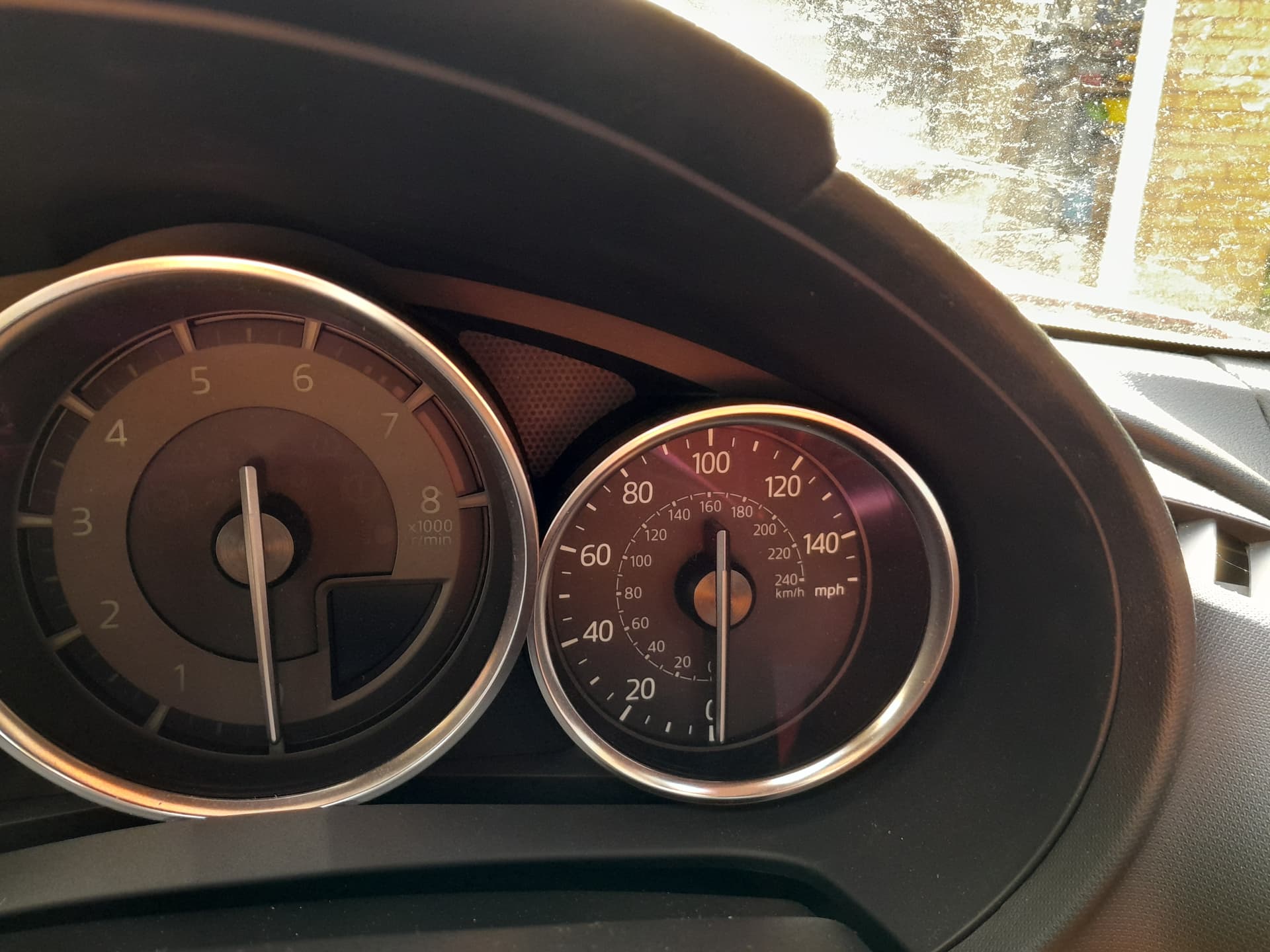

Our other car is a Qashqai which has the option of having a digital speedo showing in the centre of the dash. Really useful having it in easy view with all the speed cameras and such. Of course it over-reads like all cars but still handy.
I find the speedo on the ND difficult to read as it’s small, hidden away on the right of the dash and only has the even tens marked with numerals. Not very useful when you are trying to stick to a 30 or 50 limit.
Solution is a digital GPS speedo on top of the dash. Easy to see without looking away from the road and as it’s GPS it’s accurate.
eBay special from here -
Happy with that at £7.54. Lots of them about but be careful as they are available in km/h and MPH and sometimes not clear in the listings. They are not switchable. I got it wrong first time. :grin:
You’re starting to make me buy car things again, MX-5 car things.:open_mouth::+1:
That power cable would bug me but it looks like a good unit.
I use Waze for double checking speed as it is always displayed unlike Google which is only visible whilst navigating - unless I’m doing something wrong.
If I really need to stick to the speed, I use the speed limiter. In fact I don’t think I’ve ever used cruise control apart from trying it out when I first bought the car.
That’s the only bit of cable that’s visible. Would have taken quite a bit of stripping trim to hide it away behind the trim. Might re-do it next time I have to take things apart for anything.
It’s powered from a two output USB adaptor in the footwell socket that also powers the dashcam.
I’m a fan of the speed limiter mode of the cruise control of my ND. Keeps me alert to speed limits too as I look for when to set in to next :wink:

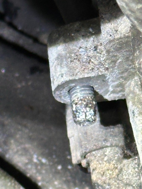

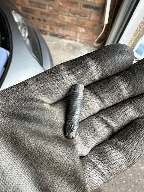

So on the way back from two track days, and about 40 miles from home, my NC decided that it didn’t like its belt tensioner any more and just let go entirely on the A1. Thankfully car was still running and I was able to pull to a controlled stop in a layby where the car was abandoned overnight while I considered my options.
I thought i’d maybe just do the fix at the side of the road, but no one local could get me the parts, not a single belt and tensioner in the scotland area. So decision was made to get the car recovered… and I’m glad I did.
Because on removal of the old tensioner, the bolts snapped off in the engine block and I’d have been absolutely scuppered at the side of a road. Thankfully, there was just enough sticking out to get a set of molegrips on them, and over the course of about 2 hours, only able to turn a few degrees at a time, i finaly got the bolts out of the block.
new vs old:
Bloody bolts:
I will not be defeated:
So new bolts are on the way, and while i was at it, i thought the idler pulley felt a bit crap, so i’ve ordered one of those as well.
I think the bearings on the tensioner have got too hot on track and melted the inner part of the roller, which has just let go on the motorway. It’s my own fault, i maintain the car myself and I didn’t remember to keep an eye on the belts.
Thankfully no harm done.
If you’ve not got AC there’s a third pulley that can be renewed, bottom right. I did all 3 on mine for around £100 including a belt. That’s probably all increased in price now but worth it.
