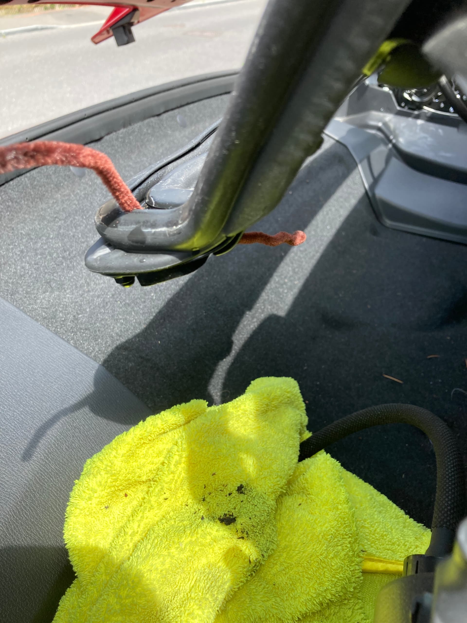

Noticed water wasn’t draining away during a quick wash so cleaned out the two drains with a pipe cleaner.
One was completely clogged with decaying leaves and the other wasn’t far behind.

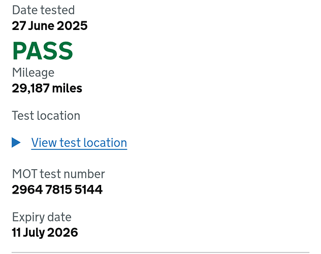

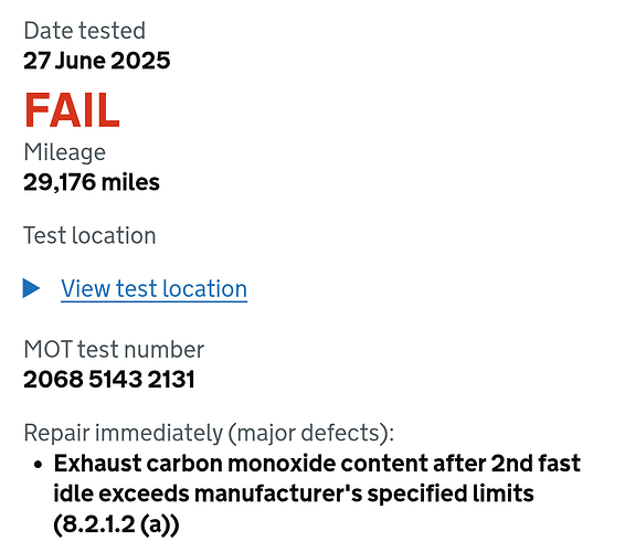

Handed the keys over for its MOT:
Sad times :pensive_face:
One Italian tune-up later…
Good times :grinning_face:

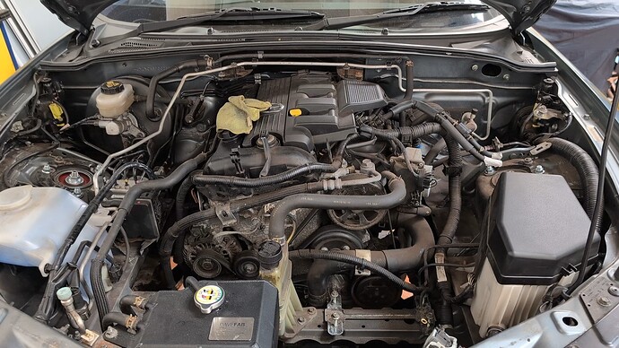

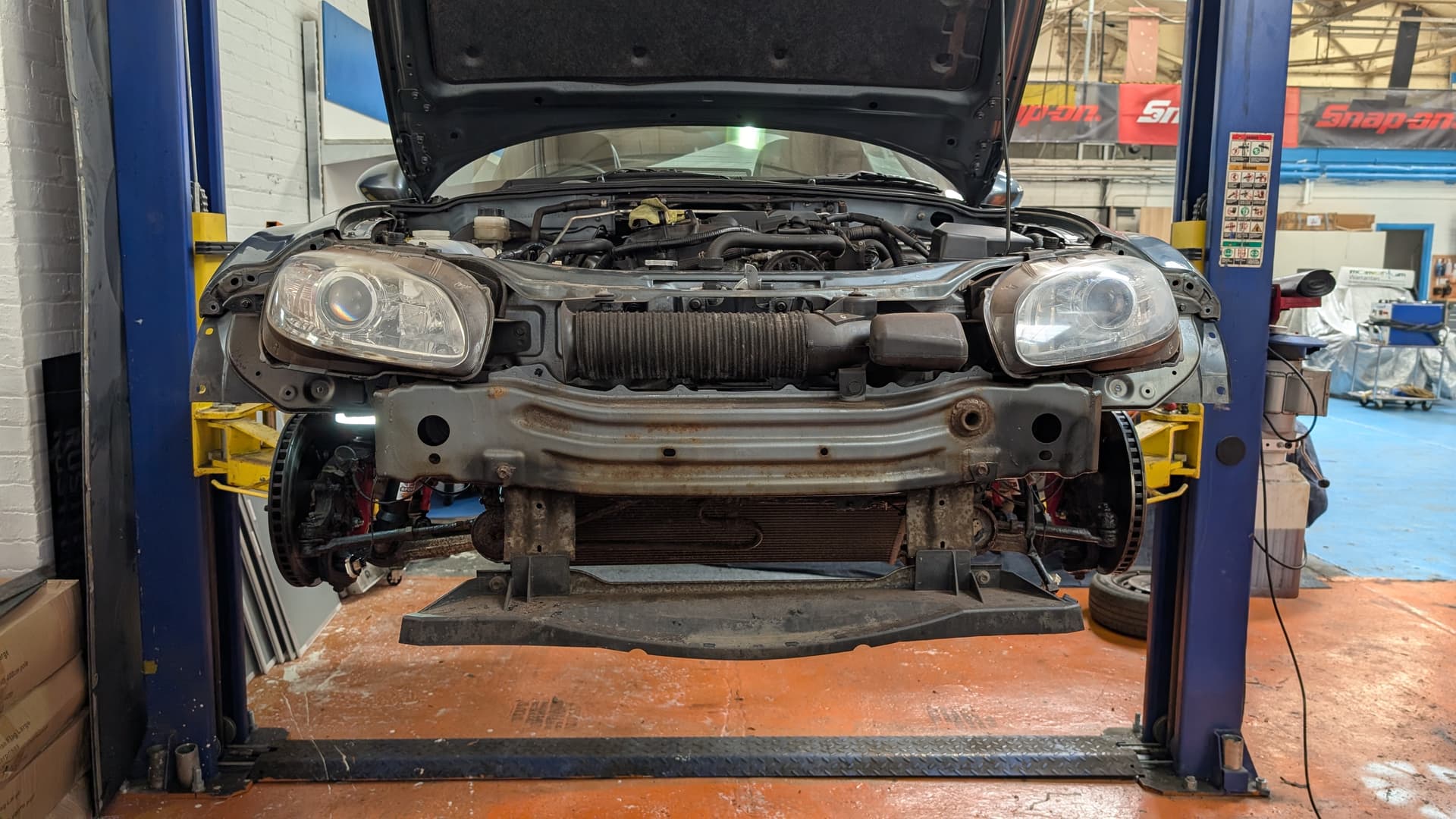

Started and completed the mechanical uninstall steps of DIY BBR Supercharger Stage 1 kit.

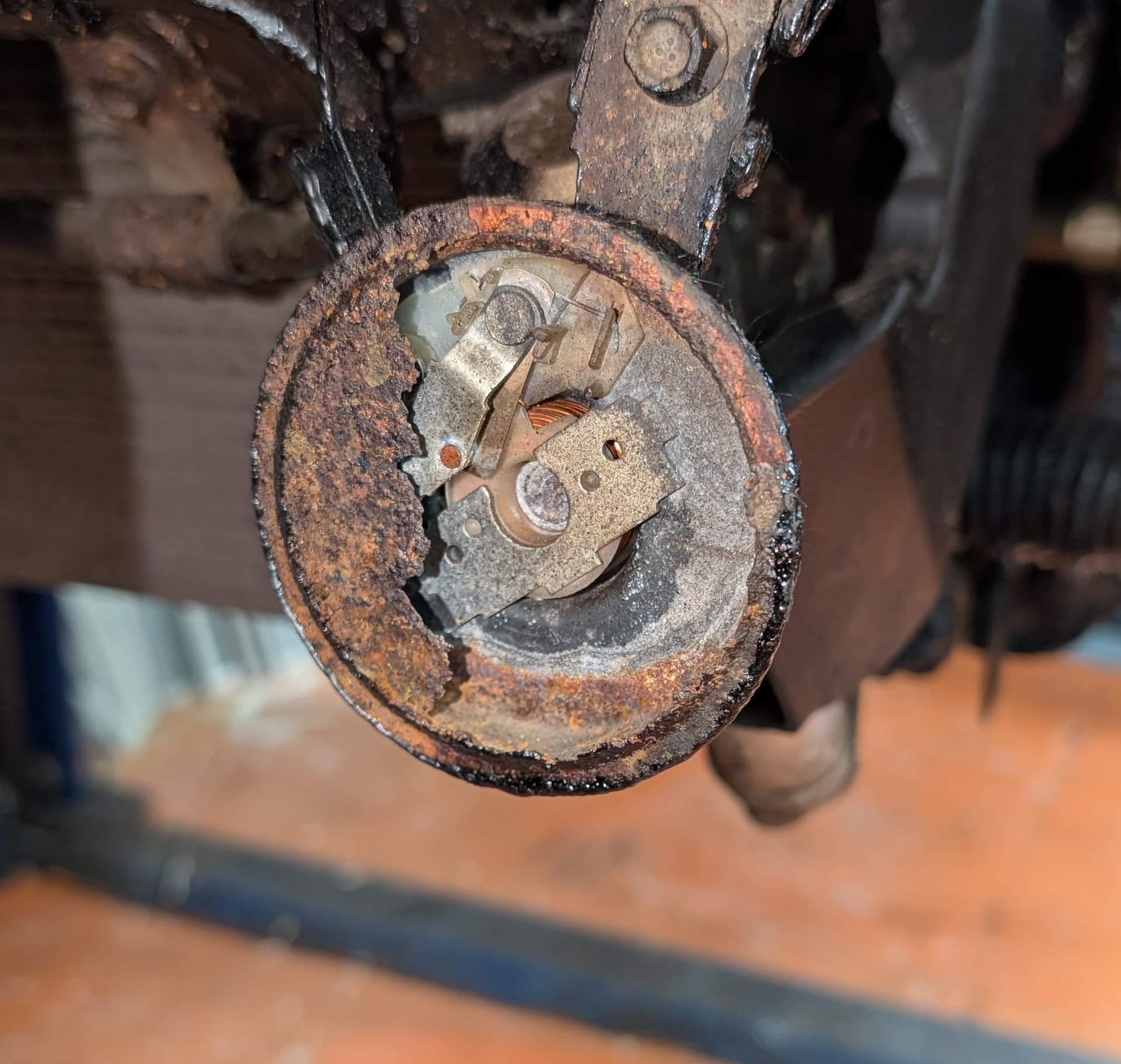

Found out why my horn sounds so puny!
Glad I bought this as a toy to abuse and track, as everything we touch has corrosion.

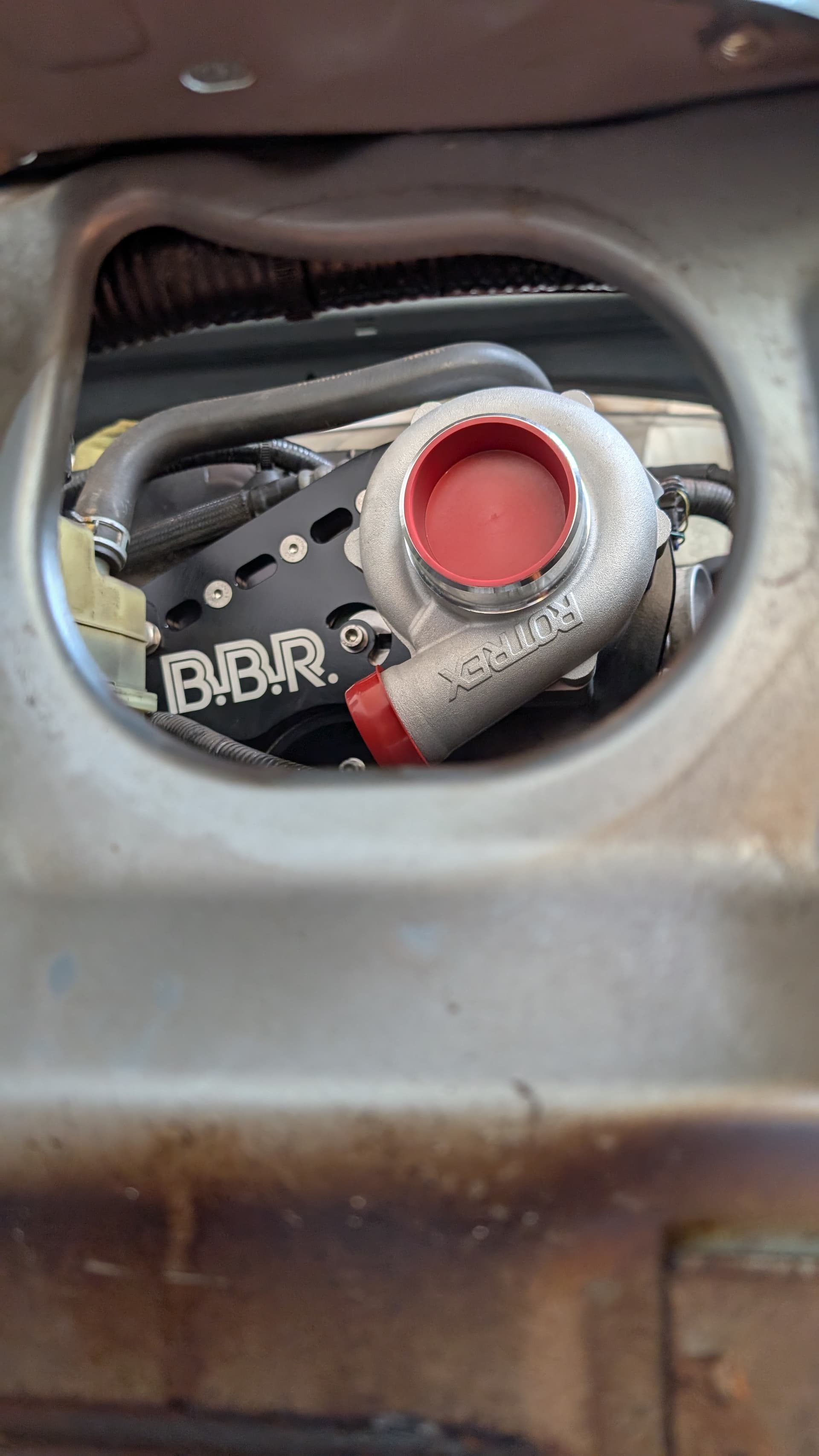

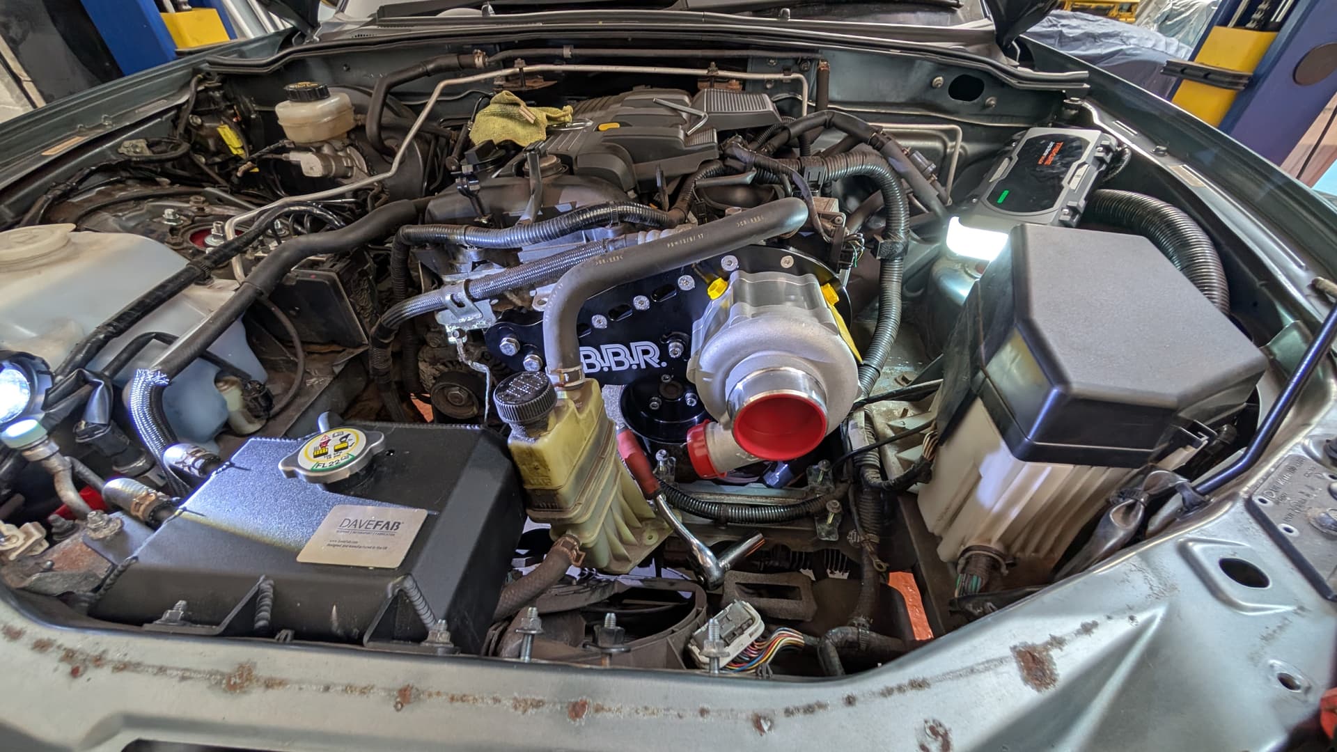

Also started the Installation phase of the BBR Stage 1 Supercharger kit…
Hopefully get back to it tomorrow…

New horns ordered from mx5 parts. Fitted the supercharger…

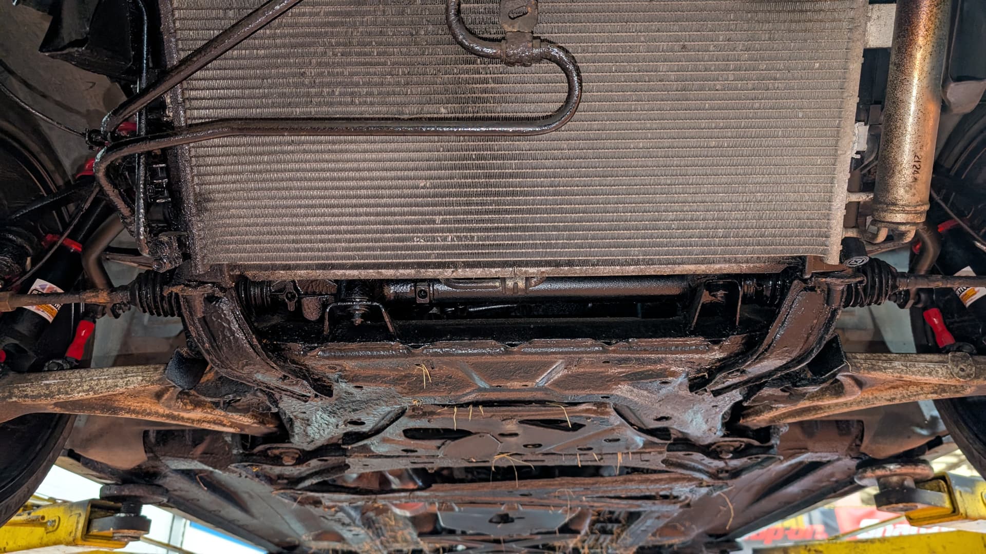

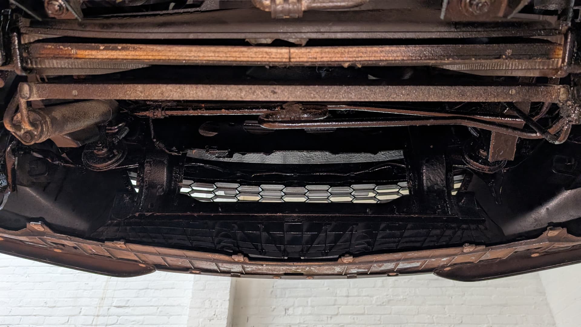

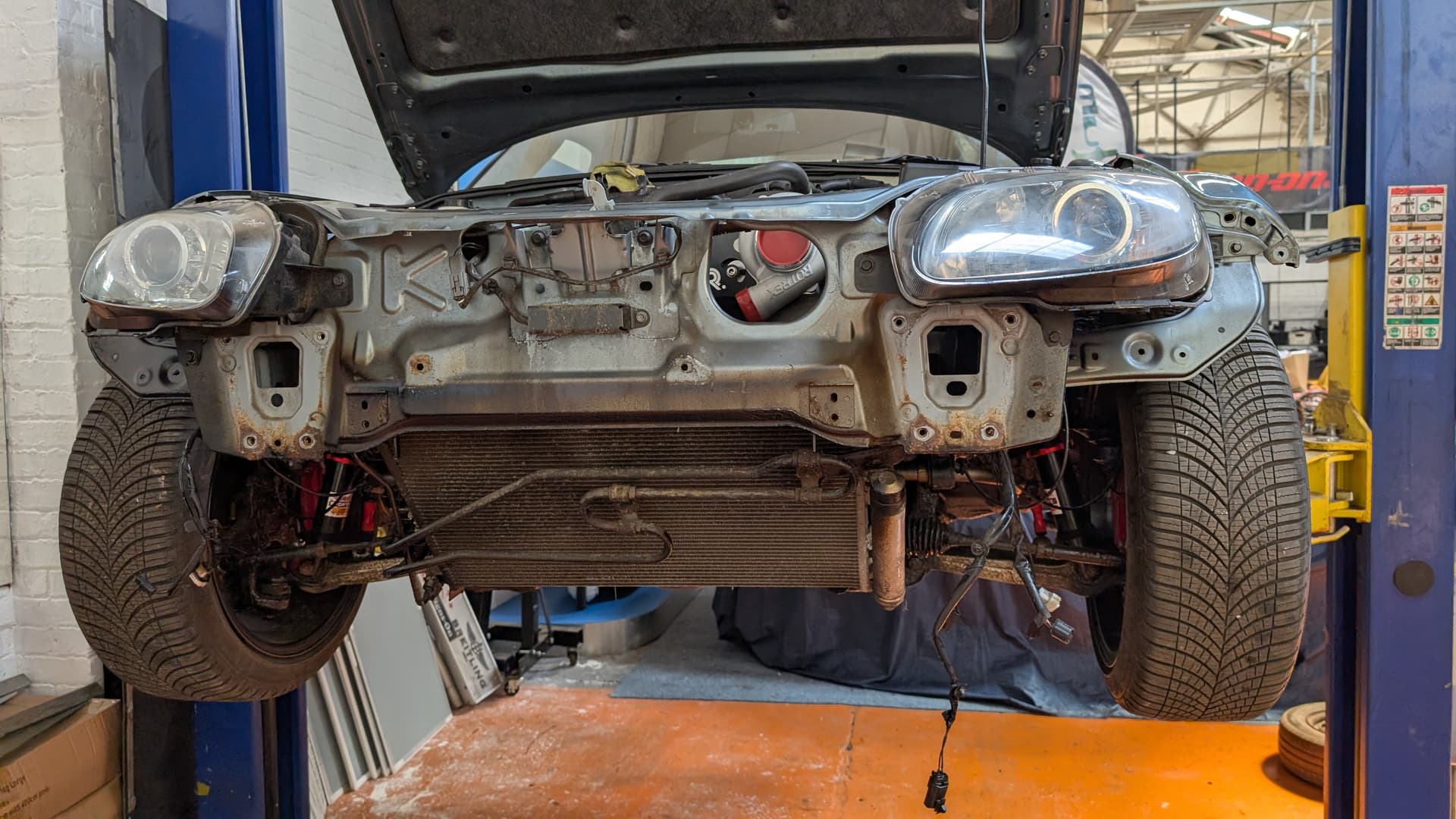

Took the crash bar off, shook my head a lot at the state of the car…
Ended up in a conversation with my neighbour (guy that’s been letting me use his workshop) about how useful a dry ice blaster would be, he ordered a blaster as he has compressors and a sand blasting oven, I’ve ordered dry ice…
Progress update next weekend…
If you haven’t already, I’d look at the rear crash bar, as they are usually a lot worse than that…

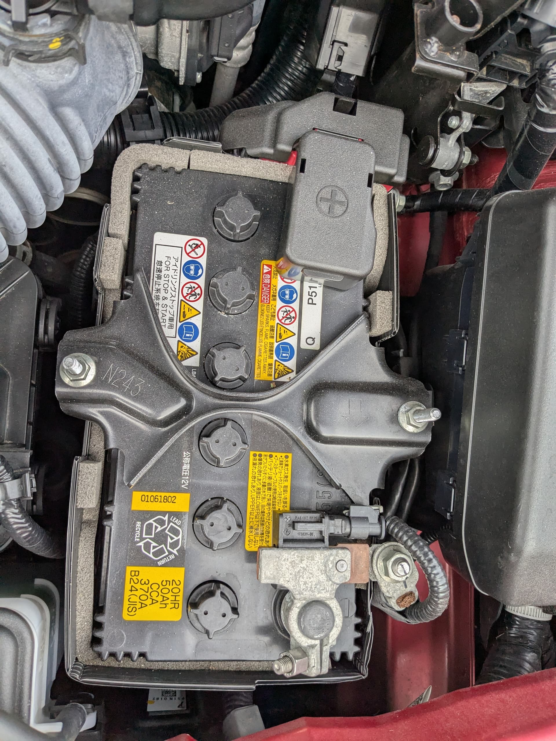

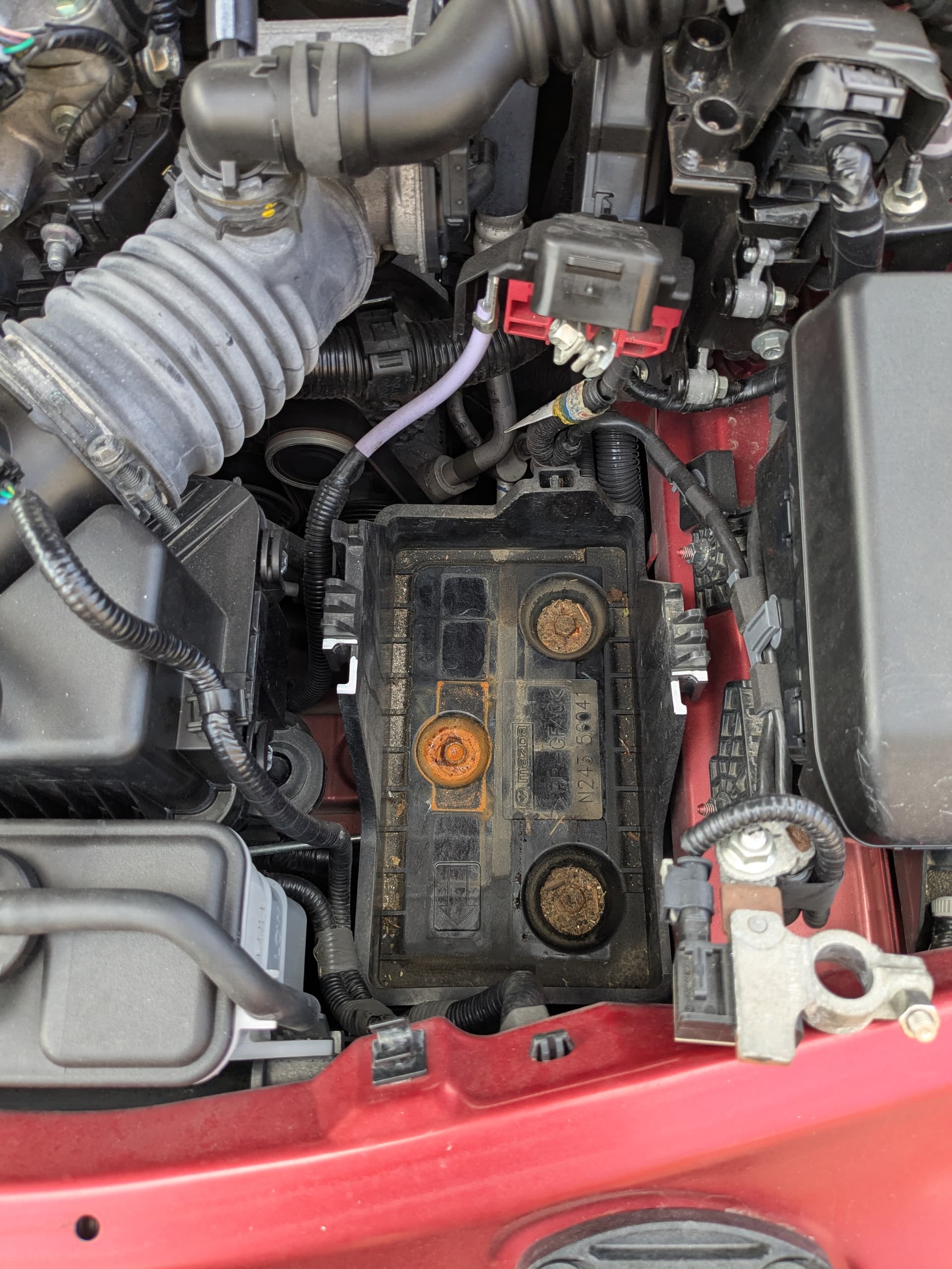

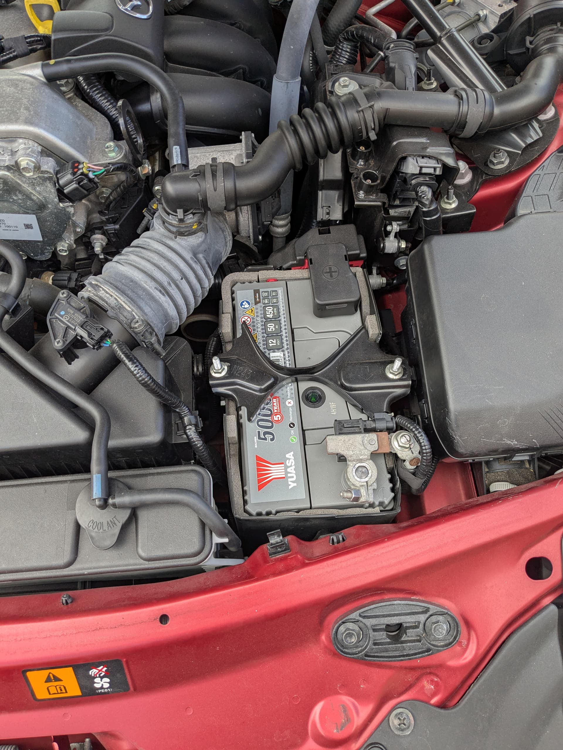

Nothing interesting I’m afraid, but today I replaced the original factory battery in my 2018 ND for a new one.
The original was still OK-ish but I’ve been worried since run the parking mode on the dash cam quite often and currently it is reaching it’s auto cut-off time very soon so figured a fresh battery would help.
Straight forward, just followed the destructions here, including the notes to open both doors before disconnecting the battery to avoid the auto-window down function getting messed up.
