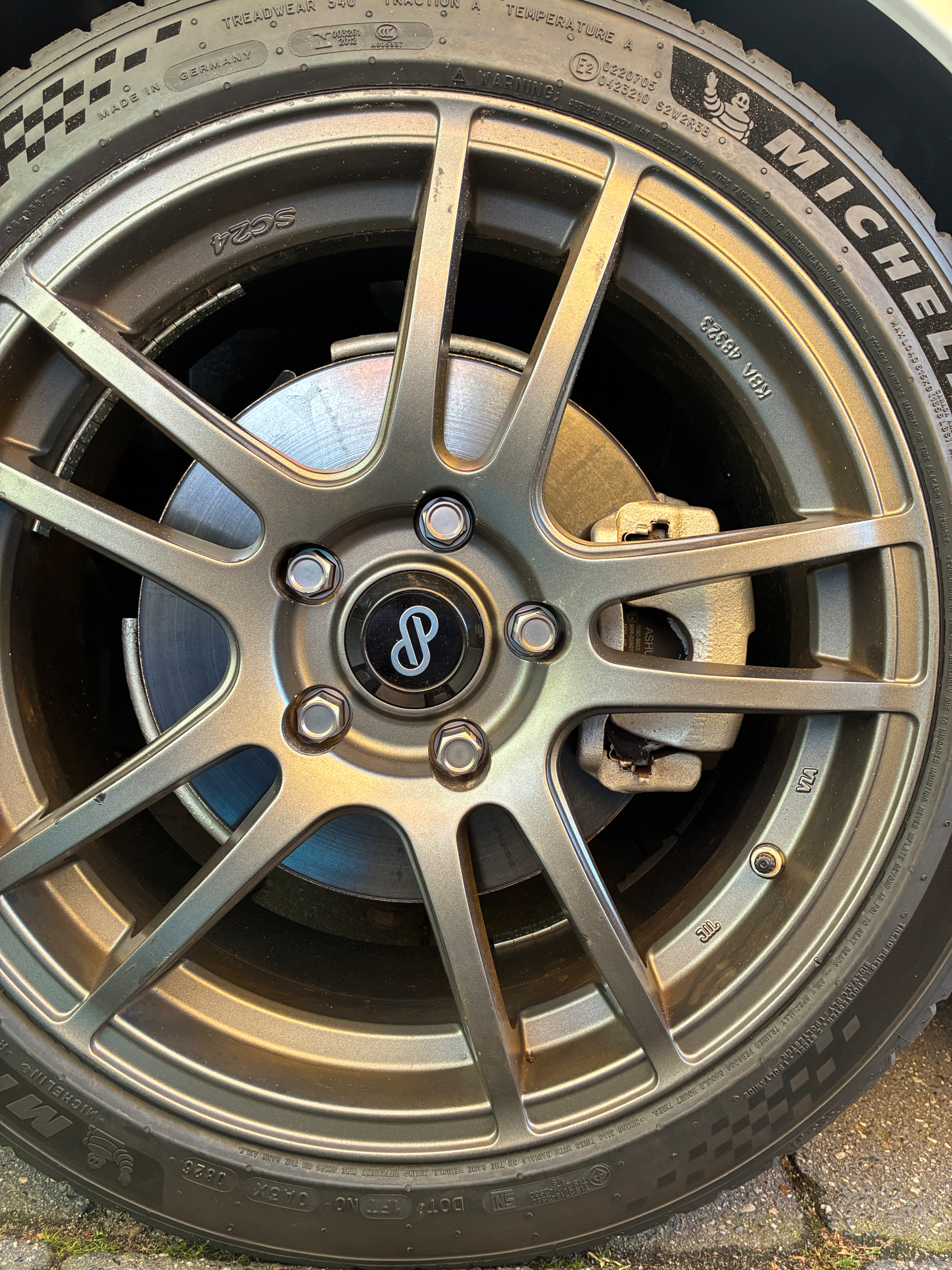

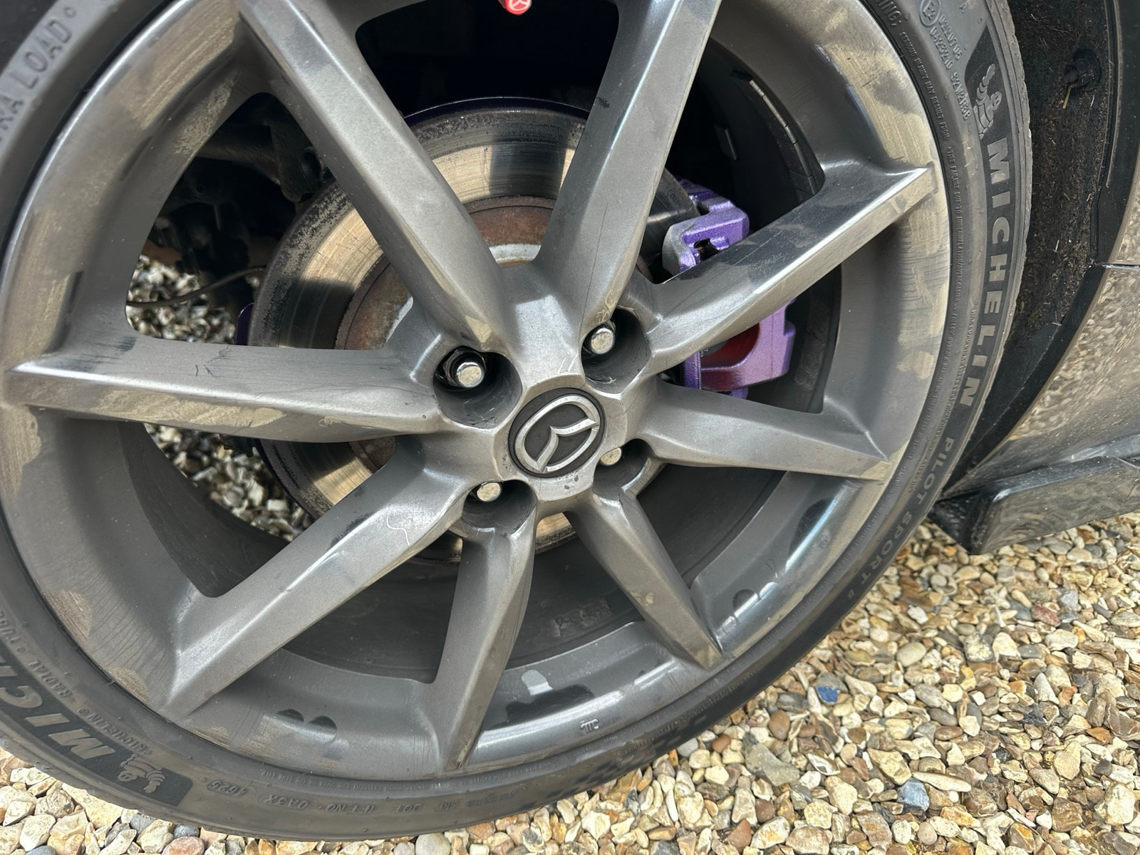

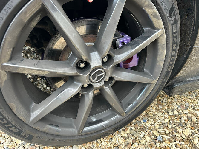

Changed the rusty lugnuts by some Enkei duralumin nuts.

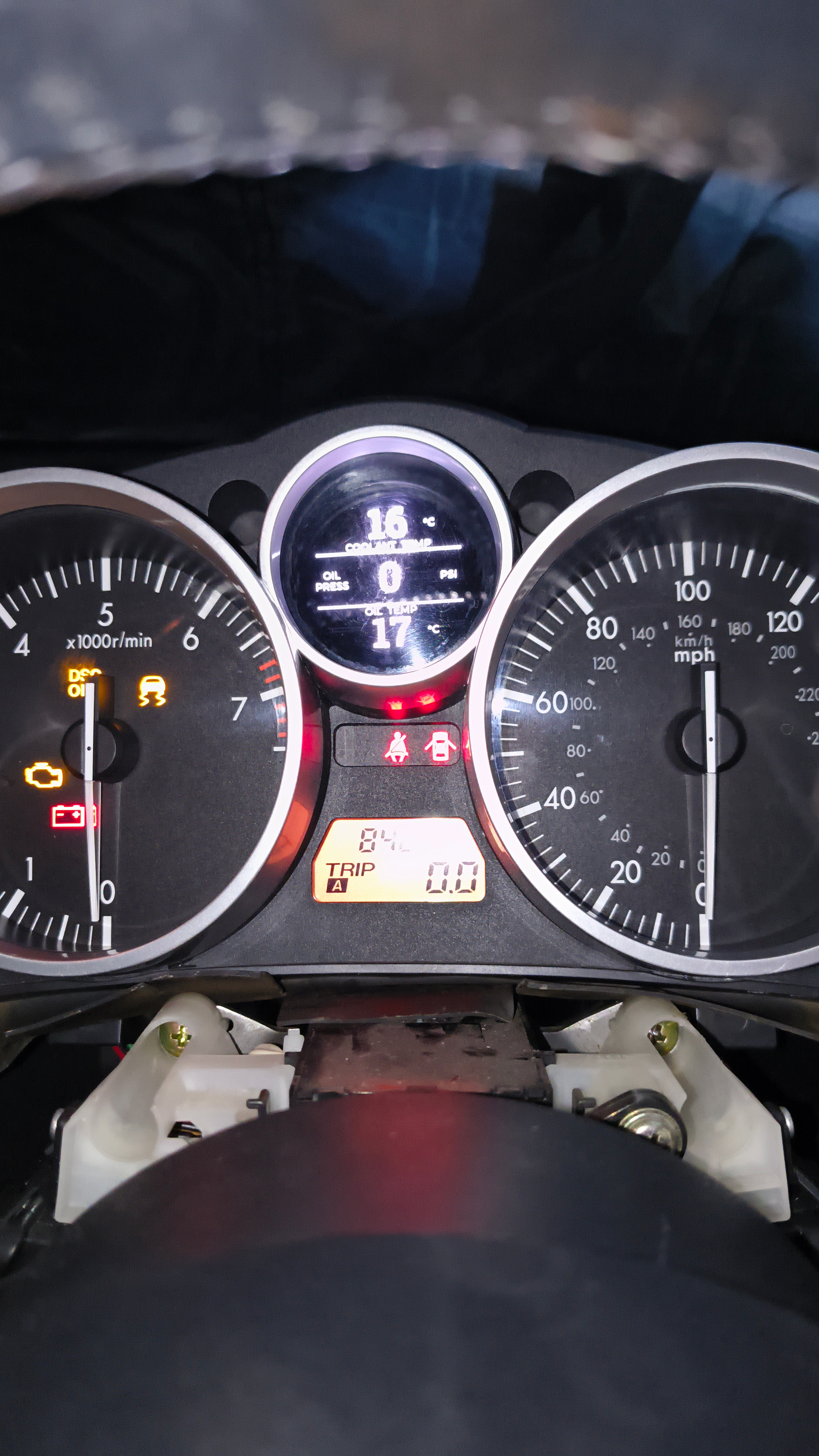

Installed a wonky gauge :sweat_smile:

It will read and look perfectly fine when your pinned against your window power sliding :grin:
Handy for measuring the OCD pressure of the driver.

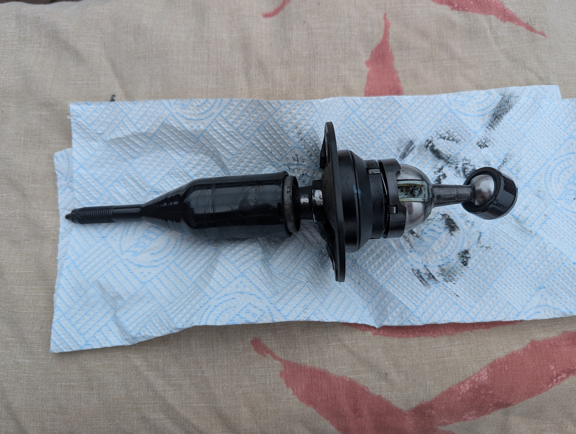

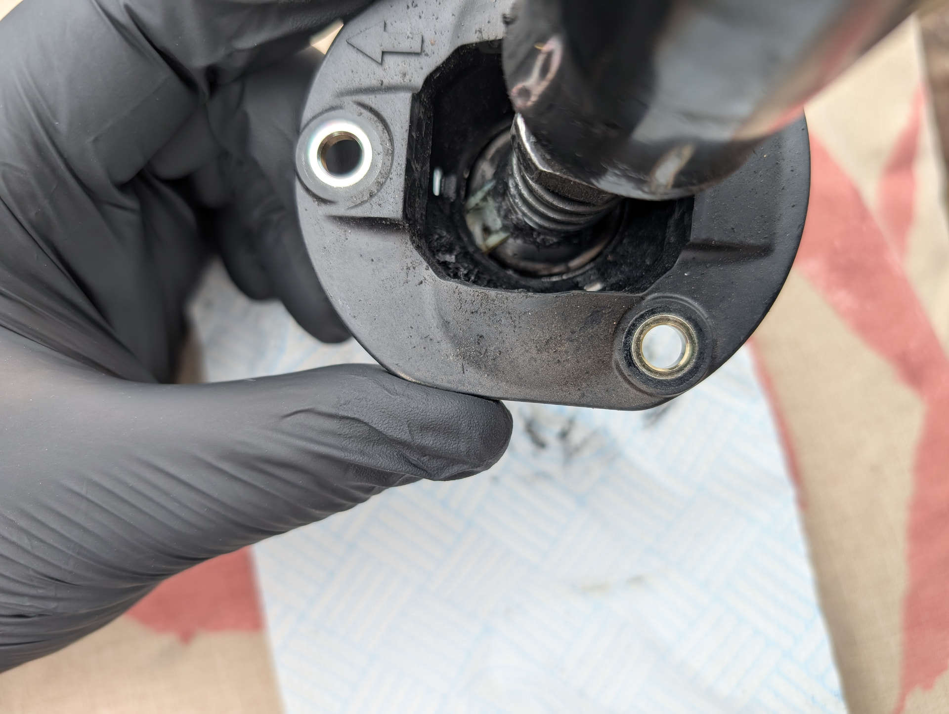

Replaced the lockout plate, the lower ball cup and the two white plastic locating parts on my NC2 6 speed shifter (and sucked out the old oil and replaced with fresh) and I’ll be honest, it doesn’t feel all that much better? When cold 1st to 2nd still seems quite difficult and even when it all warms up, it doesn’t seem the smoothest of changes, a bit clunky.
Don’t remember my 5 speed NC1 (with more miles) feeling like this. Anyone got any experience? Is this just what the 6 speed is like?
As you can see, the plat did need replacing!
(Pictures are pre me replacing the parts)
