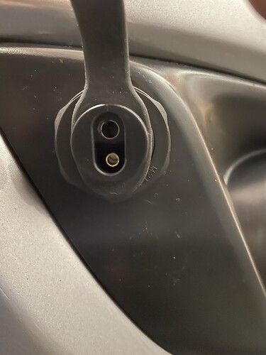

I wanted a convenient external connection for the maintenance charger. Wasn’t too bothered about a stealth connection socket as such , so bought this
OptiMate Cable O-20, Weatherproof SAE Socket, Front Panel Mount OptiMate Cable O-20, Weatherproof SAE Socket, Front Panel Mount : Amazon.co.uk
I installed it here,
Requires a 25mm hole to mount it so wheel off, front lower arch liner pushed to one side for access and popped out the fog light trim after disconnecting both fog and DRL wires.
Drilled the hole, fitted and connected the panel socket and put it all back together again! :+1:
Now, all I need do is lift the front corner of the cover to get to the socket, plug in and switch on the charger and job done!

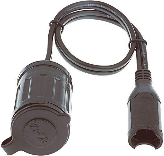

Following on from the installation of the Optimate socket into the fog light surround, I ordered this too from Optimate,

Point is, open my car, switch to accessories position on ignition, take out mini USB socket from 12v socket, insert plug from compressor etc. With this adapter plugged into the external SAE socket I fitted, no need to enter car or switch ignition on or remove/replace anything as the installed socket is directly connected to the battery? Well, I think it’s a good idea anyway! :nerd_face:
Various configurations of leads available, could even jump start a car from this external socket ‘maybe’? :thinking:

I would assume there is a fuse in the lead from the socket to the battery. If there is then trying to jump start that way would blow the fuse immediately.

Hi Paul, yes, in line fuse. I did say ‘maybe’ :nerd_face: electrics are a bit of a dark art for me. Oh well, I’ll stick with the Mazda IMS kit or maybe a USB charger or similar :+1:
