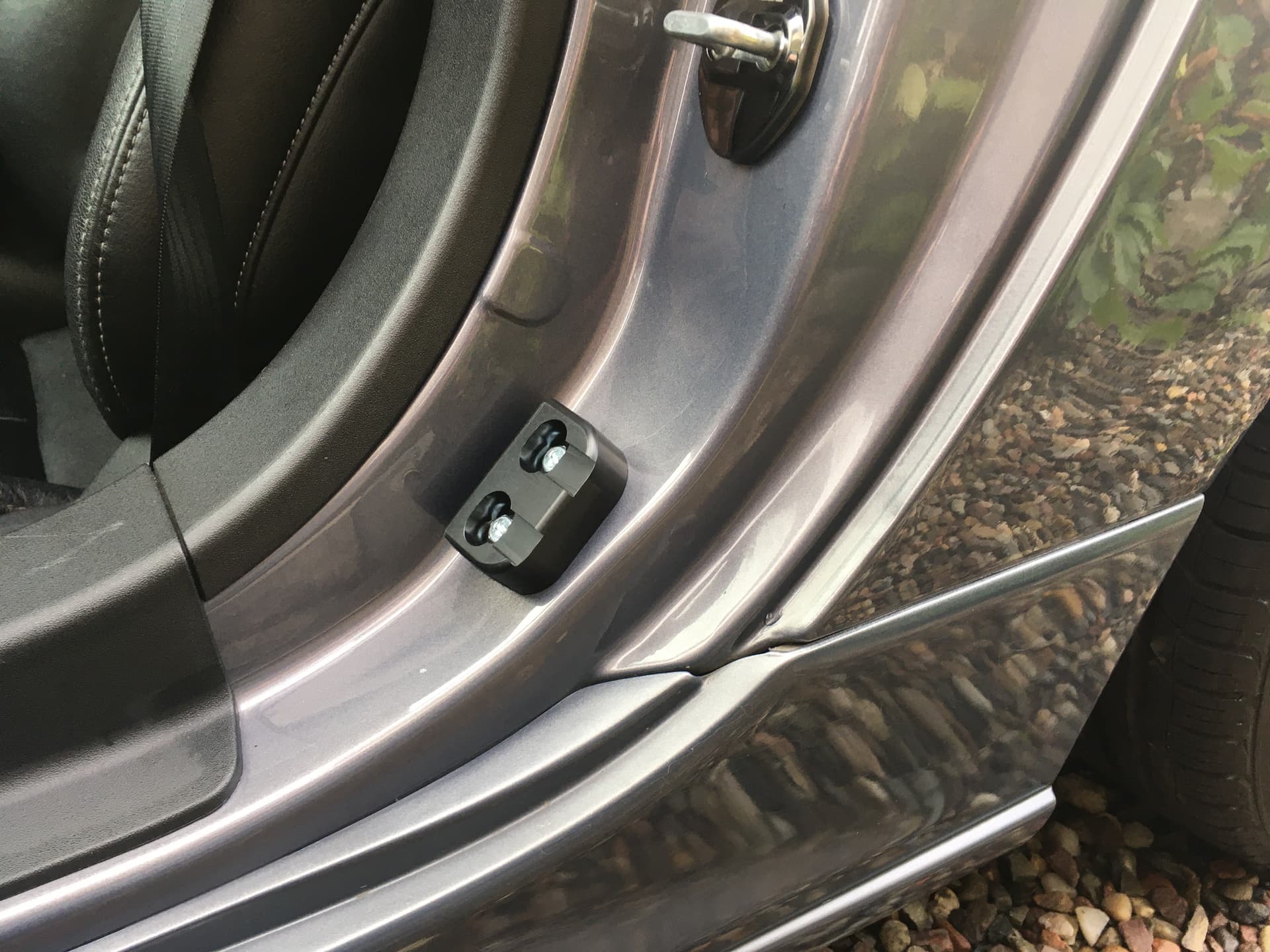

I want to buy two of these badges Where ?
If you zoom in, you will see they were produced by racing decals
I ordered a pair from Rob Bate. Painless transaction, swift despatch and both sides fitted in 10 minutes using instructions provided. Quality items at reasonable price,

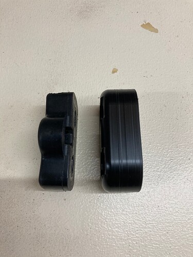

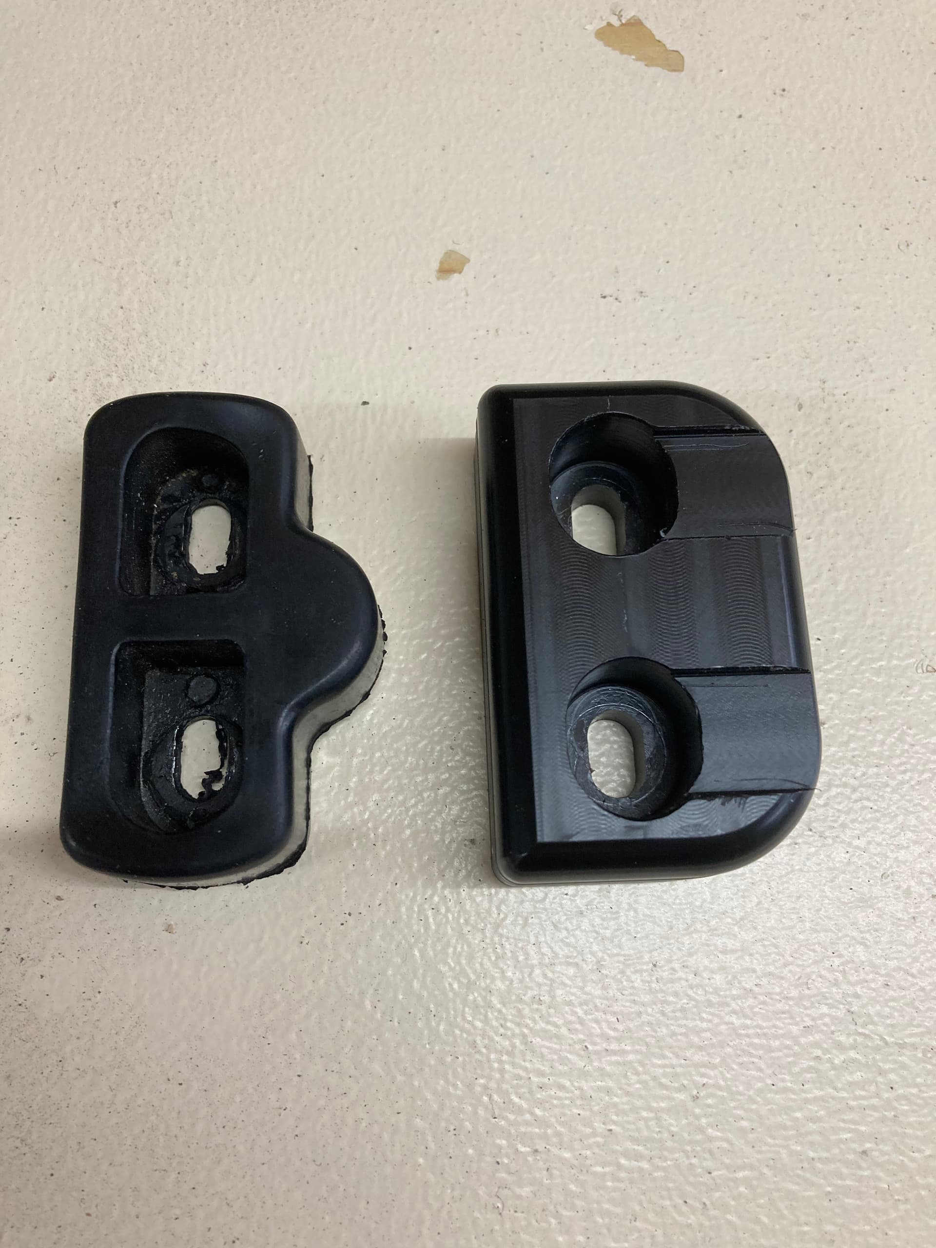

I also fitted new door bushes, but mine were from Moss Europe. Easy to install but I need to trim them slightly as I now have to slam the doors to close them properly. Can’t say I’ve noticed any improvement in body stiffness or handling, but they sure look better than the originals.
Ray,
I was referring to the door bushes.
8f you have to slam the doors now, something is wrong.
Try taking the bushes out and sliding them into the door cups.
They should slide in nicely. If not then sand them down to fit.
When adjusting the bushes to fit, leave the windows open, so the air pressure in the cabin doesn’t interfere with closing the doors.
Start with bolts loosish and gradually tighten in between opening and closing the doors several times

Agreed. When testing, they fitted snugly in the cups - tight enough so they didn’t fall out, but not too tight. I think the adjustment required is to the face of the bush, the side which makes contact with the back of the cup. The bush itself can’t go any further towards the interior of the car, so the advice is to paint the face with Tippex and operate the door several times. The Tippex should come off at any high points and you just sand those down. Now I just need to get some Tippex fluid, which we don’t stock at work as it’s all rollers now.

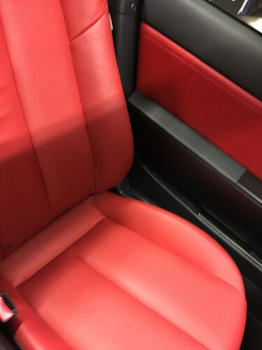

Had my guy back to bring the passenger seat quality up to match the recently refurbed drivers side.
£££ well spent.
