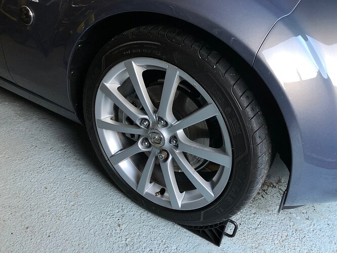

Been doing a fair bit of refurb to my NC1, including these same coilovers - fitted yesterday by AK Automotive near Newcastle-upon-Tyne, who were excellent and included a full wheel alignment (£250 in total). About 40mm lower than standard (now 34cm from wheel centre to wheel arch). Cleared a load of speed bumps near their workshop so no height problems. Early days yet so can’t say how good they are (50 mile run back up the A1 so not exactly taxing). Steering seems to feel a bit more planted and they are stiffer but pretty compliant at the same time.
