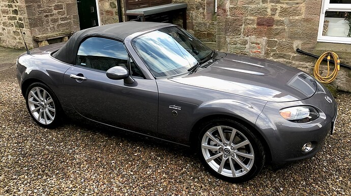

I’ve been posting some pics of work I’ve been doing over the past few months - finished for now and pretty happy with the results. Car has done 90k miles (56k of those by us since we got it just over 5 years ago). Work covered -
Clean, paint and coat as much of the undercarriage/wheel wells as possible (removing surface rust where necessary).
Replace front hub/bearings and clean up knuckles, clean and paint dust guards.
Clean and service brakes.
New Meisterr ZetaCRD suspension fitted (including full alignment).
Rear bumper off and clean up/repaint rear mounting panel.
Clean up, rub down, paint/laquer and ceramic coat wheels.
Re-proof the soft top.
I was pleasantly surprised how solid the car was underneath and how easily the hardware came apart so pretty good all round. Might look at getting new exhaust but the car is now ready for lots more action.
Excellent job👍
Looks great… love that colour…
Do love these wheels…car looks fantatic.
Cheers - Galaxy Grey - Looks its best in sunshine when it really shows the metallic flakes.
Wheels are standard 2.0L sport. Been meaning to tidy them up for ages but kept putting it off. Had a few bits of minor kerb damage (previous owner obviously!) but they came out no problem with a 240 grit sanding wheel. Really quite surprised how well they turned out - just hope the finish lasts, though it seems pretty tough - I’ve already used a machine polisher on the inside and on the spokes without issue. I have an ND 30ae as well but just can’t part with the NC. It’s been all over the place in the last 5 years and seems to be holding up pretty well, including being used as an every day driver through a couple of winters and being parked outside until we moved house at the end of 2020, so it now has garage space.
