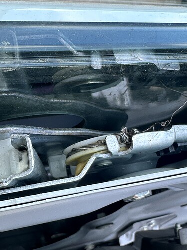

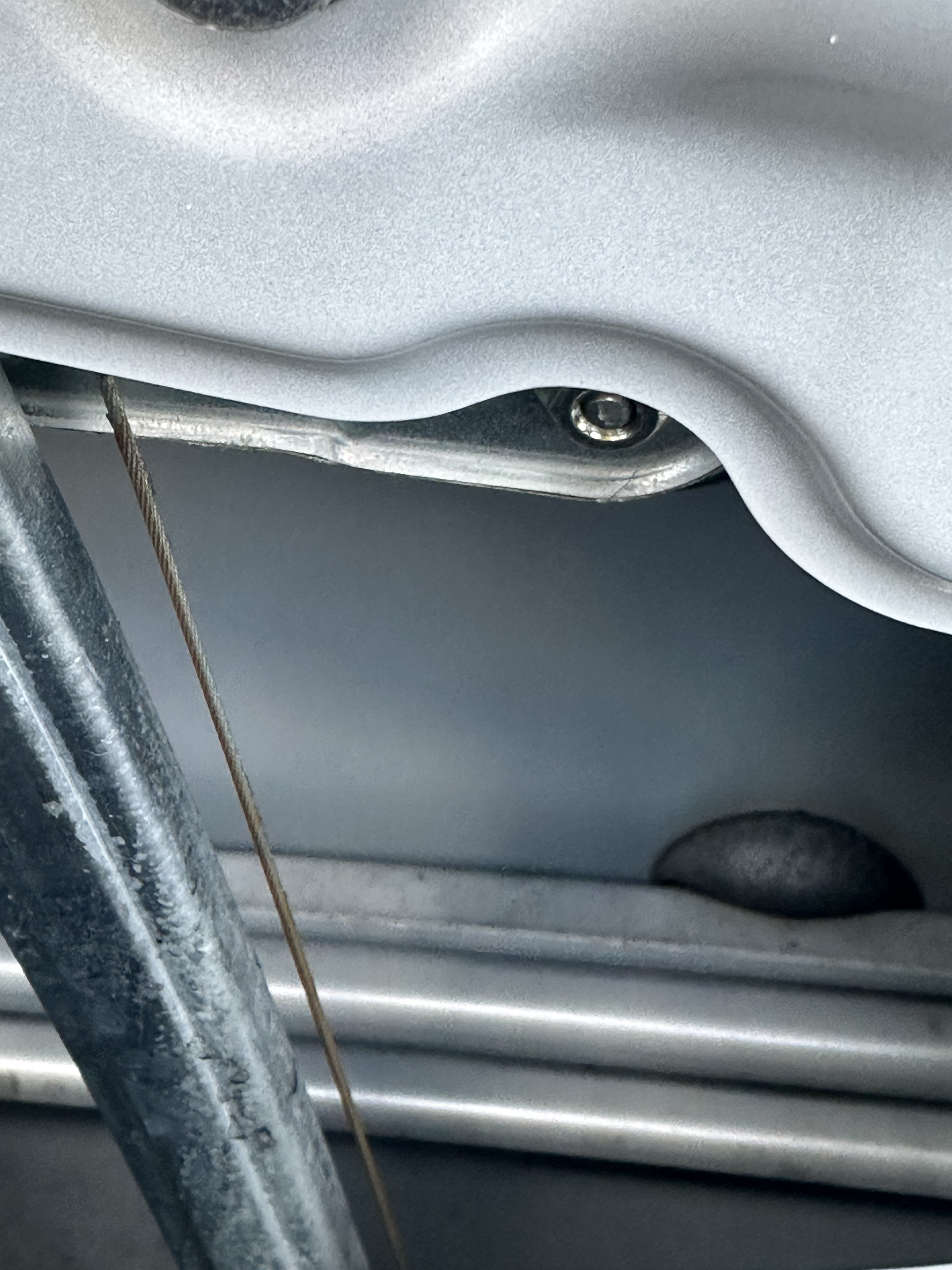

So. Disclaimer: I’m not very hands-on when it comes to cars, but have a (arguably somewhat dangerous) “give it a go” attitude. My passanger side window (ND) had been making a scratching/crunching sound, so I decided (with help from YouTube) to take the door panel off and look.
I know that the window regulator is a common failure point.
It looks like the wire is starting to fray (I could only really photo from the top)
Does anyone know if this is indeed “how it should not be” and if so, how close to failure point is this?
