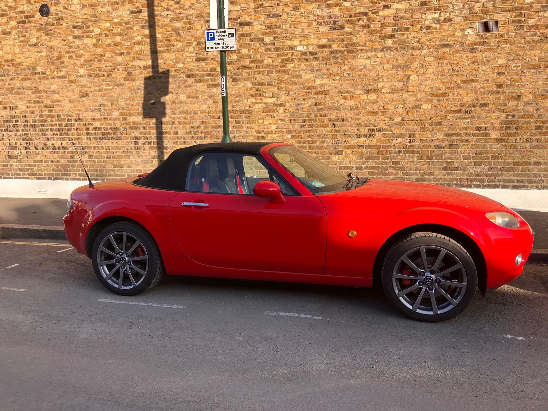

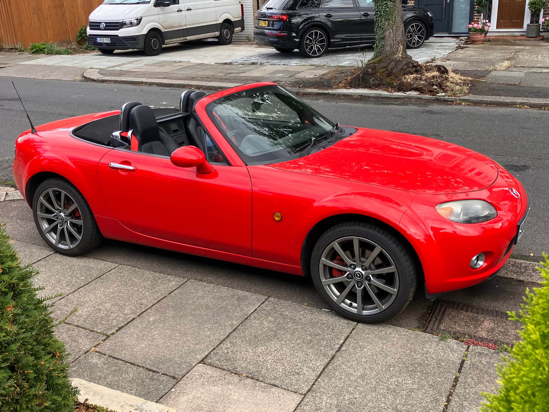

For a small amount of money I have a lowish milage early original red NC1 2.0 sport, first hour driving and I just love the handling and the little bit of subtle slide from the rear coming out of corners :)) .I was wondering what mods are most rewarding to have?
I feel want to lower the little beast a little as it seems to ride too high, a bt like a 4x4 from the side…

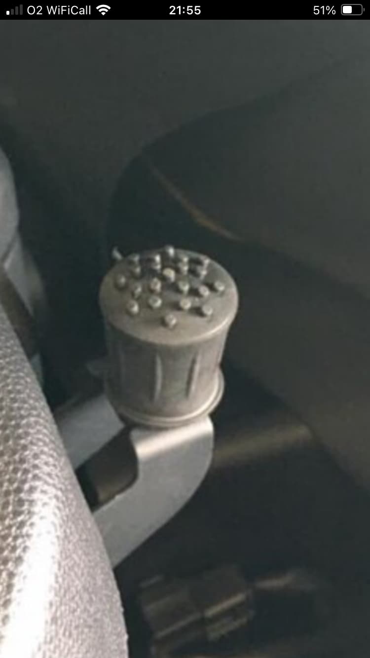

The best mod? Two 5/8 inch rubber walking-stick tips which fit over the rubber “stops” on which the hood rests when it’s in the down position. This restores the slight “bounce” upwards when you release the hood from the lock-down mechanism and makes for a more solid area behind your head.
I will look for some unguarded walking sticks from the umbrella pot in the cafe at Tesco…

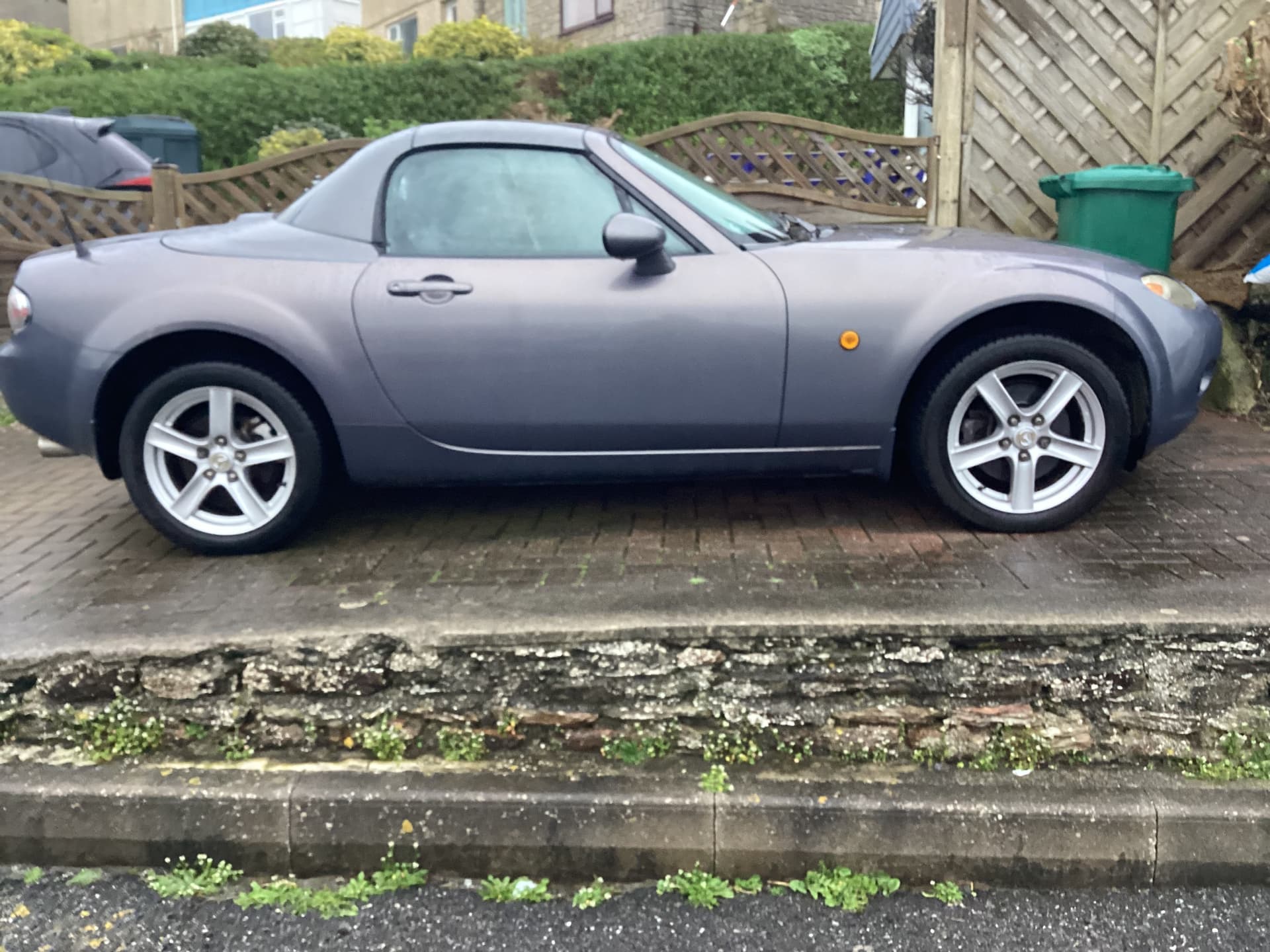

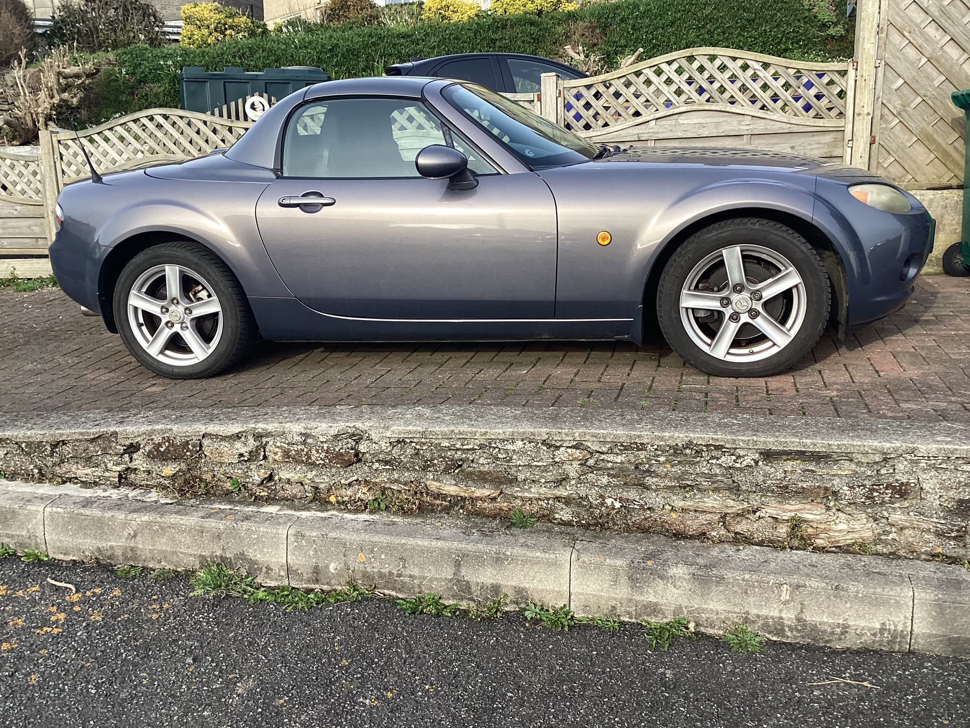

Hi, also NC1 owner. I initially lowered mine by 30mm and there was nothing not to like. Much improved appearance and hardly any harsher ride for plenty more feedback.
I’ve now got some basic Meisters. A breeze to fit; harsher ride but I’ve got used to it/they have bedded in a bit. So two budget choices for quite a change……
Did you have an 1800 or a 2.0 sport like mine with Bilsteins? not sure if there is a difference. But I am almost certain with that the large wheel arch gap, it can’t have been lowered at all so far, it almost looks like it must be because the tyres are lower profile than the originals etc.
Lowered….
Standard….
